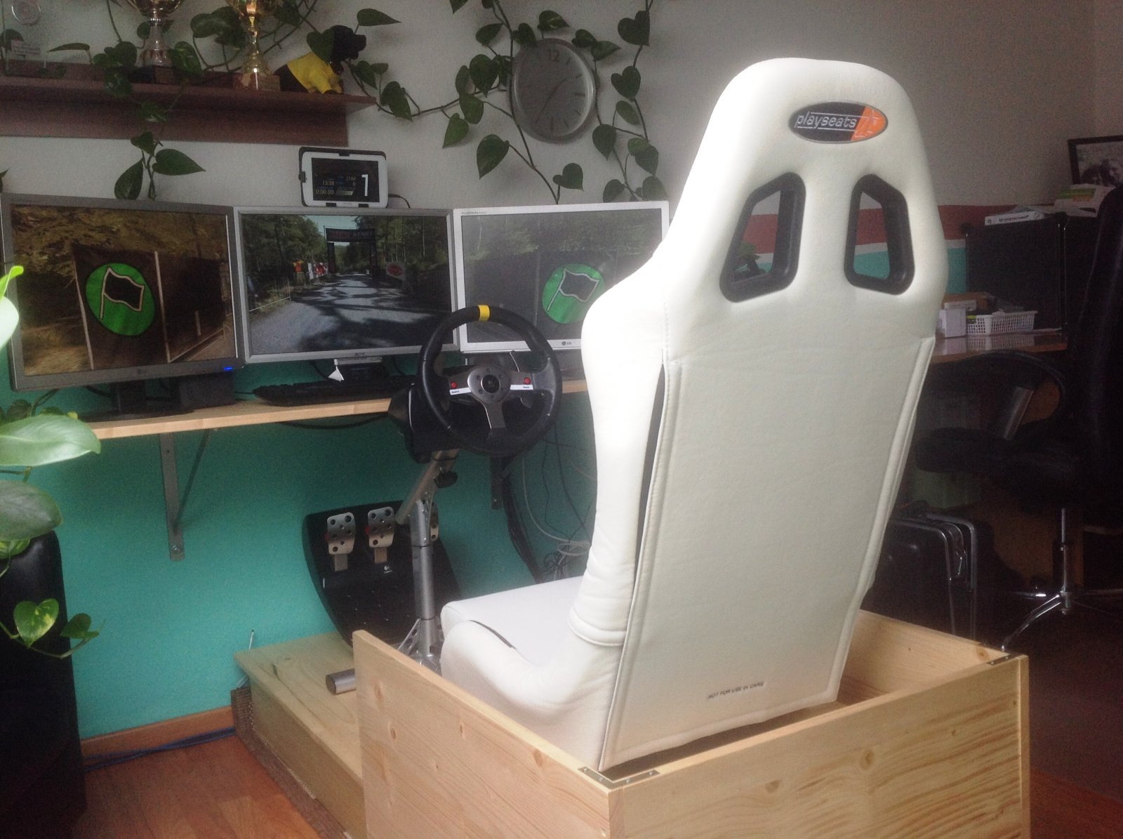

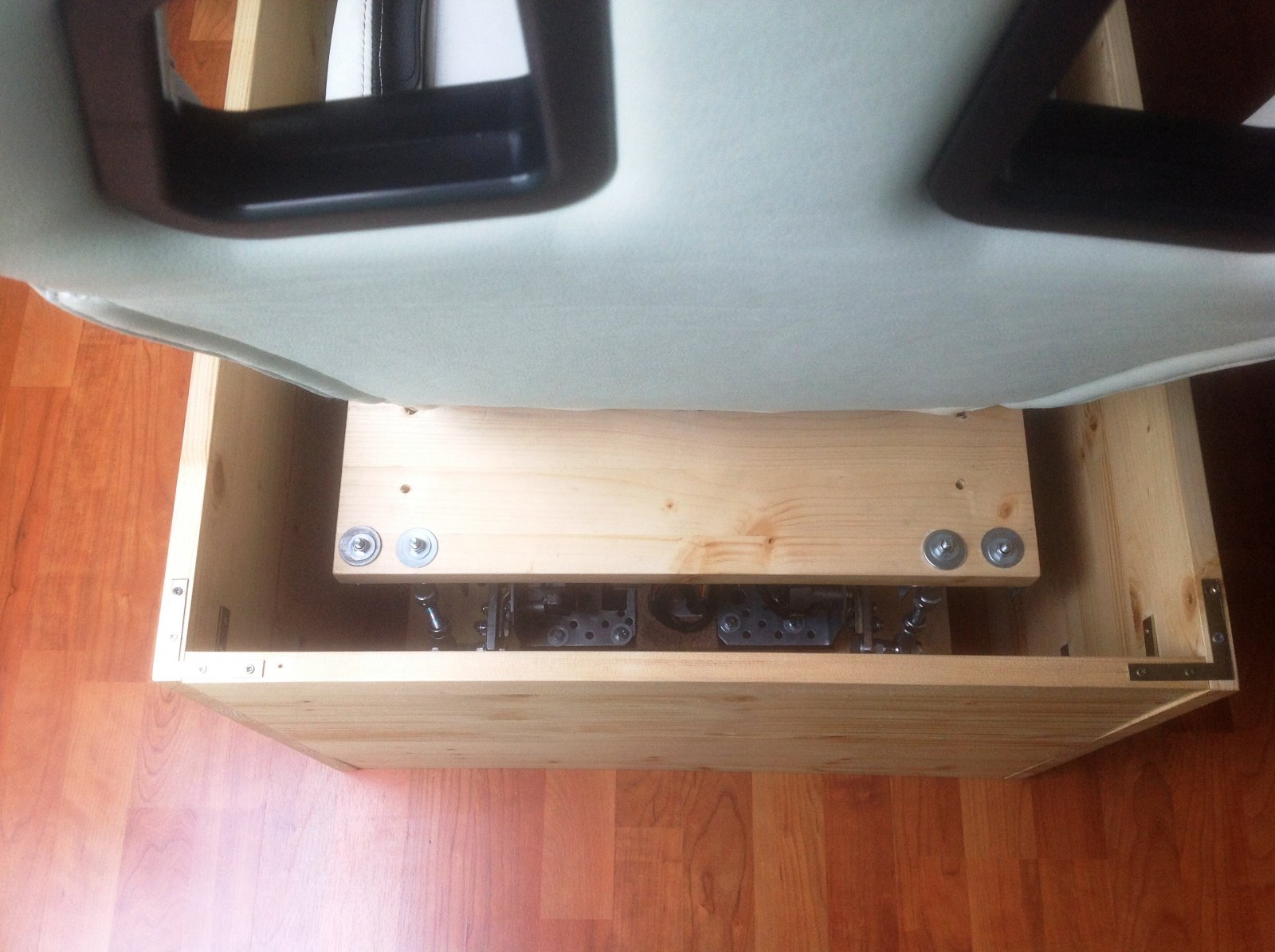

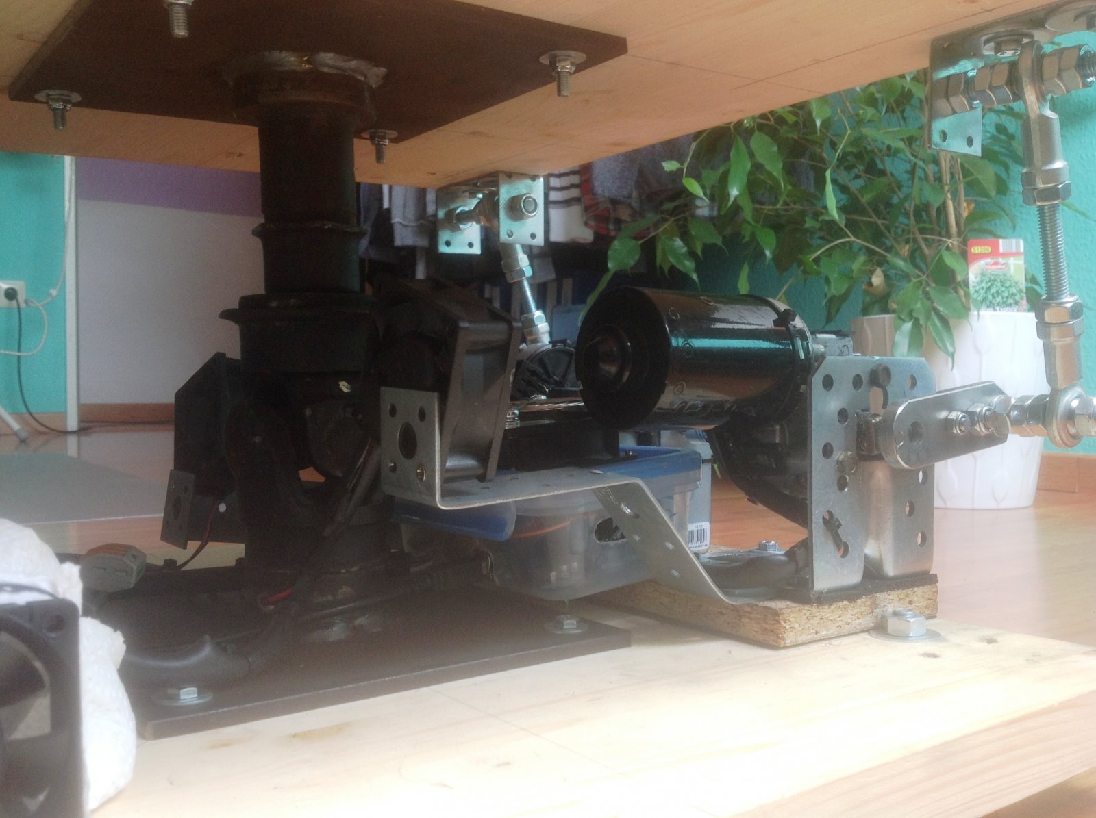

    Hello
    First of all i must say this is a great Forum and Community.

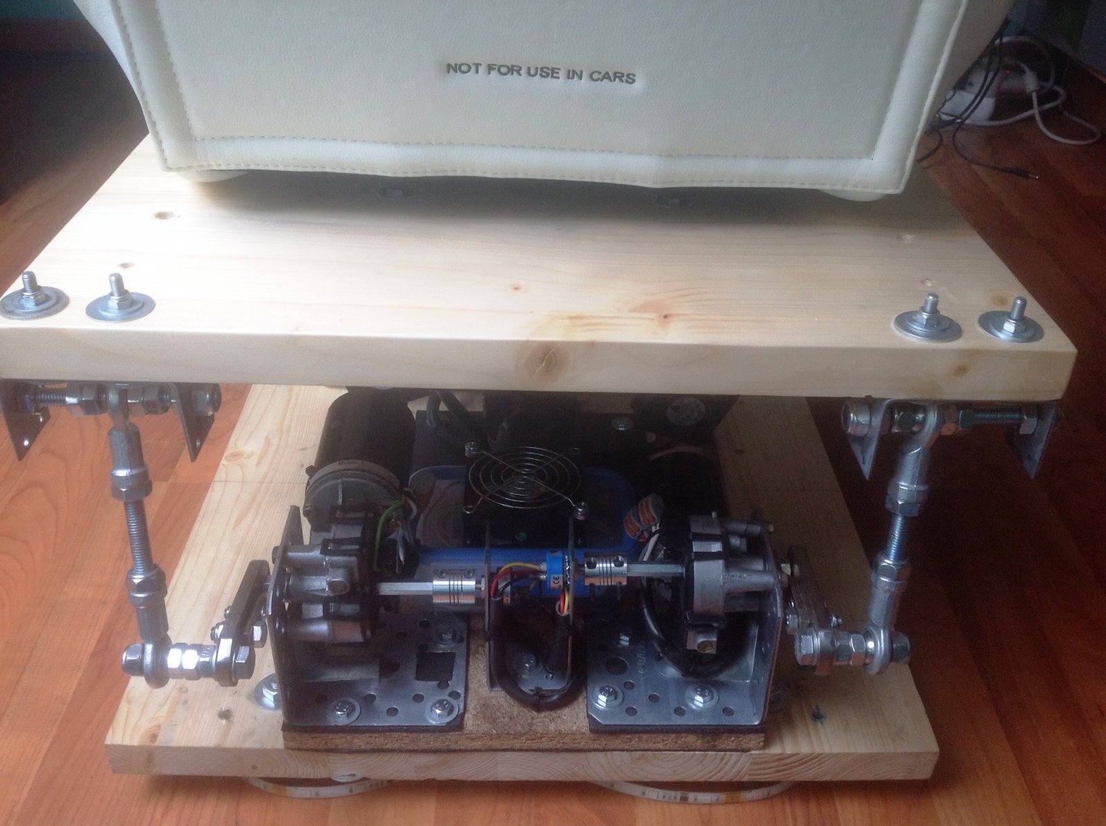

    3 month ago,i found this forum and i know i must build a Motion Simulator.:D
    Special thx will i gave to RacingMat,for his Step by Step Guide from his own built.
    For me it was verry helpfull.
    Electrikal Stuff:
    2 Wiper Motor from a Golf 4
    1X Arduino controller
    1X MotoMonster
    1X Server PSU Delta DPS-835AB (12V 69A)
    Many screws,wood,and a socket from my wife for the Electrcel Stuff:)
    IMG_4398.JPG IMG_4405(1).JPG IMG_3581.JPG IMG_3582.JPG IMG_3583.JPG IMG_3584.JPG IMG_3585.JPG IMG_3586.JPG IMG_3587.JPG IMG_3589.JPG IMG_3590.JPG

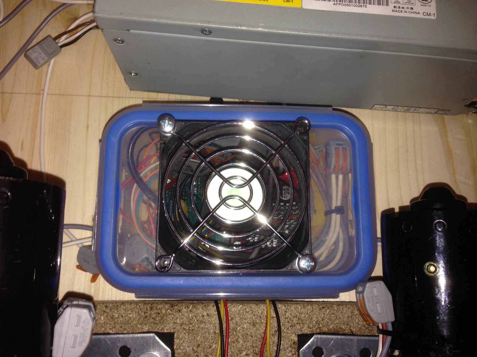

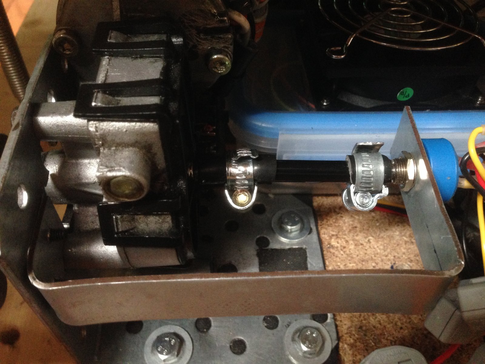

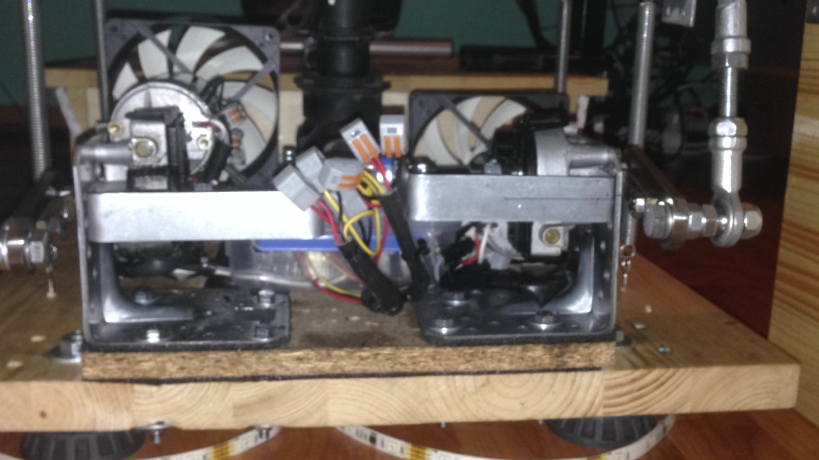

    After 2 littel Updates my rig works very fine.
    I have rebuild the holding for the potentiometer,and have built some fans for the motors.
    2x12 cm fan for the Motor's.
    It run and run and run and run,and make me a lot of fun.:)

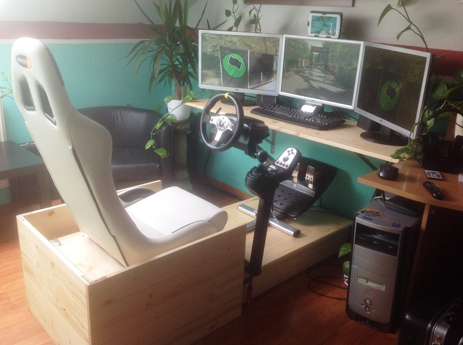

    The seat is from a "Playseat Evolution". You find it on ebay. That were my start to the world of sim racing.It looks good, but is not very comfortable. I will later replace it with a Sparco Sprint.

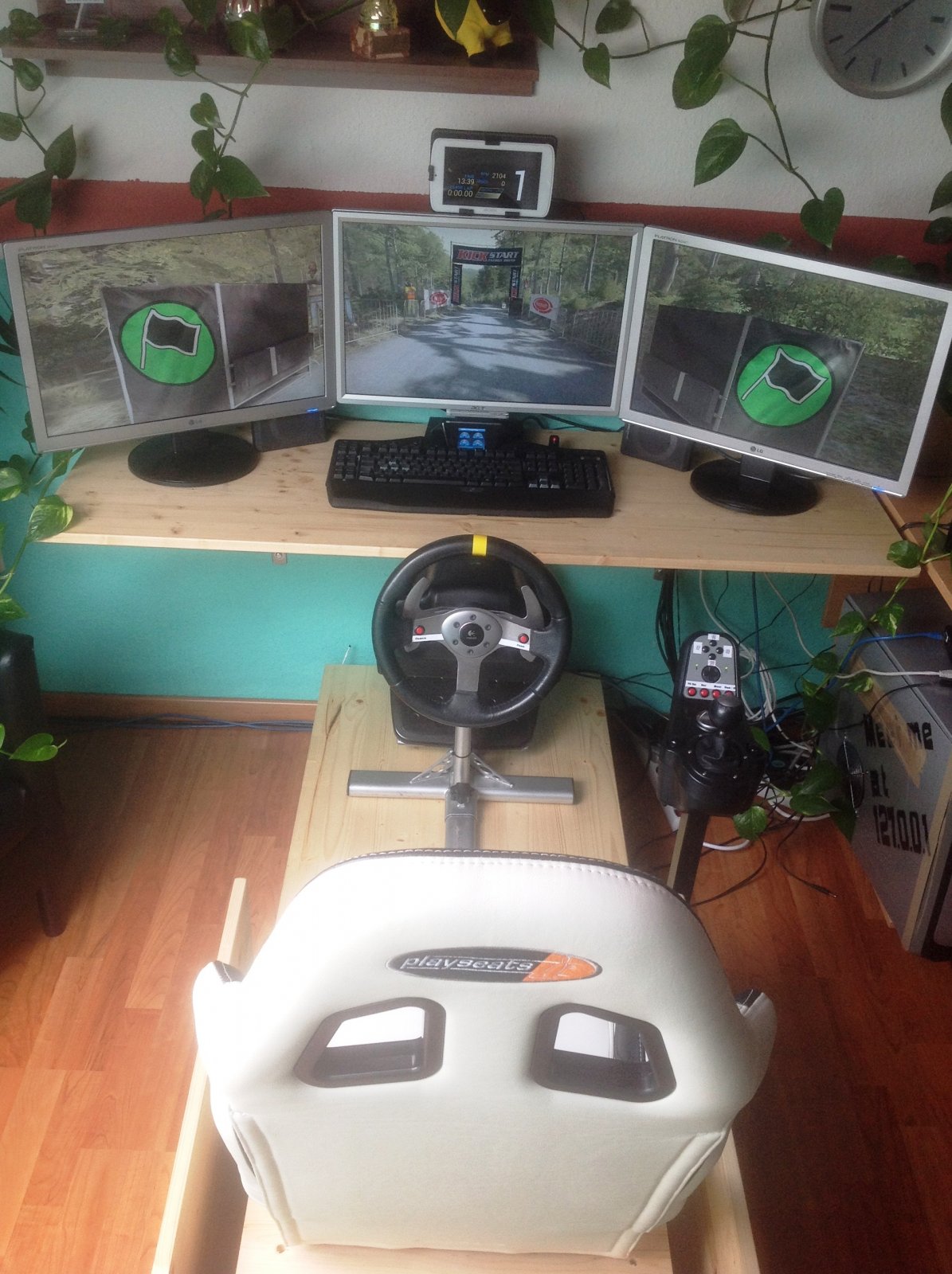

    It seems very uncomfortable to me that the chair moves but the wheel and the pedal's don't.
    How does it feel?

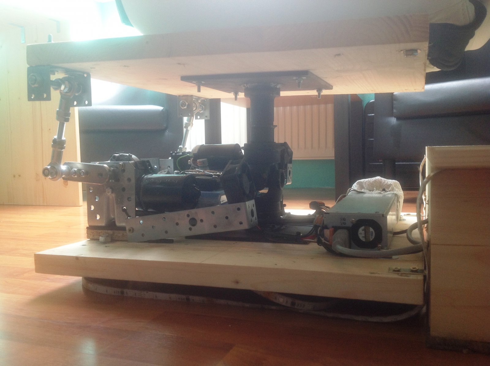

    I can't see the full specs, just a summary, but from what is there the motors should be fine.
  14. Nick Moxley
    17,054Coins
    +2,504 / 30 / -2
    Curious why did you remove the Flex Couplers ?
