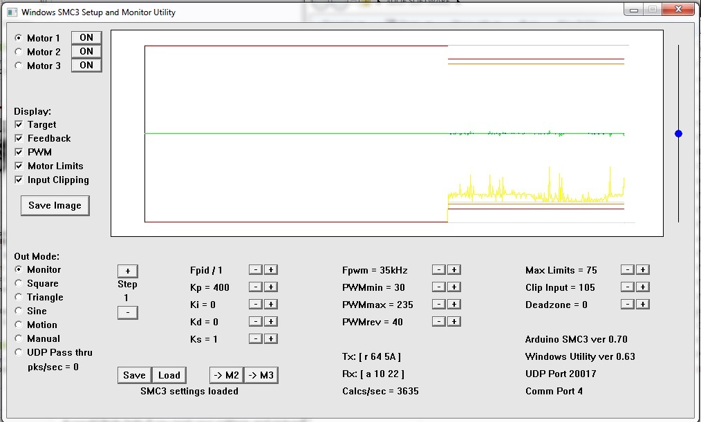

    Yes I have tried using manual mode, UDP pass through, motion and all other modes. I can see the light blue line on the graph saying that signal has been sent but it looks like nothing is coming out of the arduino. I haven't got all my test equipment at home so I can't look for signals coming from the pins to confirm but it looks like it's a problem with the arduino. Unless I've been sent two dud motomonsters. I'm thinking I might go and get an arduino uno and try it out before I replace both motomonsters. I have another two motomonsters spare so if the uno doesnt work I'll replace the motor drivers.

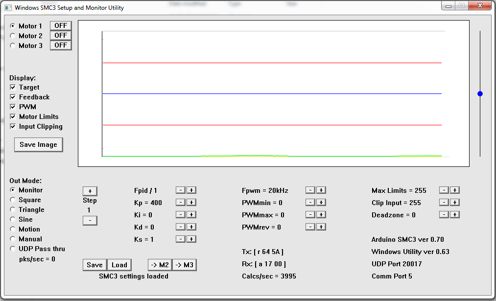

    This is the initial setup as per instructions:
    Ignoring the green line because I've disconnected everything at this stage for fault finding, when I tested the setup I increased PWNmax all the way to 255 and nothing happened. So Itried doing that for every output type and still nothing. I moved the chair up by hand and the green line moved to the blue line so I know feedback is working. Also, yes I know to turn motors on in top left hand corner after out of bounds (Incase someone asks).

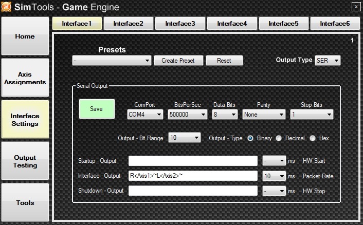

    This is so frustrating..... I got the arduino UNO and got everything working in the utility, motors moving yay!
    Now.... Simtools isn't moving the motors...... I've set everything up accordingly and nothing moves on the output test...
    This is just absurd....
    22,185
    154,750Coins
    +11,196 / 57 / -2
    It would likely help if you post your settings and pictures clearly showing the wiring.

    Wiring is all good, I can controll the motors fine withing the SMC3 utility.
    These are my settings for both SMC3 and setting for engine:
    I'm really hoping that I'm blind and have missed something...

    Should the actual COM port in the device manager be able to be set to 500000?? In the com port settings it doesnt' actually go to that value.

    Motion platform
    Interface output I think should be [A<Axis1>][B<Axis2>] for SMC3 code with 2 motors
    And add [C<Axis>] for the third motor if you go for traction loss

    I didnt touch the device manager setting only ths simtools interface for the bits per sec

    @Alexey as @Daguru mentioned you have wrong settings in interface settings must be as he said
    [A<Axis1>][B<Axis2>][C<Axis3>]

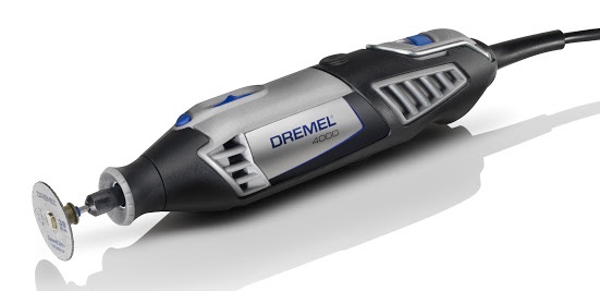

    How nice making holes?
  11. Alexey
    Alexey Well-Known Member
    Sep 23, 2014
    452
    Electronics Technician
    Adelaide, Australia
    8,066Coins
    +623 / 2 / -0
    image.jpg I used a tool called Dremel as pictured.
    I drilled a hole first then to make the longer cuts I used the Dremel.
