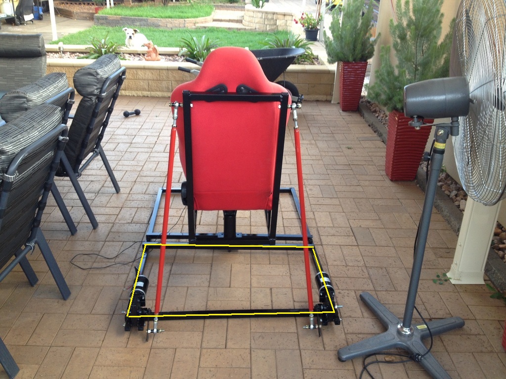

    That is really coming together now.
    Great job on the pedals they look amazing and from what you describe work a treat :thumbs
    How thick is the lever arm off the motors? It looks around 5mm, but the photo is a bit blurred. These take a fair bit of a beating and need to be robust, particularly in longer lengths.

    It's 5mm steel bar, I used 8mm bar last time and thought it might be overkill so I decreased the size. I certainly can't bend them by hand but I'll just have to wait and see how they respond to the hammering that they shall receive. Yeah I only noticed the blur after I uploaded to my computer and it was too late to take another pic as it was dark by then.

    What size is the RHS for the base frame? Will this be strong enough to prevent any flexing?

    @GIB The RHS is 30x30x3mm steel, it's surprisingly stiff for the size of the frame. I might have to add two pieces that cross the frame from the motor mounts to the drive shaft if I see any flex in the frame.

    On this photo there are some visible inaccuracies in motor positions, I don't know if that's because of photo angle but it shouldn't be that much distorted anyway. Looks like the back bar of the frame is not welded at 90 degrees, I don't know, it doesn't look right and if there are differences in motor position - one motor being further away from center than the other motor, you could find yourself in trouble with symmetrical movements and making profiles. Do the measurement again and see if the motors are positioned evenly and symmetrical, maybe I am wrong.

    The center mount is on a pivot not the external frame. This is because I made a mistake in keeping alignment on the driveshaft when I welded it. The angle is there to counteract that misalignment.

    im Confused, So you Purposely welded it out of square ? Why not just fix what the problem is ?

    Because fixing it would have taken an hour to do whereas welding it on a corrected angle took 5 minutes. My laziness wins 100% of the time :)

    That may very well come back to bite when you have odd geometry and are trying to create motion profiles which will also need to compensate.

    Also just for clarification because I didn't actually address the query, the motors are square to the bottom frame as well as the top frame. The only thing out of square is the two parallel bars supporting the top frame.

    It is worth getting it square, frustrating though that may be in terms of time and extra work...we all live and learn.

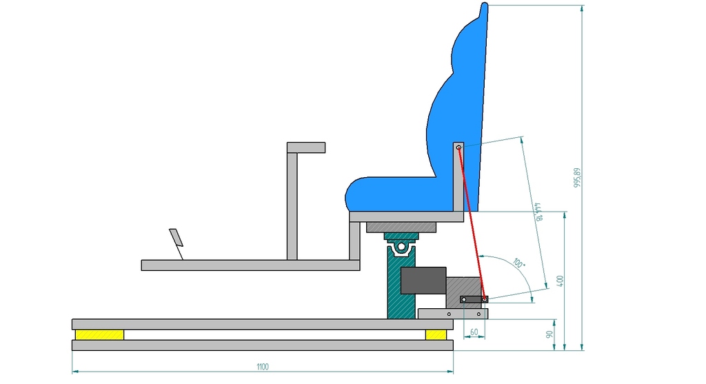

    If I'm starting over........
    Front yellow box is 150Kg chair swivel, back yellow blocks are conveyor style roller bearings.
    The new design should fit under a standard desk (this is just a back of the envelope sketch), steering wheel will be detachable so that it can be used like a desk racer or stand alone. Foot pedals will move with the rig.
    Bottom frame will be move back slightly for balance, or extension arms made for compactness.

    Any reason not to bring the base frames back basically level with the back of the seat? I would think it would give better mount support for the motors and better stability for the rig itself, as otherwise your weight when lent back is past the back of the frame.
