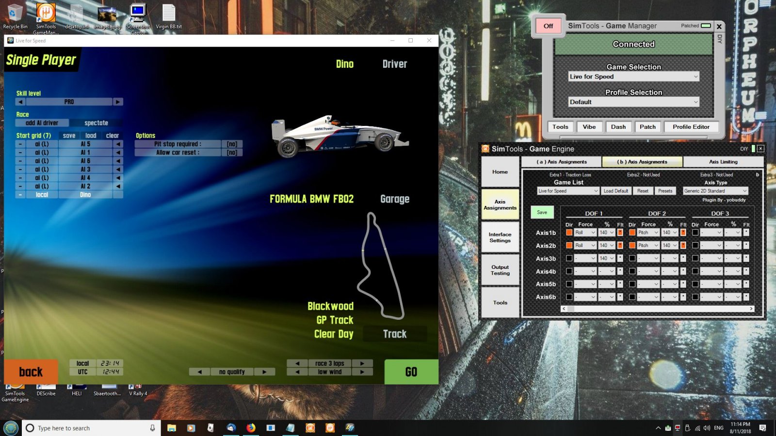

    Update 2.
    I have figured out and adjusted the pots so they are now in sync and start from a common home position.
    I had to bend one lever out a bit to get clearance as it jammed against it.
    I also think I need to redo the balance point of the rig as it's a bit nose heavy, but luckily I allowed for this and I have two extra positions that I can go forward to which will hopefully take some of the nose heavy attitude out and better balance it.
    Am I going the wrong way with the axis values as in the pic ?
    I started at 80 and have gone up to 140 to see if that made it work better as my pitch and roll are doing bugger all, but that is probably what you just told me top do with the axis directions.
    I'm slowly getting there

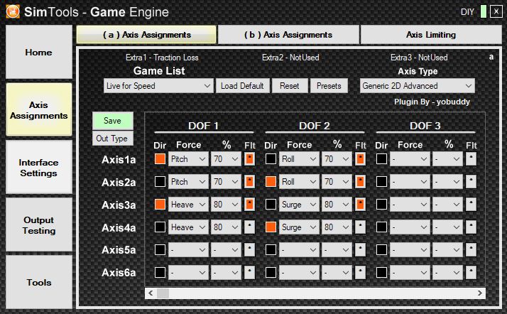

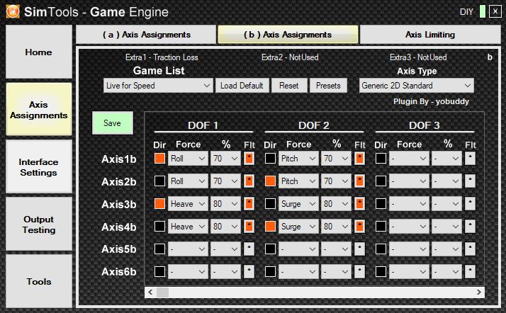

    I have been capturing data from LFS but I think my axis settings are still way off as I'm only getting limited movement so far.
    The most reactive is the surge if I get rammed which then pitches the nose down and it doesn't or can't return to level once it had stabilized from the impact.
    These are my screen shots of the settings that I am trying atm.
    Thanks.

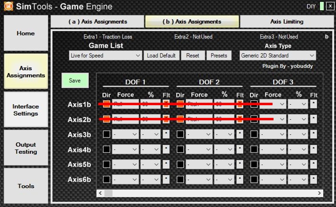

    Your axis settings are reversed from what they should be. On a 2dof you normally use only axis1a and axis2a. The you put the dofs on each of those.

    I am sorry to say this, but your settings are really confusing.
    I confess that I am far from being an expert, but there are several obvious mistakes you need to correct.

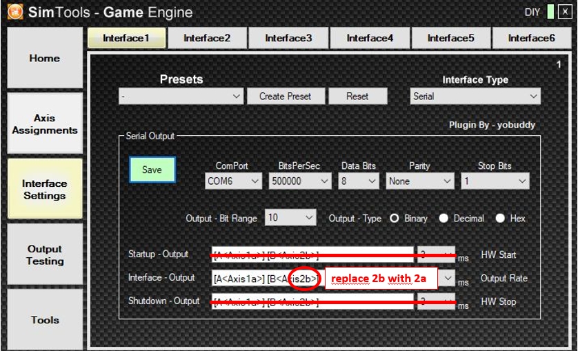

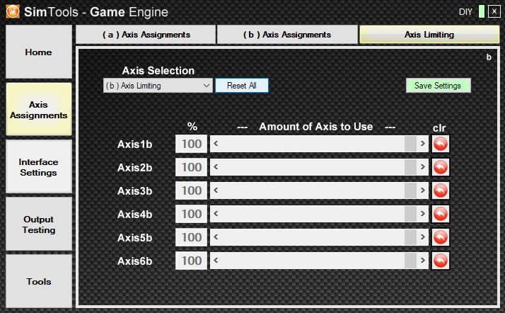

    1. At first about the Interface Settings:
    In your Interface Output, you have defined [A<Axis1a>][B<Axis2b>]
    Please change 2b to 2a, so that you then have: [A<Axis1a>][B<Axis2a>]
    Some background information: SimTools supports two sets of axis: set <a> and set <b>.
    You only have 2 axis, and for this reason you should only use one of the axis sets. Otherwise, the Axis Assignment becomes more complicated, because you would have to permanently switch between Axis Assignment (a) and (b) tabs in Game Engine.
    Delete what you have entered in Startup - Output and Shutdown - Output. As I said, I'm not an expert, and thus I don't know what these lines do in your case. But since I don't have anything entered there in my settings and it works, just try without them.

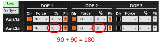

    2. Your (b) Axis Assignment
    After following the previous step, you only have Axis1a and Axis2a left. No need for configuring the (b) Axis Assignment.
    Delete everything you have configured here.

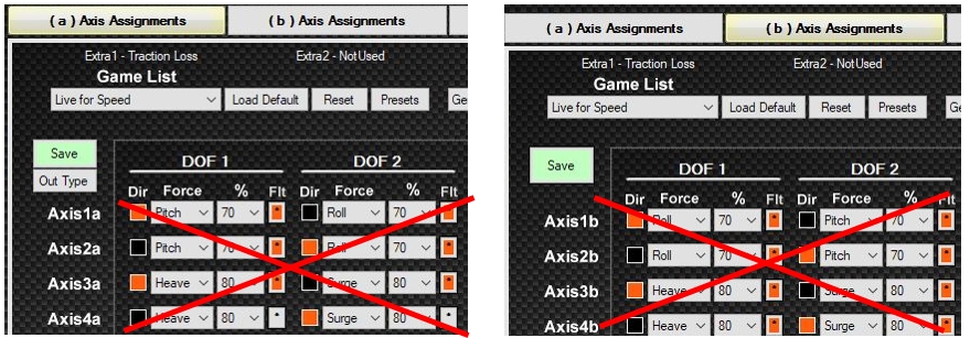

    3. Your (a) Axis Assignment
    The first issue with your Axis Assignment is that the overall value for each axis is way too large.
    With your current configuration it is 90 + 90 = 180, but it should not be larger than 100.
    Each Axis represents one motor, and with the Axis Assignment you define how SimTools shall distribute the different forces (DOF) onto the motors.
    You have defined that Axis1a shall get 80% pitch plus(!) 80% roll. Now imagine that the game's telemetry output reaches maximum pitch and maximum roll at the same time. What shall SimTools do in this case? It cannot assign more than 100% to the motor. The result is that the motor movement will not be correct, because a large part of the telemetry output cannot be assigned to the motor.
    So as a simple rule of thumb: Give each Axis (i. e. each row in the Axis Assignment sheet) less than 100%.
    Example: Roll = 40%, Pitch = 40%

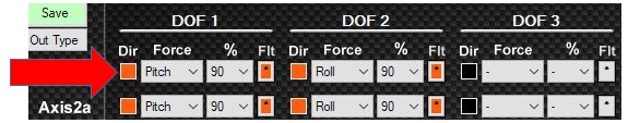

    The second issue with your Axis Assignment is that you have set the orange boxes incorrectly.
    These orange check boxes (see the red arrowe above) define the motor direction.
    Example: When the motor rotates clockwise with the check box set to "orange", then the motor will rotate counter clockwise with the check box set to "white".
    For "pitch" you want the motors to rotate in the same direction, while for "roll" you want the motors to rotate in opposite direction.
    That means: Either for pitch OR for roll both check boxes need to have the same setting (orange or white). But it is definitely wrong to have both check boxes "orange" for both "pitch" and "roll".
    Now let's start to get your settings sorted.

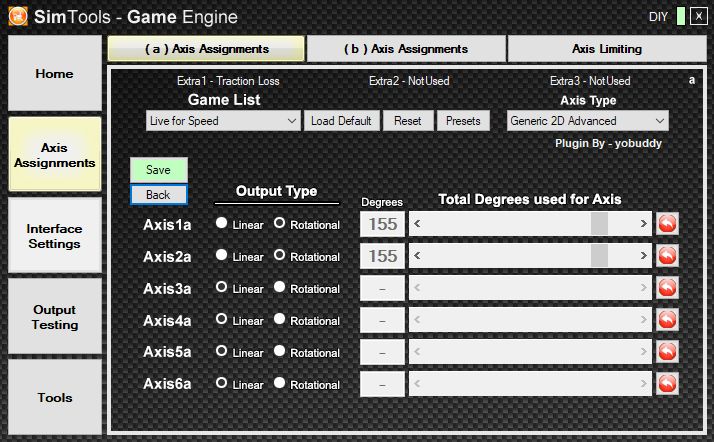

    1. Keep your Interface Settings (with the corrections I described above), but delete your entire Axis Assignments.
    After this, there should be no orange-colored highlights, and all selection fields should look like this:
    Set all Output Types from "Rotational" to "Linear". I know you have rotational motors, but let's experiment with this new parameter at a later stage. This may help to narrow down problems.
    2. Configure your first DOF.
    You have previously configured multiple DOFs (pitch and roll) at the same time, and that makes it very hard to tune your system.
    Since you are testing with LFS, I propose to start with surge (instead of pitch or roll, because these are not so relevant for car racing).
    Go to the tab "(a) Axis Assignments" and configure the "Surge" force in the following way. Leave everything else empty.
    Go to "Output Testing", press "Turn On", an move the "Surge" slider.
    Now you will see one of the following three things happen:
    • Both motors are moving into the same direction, and the seat leans backwards when you move the slider to the right.
      In this case everything is fine.
    • Both motors are moving into the same direction, but the seat leans forward when you move the slider to the right.
      In this case, press "Turn Off" and select the orange check boxes on both axis:
    • Both motors move in different directions. In this case, press "Turn Off" and only make one of the check boxes "Orange".
      Now repeat the Output Test: Does the seat now move backwards when moving the "surge" slider to the right? If so, perfect. If not, reverse the orange boxes:
    Now it is time for starting LFS and test your first DOF (surge) inside the game.
    Does accelerating lean the seat backwards as expected? If not, exit the game, go back to the Axis Settings, and reverse both orange check boxes.
    Is the amount of "surge force" to strong or too weak? Correct this by changing the percentage values.
    Further fine tuning can be done later.
    3. Configure your second DOF.
    For racing games, this should be "Sway".
    Important: Remember your "Surge" settings or make a screenshot from the Axis Settings. Then delete these settings, so that you can focus on "sway" now without getting distracted by the "surge" component. After you are done with all DOFs, you re-enter all the previous settings again.
    Configure "Sway" in the 2nd DOF column:
    Go to the Output Settings and test the "sway" force with the "sway" slider.
    Start LFS and drive some laps. Does "sway" feel right? Or does the seat lean to the wrong direction? In this case exit the game, go back to the Axis Settings, and reverse the orange check boxes.
