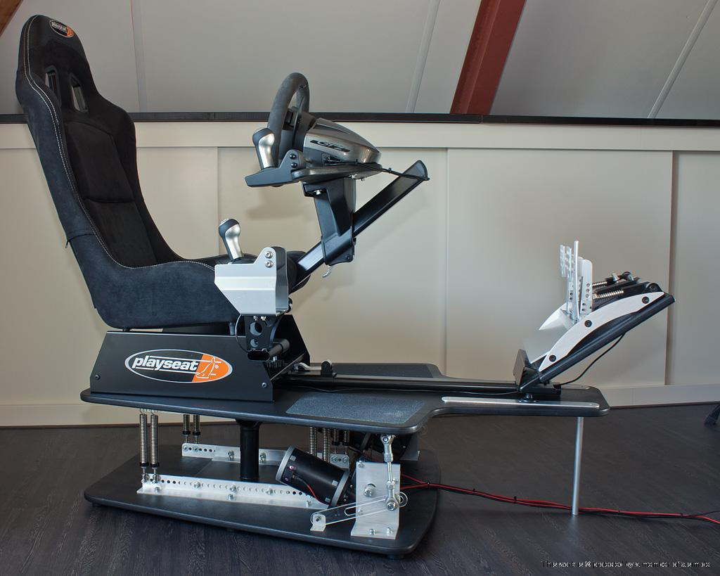

    I begin my research. I find a Dutch boy's project I like more aesthetically than the others
    I don't have a playseat but I like the compactness and cleanliness of the project ... Tanks to
    Floriske, the Dutch boy, who inspired me.

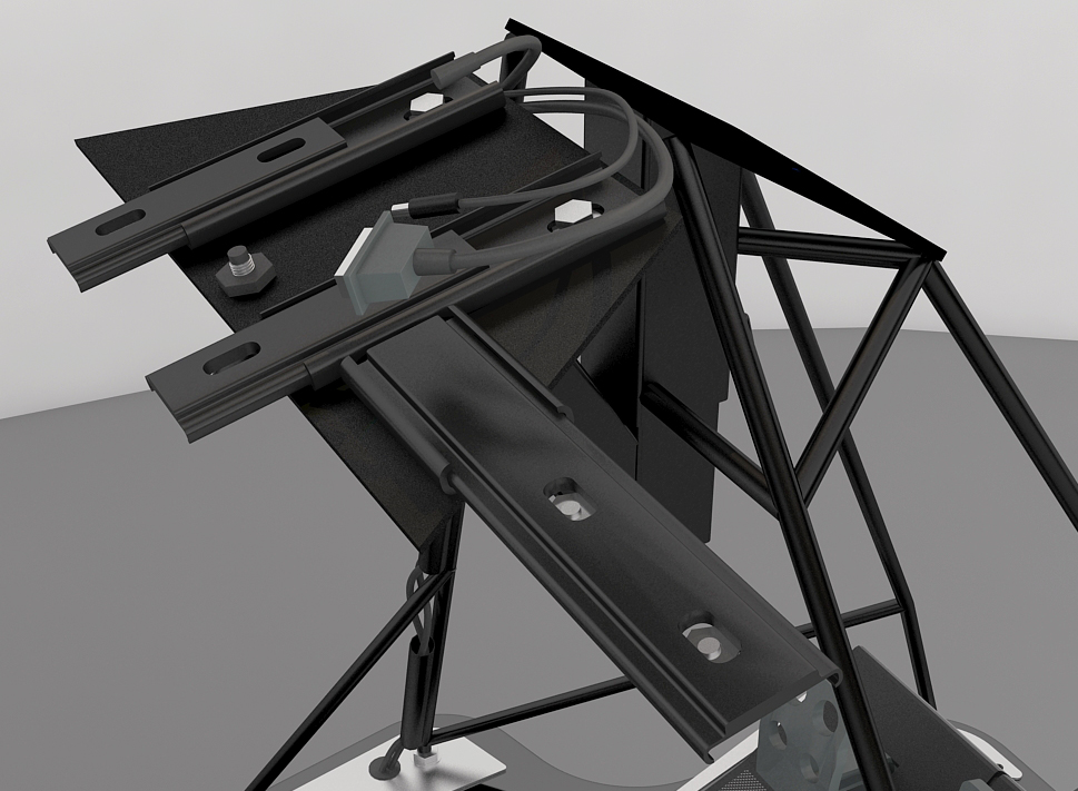

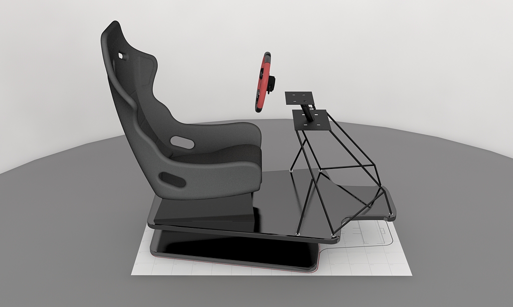

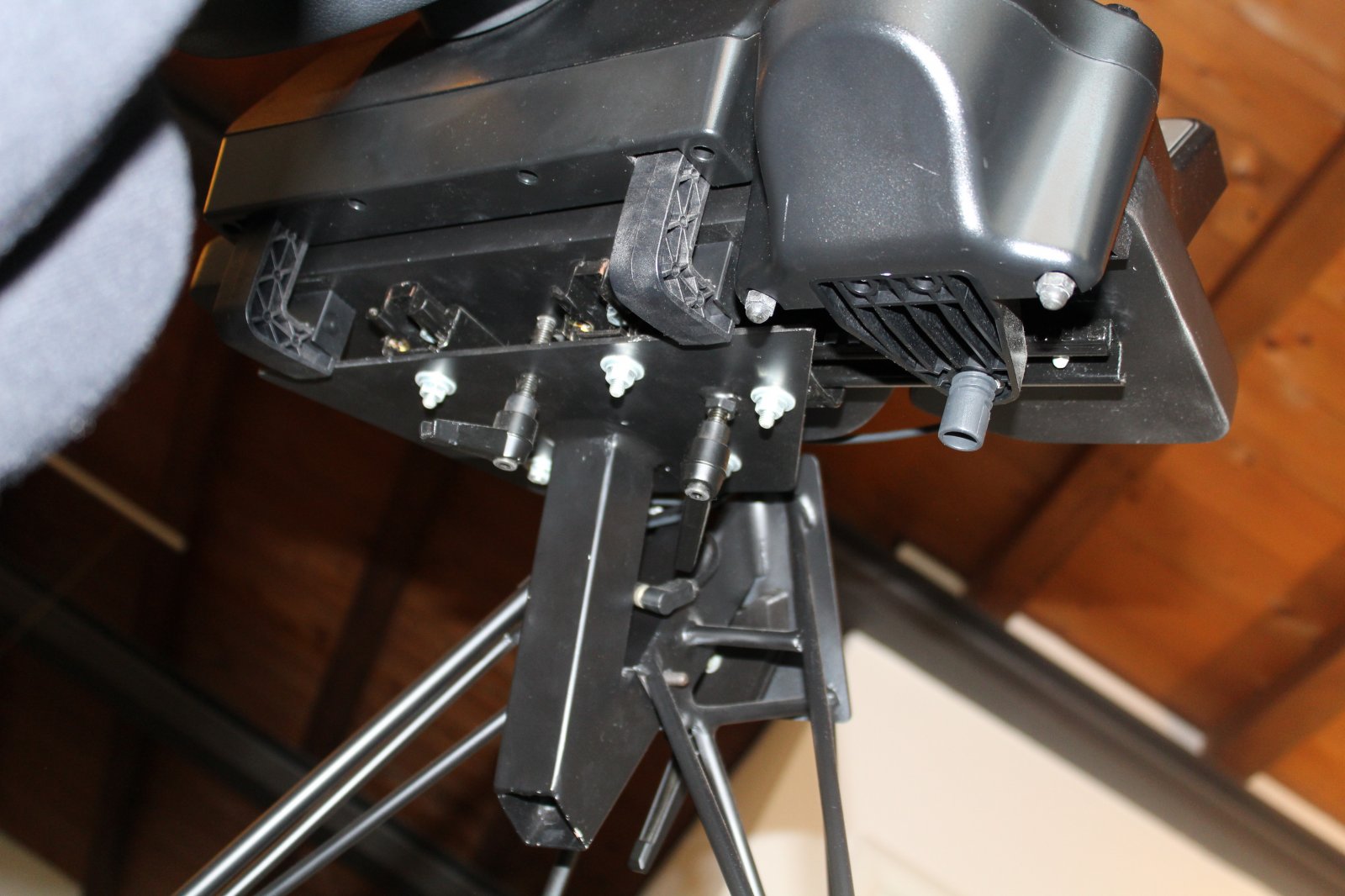

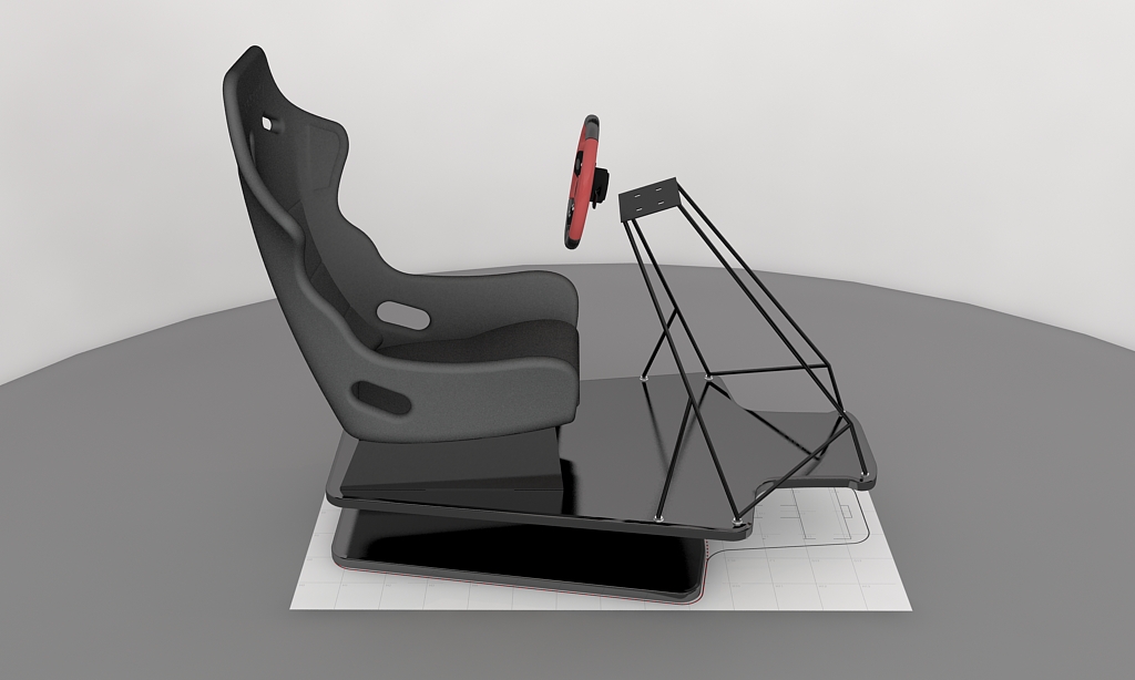

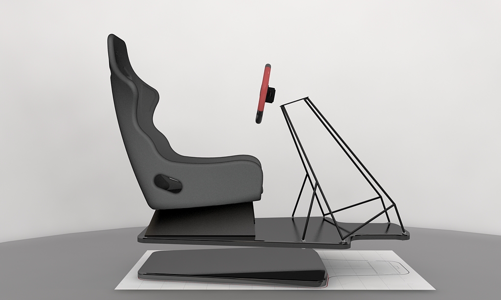

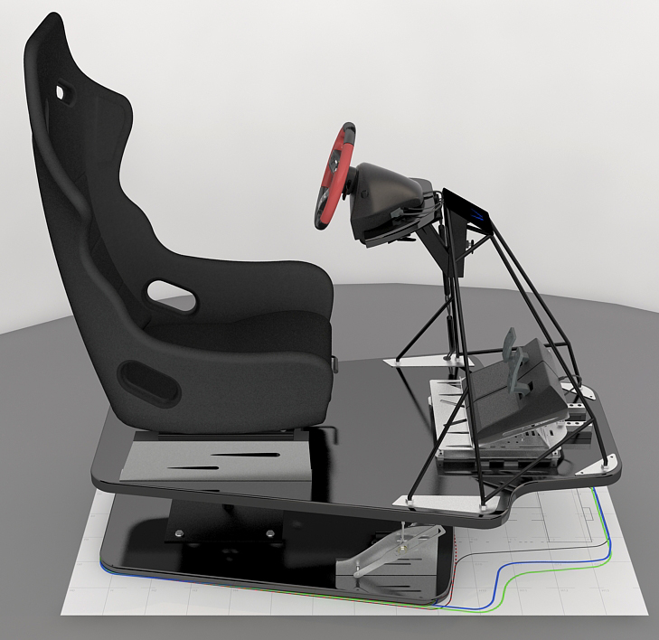

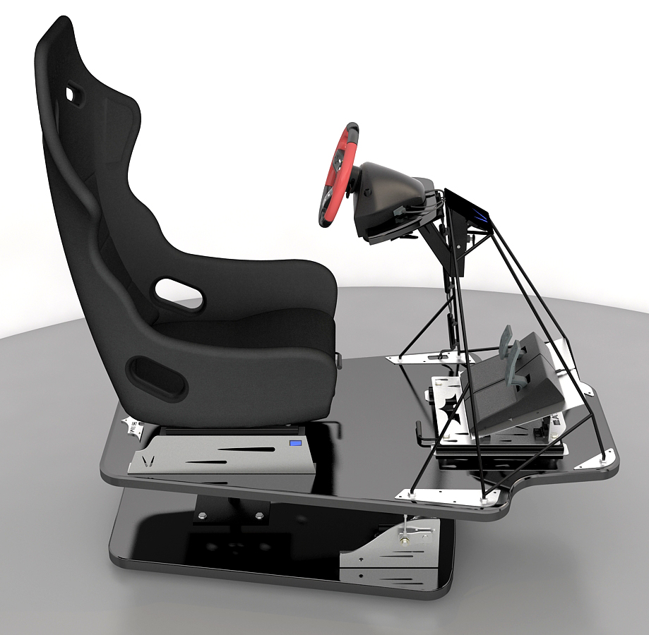

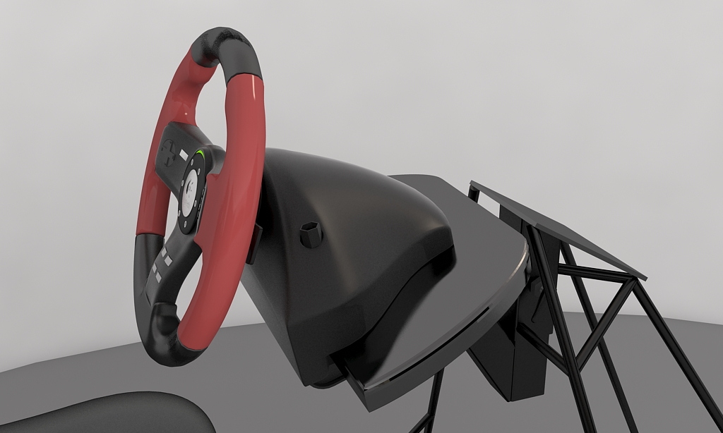

    The planning part was long. I used 3DS max to generate the model and have a preview of it. The
    steering wheel holder was the first knot to untie. Considering that my son was 9 at the time, the support had to be adjustable. After various tests..
    I find a solution that I like
    you can adjust height and distance .. you can also remove the H gearbox ... an unnecessary
    refinement, ... I had an extra piece of sliding guide and I used it for him..

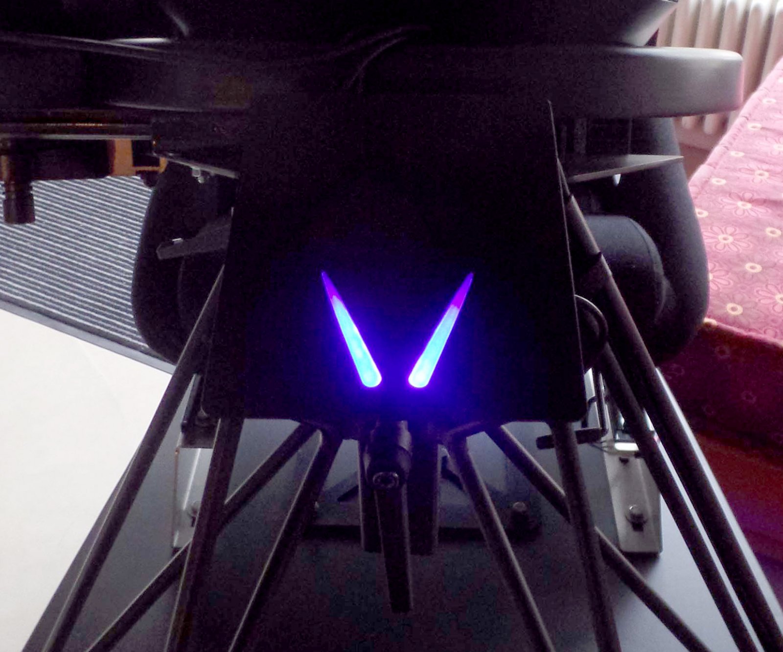

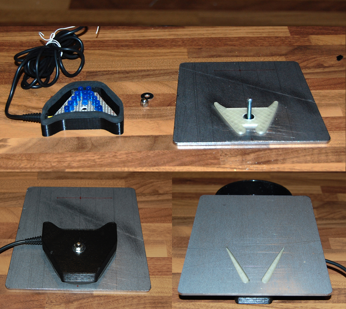

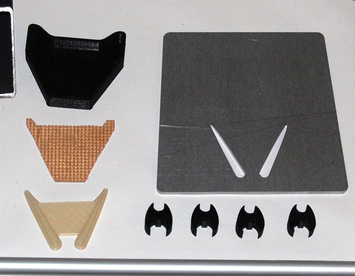

    I also wanted to have some led lights ... I made his eyes !!
    To light up the eyes I printed some 3D pieces and add some led--

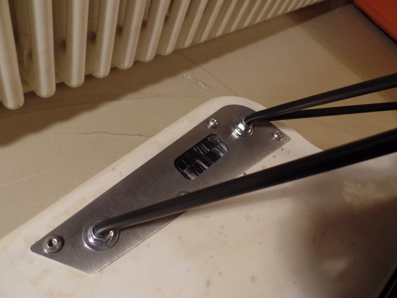

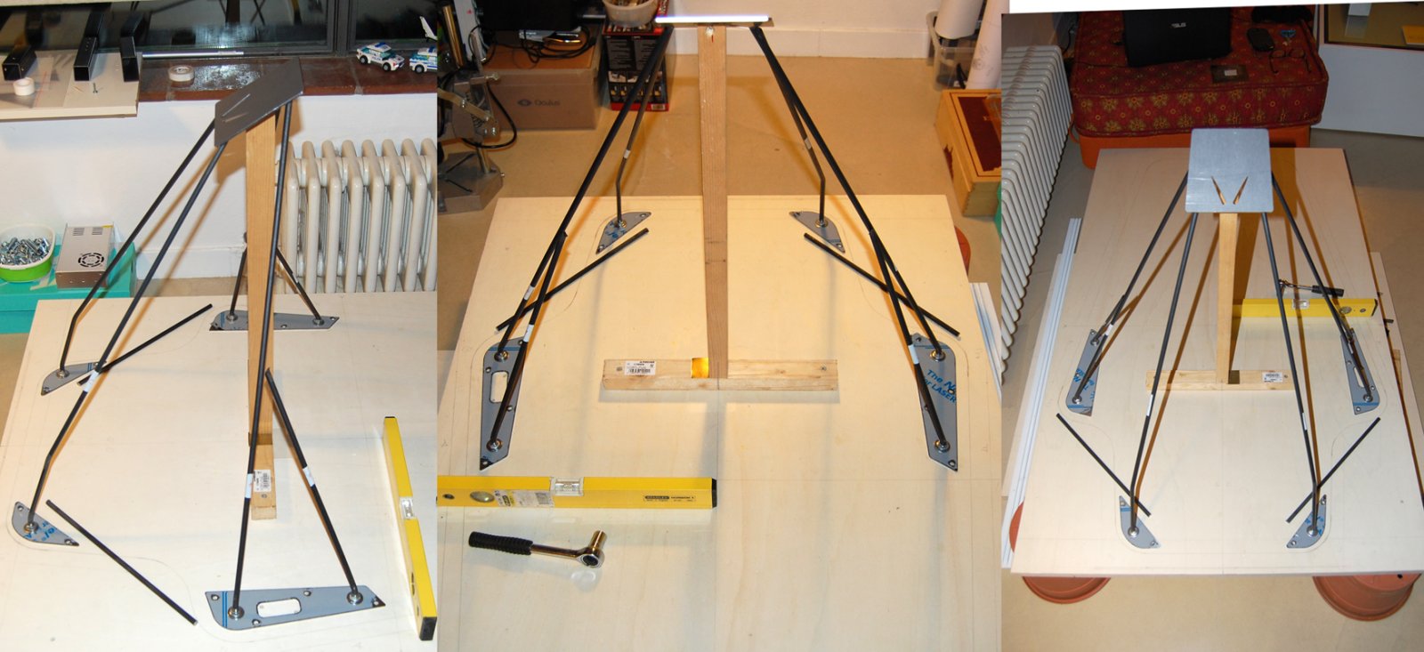

    The other parts of support is made with iron rods, welded and threaded. Inside the drawing there are not some pieces of rod that I added later, before it moved a bit, now it is fixed like a rock.

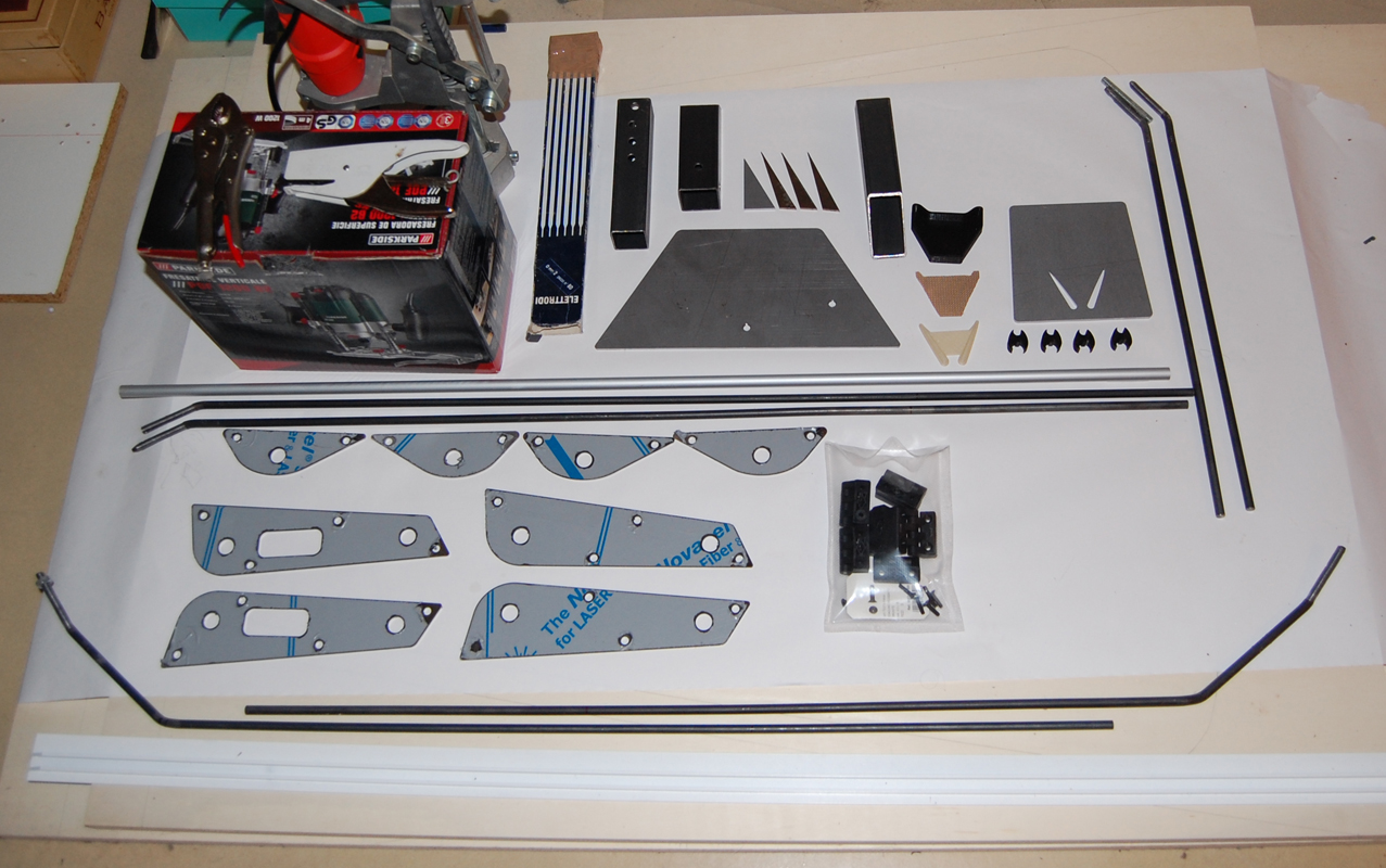

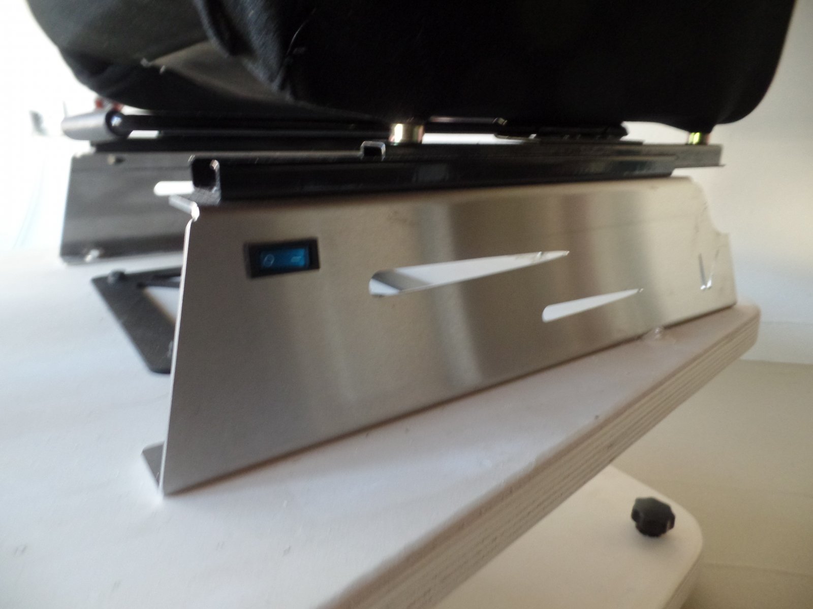

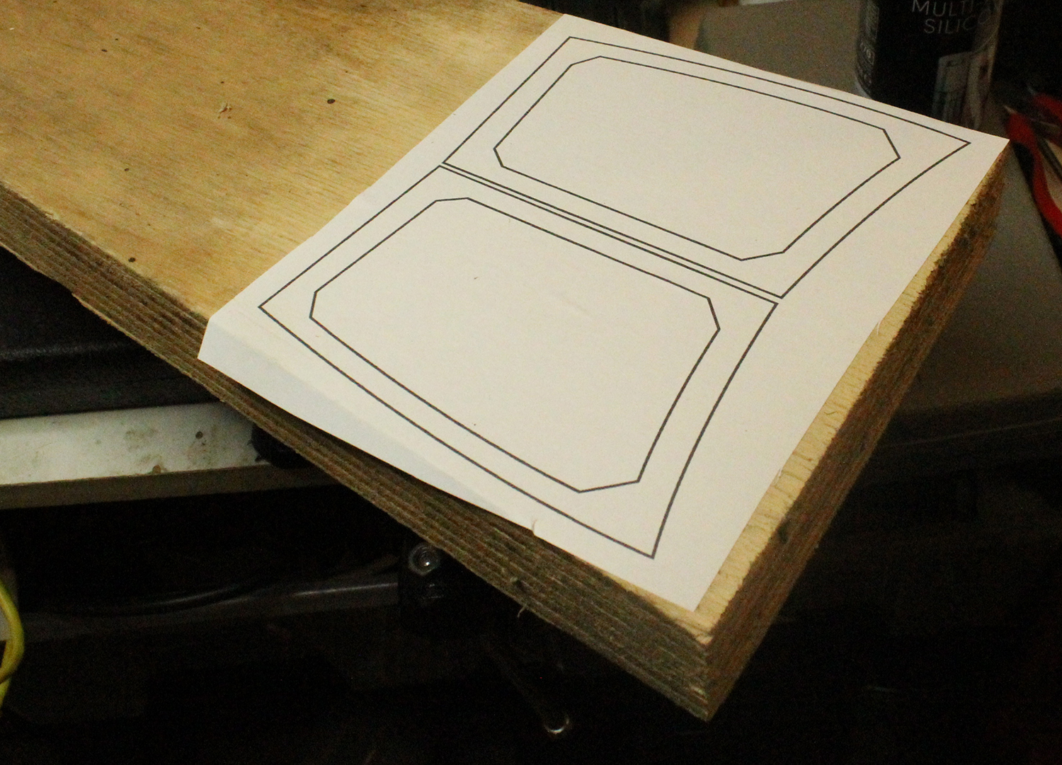

    I forgot to tell you that I have a big advantage: a friend with an industrial laser cutting. I can
    extract the paths from 3D max and pass them in the cutting machine directly .. I can do whatever I want!
    I used, 5 mm satin steel for the seat and motor support, 2 mm for the pedals and steering wheel
    support details, satin aluminum 1,5 mm for the electric unit and 4 mm - 2 mm iron for the steering wheel support and the gimbal.

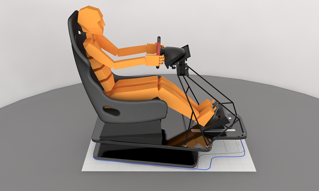

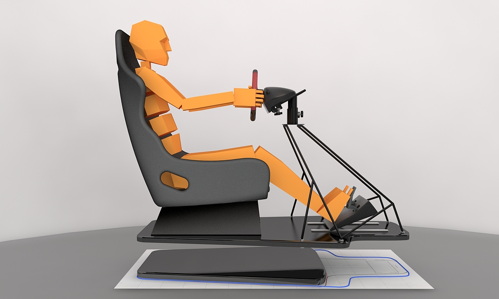

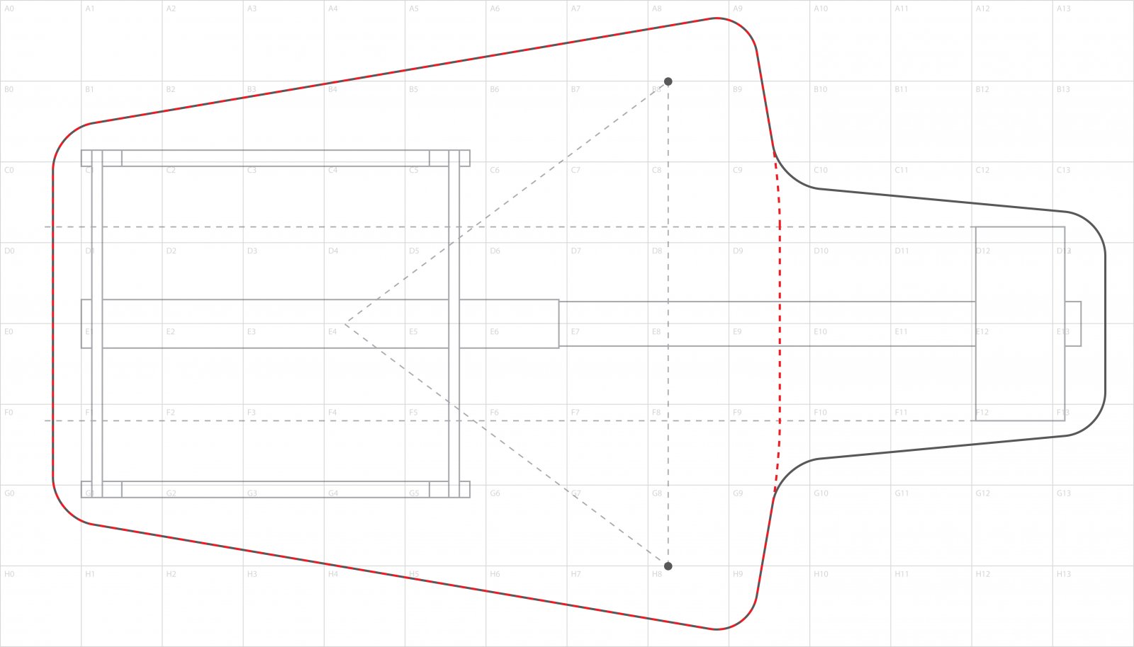

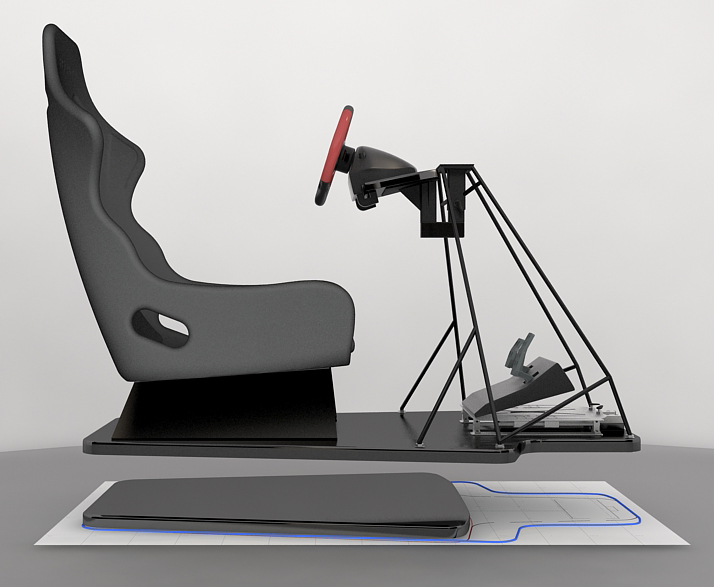

    The shelves are 3 cm stratified wood. I used this picture to find the most suitable shape of my sim.
    The drawing is always from the Floriske project..
    The green line in rendering is my final path
    I find the most suitable position for seat, steering wheel and pedals ( the orange man is exatly me!)

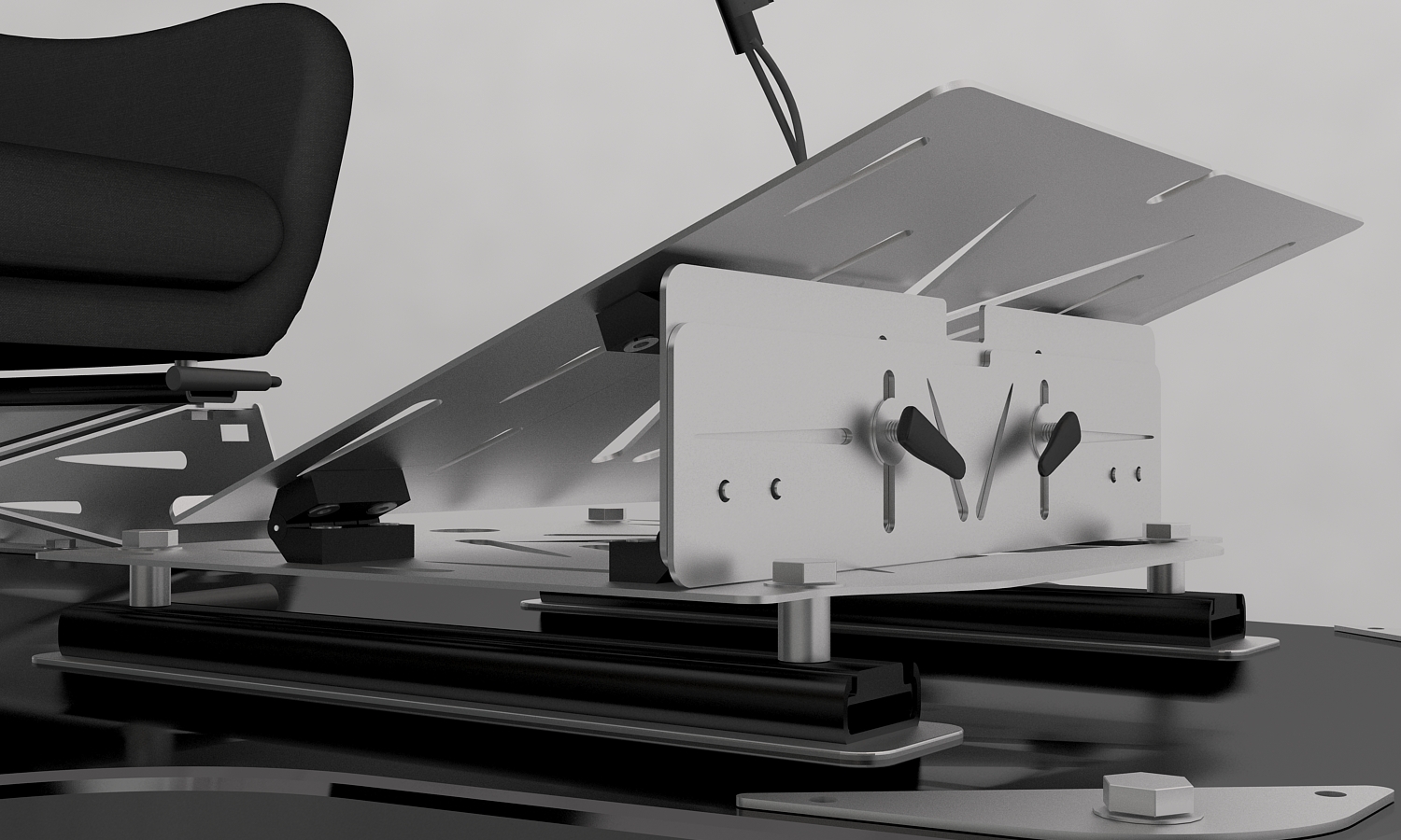

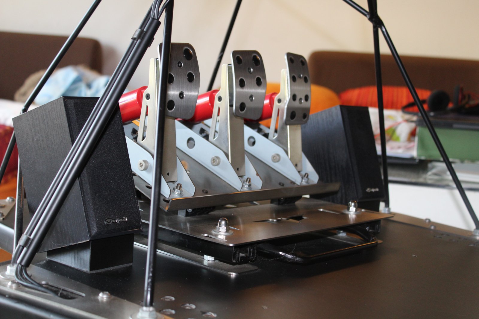

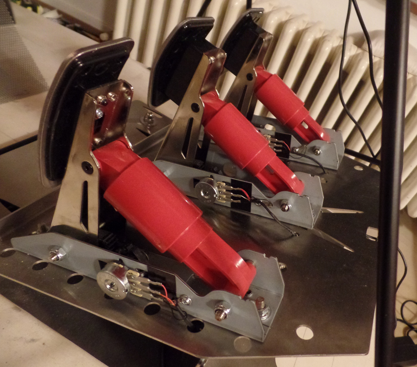

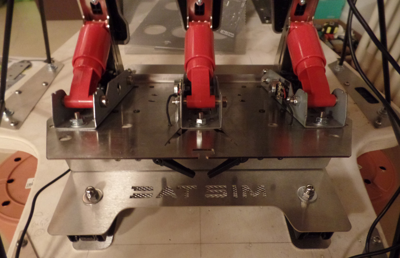

    I drawing the support for pedals. I used sliding seat rails to be able to adjust the distance with seat....
    another useless thing is the adjustment of the inclination

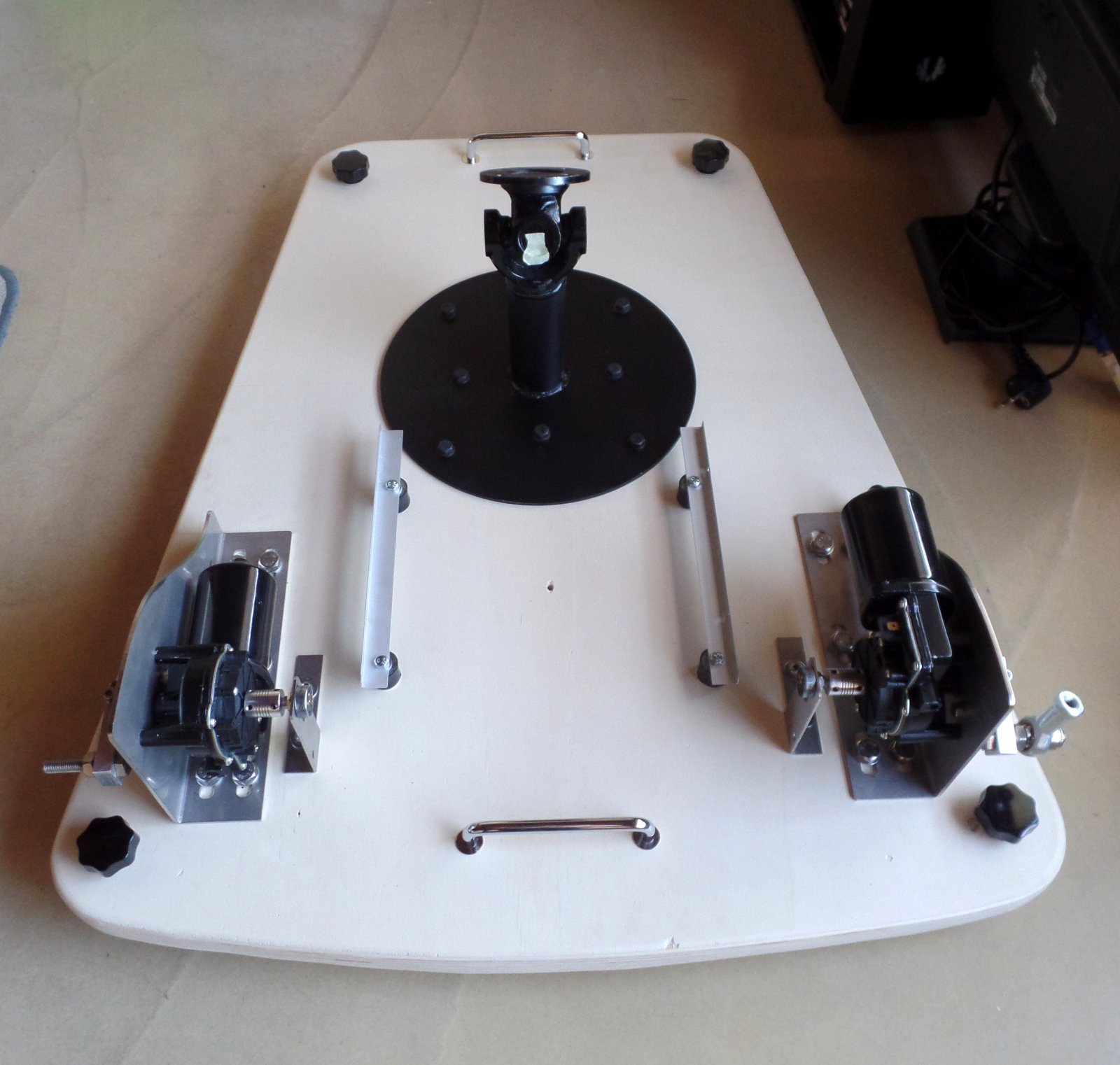

    It's time for the seat supports and engine supports!!

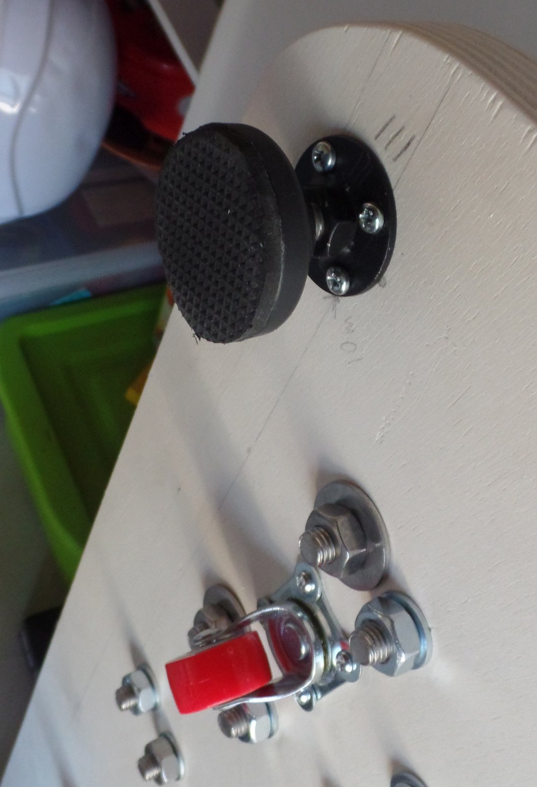

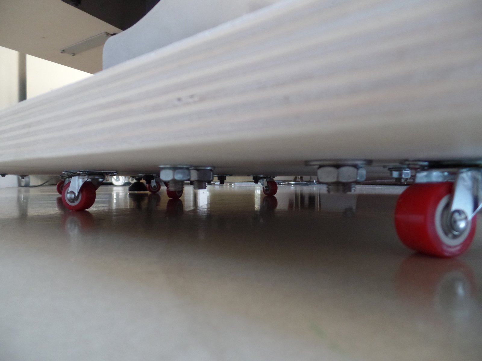

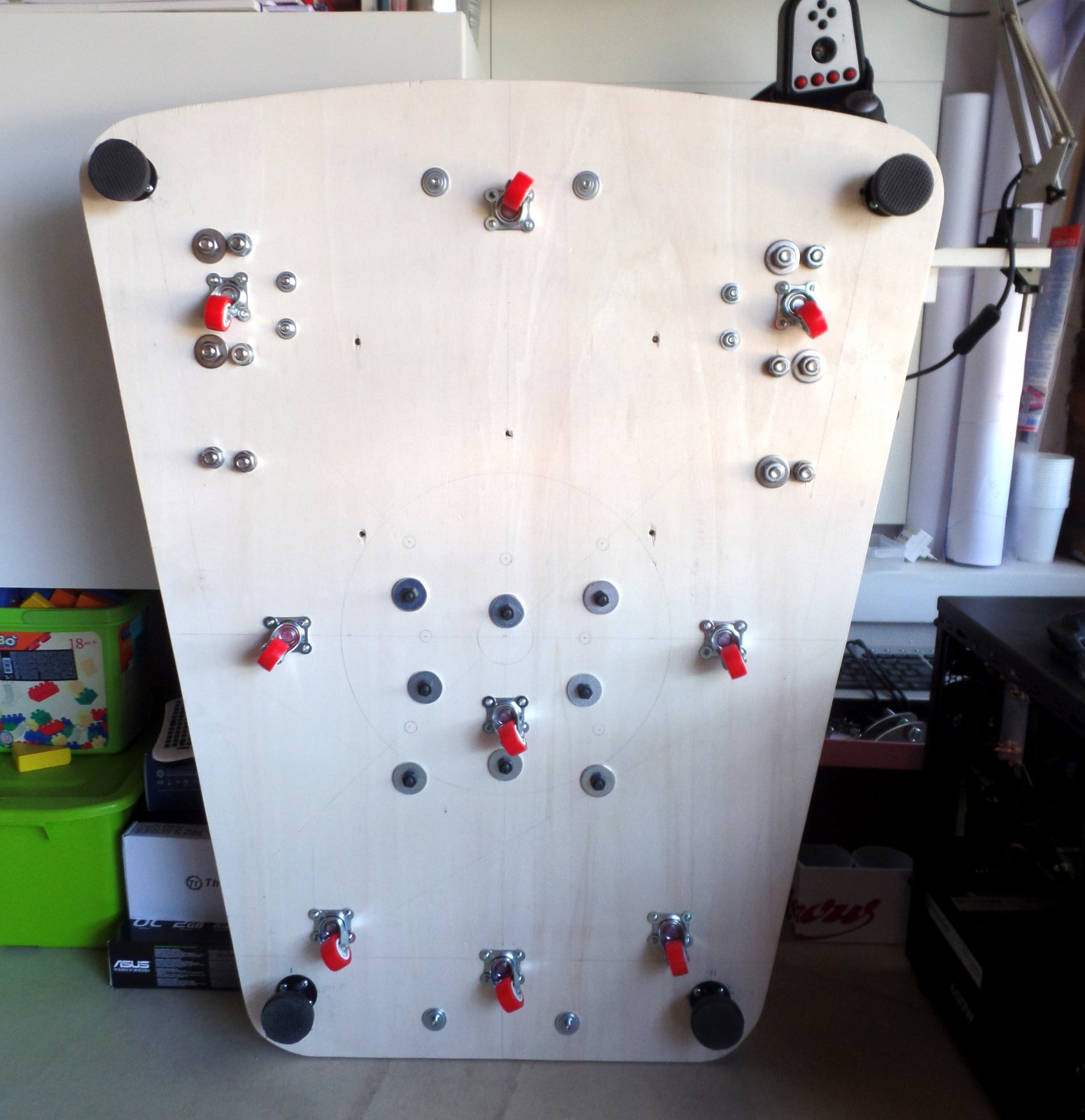

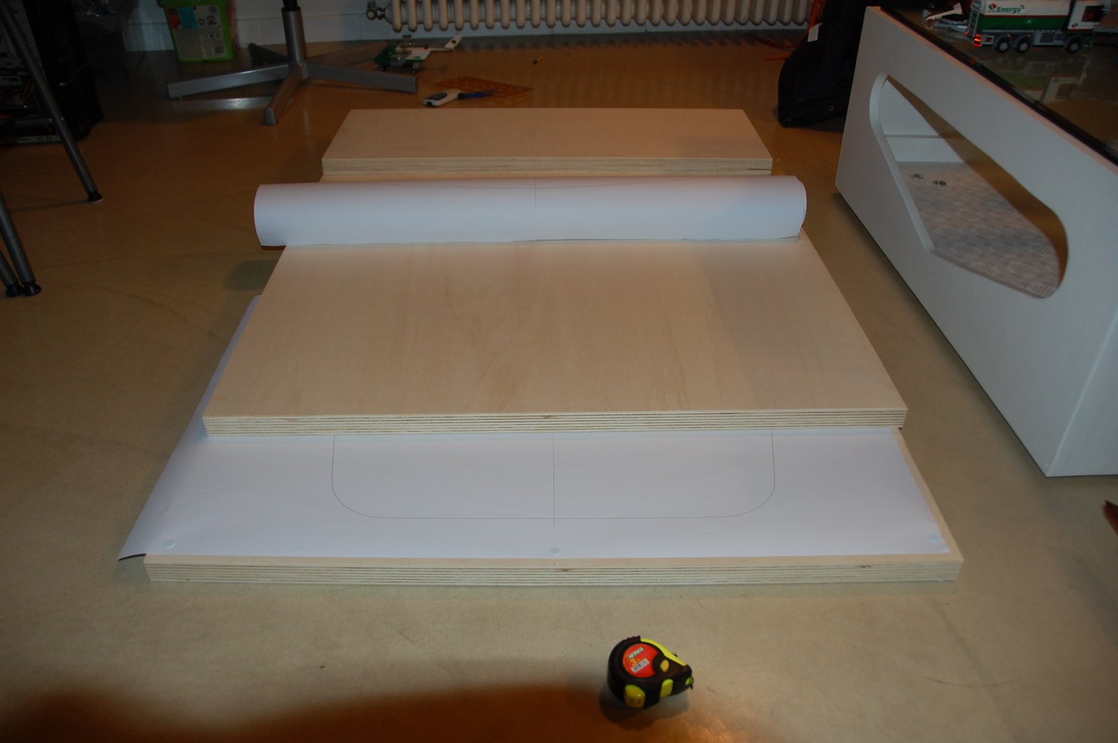

    I need to be able to move the sim to clean room.I mount a set of pivoting wheels and 4 screw
    stabilizers in the corners of the base, produced using electrical panel knobs, floating floor feet,

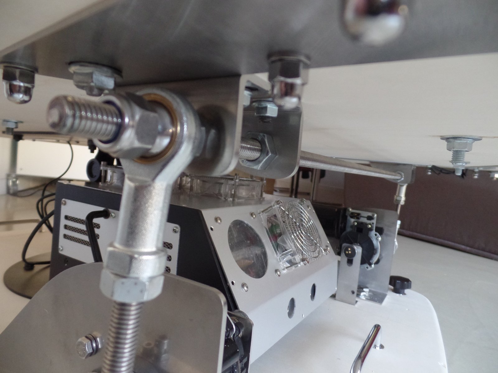

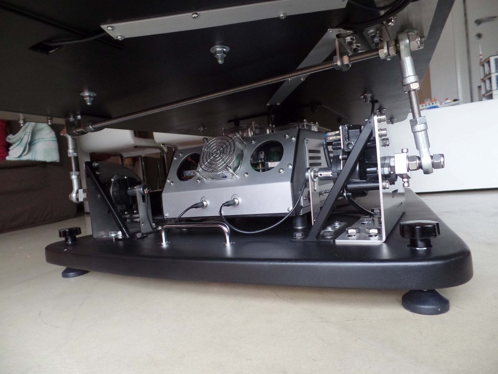

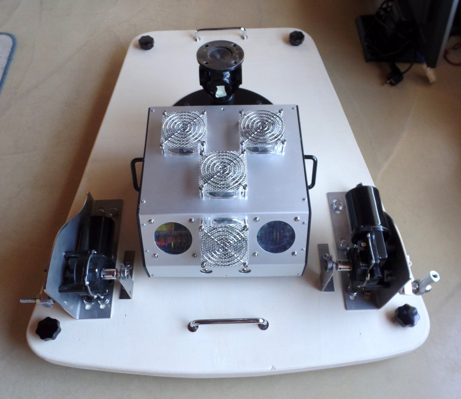

    The joint. I used a large gimbal, with two large attachment bases in order not to have a false yaw effect generated by the action of the motors.
    The sim takes shape !! ... a 1970s detail, it is a hole for the steering wheel cables. It is made with a piece of door draft excluder.

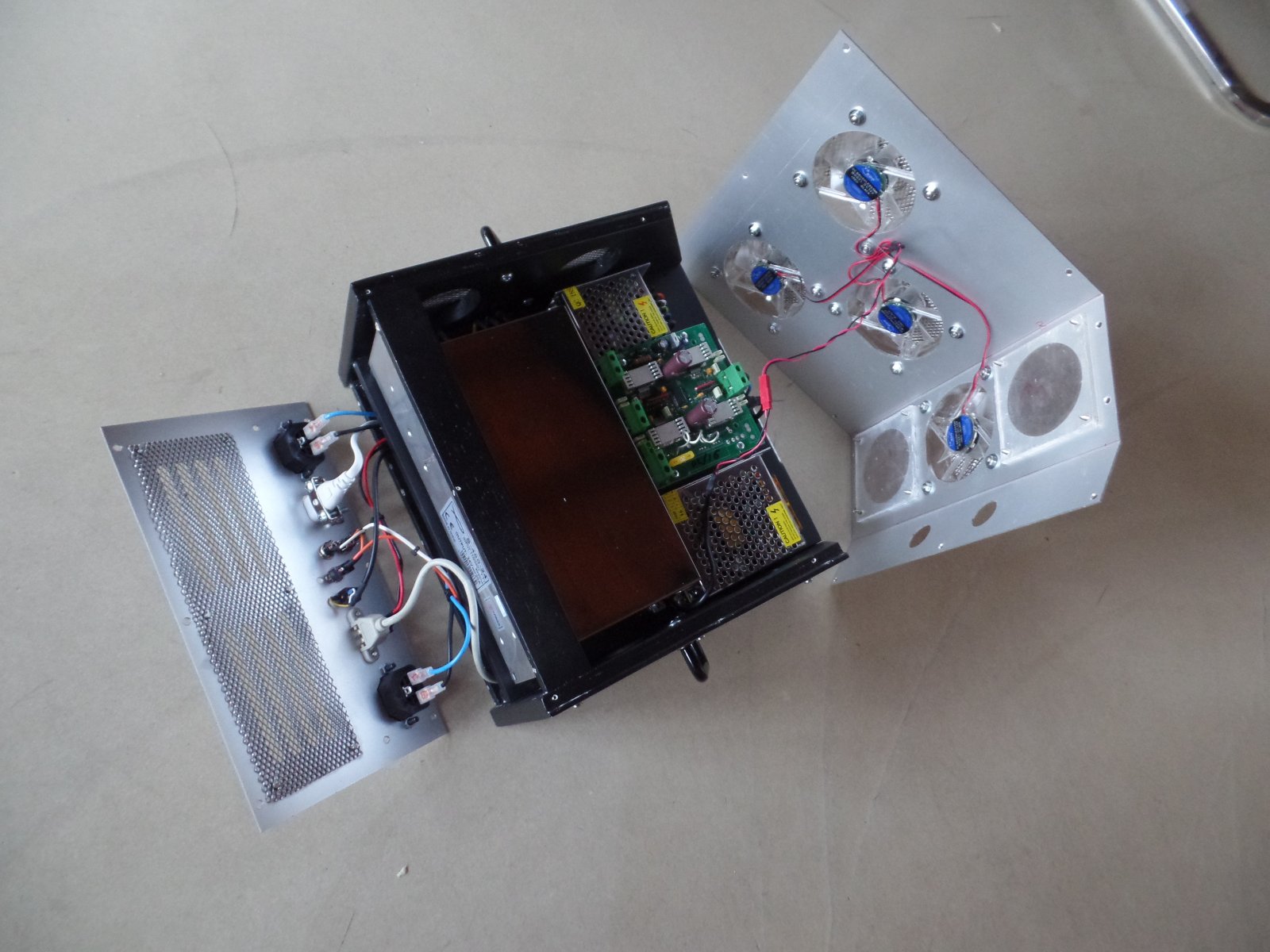

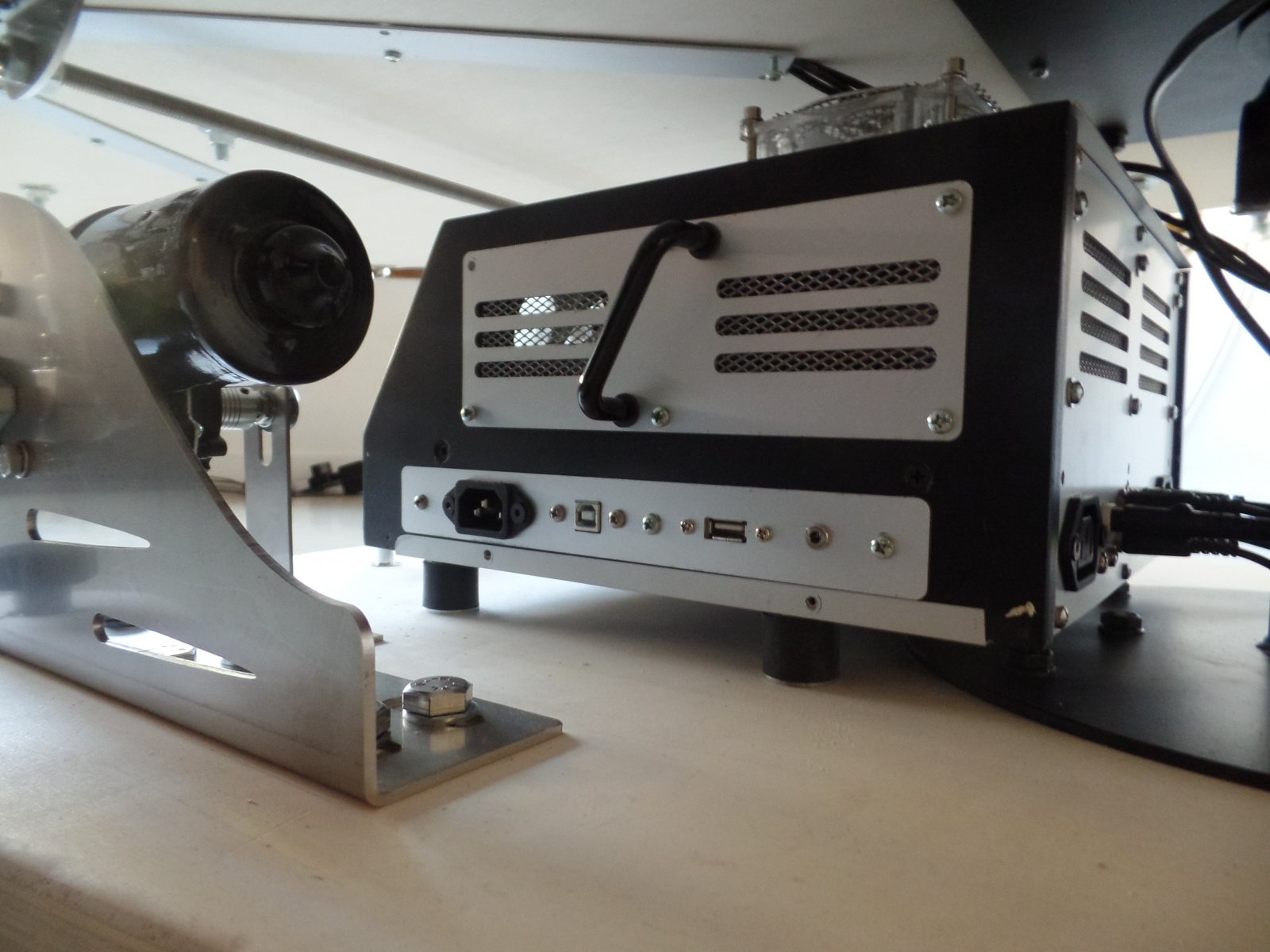

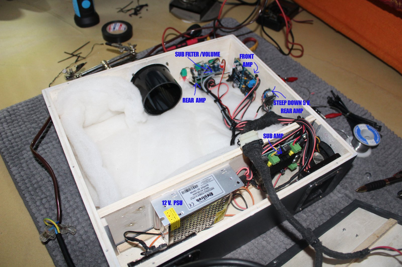

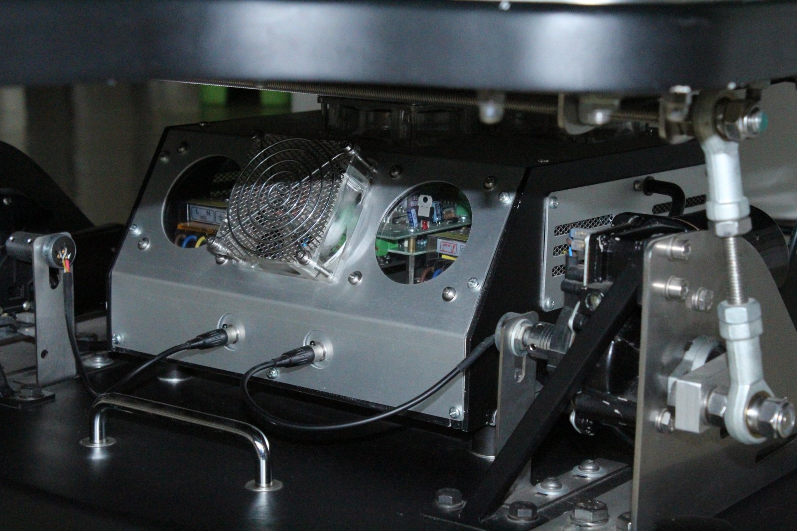

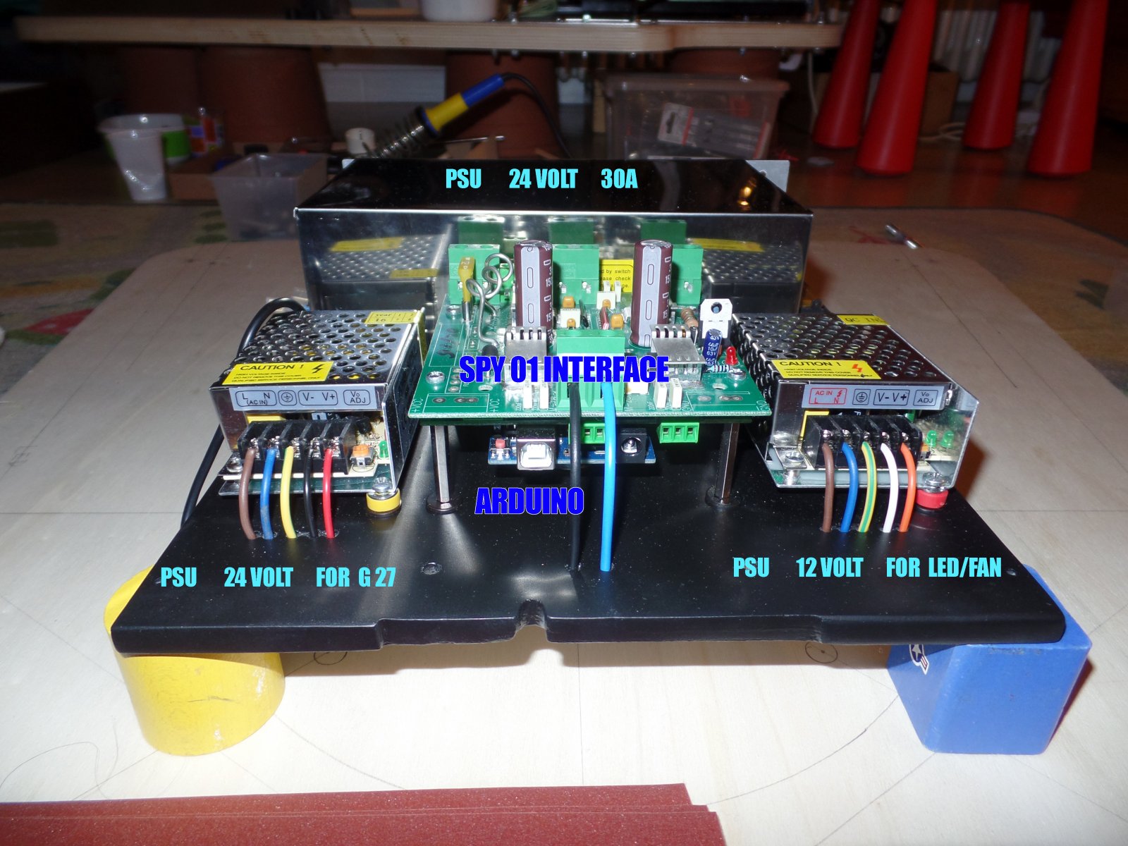

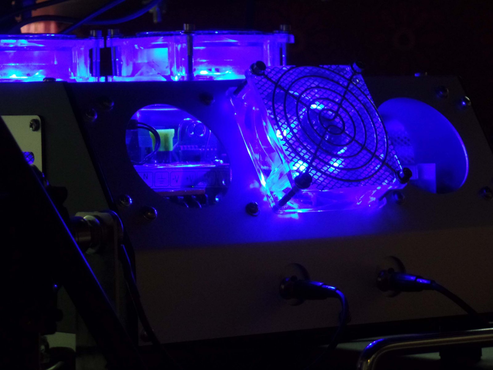

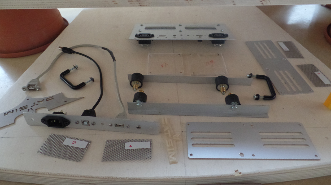

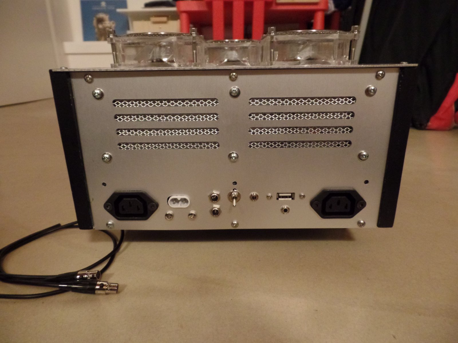

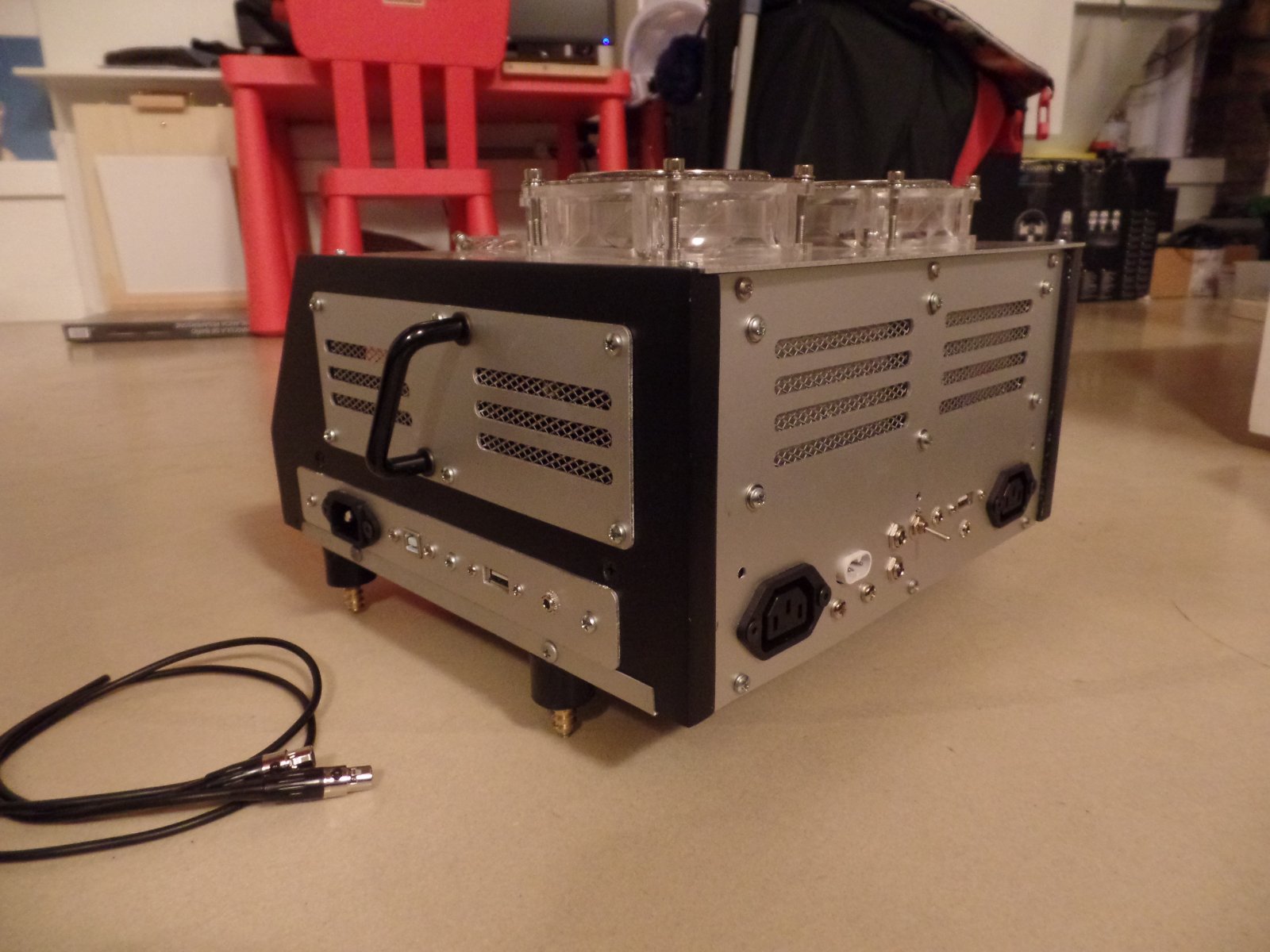

    There remains only the "mind" of the sim to do. These are the aluminum pieces of the electronics box
    This is inside
    Finished and placed box

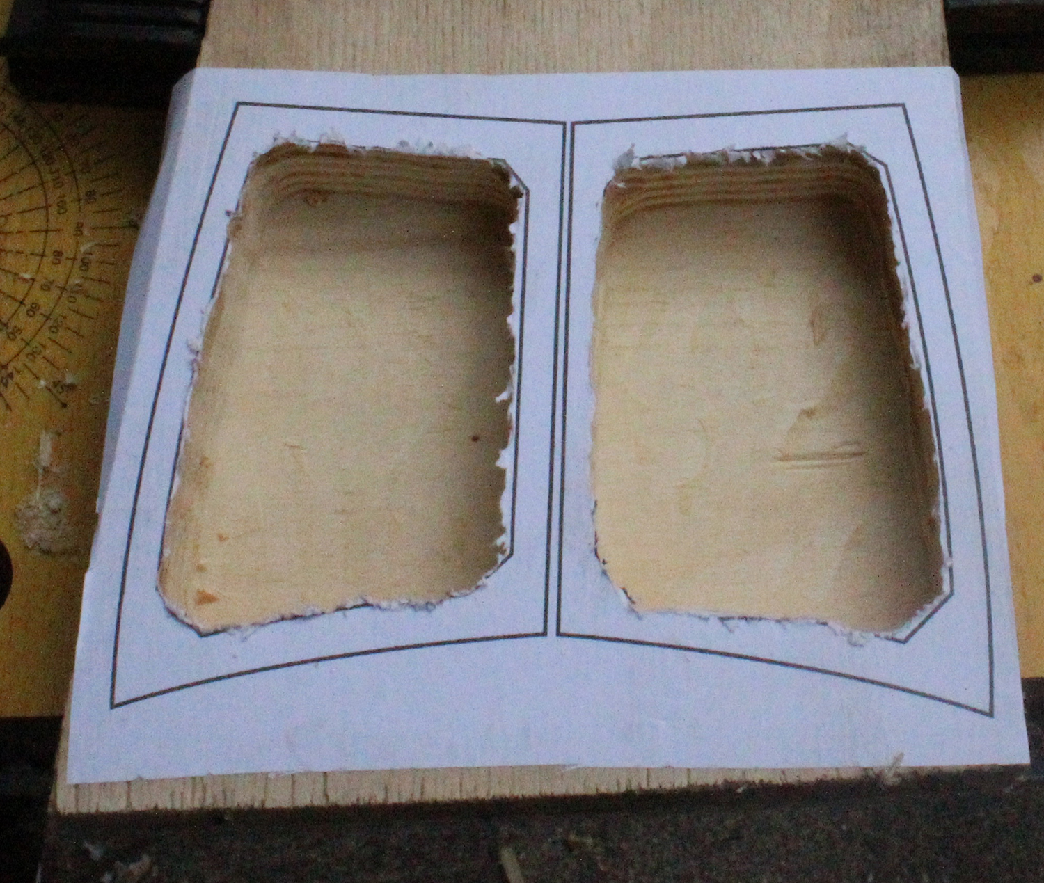

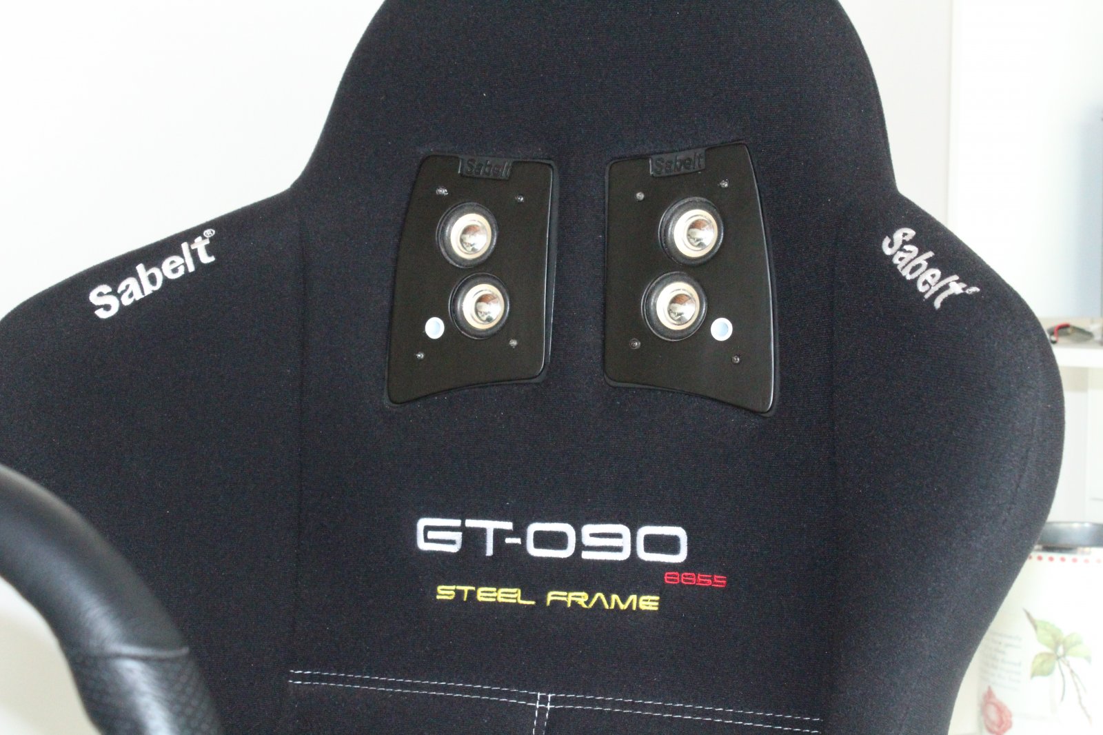

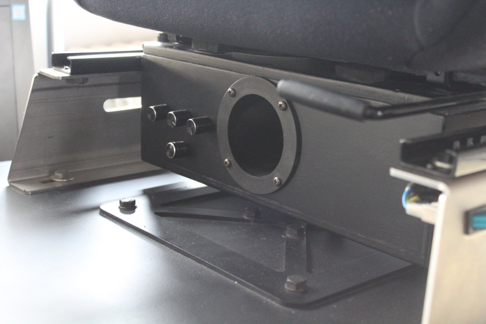

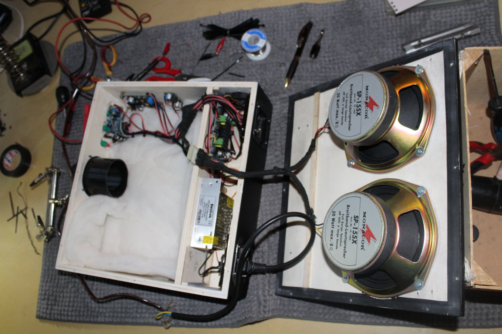

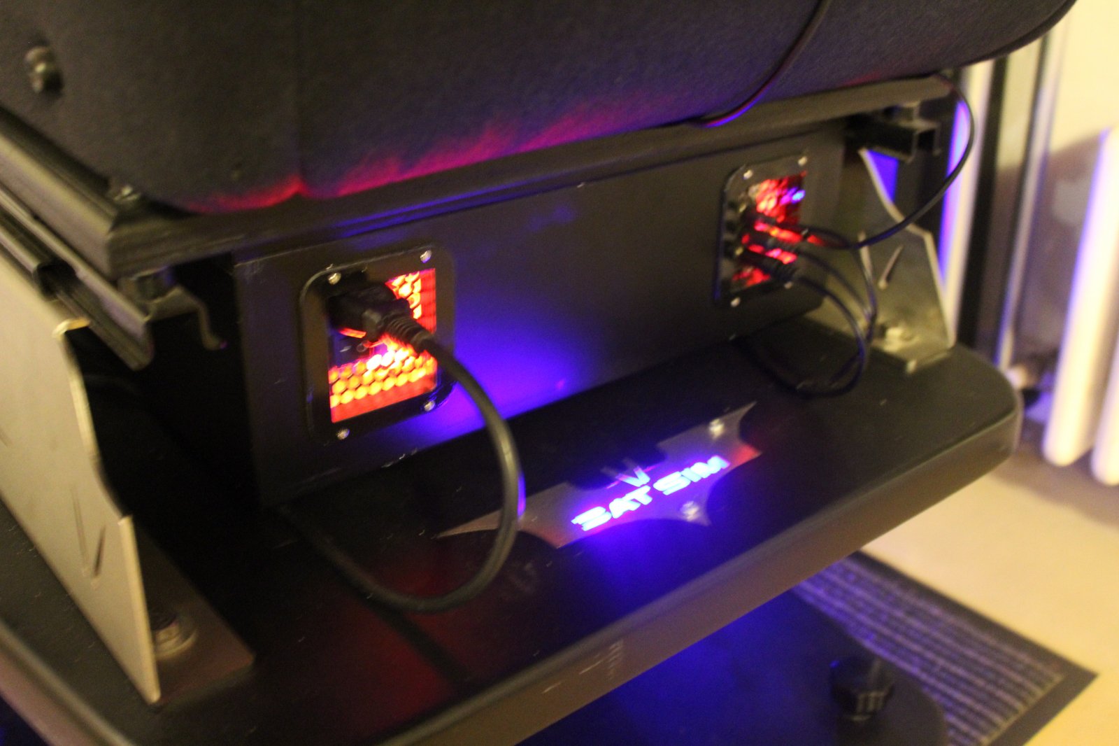

    Sound system:
    I mounted a subwoofer box under the seat. There are also amplifiers inside.
    Sub also returns some vibrations to the seat .. like a vibe ... less ... but there are!

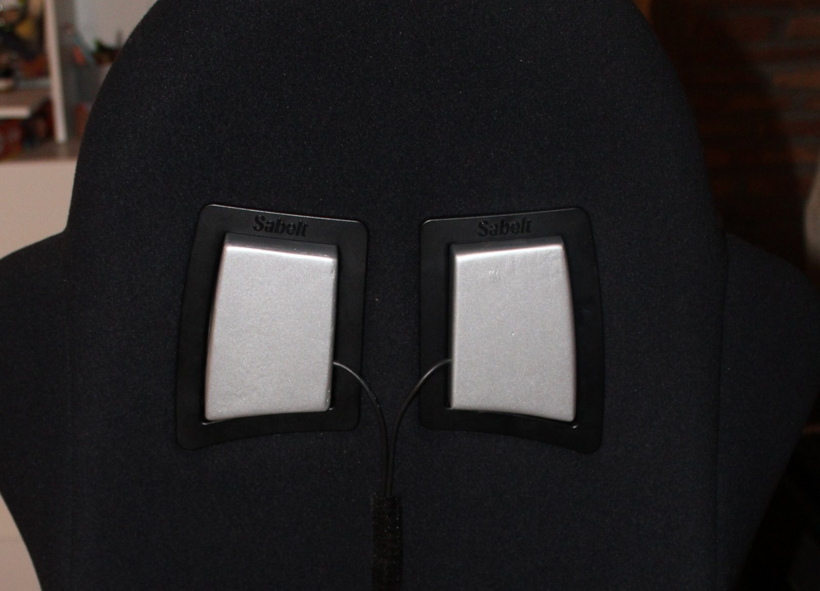

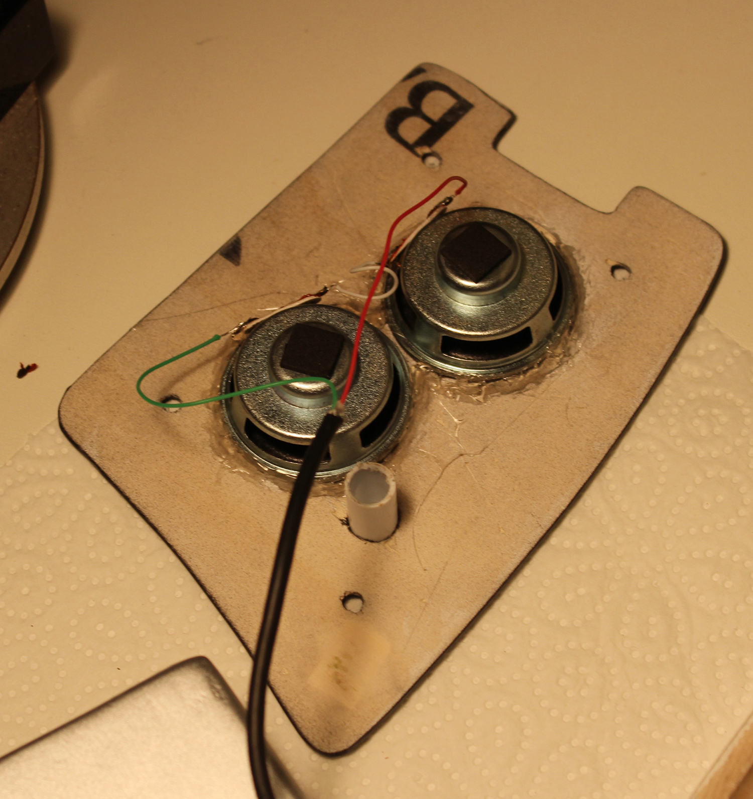

    ..... 2 satellites near the pedals

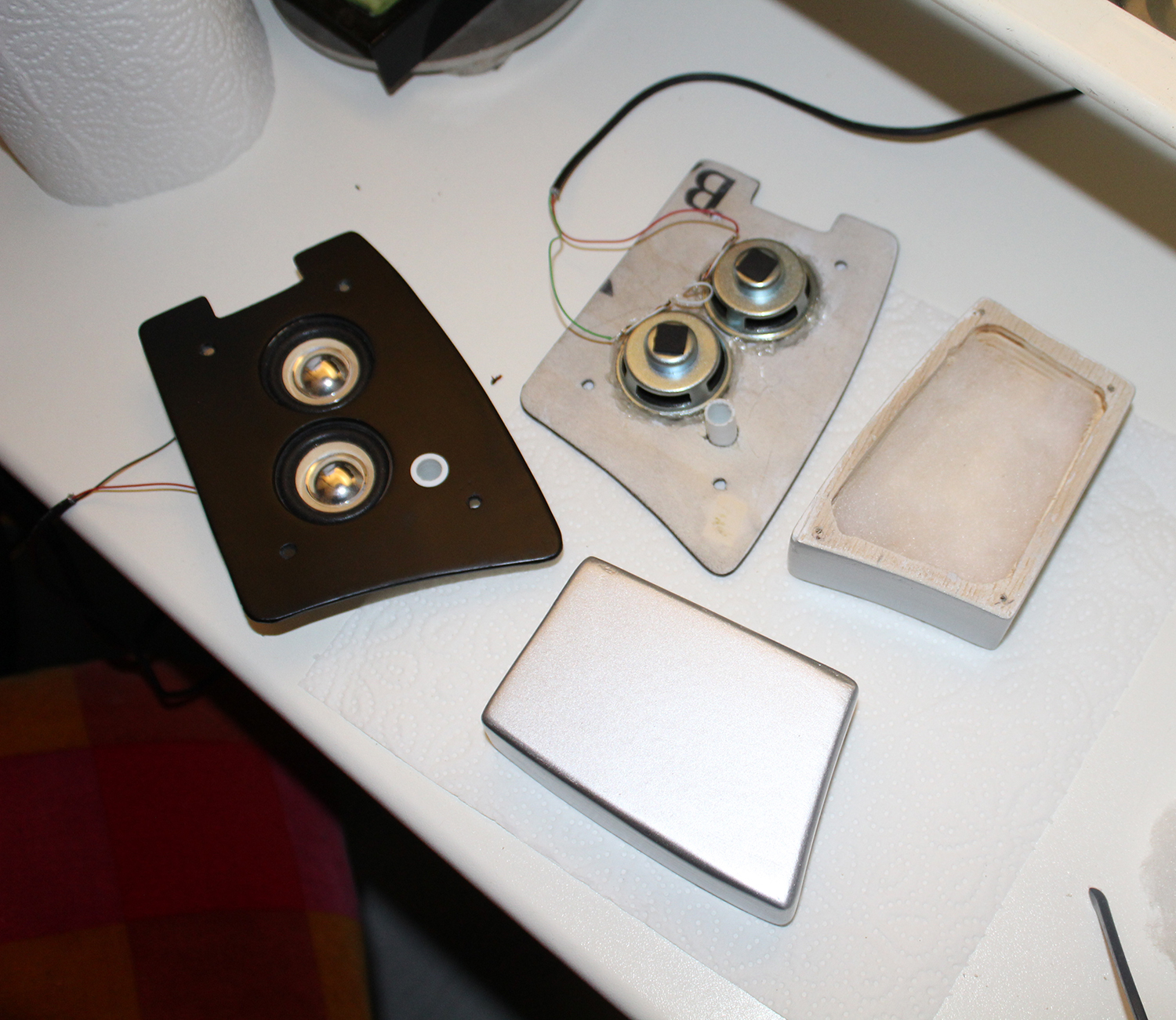

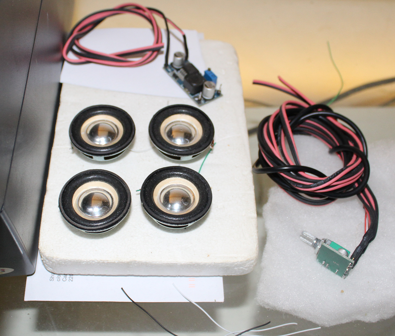

    and 2 DIY in the seat..
    IMG_8637.JPG IMG_8553.JPG IMG_8527.JPG IMG_8528.JPG IMG_8535.JPG IMG_8542.JPG IMG_8543.JPG

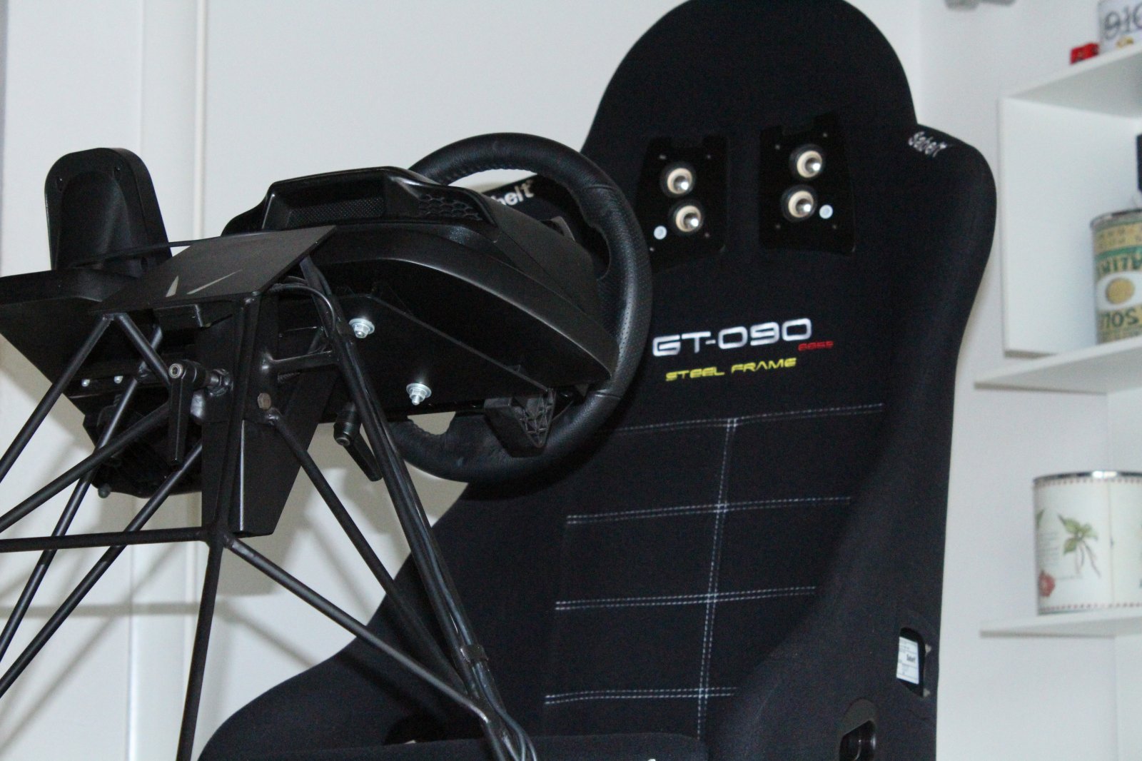

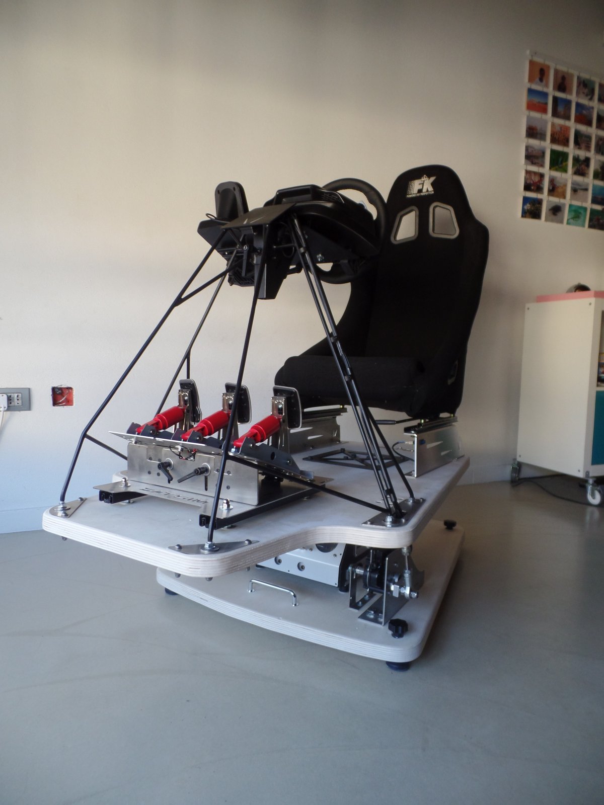

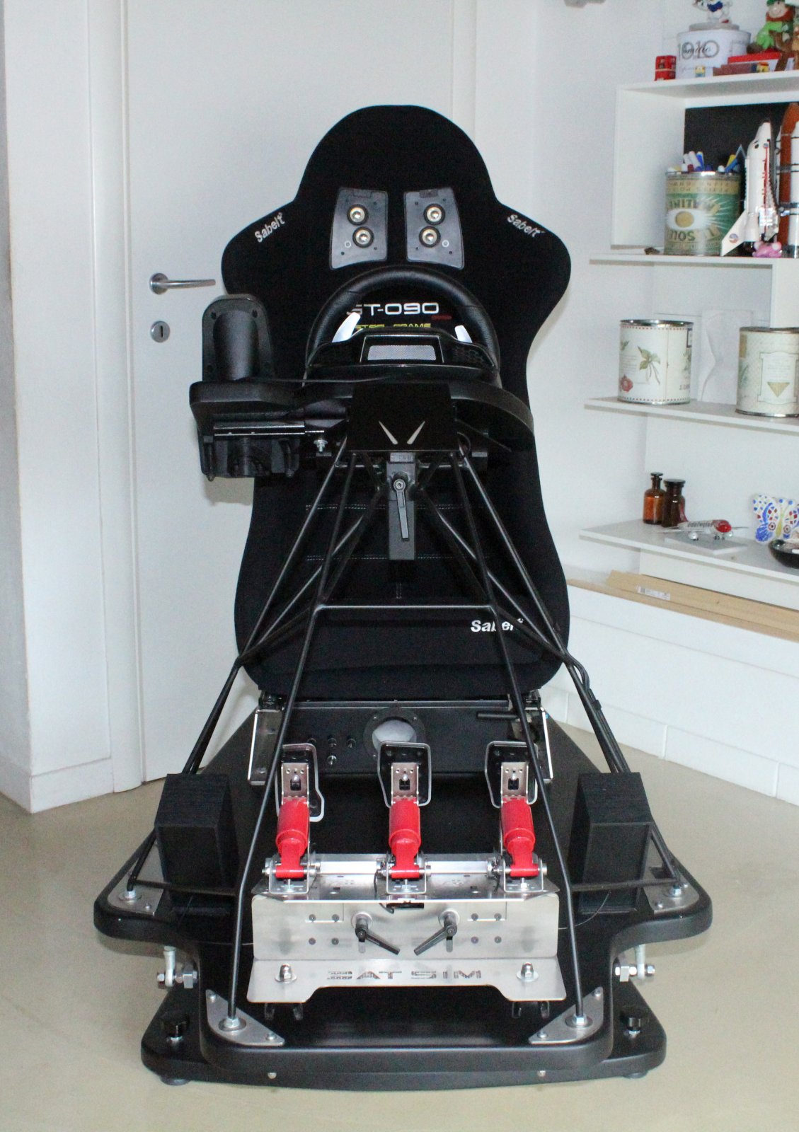

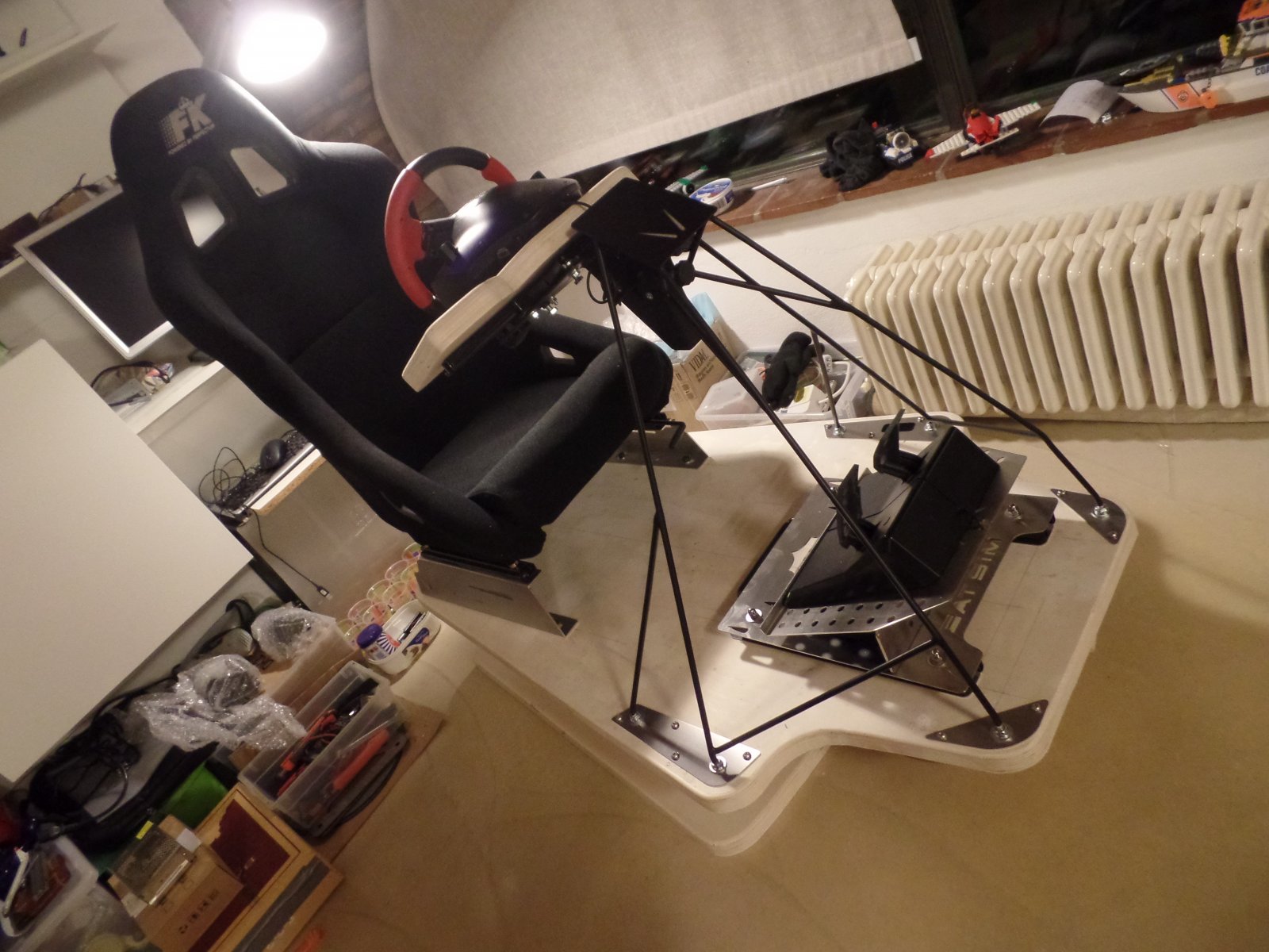

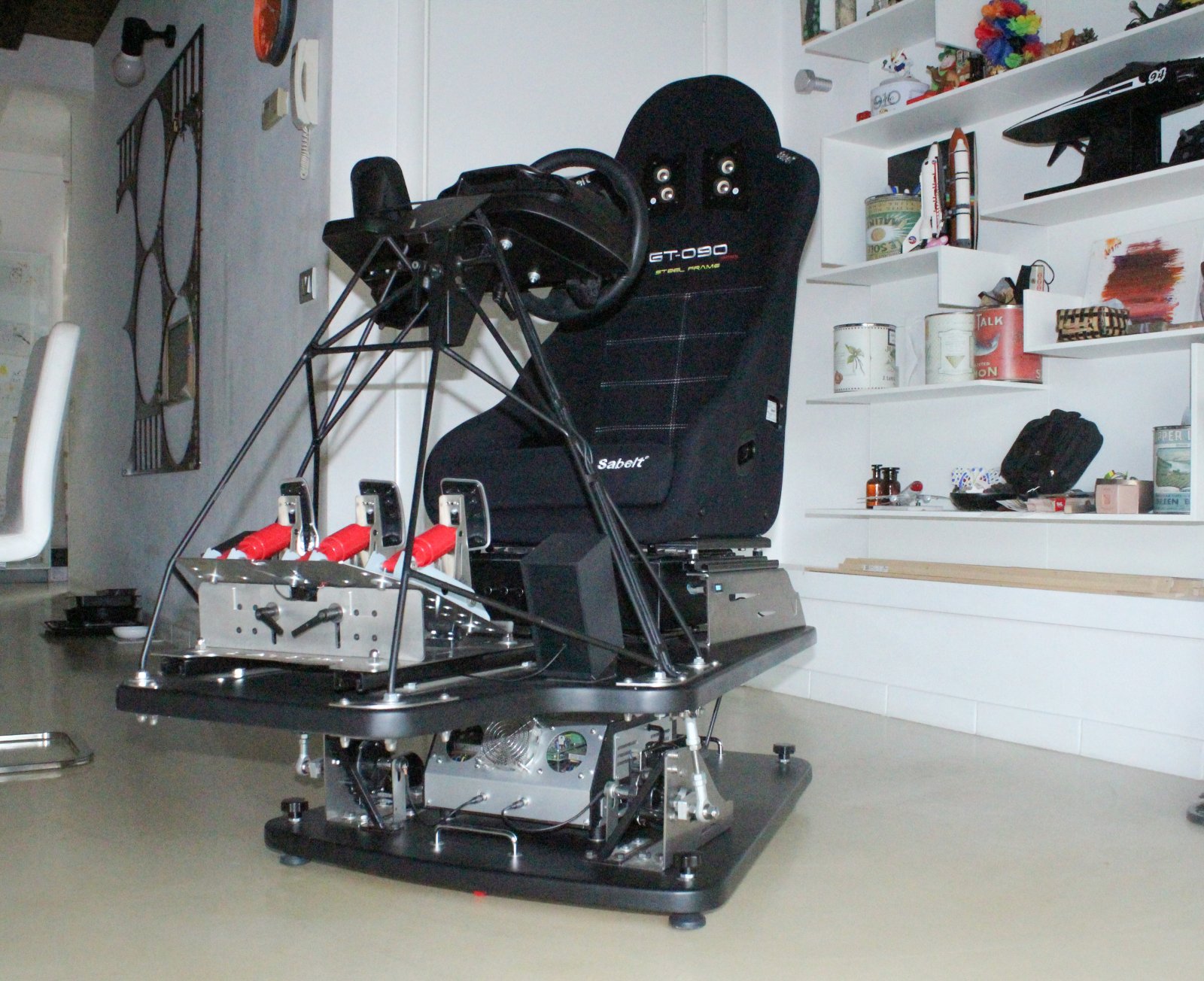

    And here is the finished sim! I had to change the seat because the Fk seat (used during construction)
    creaked like a bed fromthe 1800s.
    SAM_3541.JPG SAM_3551b.jpg SAM_3554.JPG SAM_3560.JPG The Sabelt seat is a steel frame and is silent.... even more beautiful.
