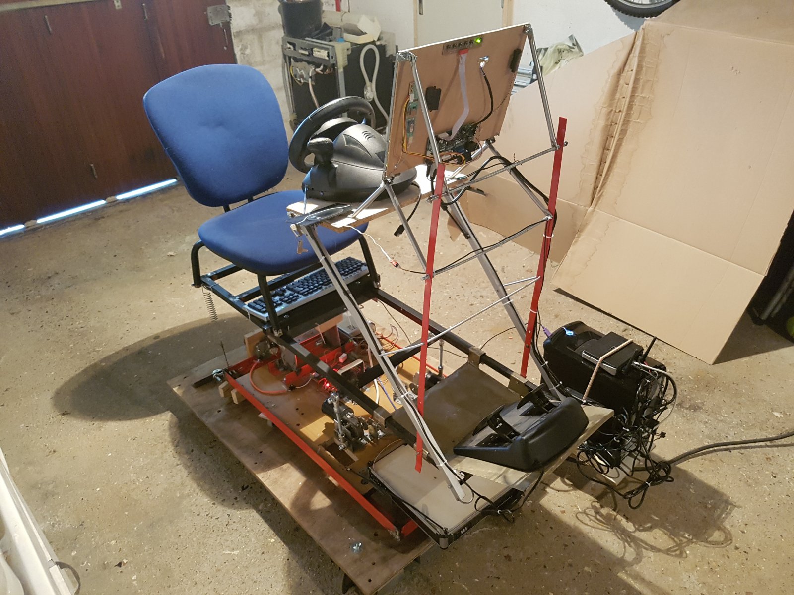

    I have more preference for comfort than for safety.

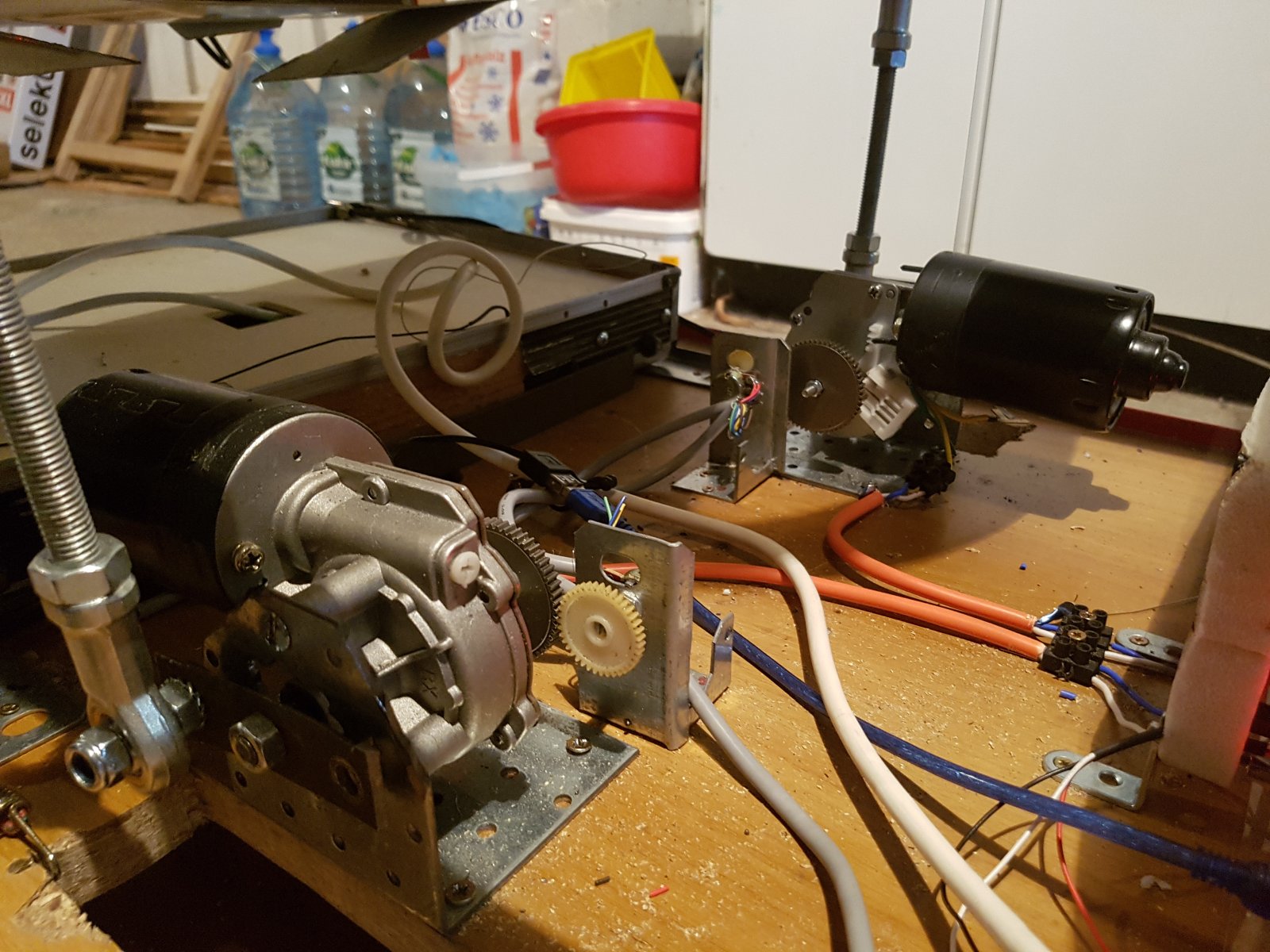

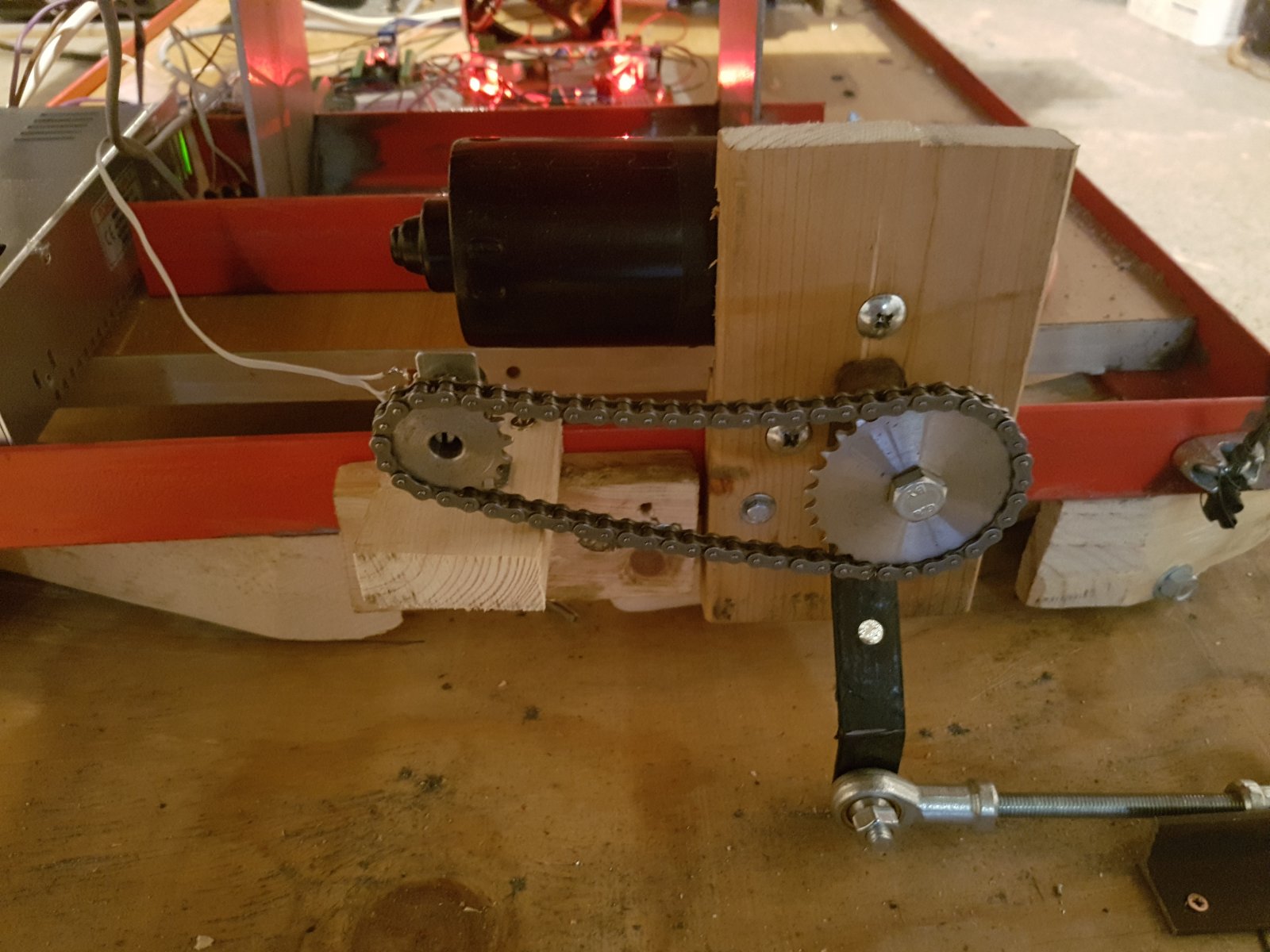

    What type of DC motor did you use? How Many NM, RPM?
  4. hoyang
    hoyang handyman
    Dec 14, 2017
    94
    Bricoleur
    1,337Coins
    +93 / 0 / -0
    I used 12v wiper motors.
    they are not very powerful but they are doing their job for the moment.
    I think to change the engines later.

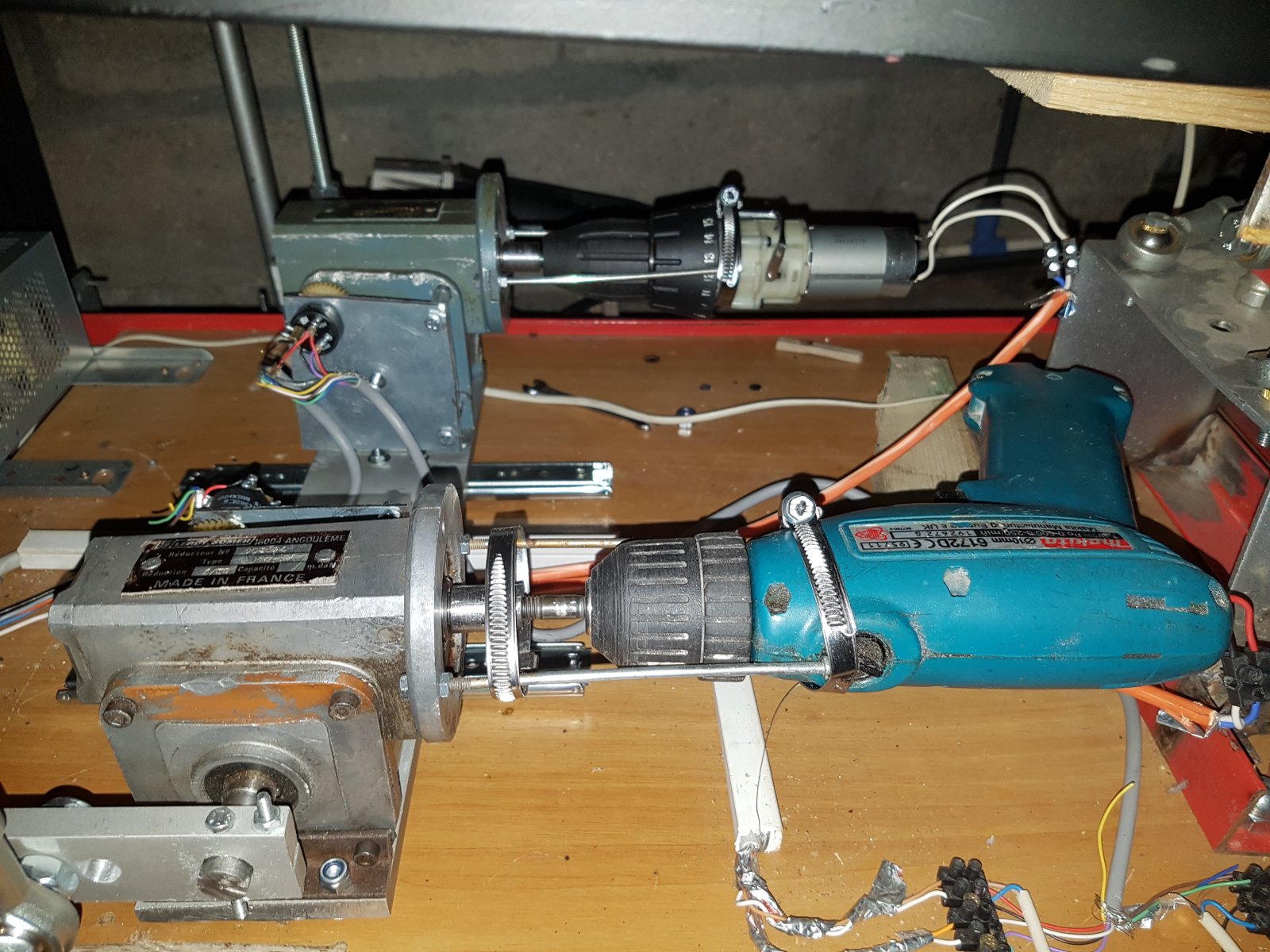

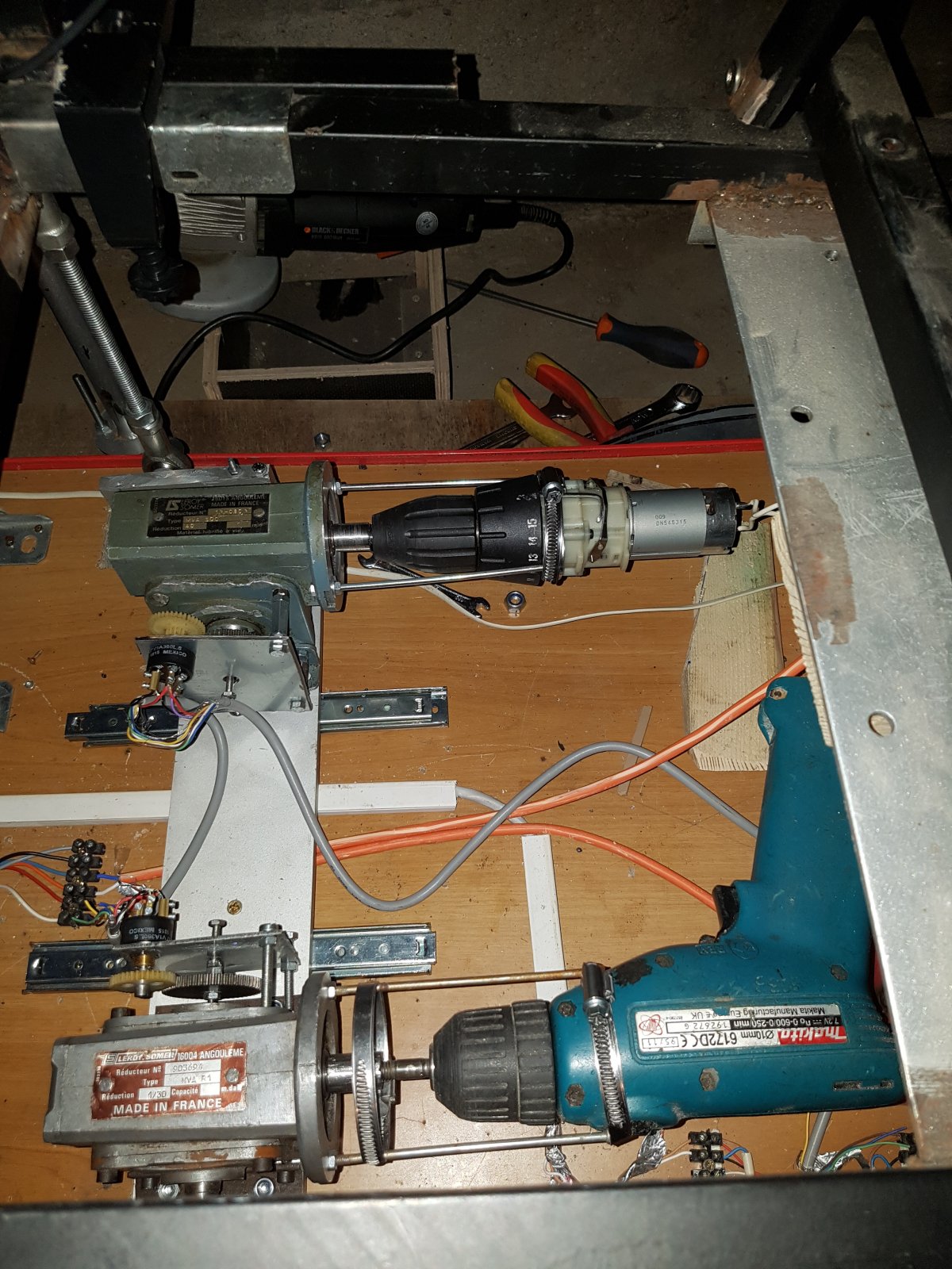

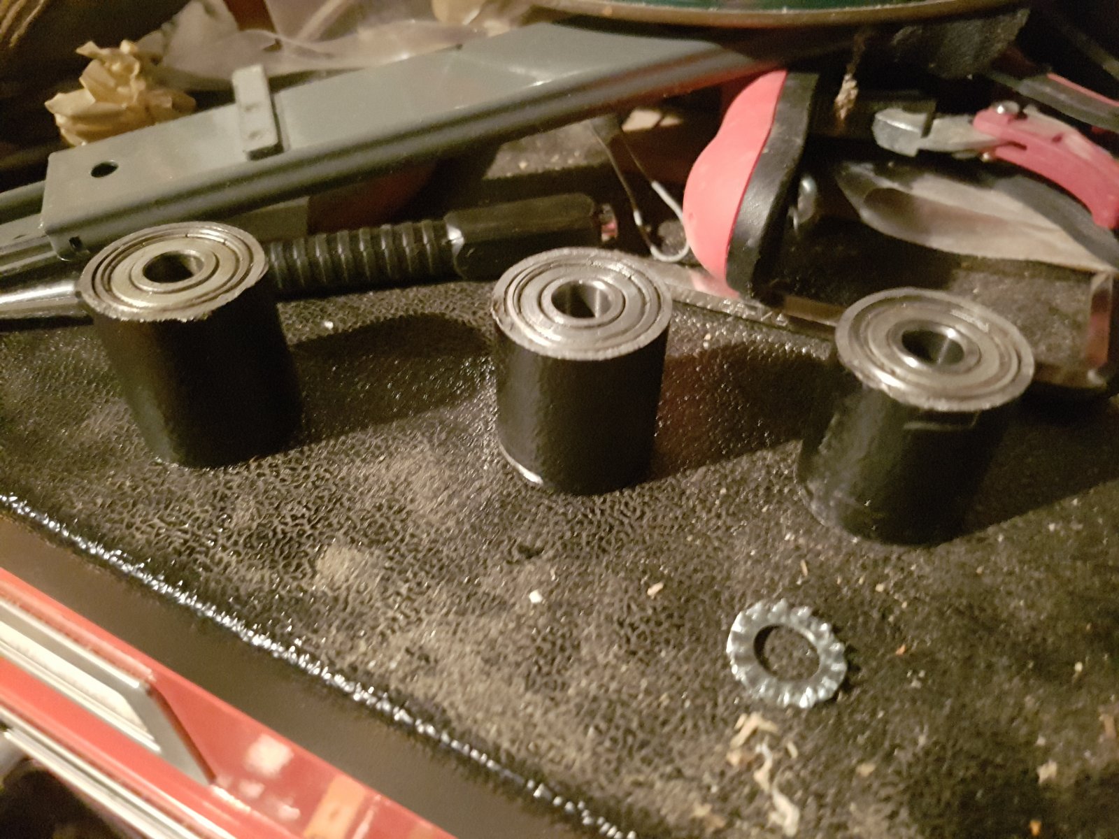

    when destiny offers you reducers. A few months ago, I found in a bin three-phase motors. Their winding was down.
    So I recovered the reducers to fit my stimulator. 20190418_212340.jpg 20190418_212321.jpg

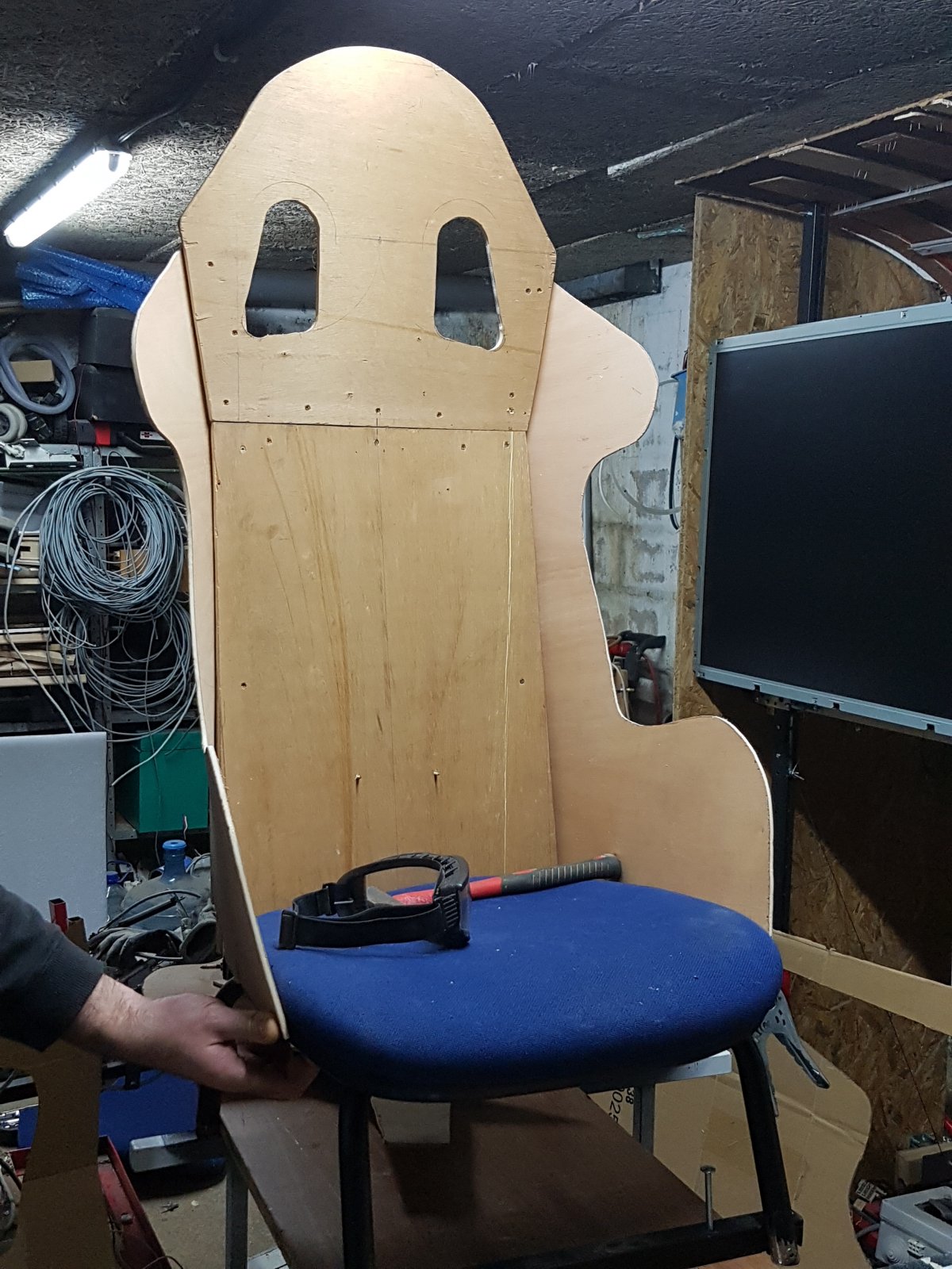

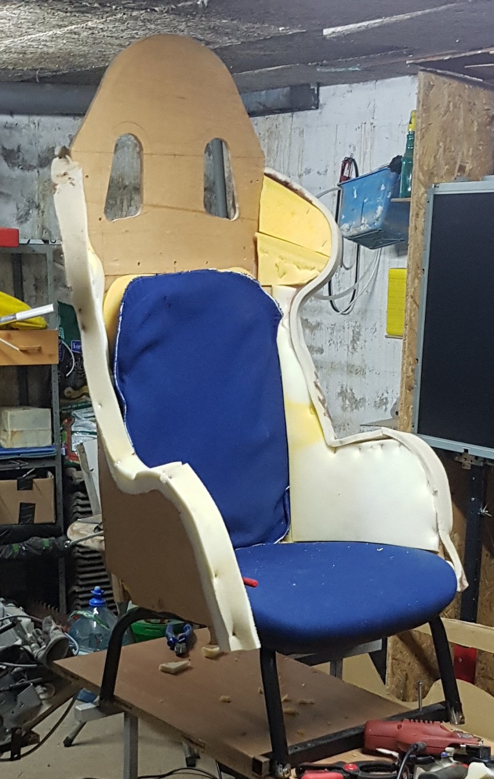

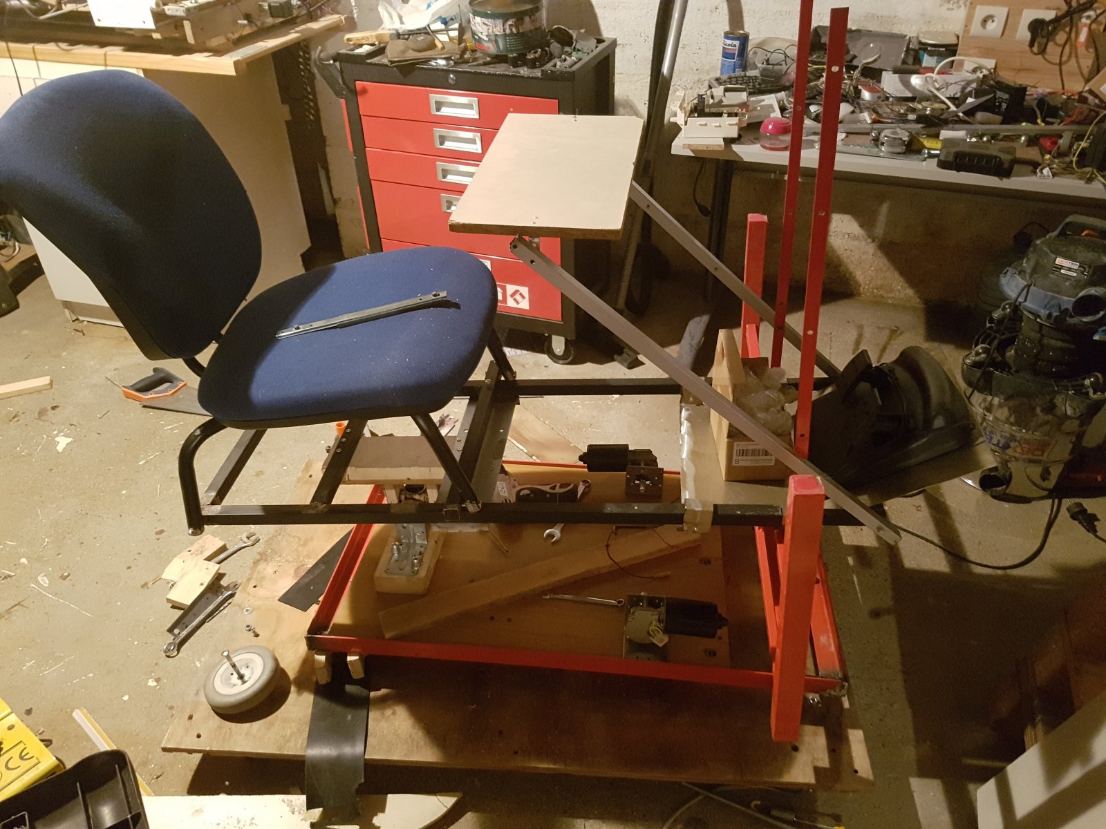

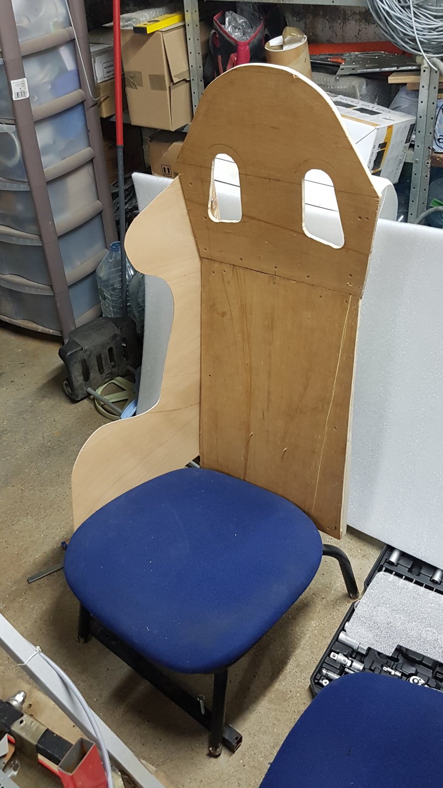

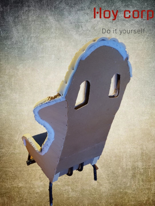

    construction of a bucket seat for my simulator.

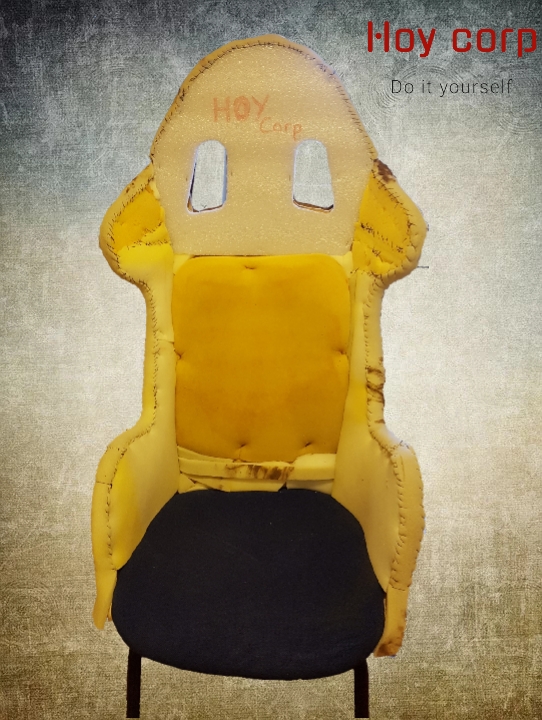

    weekend activity:
    installation of honeycomb foam (protective foam) on the sides and seat backs.
    foam assembly and shaping.

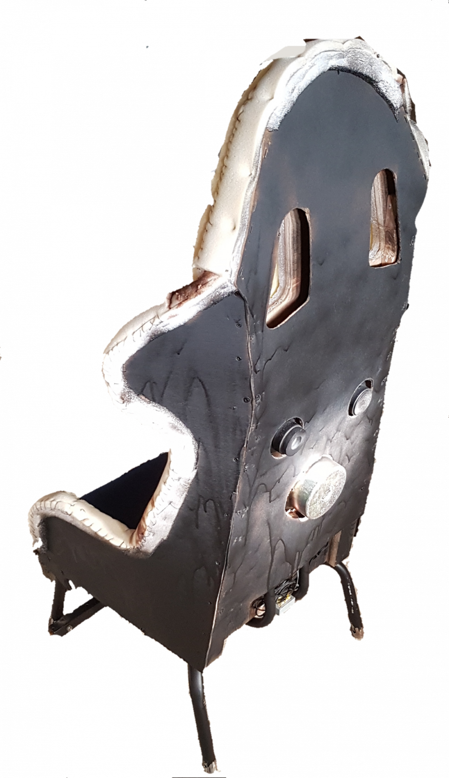

    rear view and construction of a seat cover

    You are a wizadrd to me :eek: what ... does the simulator really work this way? If so what gearbox/reducer ratio are you prefer? WoW.

    thank you very much, the reducers have a 1/30 ratio, yes the simulator works like this but it will require 2 motor a little faster (1500 rpm) because with 850 rpm there is a small loss of sensations on certain effect .

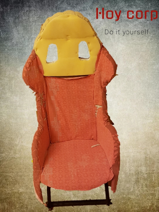

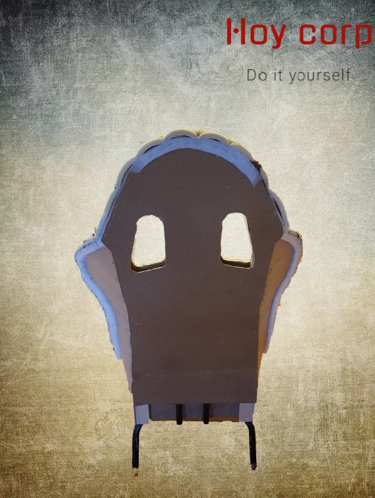

    following the construction of my seat back realization of a seat cover and painting of the first layer.

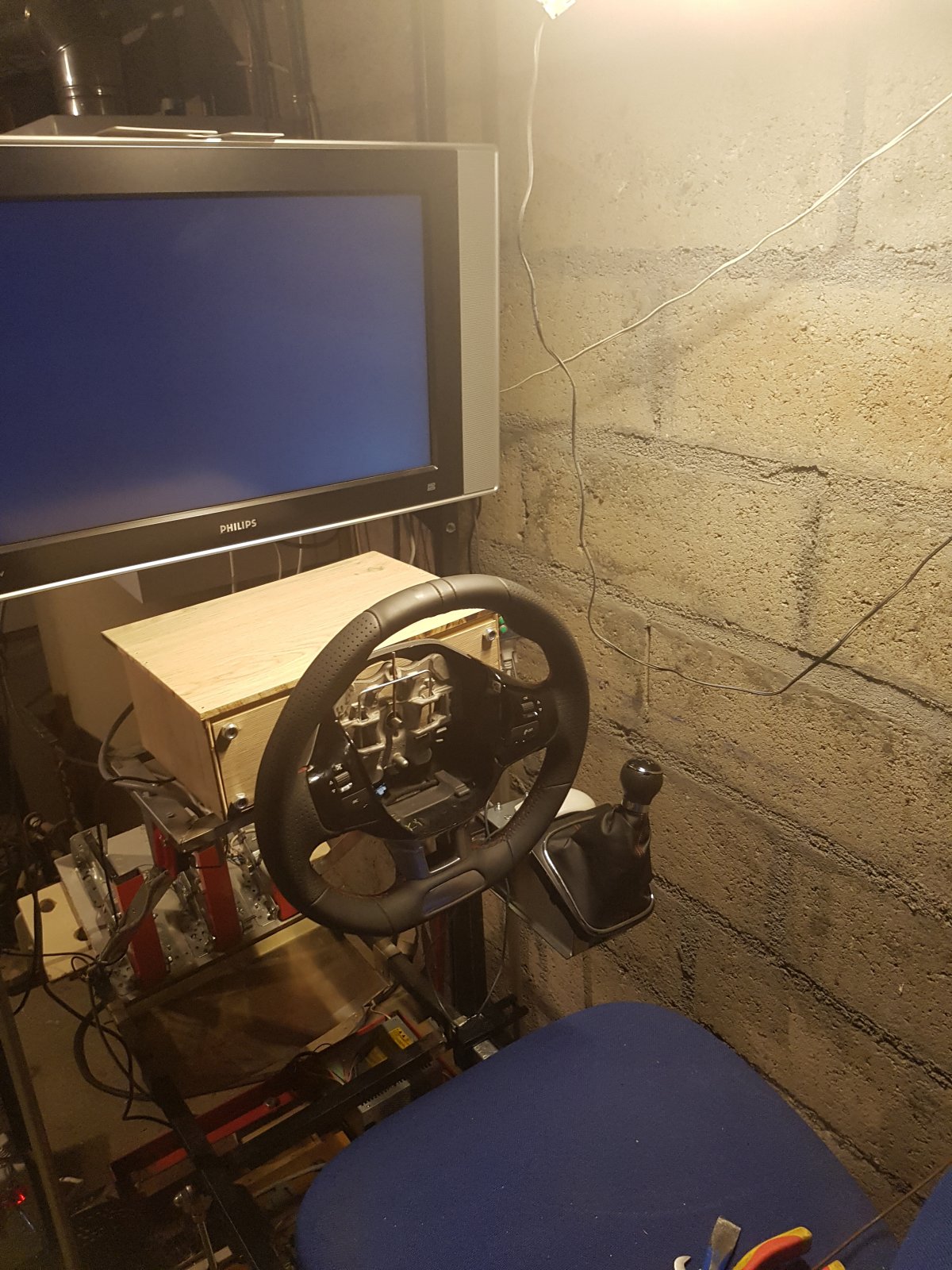

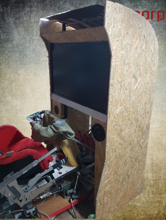

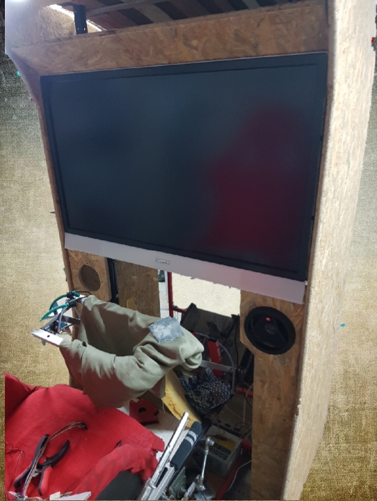

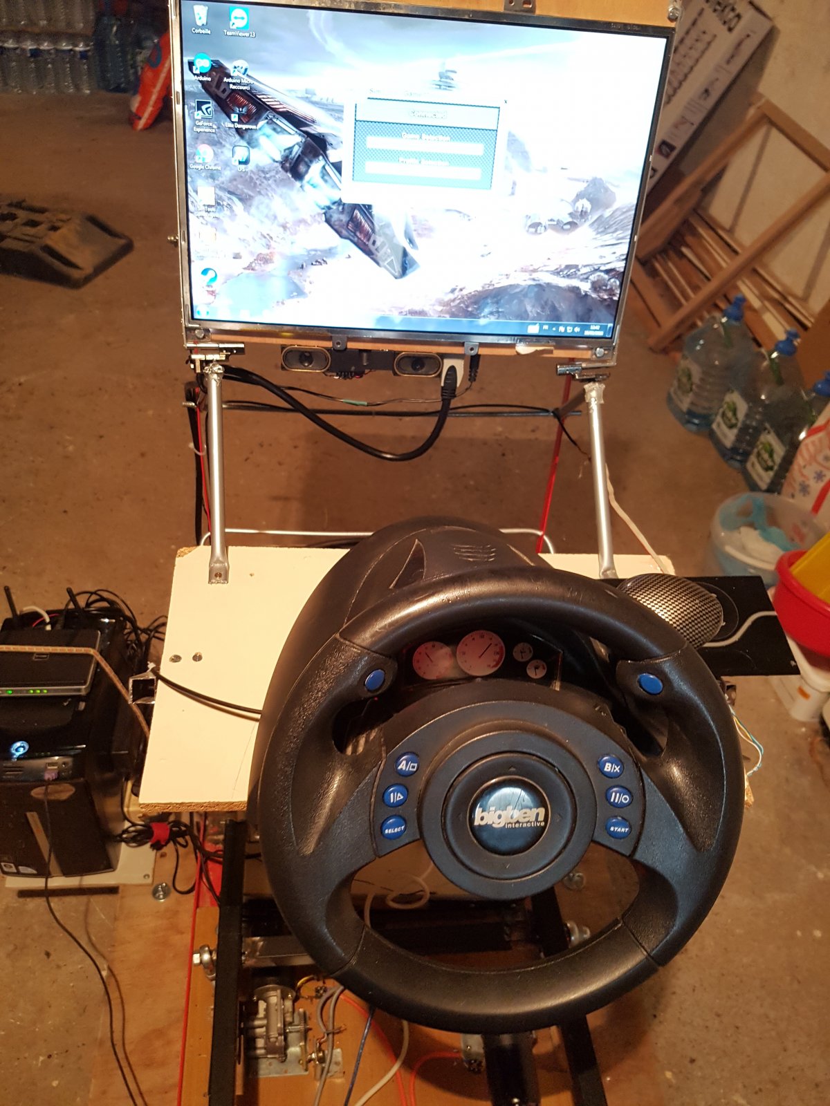

    Replacement of the screen and creation of an arcade style support.

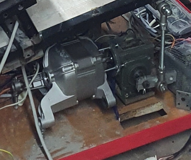

    simulator modification:
    replacement of drill motors with bldc washing machine motors.
  18. hoyang
    hoyang handyman
    Dec 14, 2017
    94
    Bricoleur
    1,337Coins
    +93 / 0 / -0

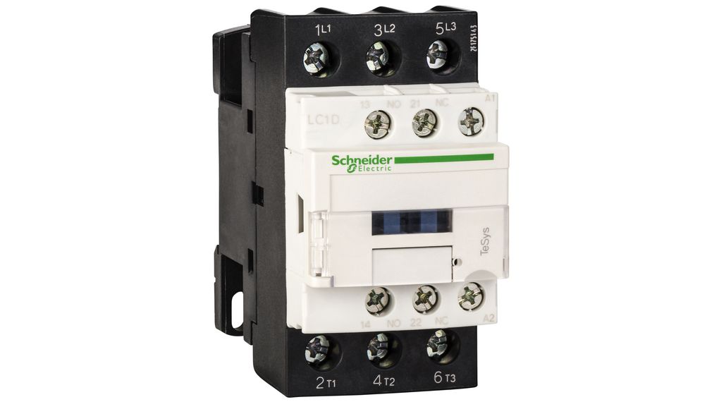

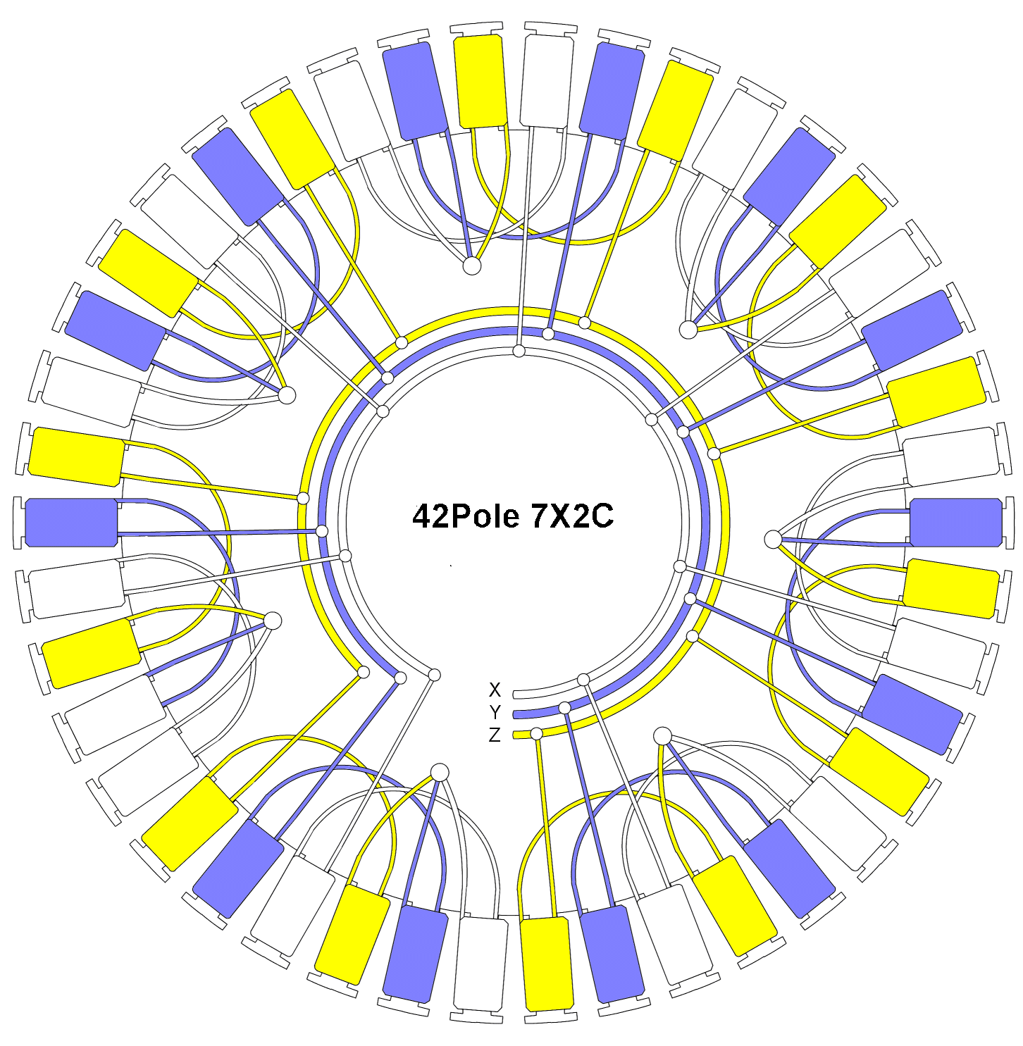

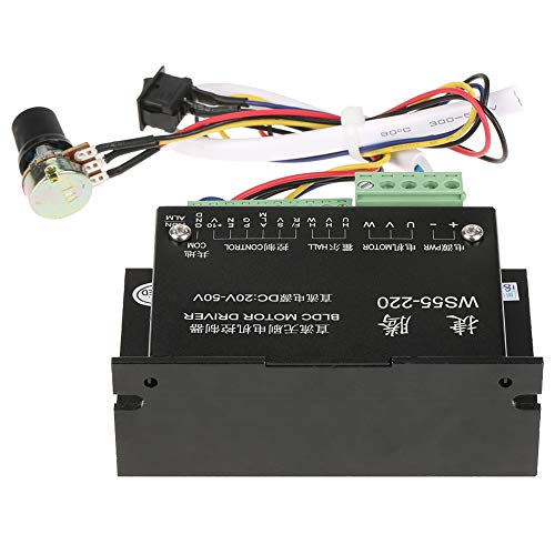

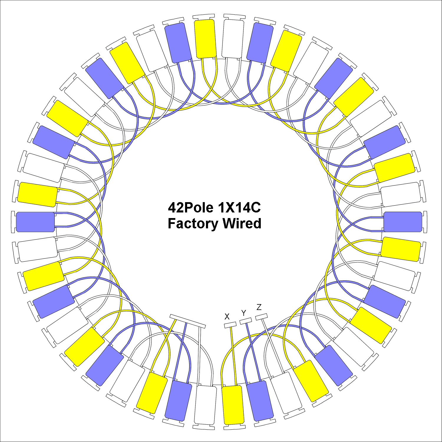

    new motors new wiring to be able to run the new bldc motors I had to modify the stators, because this motor is made to work with 210 v continuous.
    winding modification:
    I bought a bldc motor controller Ws55-220
    and add three-phase contactors for reversing the motor direction, because it is faster than the inverter of the controller
