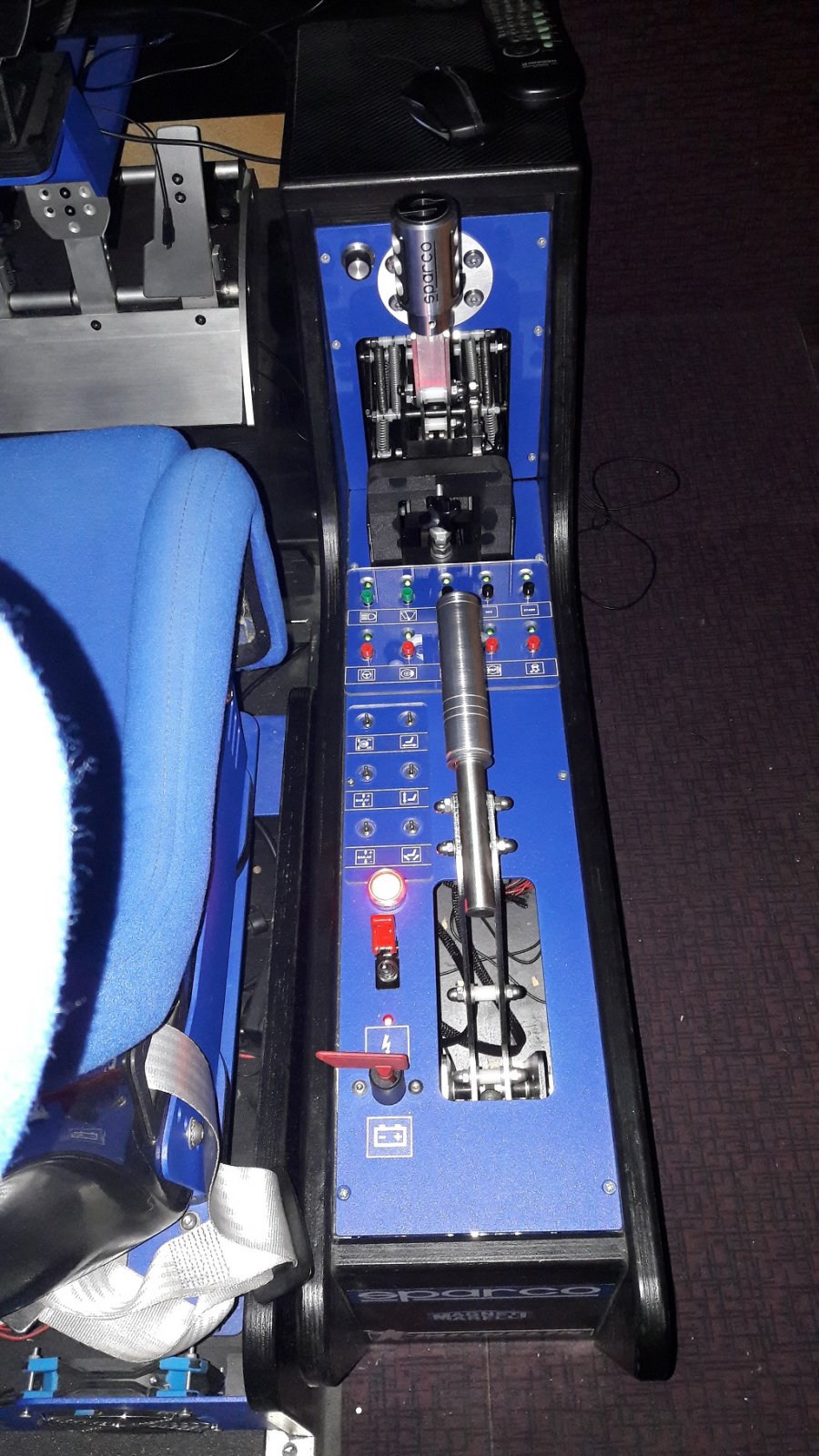

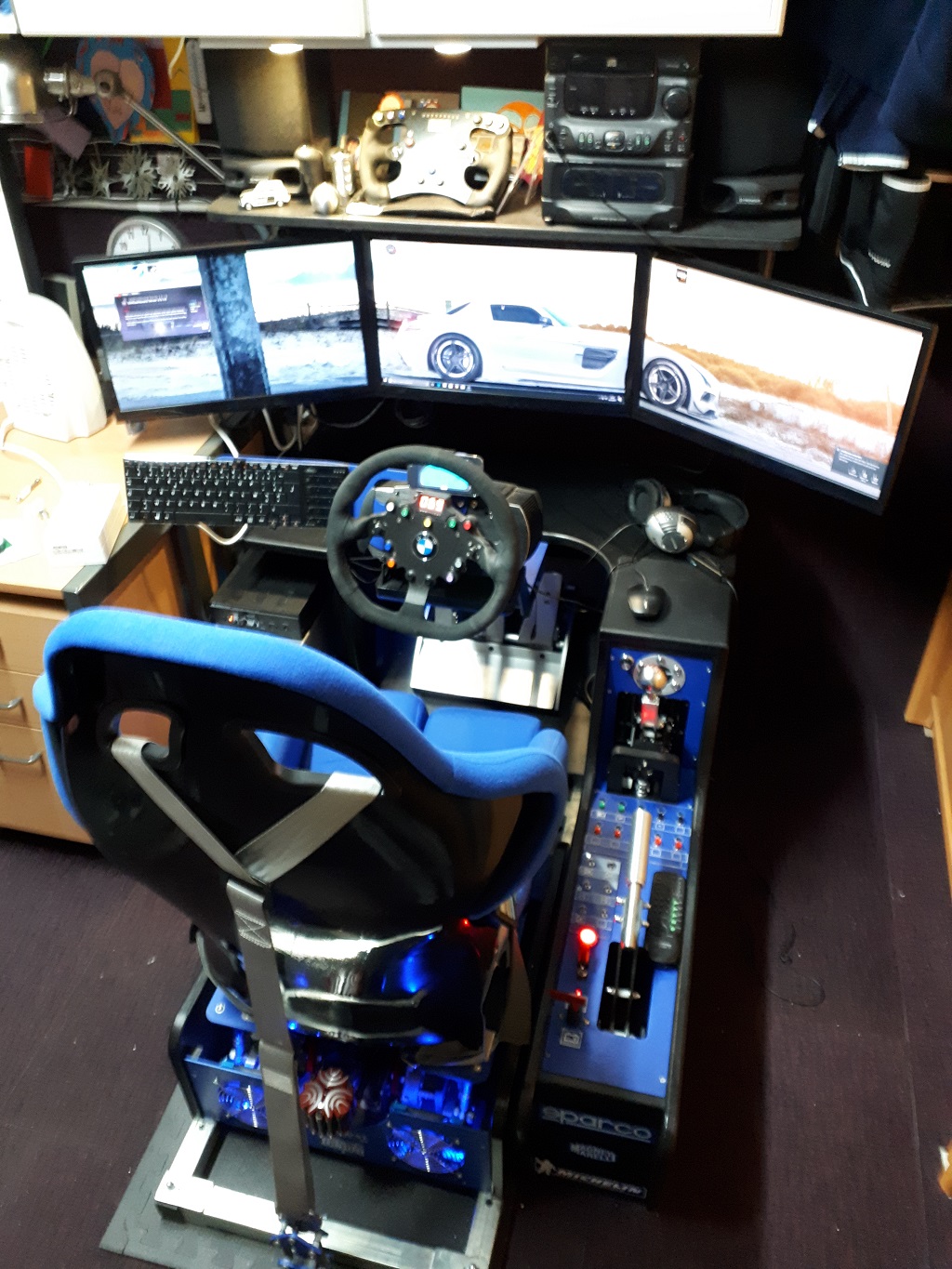

    I present you my rig with diy seat mover and diy handbrake and diy H and squential shifter...

    Nice work, passion shows

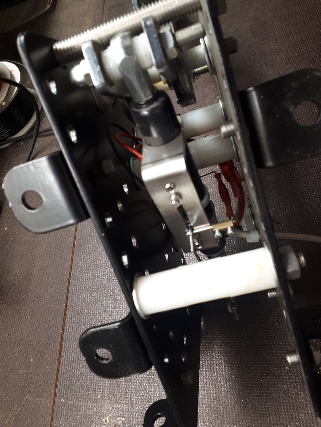

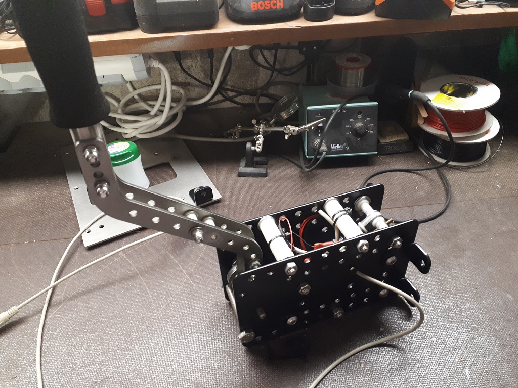

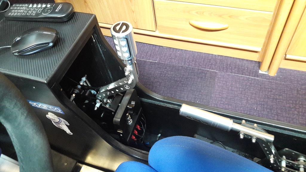

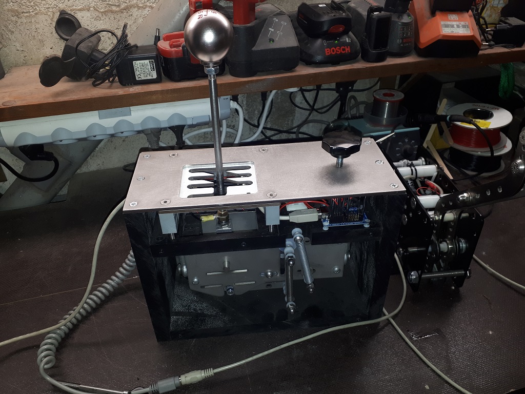

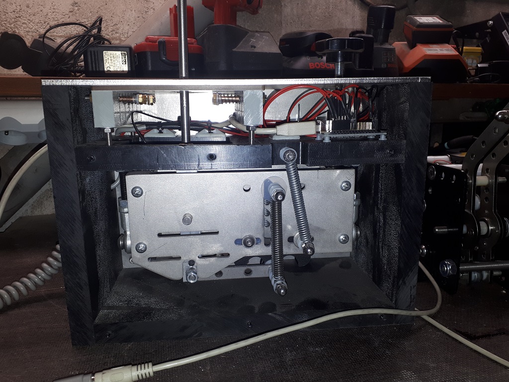

    I also worked on a second gearbox pototype, and on an analog handbrake.

    Yikes. That's a monster shifter

    yes he is a little big...:)

    Roughly how much did it cost you to build each
    They look great
  8. mimi67
    mimi67 New Member Gold Contributor
    Jan 16, 2017
    8
    france
    84Coins
    +15 / 0 / -0
    Not very expensive, the laser cutting and machining are made at my job in falls, the only things I bought are the switches, the knob and the card leo bodnar, about 60 euros in all.

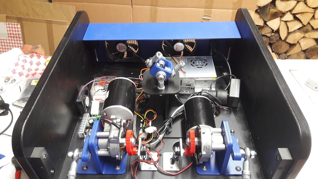

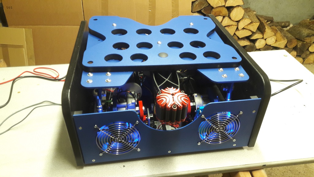

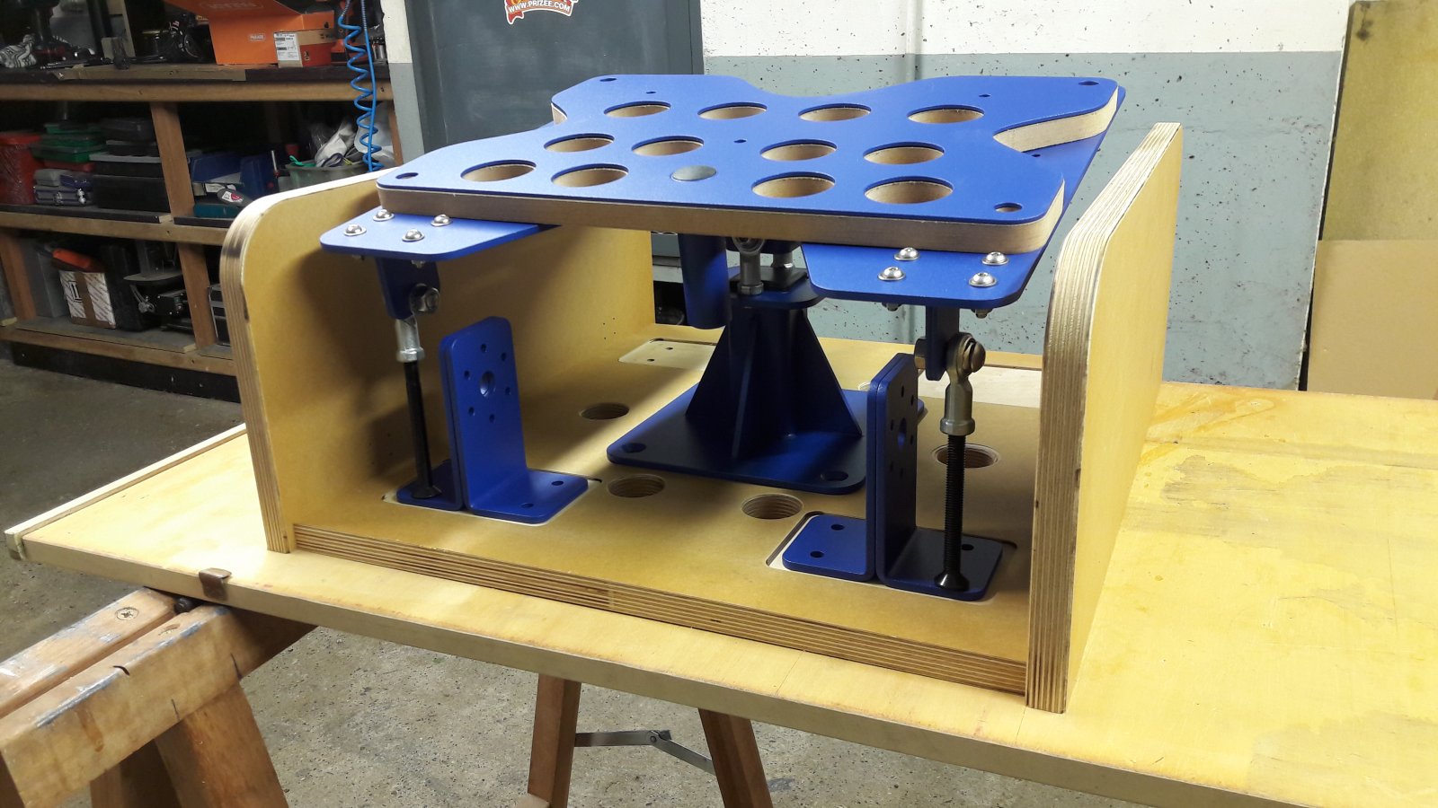

    hey mimi,
    i really like your build.
    especialy the creative way to build the u-joint for the seat.
    are the blue parts in the controlbox 3d-printed or metal?
    (motorarm)
    is it a crank style like simukit uses?
    can you please provide details on this.
    I´m looking for a solution here for my own build.
    thank you!
    again, great work! :)
  10. mimi67
    Jan 16, 2017
    8
    france
    84Coins
    +15 / 0 / -0
    hello
    The parts in blue are all in metal (laser cutting).
    I designed the cranks myself, but they are inspired by those of simukit.
    I still have the plans if you want...

    hey mimi,
    yeah, that would be great! :)
    finding a right motorarm is harder as i thought it would be...

  15. dieser
    dieser Member
    Jan 20, 2020
    35
    249Coins
    +10 / 0 / -0
    hey, it‘s me again ;)
    i found your simulator in a video by randomly browsing youtube searching for 2dof seatmover.
    it‘s great! you should really link it in your startingpost
    i‘m impressed how smooth and direct the movement is.
    would you mind to share your simtools settings here?
    are you using the 120w or the 400w motors from simukit?
    thank you for building this.
    it‘s such an inspiration! :)
  16. mimi67
    Jan 16, 2017
    8
    france
    84Coins
    +15 / 0 / -0
    hello
    I use the 120 w motors, they are sufficient for a seatmover, they don't heat.
    My settings (for Assetto Corsa) in Game Engine are : surge 45%(with 10% smoothing), sway 35%, heave 20%, roll 15%, pitch 15%
    in tunnig center: roll 15/-15, pitch 15/-15, heave 1/-1, sway 1/-1, surge 1/-1
    I have a potentiometer which adjusts the effects in game from 0 to 200%.
  17. dieser
    dieser Member
    Jan 20, 2020
    35
    249Coins
    +10 / 0 / -0
    hey!
    thanks for sharing your settings! :)
    are you using smc3 code for arduino?
    i‘m thinking about switching to your design...
  18. mimi67
    Jan 16, 2017
    8
    france
    84Coins
    +15 / 0 / -0
    hey
    the code i use is made by Wanegain on PCSHM Forum...
    good luck for the design, and if you have a question, maybe i can help.
