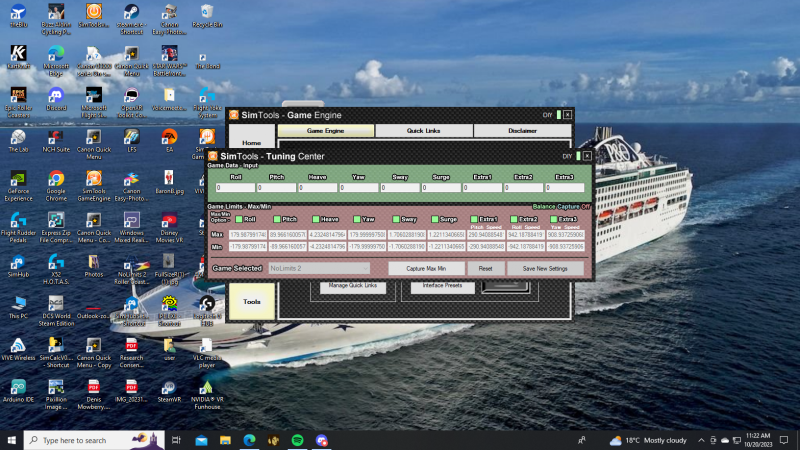

    U Screenshot (8).png sing the tuning center in sim tools the game data input is all showing 0 is this correct

    The game has to be running to provide telemetry, was that the case when this image was taken?

    No the game was not running do I need it to be running 2 screens to see it when the game is running and what should I expect to see

    If you check out the Tuning Center while a patched game is running the telemetry will be evident in the top row on the green banner.
