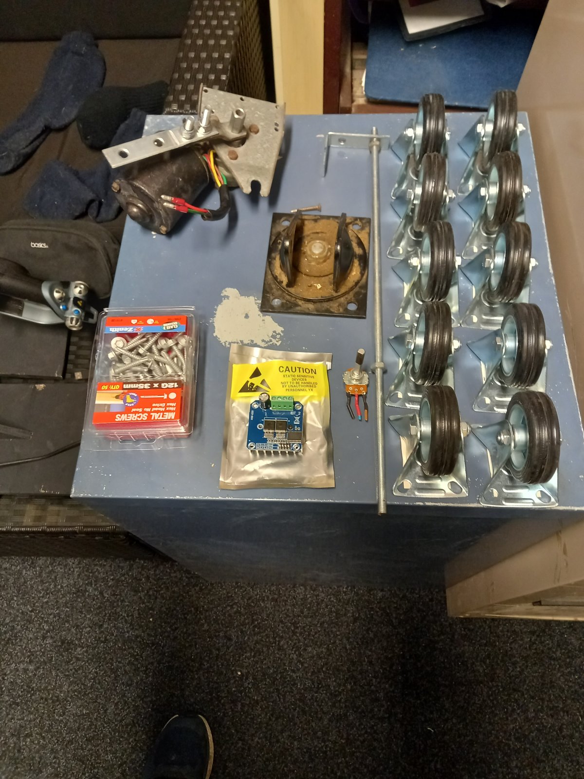

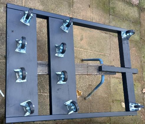

    And now to turn 2 DOF into 3 DOF . I have decided keep it simple is the way to go . Multiple castors to spread the load and a simple arm attached to the base with the motor swinging it back and forth. I will post pictures as I progress 20240430_131050.jpg

  3. Denis Mowberry
    Denis Mowberry Member
    Jun 6, 2023
    122
    New Zealand
    99Coins
    +20 / 0 / -0
    The next step in the conversion . I used 8 50kg fixed casters to spread the weight and a further 2 each side of the pivot point for stability. I will add further pics as I fit this to the rig

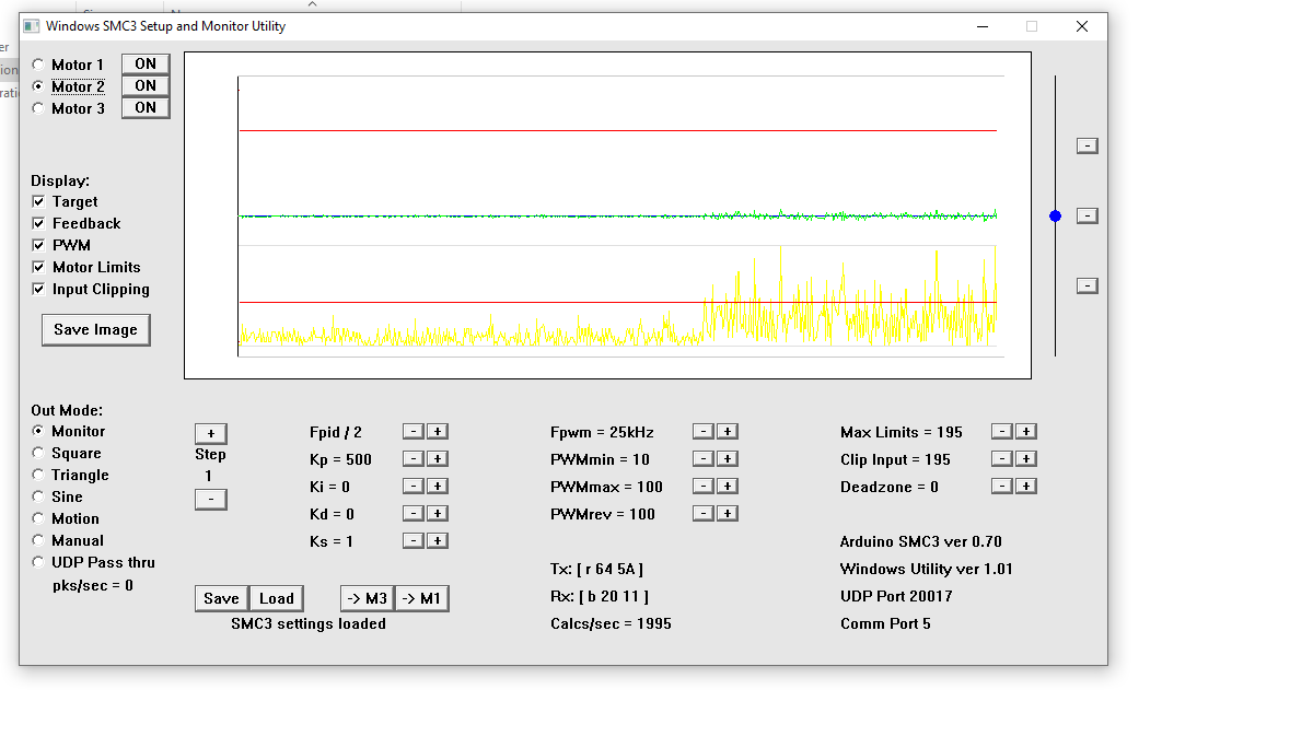

    Now that I have added a 3rd motor do I need to make any changes to SMC3 as I can not get any movement . I have checked the wiring multiple times and can see no reason for the problem

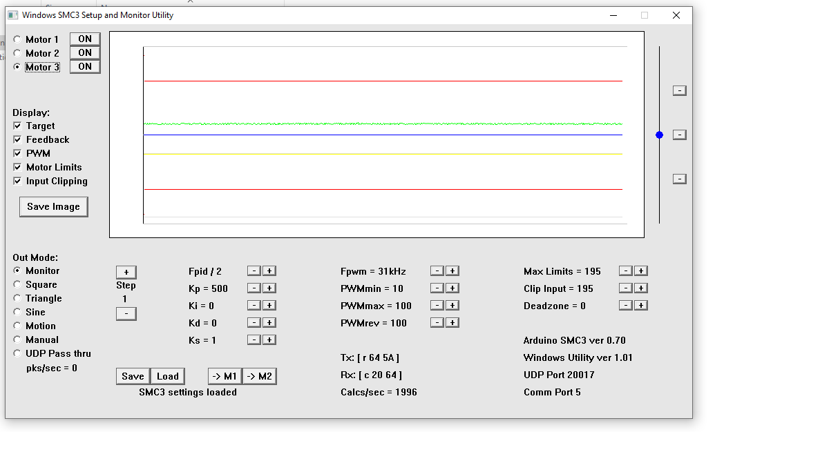

  6. Denis Mowberry
    Jun 6, 2023
    122
    New Zealand
    99Coins
    +20 / 0 / -0

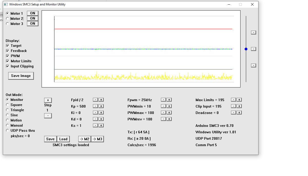

    Here are the screen shots of my 3 motors as you can see motor 3 is different to the other two motors .
  7. Attyla.pl
    Attyla.pl Active Member
    Oct 1, 2023
    287
    Polska
    1,262Coins
    +81 / 2 / -0
    IBT2 Fpwm max 25kHz !! better set to 20kHz , due to the limitations of the arduino set the motor 3 to 4 kHz probably setting 31kHz "fried" IBT2 you probably need a new one.

  9. Denis Mowberry
    Jun 6, 2023
    122
    New Zealand
    99Coins
    +20 / 0 / -0

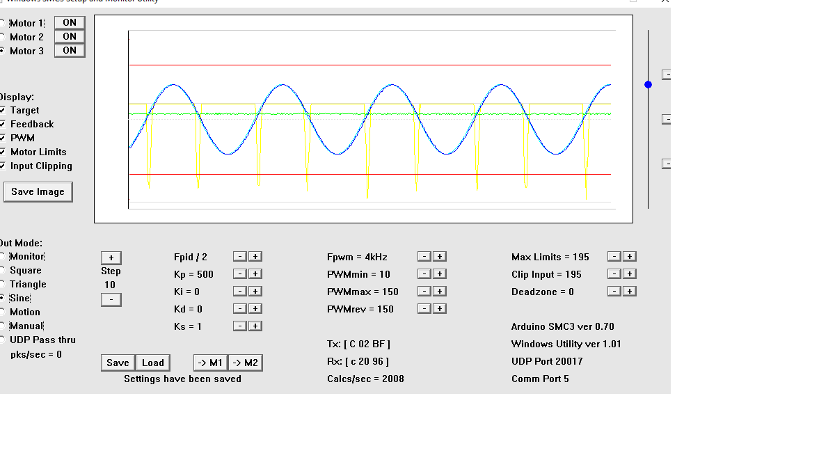

    I have installed a new IBT2 and this is what I get when I run SMC3 on sine . The green line does not follow the blue line but the motor jerks back and forth a small amount is there an obvious issue I can address. Thanks
    21,581
    151,100Coins
    With the power disconnected to the motor does the line move when you turn the pot?
  11. Denis Mowberry
    Jun 6, 2023
    122
    New Zealand
    99Coins
    +20 / 0 / -0

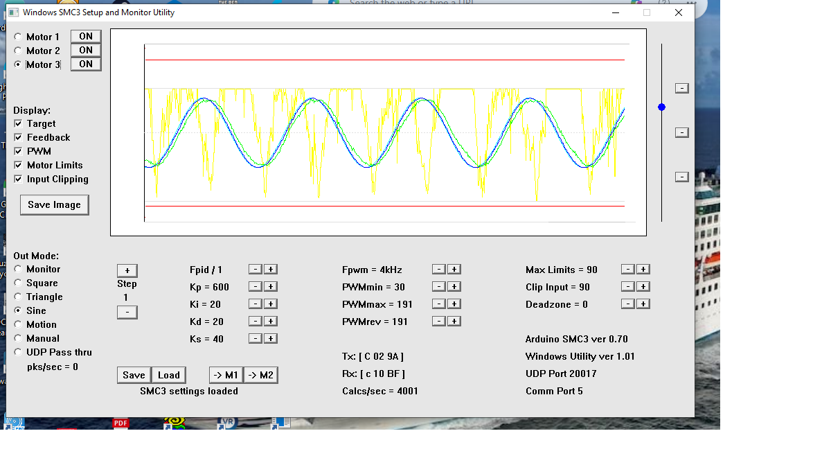

    Success I have increased the power to the motor and reduced the lever arm length and I now have movement .As this is one of my old wiper motors I am not sure if it will have enough grunt . Just waiting for tie rod ends to finish and we will see . Video on completion.

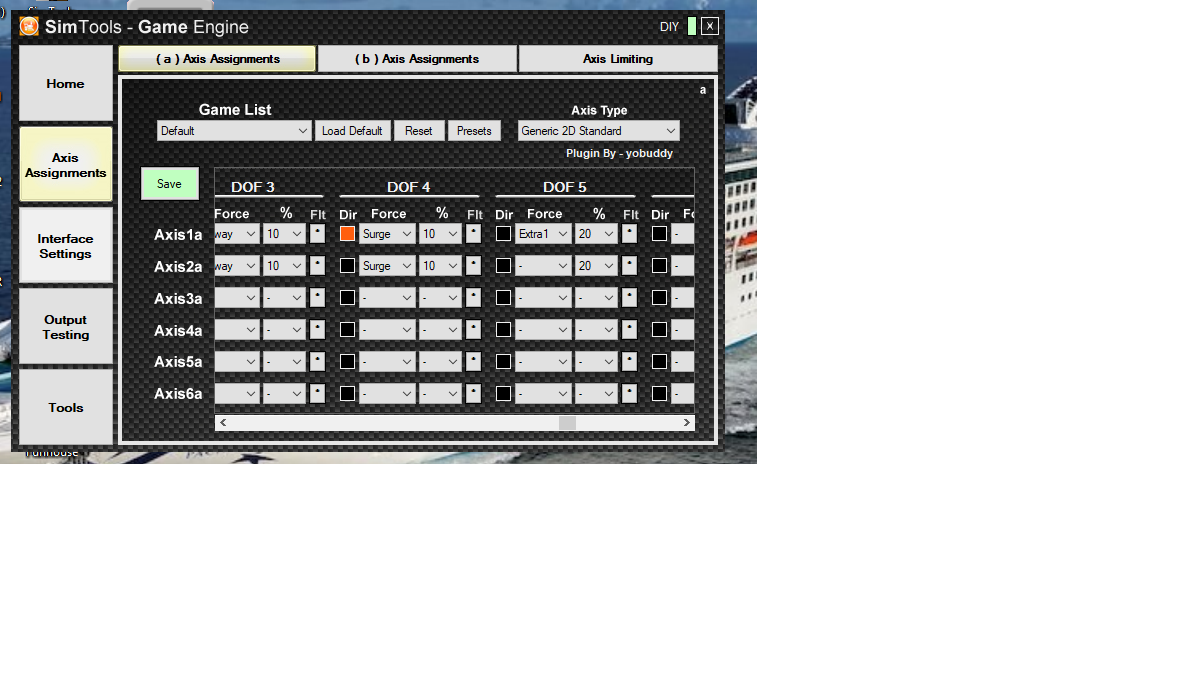

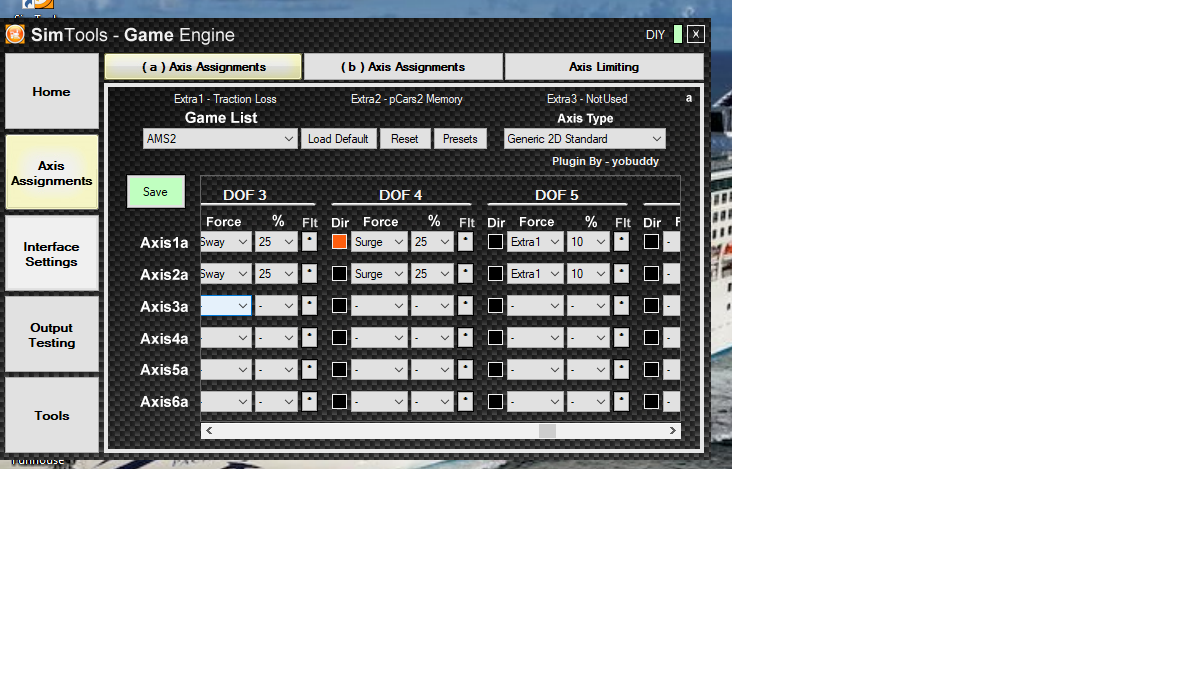

    99Coins
    +20 / 0 / -0

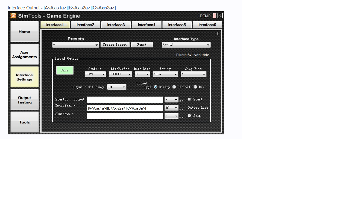

    I have now moved onto Sim Tools but have no movement Do my settings look right or am I causing the problem
  13. Denis Mowberry
    Jun 6, 2023
    122
    New Zealand
    99Coins
    +20 / 0 / -0
    Sorry got the wrong screen shot
  14. Denis Mowberry
    Jun 6, 2023
    122
    New Zealand
    99Coins
    +20 / 0 / -0
    Sorry finally got it right

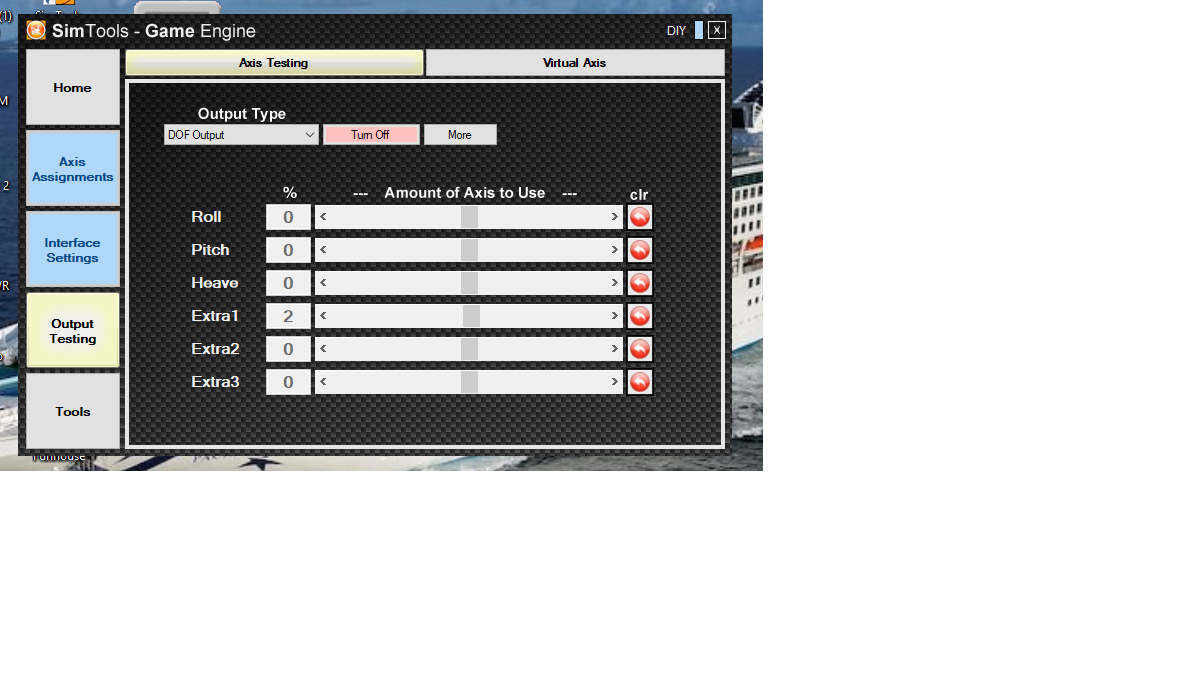

  15. noorbeast
    21,581
    151,100Coins
    For Output Testing to work the Default profile in Axis Assignments has to be configured, have you done that?
  16. Denis Mowberry
    Jun 6, 2023
    122
    New Zealand
    99Coins
    +20 / 0 / -0
    I have updated my default settings but when I go to test extra 1 it is moving motor 1 not motor 3
  17. noorbeast
    21,581
    151,100Coins
    You currently have Extra 1 assigned to Axis 1 and I suspect, depending on your interface settings, it should be assigned to Axis 3.

    +20 / 0 / -0
    Thanks Noorbeast sometimes you can,t see the answer when it is in front of you. Now just waiting for ball joints from china and I will post a final video. Thanks so much for your help I would not have got to this point without your guidance
