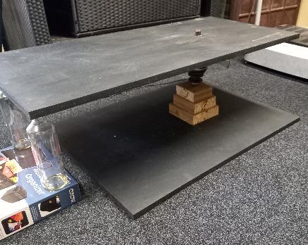

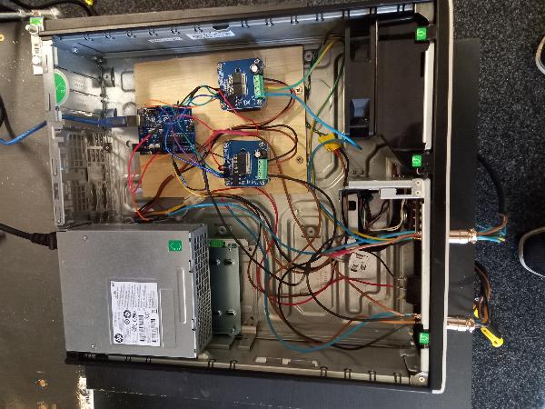

    My initial quest was to find out if someone with limited computer skills could build a working 2DOF motion simulator without breaking the bank . After 9 months of building and with an enormous amount of help from Noorbeast I now have a functioning rig that I run No Limits 2 roller coaster for my grand kinds , Microsoft flight sim and automobilista 2 for myself . With more to be added as I get the games .
    My materials list
    1 Sheet of 19mm Tri Board
    1 Car steering universal joint
    1 600w 24 volt power supply
    2 250w 24 volt motors
    1 Arduino board
    2 IBT2 motor controllers
    1 old computer case
    Various nuts, bolts, screws and brackets
    My total cost was about NZ $700.00 most of this being the motors and power supply.
    Please this cost does not include the computer, controllers of screens .
    The bottom sheet is 1050 cm x 750 cm
    The top sheet is 1250 cm x 560 cm

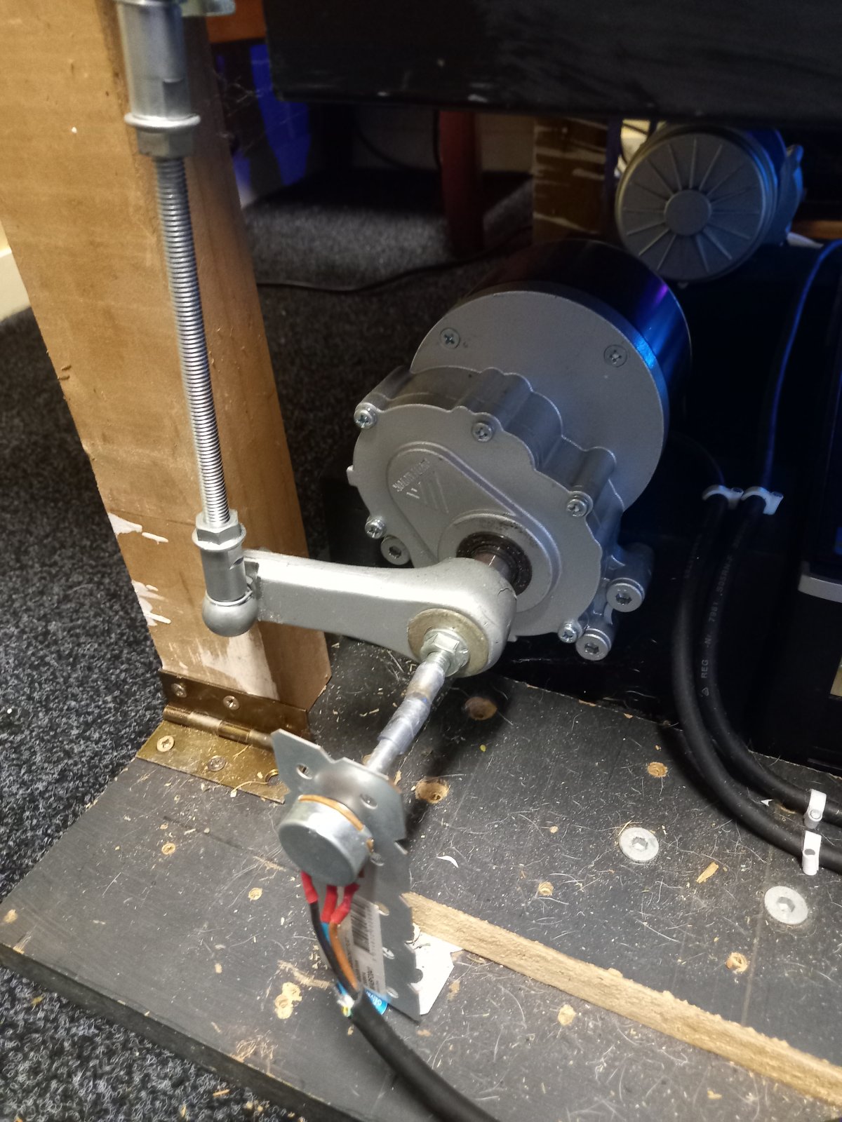

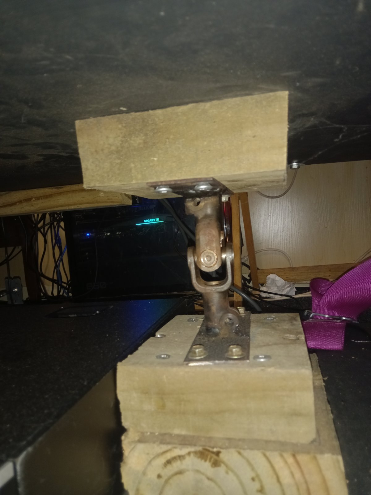

    I welded 2 plates to the universal and bolted it to blocks to give the height needed to fit the motors and attached potentiometers to the end of each motor shaft
    I used an old computer case to hold the Arduino ,the IBT 2 controllers and the 24 volt power supply

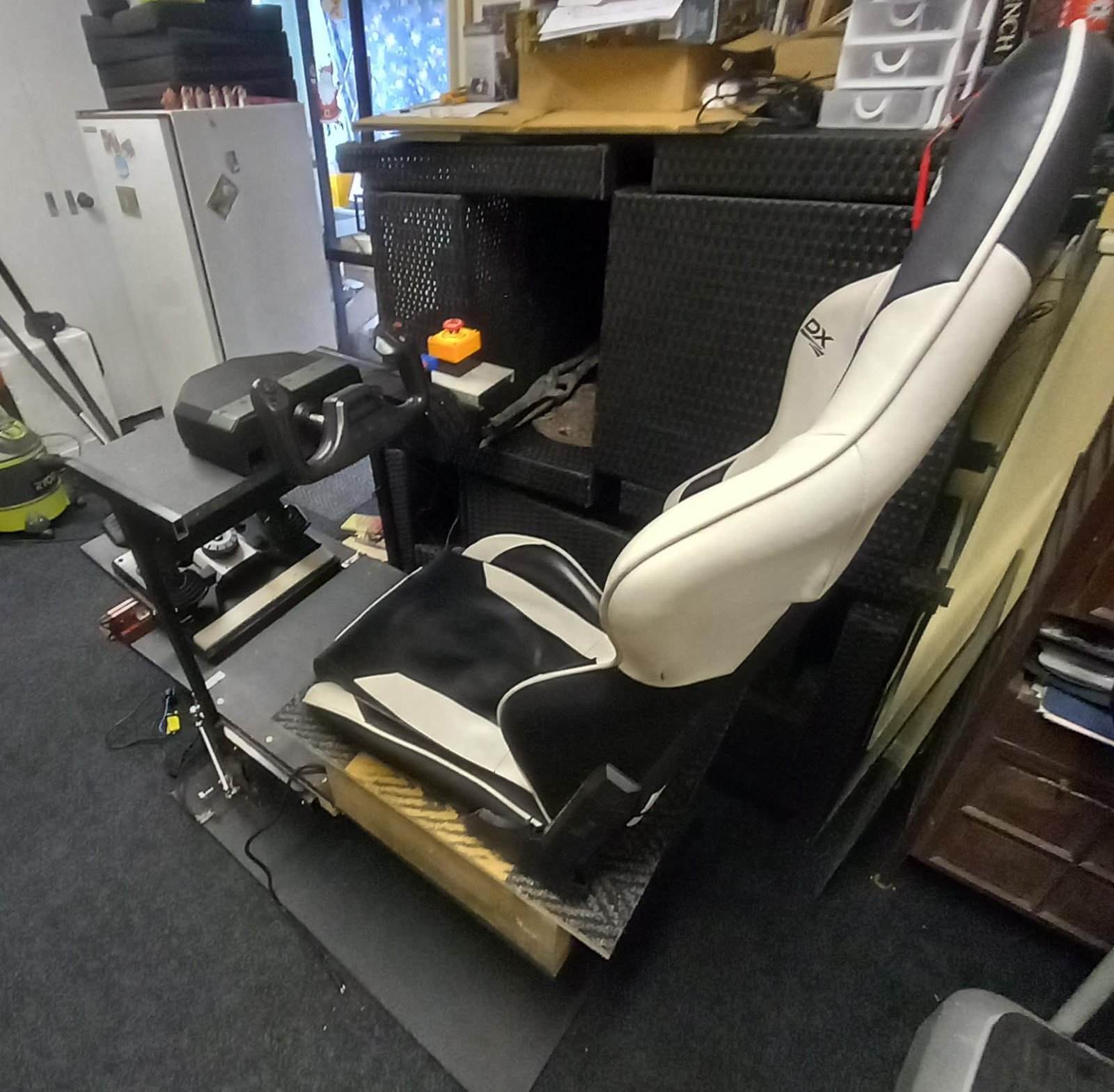

    I have used an old computer table as the mount for the flight yoke and Steering wheel . After removing the base from my old seat and bolting it in place we have this.
    I have added a few bits and pieces like a better seat mount and a 5-point harness which makes it look better. I will post a video of the completed rig running in the next couple of days.

    I have a question what program do you use FlyPTmover or Simtools ?

    I have used simtools supplied by this site

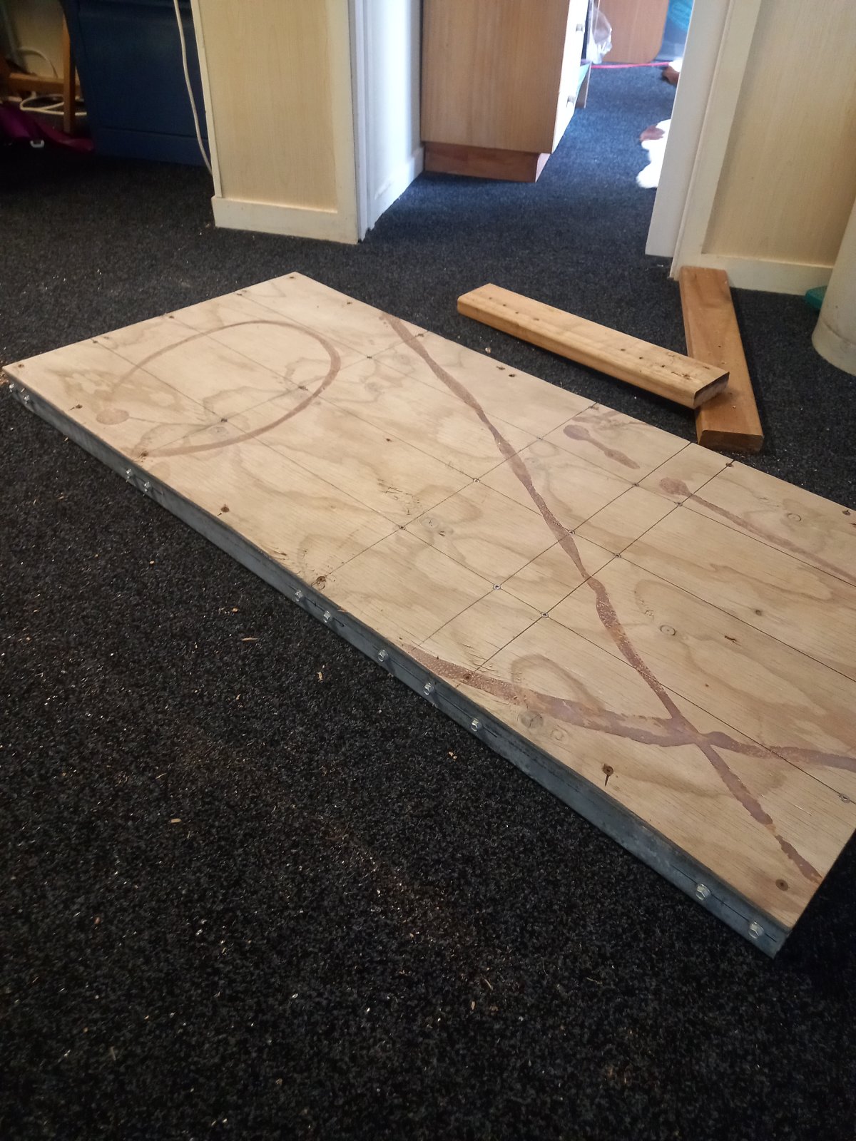

    Just to add a note for anyone thinking of trying this kind of construction . After some use I have noticed the top board is flexing and has developed a bow from front to back . Apart from creaking it is not causing a problem at the moment but I feel it may do in the future. I will try and work out a way to stiffen it up and will post pictures when completed of if anyone has had this problem can you let me know how you fixed it.
  7. Trent Robinson
    Trent Robinson Member
    Nov 21, 2023
    64
    Systems Engineer
    354Coins
    +16 / 2 / -0
    3DOF, AC motor, Motion platform
    You could brace the board with angle iron. Aluminum or steel. You could cut it to length, clamp in place along edges, drill right through it in many places and bolt them together. Welding wouldn't be needed if not in your toolset.
    Wouldn't help much with twist but would greatly reduce flex.
  8. Denis Mowberry
    Denis Mowberry Member
    Jun 6, 2023
    122
    New Zealand
    99Coins
    +20 / 0 / -0

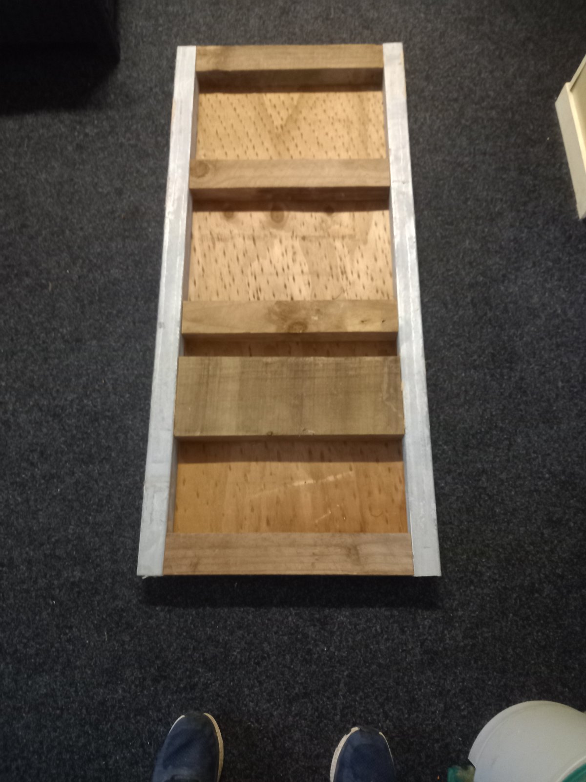

    Thanks I have used 50mm x 50 mm x 2mm thick box section steel running the length of the platform connected with 75 mm x 50 mm timber and topped with 7 mm ply wood using numerous screws to hold in place pictures to come on completion

    That said, given your construction approach and reported flexing it sounds like the framing design is not yet adequate to prevent torsional twisting. Triangular bracing may help and not add too much mass or complexity to your current setup.

    As you can see the platform is far more robust and with the steel box section running the full length of the platform there will be no bowing. Also there is verry little flex
