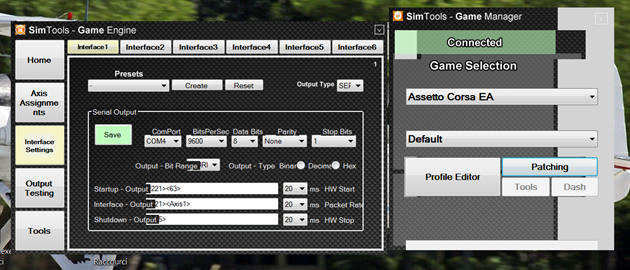

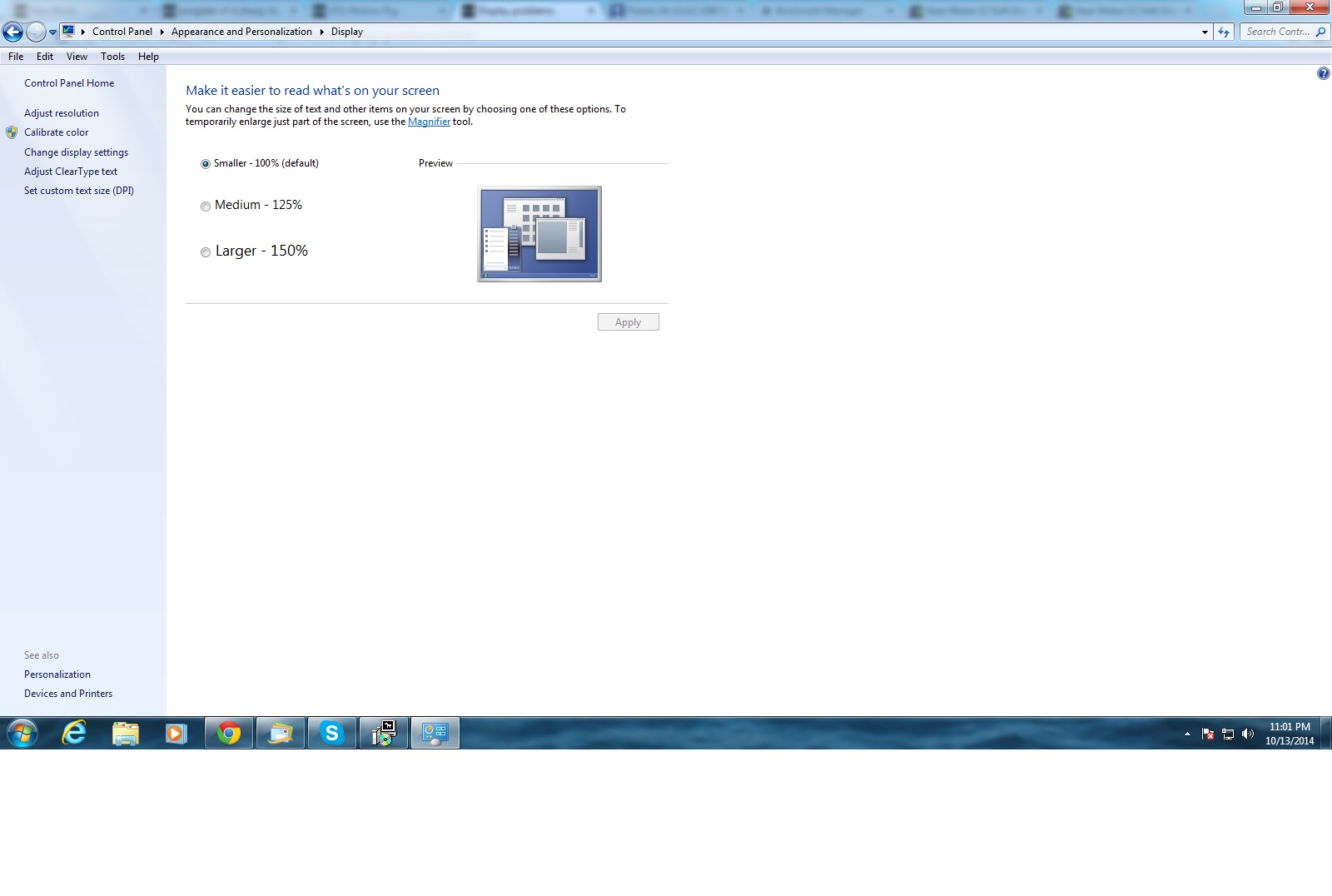

    Installed V1.2 yesterday after a long break, V1.0 has never worked properly and i quit trying many months ago since i didnt race much, but now i am getting odd things, followed the instructions to get it running and at the step of the game manager, it doesnt display the bottom pat where you need to patch the game, tried with keyboard in blind mode, was able to get the path of the EXE, but wasnt able to get it to patch, i also have some overlay in the game engine screen, less problematic but i wonder what is wrong, i have windows 7 64 bits , nvidia card, GTX 650 TI with updated driver yesterday, it was 337.88 and now is 344.11, please help :) check the attached screenshot tks a lot

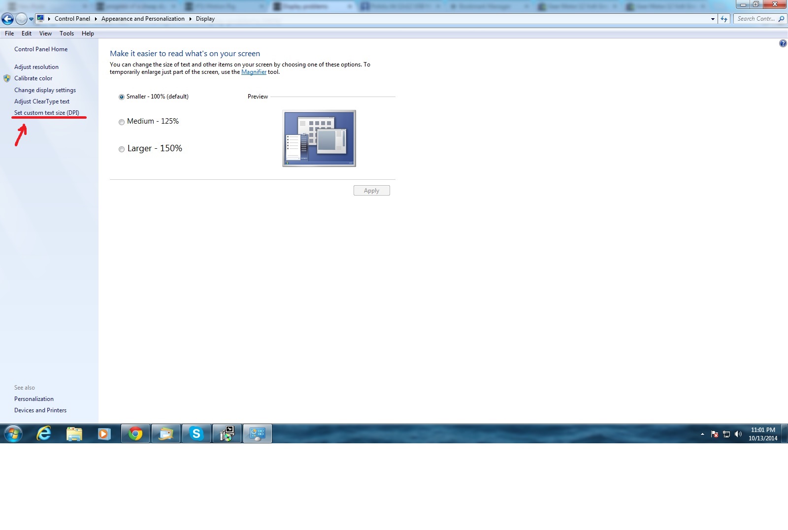

  2. bsft
    change your icon size to 100%

    @insane, tks, but that was the same answer as the first guy, and it is not working, tried it at 100% with no luck, but i have the same UI looks than this guy, distorded and missing part of it...darn !!

    What is your DPI set to?

    @ Yobuddy, like i mentionned, it was set to medium size, tried to 100% like BSFT said, and it didnt worked !! tks anyway

    but what is your DPI setting?

    Hummm, i am a bit shamed of myself...when i said i tried the icons at 100% like BSFT said, i did it by rightclicking on the desk and changing icons to small, but i checked again the screenshot he took, and noticed that he was in the configuration panel....so went to check and to my amazement, it was set to 125%, so changed it , reboot and it worked...dam it, why windows have 2 places to set that and the effect is working only from one place ?????? guess this is windows's stupid way of working... anyway, problem solved tks to all and sorry for not knowing more about windows.

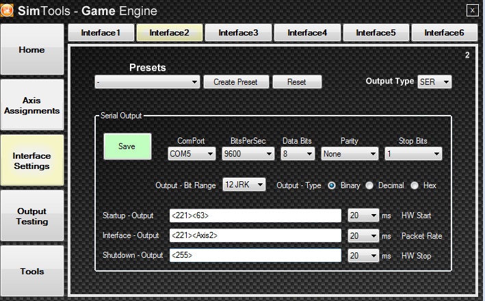

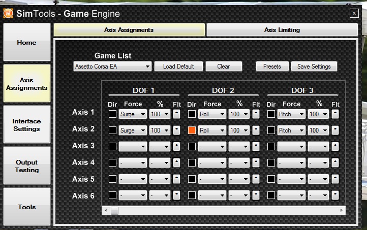

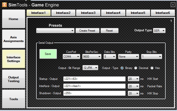

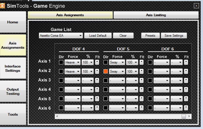

    OK, previously to that problem, i followed step by step BSFT's set-up guide, so i patched the game, worked fine just like the tutorial says, then stsarted assetto corsa and still no ingame movement ?? the thing that bugs me is that in the game engine sorftware, i am able to make them move, both axis/motors , in the output testing page under axis , but in the DOF page, the only one i can get some small movement is the "surge" slider, please help me understand!! here is what i got as set-up...tks in advance again :)

    Have you made changes in the tuning center yet? Right click on the game engine icon in the taskbar and click on tuning center to open it.
  13. bsft
    yes @poman , have you looked at tuning centre numbers and changed them?
    Also you have got each force at 100%, in my suggested guide I set each force at 20%, not 100% , then I go to the tuning centre and if the direction of the motors is right, I spend time with tuning centre to get a good feel. Only after that , I go back to the original force and change the percentage of the force.

    Tks guys for answering. I understand that i will most probably need to fine tune all axis and not leave them at 100% like it is now, but wouldnt i be supposed to feel movement in the testing screen??? in the DOF one...because the axis screen works, i should also mention the when i loaded the game, at one point after loading i was able to feel a small movement like a repositionning of my seat, but nothing during driving, even if i go extreme like high speed crash, wonder if it could be normal...my point is that i believe i should feel something right from the start if all is configured properly...isnt it ? even if the forces are reversed or else... i would just like to know if my setting are somewhat right for a 2dof with 2 jrk12v wiper mounted in parallel in back of seat. tks so much again

    you will feel something, yes, just follow the steps I provided and set each force, test to see if the motors/sim moves the right way, work in the tuning centre and adjust numbers.
    Rinse repeat.
