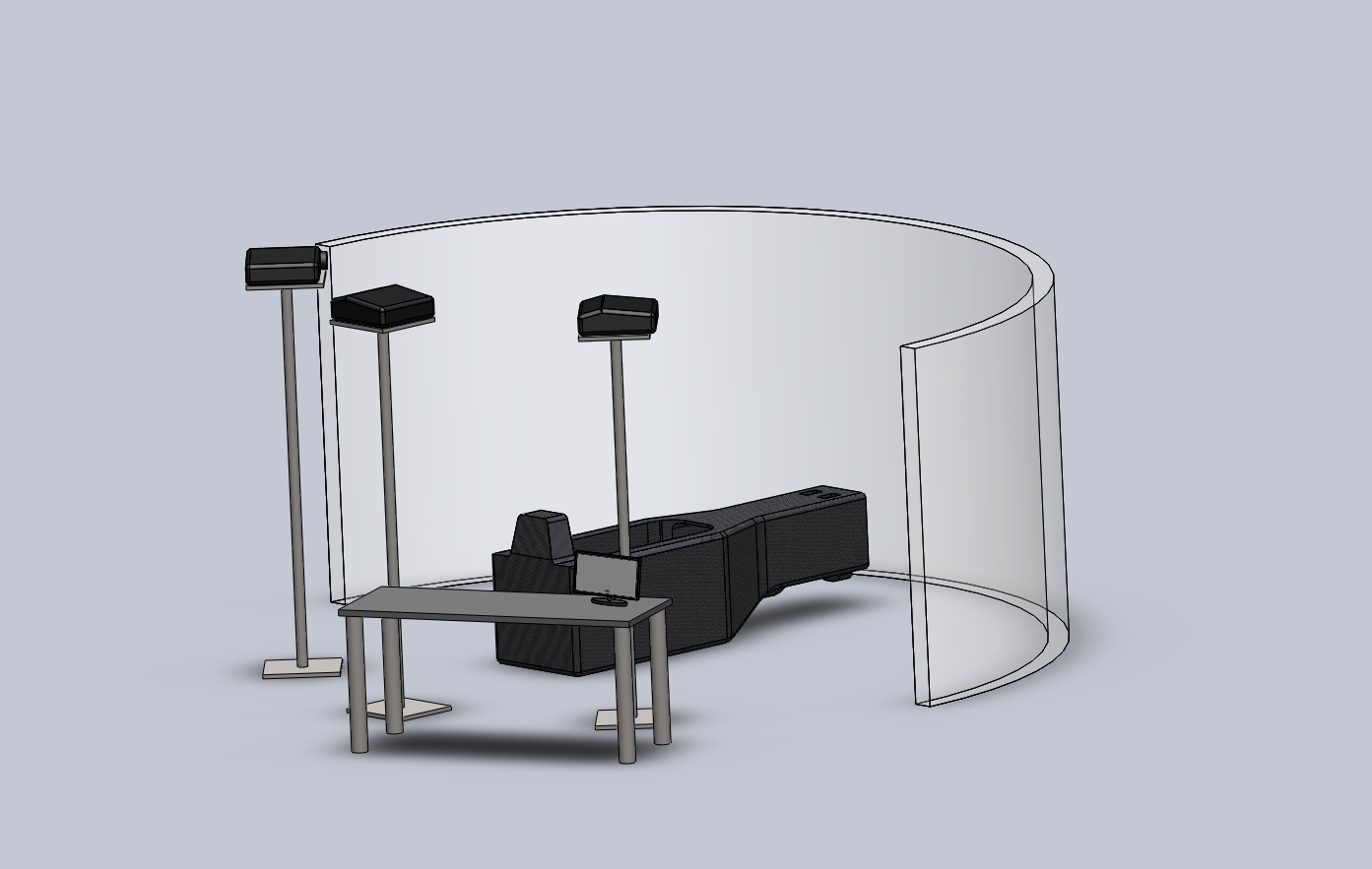

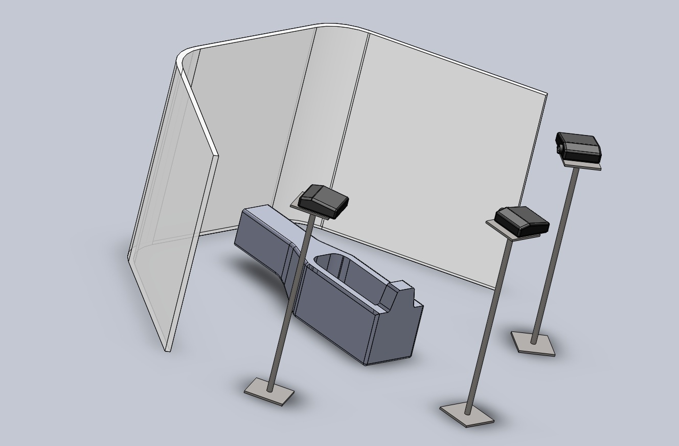

    Hi all,
    I'm in the final stages of wrapping up my sim design before I embark in the purchasing process, and have got one last dilemma! I've decided I definately want a 180 degree wrap around screen, but am unsure whether to go for a curved screen or a three panel screen with substantial radii joining them together. I intend on using 3 HD projectors (Mitsu HC4000 seems to be my best bet at present) and possibly some warping and edge blending software, namely Warpalizar which appears to be very well priced! My only fear in running a curved screen config as opposed to a 3 panel screen is the focal depth issues brought about by projecting an image onto a curved surface.
    According to my calculations, each projector will be projecting an image of 2.21m (Wdith) and 1.25m (high) with a maximum screen depth of around 25-30cm (throw distance between3.1-4.6m). I've asked around on the projector forums but nobody really has any idea on extreme curved surfaces as most focus on home theatre configs.
    On the other hand I could play it safe and go for the three panel arrangement, but I wonder how good the immersion sensation would be...
    Any opinions would be much appreciated!
    Regards,
    Julian

    Hi Julian,
    nice project going on :thbup:
    If I ever start a project like this I would go for the curved screen without hesitation simply because I personnaly hate the angles between the screens on a 3x flat panels setup... It kills the immersion even without bezels...
    Videos of sims on curved screens using Warpalizer looks amazing! No more screen angles causing image distortion :clap:
    Thx for sharing! Now I want my own curved screen!
    This one is very similar to your drawing and the FOV looks fantastic!

    Thanks for the input Bleco. Yeah I have stumbled accross those videos, very nicely sims! The first rig is base performance sims, that one is 42 (GBP) thousand if I m not mistaken!!!
    My only worry is that the projector won't be able to produce a relatively uniform focus picture...what do you think?

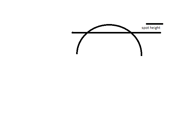

    the focus is with 3 projectors not a big problem and a curved screen.the spot height
    is not very high.the rest make the software.i use nthusim.but i have find a other soft http://www.vioso.com/de/profi-tools/vio ... enter-pro/ hi make the correctur with camera.

    I don't think this will be a problem especially with Mitsubishi projectors! :thbup:

    Thanks Nima, What is spot height?

    hi
  9. julian.bernard
    julian.bernard New Member
    Oct 8, 2010
    37
    22Coins
    So in my case teh spot height is around 25-30cm (i.e. maximum depth?) Now I'm just deciding on graphics cards to power the 5769 x 1080 resolution! I'll either be going for 1 or two Radeon HD 6970's :)
