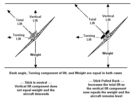

    I was trying to figure out what the forces would be in an aileron roll (very different forces from a barrel roll!) etc. and I had an idea so I did a search. I think this video contains some very interesting info for us, and I would like to discuss how we can achieve proper cues for these things.
    You will see that in an aileron roll the water is being acted on primarily by earths gravity and aircraft forces are pretty minimal. This is as opposed to a barrel roll where the primary force felt is perpendicular to the wing which you can see a little later in the video. @Dirty I know this is counter to what you said about gravity but for aerobatics these are realistic cues as you can see in the video.
    I'm trying to figure out how to get the proper cues for these two situations.
    In barrel roll the aircraft is pulling constant positive G-force perpendicular to the wing so it is easy. Use just angular velocity. When pilot initiates roll you will feel the wing drop so if you are doing barrel roll left the simulator rolls left. Once barrel roll is in progress the roll axis of the motion sim should wash out to level and stay there as long as the barrel roll continues. To end the roll the angular velocity now changes in the other direction (negative acceleration) so the right side of sim would drop, and then the roll axis of the sim would wash out again.
    In aileron roll you are not causing the aircraft to pull vertical g-force, so you would feel the roll initiate (change in angular velocity just like barrel roll, but then instead of washing out you want to give cues in the direction of earth's gravity. So again we do roll to the left for the example. Simulator rolls left wing down, but then instead of washing out the sim should stay rolled left a bit. It should return to level as the aircraft is inverted, and then should start rolling right a bit to cue for earths gravity now pulling in that direction (see water in glass video above). As long as the roll continues the platform should continue to vary the cue for direction of earth's pull. And again, to end the roll we have an angular velocity change opposite of initiating the roll so the platform should roll right to simulate that (regardless of current orientation to the ground. If the roll is stopped with the aircraft not in normal orientation (such as in an aerobatic four-point roll) the angular velocity cue should occur, but then the platform should wash out not level, but to cue the direction of earth's pull. As long as angular velocity remains the same the simulator should increase left roll angle until it is at 90 degree left bank angle, and then should start decreasing it again as it passes 90 degrees continuing toward 180 degrees. As aircraft comes to 180 degrees from normal flight (inverted) the platform comes back to level again. As aircraft continues the left roll, the simulator then would begin to roll to the right to simulate direction of earths pull increasing until aircraft is at 90 degree right bank angle, and then decreasing as it continues toward zero bank angle, arriving back at center position (roll axis level) as the aircraft returns to normal flight. If the roll continues it would again begin to roll left a bit and continue as described. Bank angle should only use a portion of simulator roll cue, so that if the pilot (again back to my left roll example) stops the left hand roll at 90 degree right bank angle the simulator can still cue right hand roll for the (negative) angular velocity acceleration.
    So that gets more complicated. I will describe the cues for a four-point aileron roll to the left.
    Pilot initiates left roll: Simulator cues for change of angular velocity and rolls to the left.
    Roll continues until 90 degree left bank: Simulator stays somewhat rolled left (changing sim roll axis angle as aircraft bank angle changes) because of the direction of gravity (because this is an aileron roll not a barrel roll). For four point roll the pilot quite suddenly moves the stick toward center to stop the roll at 90 degree left bank. Simulator cues this acceleration by quick roll to the right, then washes out not to center but to left bank angle and stays there. Pilot then resumes the left roll, so there is a quick left roll cue from the sim, and then the angular velocity cue washes out but the sim continues to cue for direction of earth's pull, now rolling back toward center position. Pilot stops the roll at 180 degrees for the four point roll, so the simulator does a quick right roll cue for the change in angular velocity, then washes out. At this point the aircraft is at 180 degrees so there is no continuing bank angle cue, platform roll axis will be at center. Pilot resumes left roll, we give quick left roll cue, and then sim "washes out" but goes past level over to right roll angle for pull of gravity. At 90 degree right bank angle the pilot stops the roll again, so we get a quick right roll cue for change in angular velocity, then "wash out" but stays rolled to the right to simulate the earth's pull because we are at 90 degree right bank. Pilot once more resumes the left roll so we get a quick left roll cue, washing out back to the right bank angle, and the bank angle continues to decrease from there as the aircraft returns to level flight arriving at simulator zero roll position, pilot then stops the roll the fourth and final time, giving a quick right roll cue for change in angular velocity, then washing out back to center position.

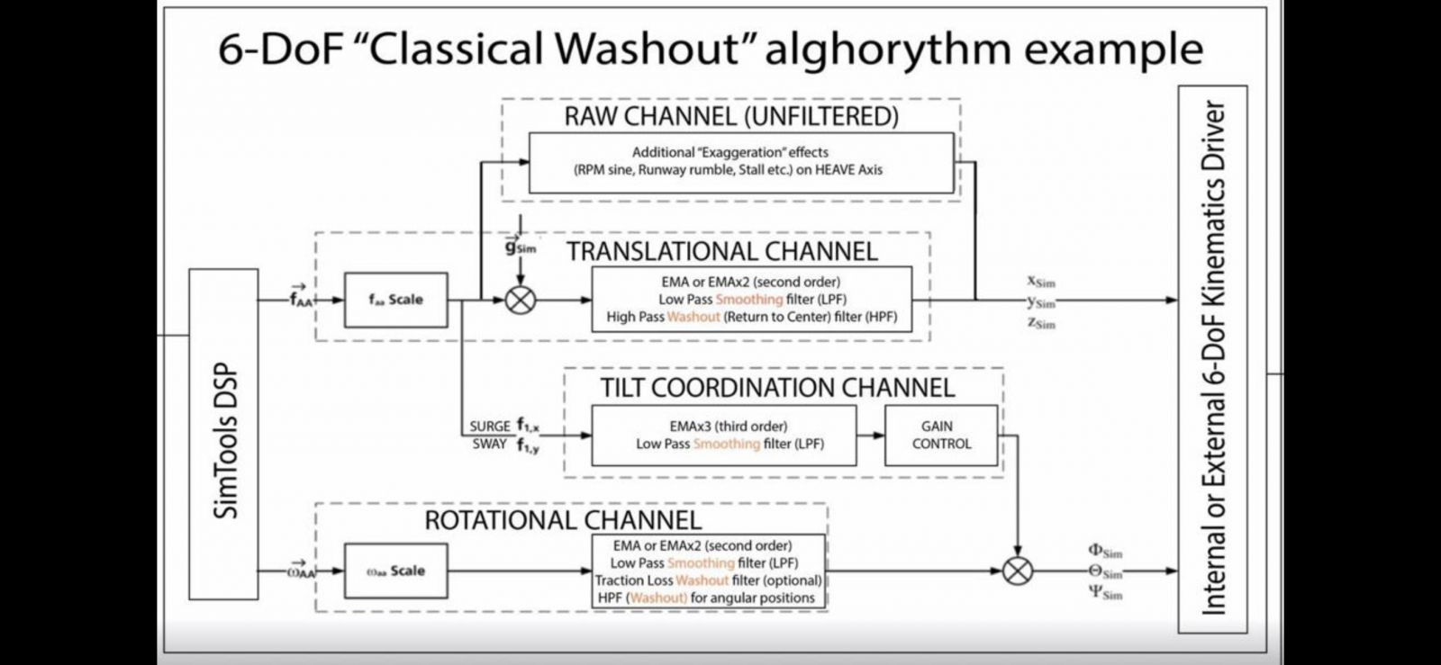

    More or less the idea is this one:

    TLDR:
    1. Ignore Euler angles, because...
    2. Gravity does not exist.
    I find it totally awesome that people are interested in this. Especially because @Trip Rodriguez' problems 1 + 2 appear to be fairly frequent in plenty of discussions around the community. The "rollover-problem", as well as the "pitch 90°-problem" both most probably come from the same misconception.
    It is the misconception that we need to use Euler-angles to describe the motion of the vehicle. Euler angles describe the orientation of the vehicle, not the motion. To be more specific: They describe the orientation of the vehicle in an instance of time and they do so only in relation to the horizontal plane and north. But neither of those have anything to do with what an occupant feels inside a vehicle.
    In 6DOF motion-cueing we don't care for orientation, we care for motion! We don't do orientation-cueing we do motion-cueing:) And we normally do this for longer than an "instance" of time. If you intend to use a motion sim for anything longer than a Gazillon-th of a second, then let go of Euler angles. :) They are worthless. In fact the only thing we feel on a vehicle are vehicle specific forces (aka proper accelerations) and vehicle specific angular rates.
    The tricky part is, that for small angles the results you get from using Euler angles will initially be somewhat plausible.

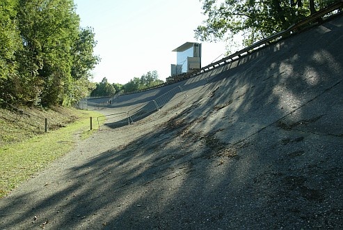

    ...unless you are driving here:
    In this turn your heading will change very quickly, but you will nonetheless have only minimal side loads and very small angular rates around the vertical axis. A special case, I admit :)
    But the problems increase with tan(pitch) or tan(roll). Up to a point where at ~90° roll (steep turn) your veh.spec. pitch rate is quasi your world-yaw-rate and vice versa. For 90° pitch neither heading nor bank angle is even defined. It does simply not exist.

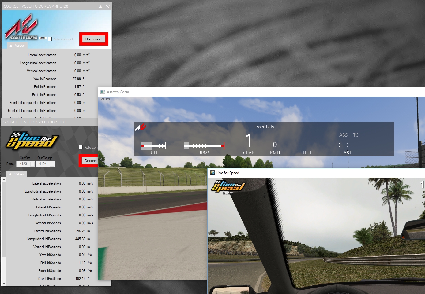

    When I said not in all situations, was relative to the games that don't output values with "gravity". Not the gravity exists or not...
    An yes, they don't, at least in the output, it doesn't show the acceleration due to the so called gravity:

    That's a bummer indeed! :confused: That means you could slowly drive up the Eau Rouge in Spa Francorchamps and feel nothing...!
    Try the corrections, or the traction forces if available.
    Dirty :)
