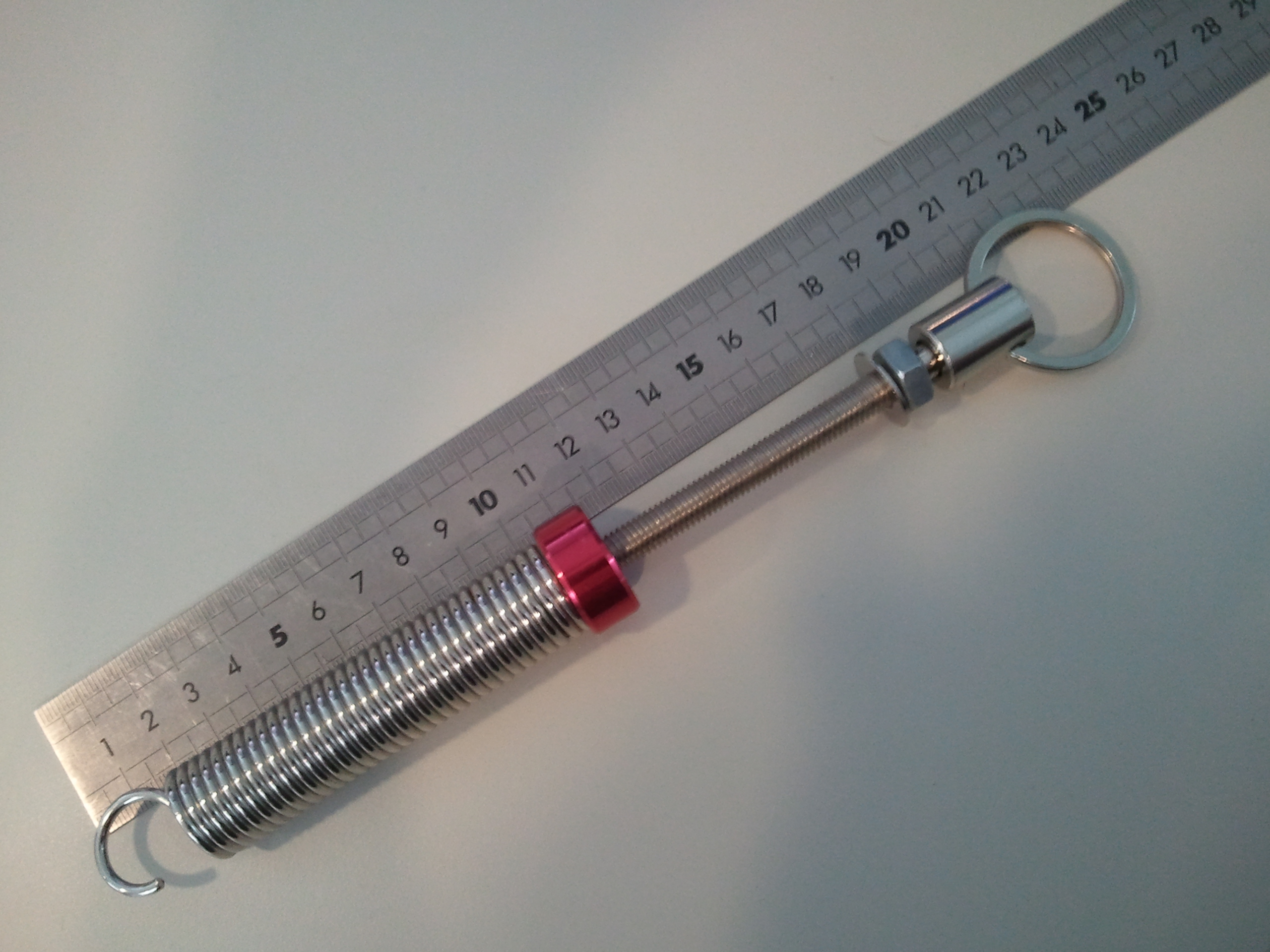

    For those interested: the springs arrived today:
    2012-05-03 14.30.09.jpg (the ruler is in cm/mm)
    They are a lot bigger and, more important, stronger than I thought. (I can barely stretch them by hand).
    So I reckon I have to place them closer to the pivot point than I intended.
    Since these are the plates my pivot will end up in between:
    (the steel plates are 30x30cm)
    I reckon I'll just place them in between the top and bottom adjustment rails.
    Edit: a quick calculation learns that at that point the springs have to stretch in and out approx 25 to 30mm (so 50 to 60mm in total). Guess I need to test it to see if they will.
