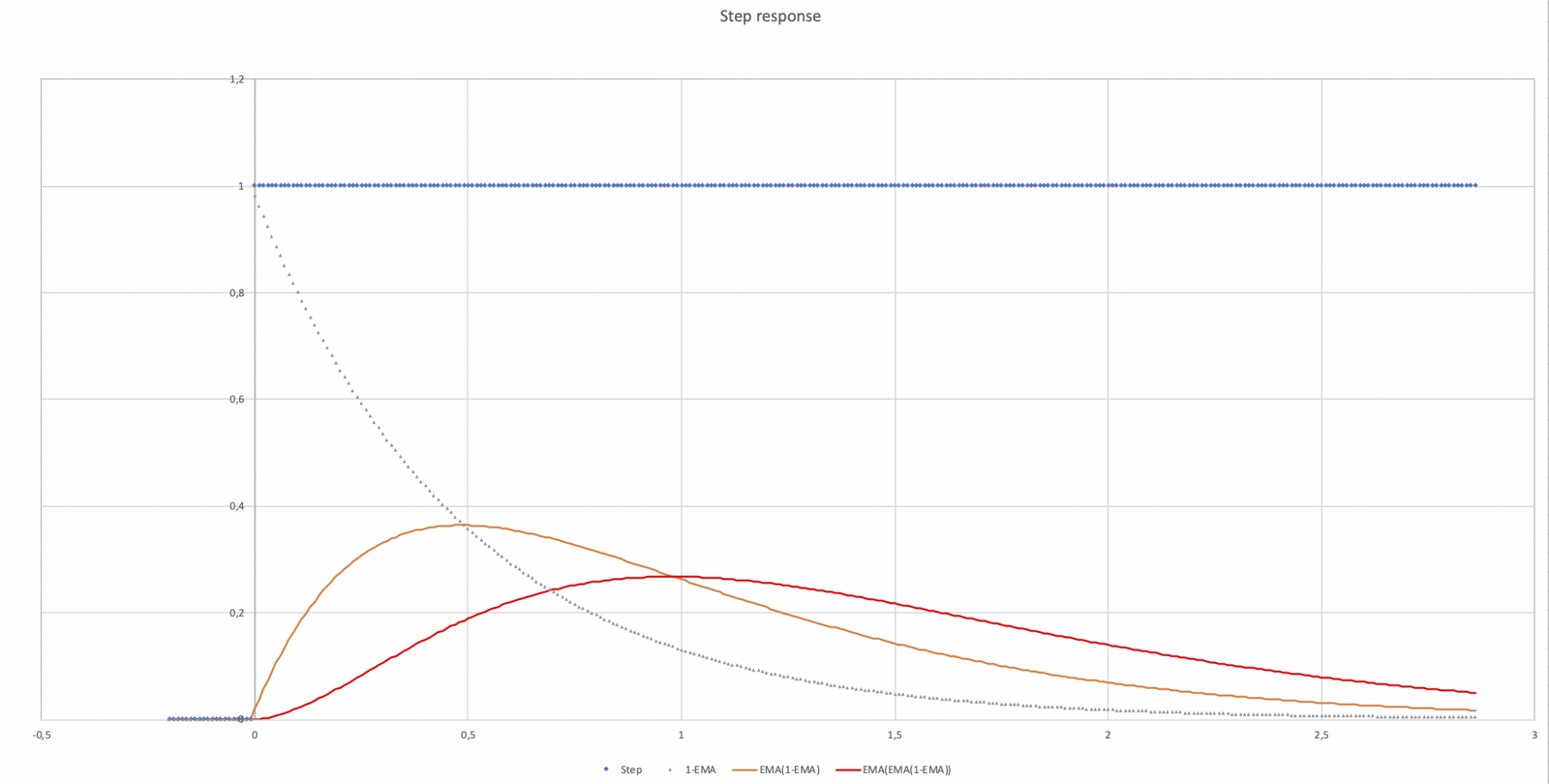

    I didn't know there were different levels of firmness. I ordered this. It is good, it absorbs quite a bit of the vibrations, especially the "chrrrr" from the ballscrews. The "Brrr" from the belt drive not so much, unfortunately.
    Oh, I don't mind. Over the past few weeks - and especially since I have a rig to test - I have modeled the filters I use in every possible way in the time domain.
    There are a total of 8 channels driving the rig.
    Two of them are the tilt-coordination channels, let's ignore them for a moment.
    The three angular rates use a HP followed by a 1st order LP.
    The three accelerations use a HP followed by a 2nd order LP.
    ...and then each channel has a gain (multiplier).
    First, to get a starting point, you set the gain to 1 and the filter variables of the HP/LP filter system to the same value:
    Filter_variable = Processing_framerate / LP_filter_order.
    So, for example if your software processes the motion data 500 times a second, and your LP filter is of 2nd order, set the filter variables to 500/2=250. Both equally!
    You will now have a system with a step response of the red curve:
    The output signal will reach its maximum value after exactly 1s.
    The output signal will reach a maximum value of 0.26 times the input. (0.35 for a first order)
    You can now...
    • ...stretch the output signal in time (horizontally) by increasing/decreasing the filter variable.
    • ...stretch the output signal in amplitude (vertically) by multiplying with a gain value.
    • ...shape the signal by changing the HP/LP filter ratio.
    Technically speaking: I represent the filter system with its threes components (HP,LP,Gain) in a 3D state-space.
    The "shaping" part is where it gets interesting! The different "regions" in that state-space are more or less suitable for use in different kinds of vehicles. Through that state-space run certain "surfaces" that represent fixed values for I_want_a_defined_displacement, or I_want_a_reaction_within_this_time.
    Once you know those surfaces, setting the filters is no longer a matter of trial and error, but can be calculated precisely. Figuratively speaking, your set-point walks along those surfaces to the intersection of these three surfaces:
    Surface 1: I_want_THIS_displacement
    Surface 2: I_want_it_THIS_fast
    Surface 3: I_want_a_shape_like_THIS
    I know,... nothing you would bring up on a first date,.... but this is the kind of s#!+ that keeps me up at night.
    Cheers,... Dirty :)

    oh,.... and see how the orange curve (LP1) has its peak exactly where it intersects the dotted line (HP)? And see how the red curve (LP2) has its peak exactly where it intersects the orange line (LP1)?
    At each point in time, each curve "aims" at a point where its input signal would be Filter_variable amount of frames off into the future (if that input didn't change).
    Wrap your heads around that! Just for the sake of mental gymnastics :-D

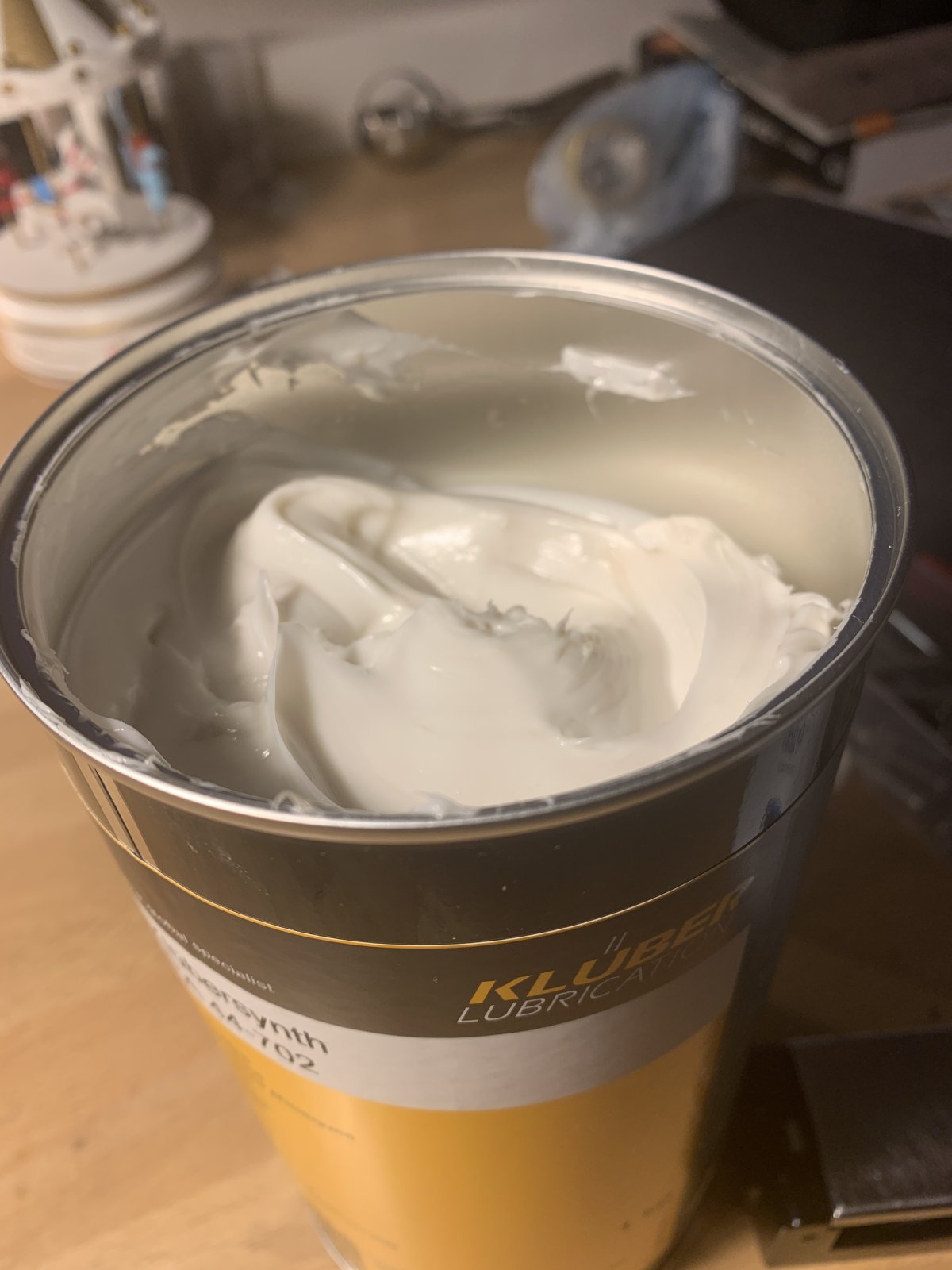

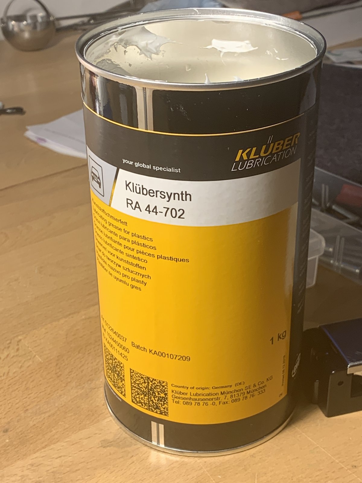

    I have just received the most expensive lubricant I have ever seen! :)
    KlüberSynth RA 44-702
    The 1Kg can sells for the ridiculous amount of 327,82€ (~350$US). It was made specifically to enhance the "haptic qualities" of mechanical constructions :). You can get it even cheaper for 264,70€ (~300$US) per Kilo if you are willing to buy the 170Kg barrel for 45.000€ (plus shipping, handling and tax!). Crazy!
    Here's the story behind:
    With the AASD Servos, I have noticed that they are suuuuper smooth over MOST of their operating envelope! Generally speaking, I can certainly recommend them for use in motion sims. They move the rig (30Kg) up and down and all around easily, but with my 95Kg of an adonis-like body in it, I noticed some strange "artifact". When the motors retract very slowly with a lot of weight on the rig, the servo control loop creates an oscillation of ~10-20Hz.
    I assume it comes from a combination of factors like...
    • the resonance frequency of the rig
    • the blocking and unblocking of the ball nut under load
    • the friction (static vs dynamic) in the Igus bearings
    • elasticity in the belt drive
    • elasticity (torsion) in the ball screw
    • the servo control loops (torque/speed/position)
    I have looked at and read about every one of the 250+ parameters in the servo drives and played around with ~20 of them over days to no avail. "S-shaped smoothing" on the position loop did give a tiny little bit of an improvement, but at the expense of finer detail in the motion getting lost.
    To be clear: Under forward motion it's all fine. Under faster moves it's all fine. These servos are insanely strong! It's just those very slow retract moves that cause the stuttering.

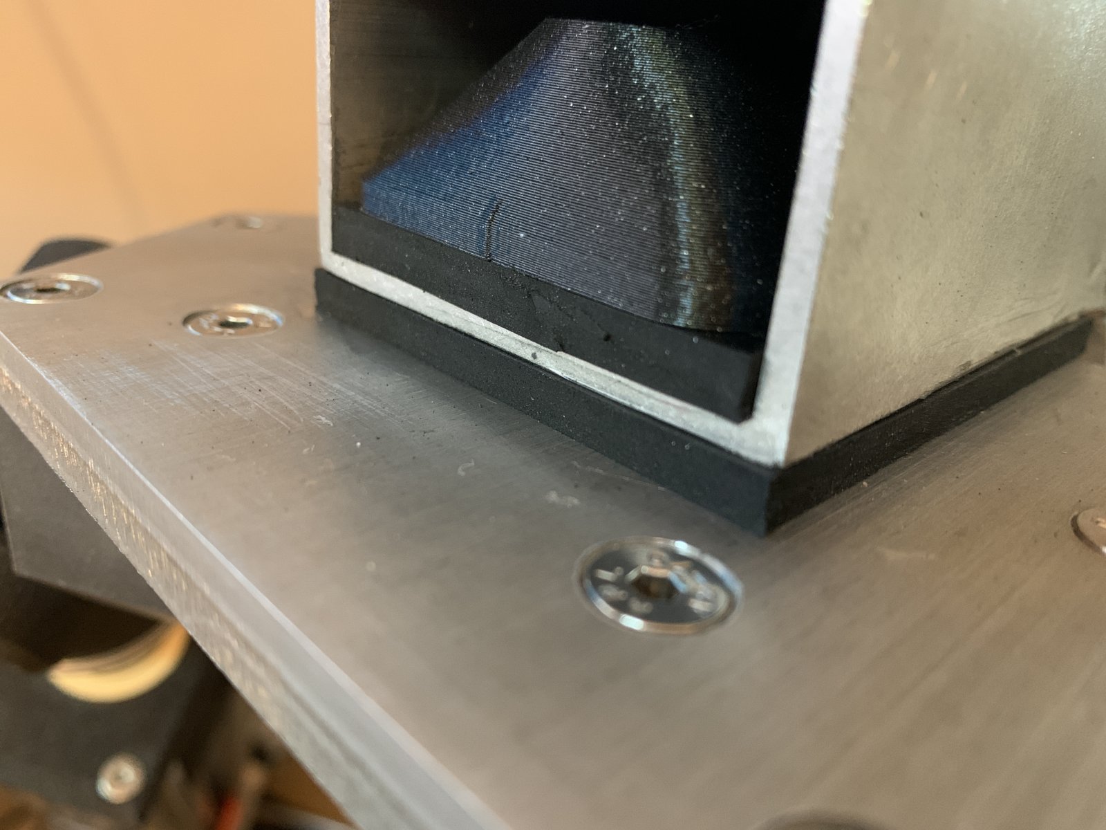

    Here's what did the trick:
    I put 5mm rubber pads between the frame and the actuators.
    Actual hard Rubber (SBR), not the Sorbothane I used earlier. I put it on both sides, outside and inside to avoid ANY metal to metal contact. That alone reduced the slow-retract-stutter by about ~70%.
    Additionally I applied S100 (high quality, low viscosity motorcycle chain lube) to the ball screw to actively generate dampening inside the ball nut. That removed another 10% of the stutter I'd say.
    Encouraged by the promising results with high viscosity lubricant I started looking for even higher viscosity products and found a German company named Klüber with their KlüberSynth RA 44-702. It was made specifically for applications that require dampening. It reduces static friction like any cheap lubricant does, but intentionally increases dynamic friction! Now the motors have to actually work to crank down the rig. Even with a heavy person in it! That eliminated the load changes in the motors and the 10-20Hz stuttering is almost completely gone. Probably just 5% of what it used to be. If you didn't know it was ever there, you wouldn't notice it.:thumbs
    Cheers, Dirty:)

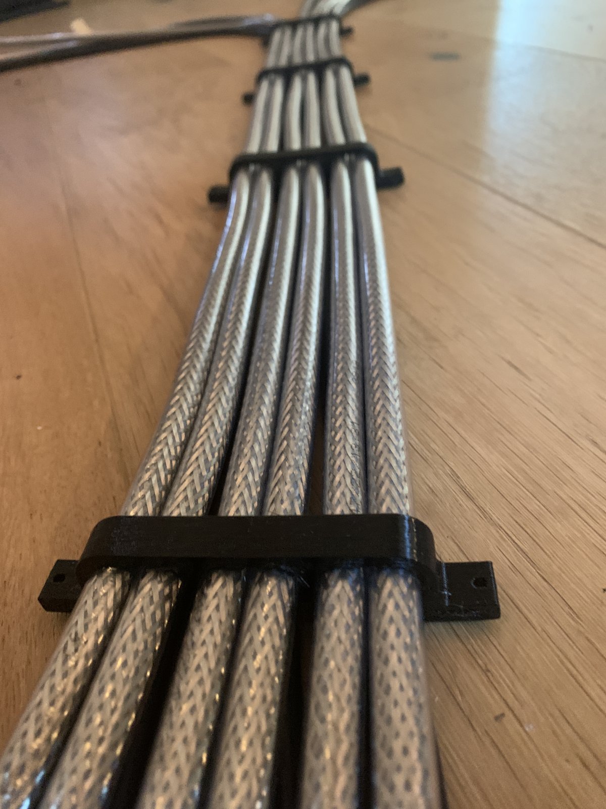

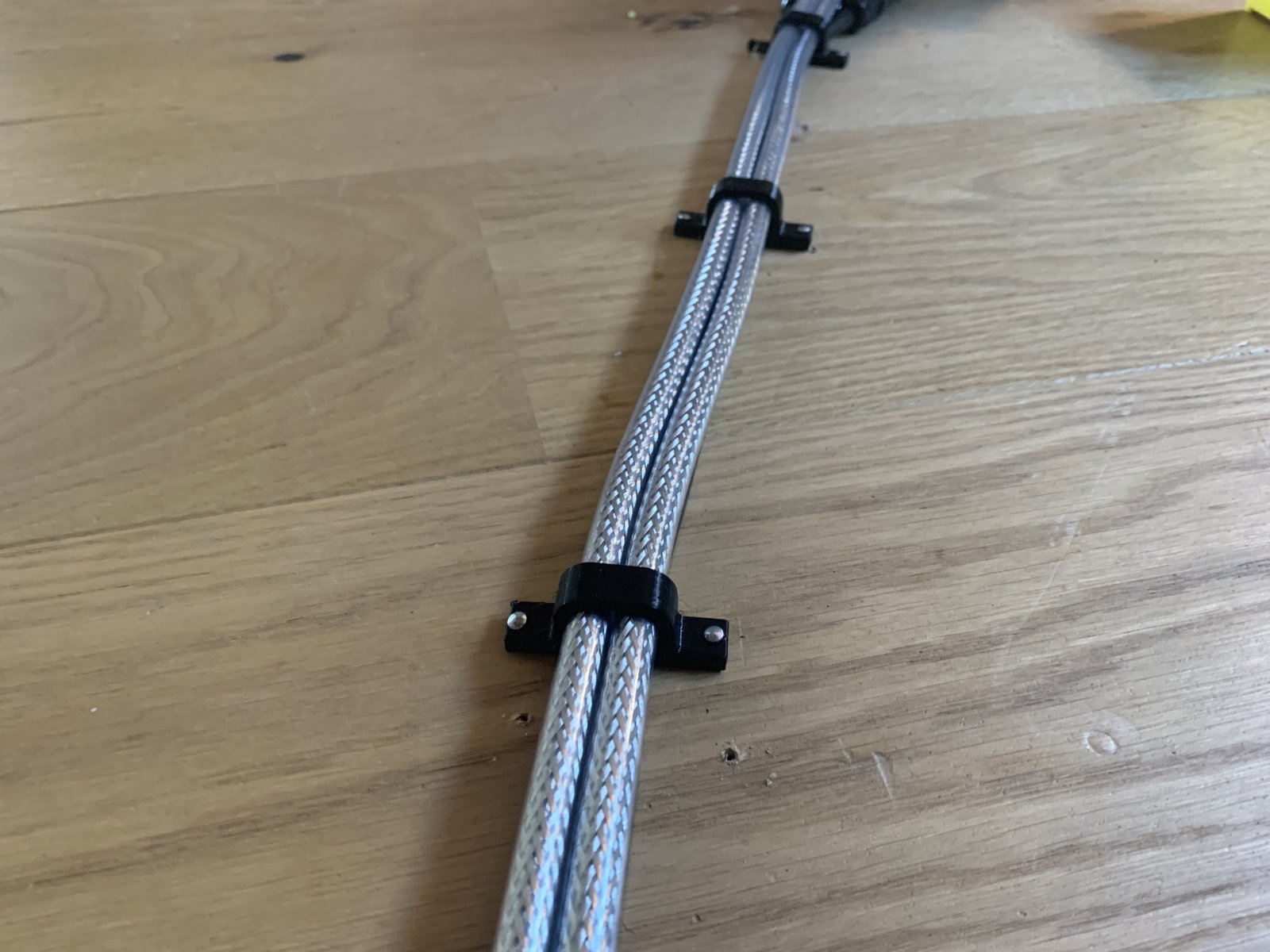

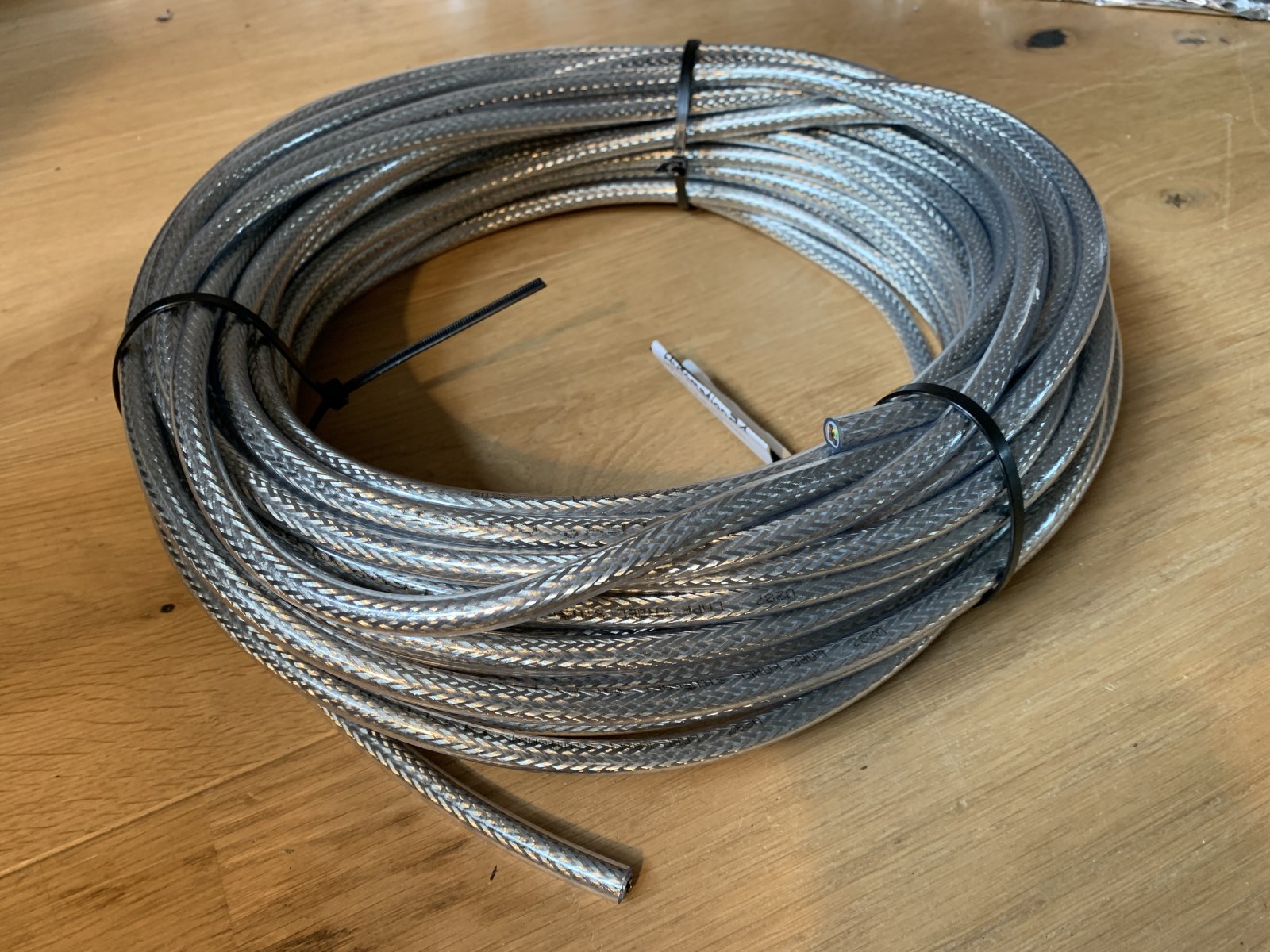

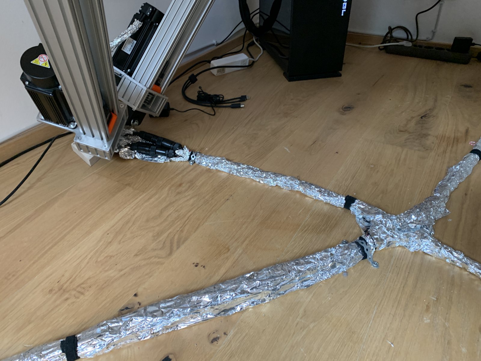

    I have finally replaced the unshielded servo cables with proper shielded cables of good quality.
    What used to look like this...
    ...now looks like this:
    The EMI is not gone completely, but greatly reduced. Now I can (gently) touch my Inxed HMD without getting immediate greyouts and other periphery devices work flawless again. At 2€/meter not cheap, but worth it!
    Cheers,.. Dirty :)

    have a look at what we call waffle pads, I use 2sq inches under big package units and heaters.
    It is made of NBR and has a pattern like waffles on it.
    It makes a big difference from solid rubber like rain and thunder.

    Just some tips and thoughts on EMI:
    Next thing you could do is to put the cables into a metal cable duct (and connect it to ground) for another shielding layer.
    Did you ground your rig after you put the rubber in between?
    Your cabinet has a glass front - replace it with metal. Is it all connected to earth?
    Use the proper cable glands to connect the cable shield as good as possible.
    If you earth something - use thick wire like 6mm².
    Run power and data cables apart from each other. More distance is better.

    I did take a look at it before. I am not sure if there are different levels of firmness, but the product I had in my hands was very soft. Softer even then Sorbothane. If there are different firmnesses available, I will try to find some harder variant of it. In general, I think you're right: NBR is a material with many of the right properties!
    For example, it absorbs energy and converts much of it into heat rather than bounce it back into kinetic energy. SBR instead bounces back much of it. I will keep looking... :)
    All in all, I can say that 50ct worth of rubber have made a difference in the smoothness of the motion that otherwise probably only a 300€ ball screw would've been able to make.
    Definitely something I'd recommend everyone!

    Thanks for the advice. Interesting thoughts there!
    Over the weeks I learned that the fight against EMI is not something that you win with a single panacea-measure. EMI comes from different sources, takes different pathways, and shows up in different spots with different symptoms.
    For example, when I used the Thanos board to drive the servo for the first time, I noticed that my joystick kept losing the connection to the PC. I suspected the AMC AASD board (changed firmware), I rewrote the serial com code in my software (and actually found a few bugs on the way), I tried another joystick (which apparently had better shielding, so it worked).
    I later noticed that the HMD grey'ed out regularly, that the lighthouse stations lost tracking, that the keyboard started missing keystrokes, etc....
    All kinds of problems that had no apparent connection between them. No single part of hardware that could've been the cause.
    Luckily @cbailey pointed me to EMI, otherwise I would've looked everywhere but seen nothing.
    As diverse as the symptoms of the problem were the solution(s): Shielded cables, Ferrite cores, proper grounding, understanding that a SINGLE point of grounding is better then multiple, grounding the rig itself....
    EMI is still present to a certain degree, but with a few measures it is now manageable and normal operation is possible.
    I still have to ground the metal cabinet (thank you @Dschadu!) and maybe even pack the motors in foil.
    Dirty :)

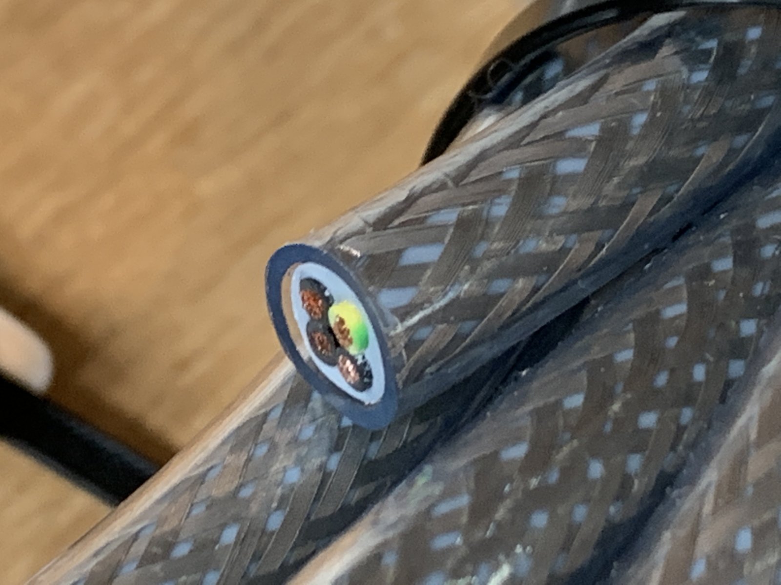

    The cables I used are these:
    https://www.automation24.de/artikel/7780
    ...and I have soldered the grounding/earthing wire to the shielding braid to get a reliable connection. I am sure that a professional could substantially improve the shielding capacity but it is OK for my use case as it is right now.
