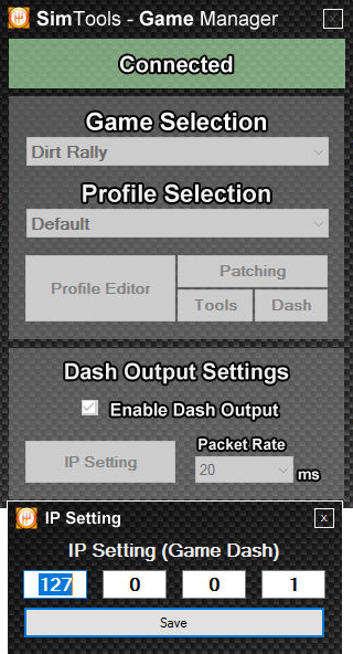

    I'm using game dash for my speed based fans only.
    So far every race game works, except Dirt Rally.
    I have approached the installation for DR the same as all other working titles:
    -Installed the plug-in
    -Patched the game
    -Checked the dash settings in game manager
    -Set the correct values in game dash
    The settings of my hardwaresettingsconfig.xml in the Mygames/Dirt Rally folder
    Setting in Simtools
    Settings in game dash
    Simdash starts but every digit in the dashes stays at zero.
    Since i'm not using motion, i have made no adjustments in Game Engine at all.
    I have followed the same process for all race games and they all work, except Dirt Rally.
    I already have done:
    - Steam integrity check of DR
    - Reinstalled the DR plug-in
    - Start the game without Simcommander (which i need for my AccuForce)
    - Port forwarding to 4123 with SC4
    - Tried codemasters proxy server
    I really hope that @SilentChill, @Pitt or @RaceRay can help me out.

    The problem is back :(
    A couple of weeks ago my pc died when i pressed the reset button. Had to install everything. Now everything works fine again except........... Dirt Rally.
    Again no wind and the dash only shows zeros at start up. I even copied the hardwaresettingconfig.ini from my old installation into the mygames/dirt/hardwaresettings folder, but no go
    Reïnstalled the plugin's, the game, simtools........... no sure what to do now??
  11. value1
    Jan 9, 2011
    2,192
    Zug, Switzerland
    14,184Coins
    +3,359 / 12 / -1
    Have you Enabled Dash Output and set the IP address correctly?

    Yes i did. Just checked it again to be sure.
    Followed every step

    Did some further testing this evening, with the hardwaresettingconfig.xml file from the previous installation that worked fine:
    - Simcommander (GS4): Works
    - Platform manager (NLMv3) : Works
    - Dashmeter pro : Works
    - Simdash (windsim) : Does not work
    To test if the data output on port 4123 works, i have changed the port settings in the dashmeter pro settings ini file to 4123 and DMP works fine.
    Prelimenary conculusion is the hardwaresettingsconfig.xml is configurated correct and only simtools + simdash is not working. All dashes remain at zero.
    All other games work fine and have the wind sim that i love so much.
  14. value1
    Jan 9, 2011
    2,192
    Zug, Switzerland
    14,184Coins
    +3,359 / 12 / -1
    Actually this is what the plugin is supposed to do in the first place. Strange, that you had to enter this manually…
