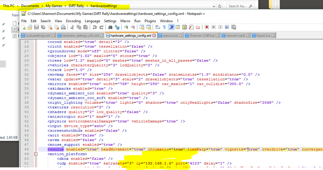

    Prob the same thing as me, go where you patch the game, the folder, open the config file and find the IP address...manually change it to your other computers IP address

    so.. I'm wrong.... Working in NON VR fine, have been tuning, but as soon as I switch to VR no input to game again... I will continue to search...

    I don't think so as EVERYTHING else is working properly and again, it works fine in non VR mode.
    One thing I did forget to mention is I store all games on my D:/ Drive not C:/

    So you are running VR on Drive "D" patching to where?

    hummmm.... I guess my minions came in and fixed Dirt Rally in VR...
    Home from work today, started it up just to try and works fine in VR now.... Crazy computers...
    Anywho, thanks for your help guys, now to just figure out the heave sway surge thing and I'm set.... until....

    One thing I did do just for kicks and giggles, was remove patch then reinstall patch in the same location. It must have just taken that time.

    Some times the game runs fine with motion, then the next time no motion. It always connects to the game but not always produces motion. Typically I unpatch then repatch and it works.
    Just an FYI if it means anything to anyone

    it can be as simple as that tbh.
    or running it as admin when you boot up simtools
