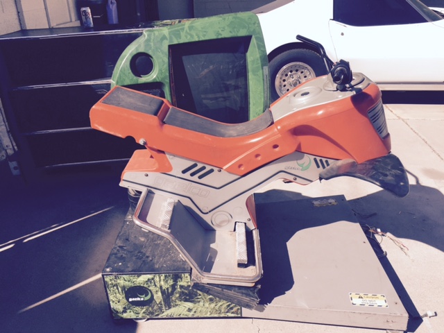

    here is a pic, it is a quad dirt bike and has 2 motors

    a real beauty :D
    did it came with a monitor and a stand for the monitor???

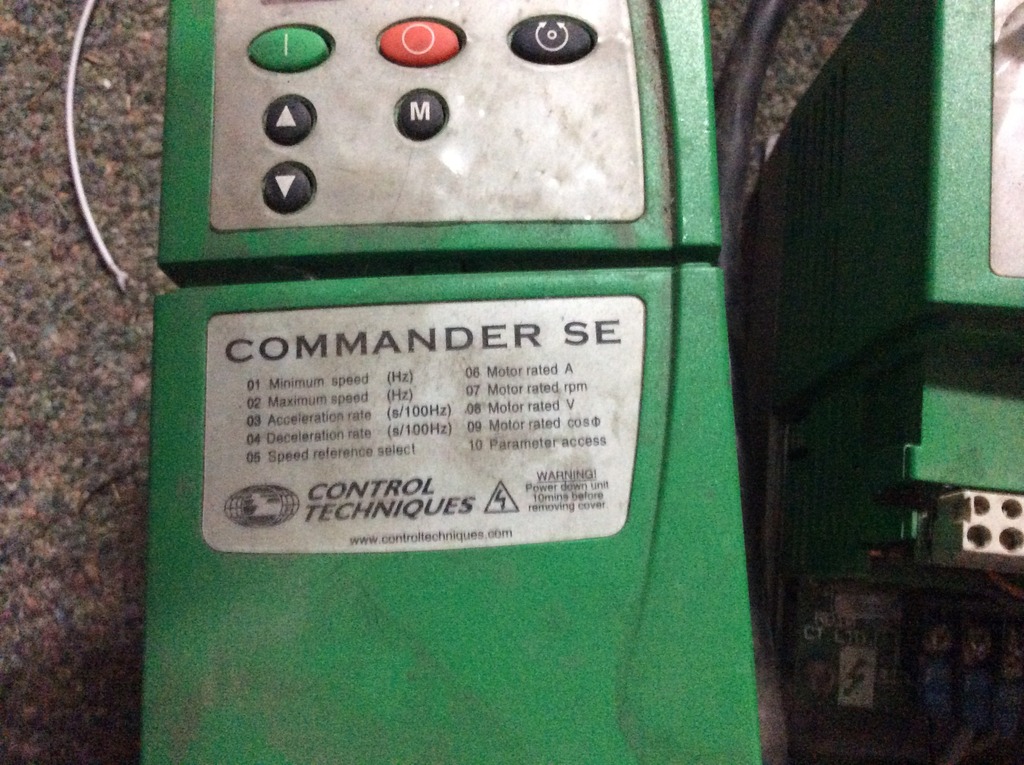

    -- just a last question... (i was reading about ac motors, and as long as i undertand, your original sim should had a vfd motor countroler... it is something like this picture??:
    (the box) or just a bunch of confused cards and wires?

    Yes it does come with them, mine have green covers and are digital instead of analog control. the thing is i do not know if they are good and i am very particular with death, i want it to happen later rather than sooner, lmao at myself, and messing with that type of voltage can get you kill. so I was more looking for replacement motors. it should not be too hard to find.

    Don't worry so much as they are safe for such arcade machine ... and for inverter digital configuration they are easier than the Idiot Phone :grin:grin .
    I just need to inform you that when replacing motors in any application you search FIRST :nerd by the equivalent motor Horsepower ... even if you're going to use different operating voltage or current ... you need the same performance after all .
    By selecting big DC motors like 300-400W or more you'll find them very very expensive like the "Car Starter Motor " where in best cases does not withstand 5 minutes operation with a lot of problems due to size + a very high price equivalent powerful motion controller is needed + Big Amps. DC power supply unit is needed ...
    So in general life big applications ... going beyond 1/2HP DC motors is not recommended at all .
    This is where AC single phase OR 3-phase motors takes place ... powerful and economical in all cases :thumbs.
    Both supply connection can be speed controlled easily ... but the single phase motor does not reverse its direction electrically " you have to change the brushes angle to go reverse " ...
    An AC 3-phase have both options flawlessly :thumbs ... and by using a VFD "Variable Frequency Drive " [the green one you have] you can control the speed and direction easily from a computer/control unit .
    Just take your time to absorb the new information and you'll find it very easy to go with .
    Ask for any details if you need ...
    Edit : please post the VFD's model No. and if it came with any extra control boards and sensors ... Full details to see what you've got there .

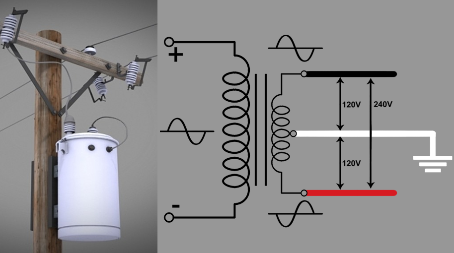

    - can we connect a AC 3-phase to a 110v american power outlet (the one we have in our homes-? or you have to go for an industrial instalation? (3-phase sound like a lot of voltage, is it?

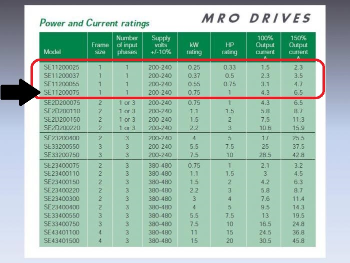

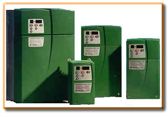

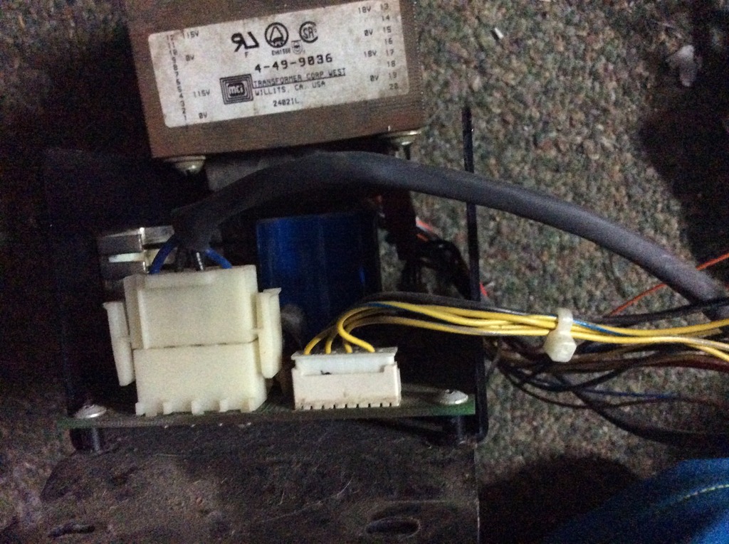

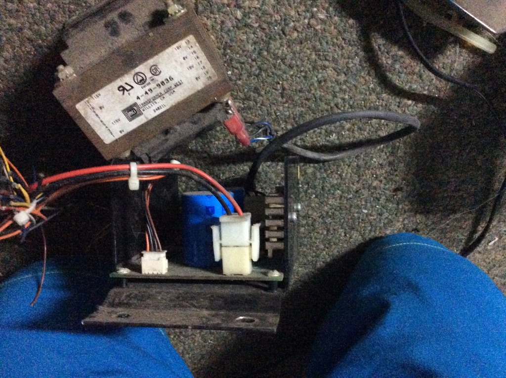

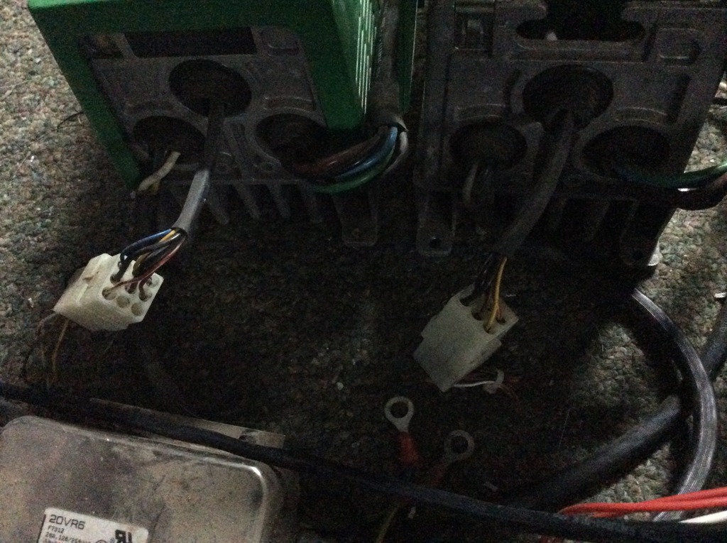

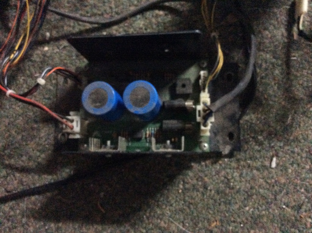

    Very interesting @cruzebabuze :thumbs ... But where are the rest of sensors and control/Game boards ?
    Let me see them to confirm if the Arduino will be easily connected .
    - The first photo looks like a power supply board ... you may need it if it is working or you will use additional PSU .
    Just give me a clear photo for its up and down sides to get you where the outputs/input and the switches are .
    - The second photo is the VFD Commander SE ... and I guess from the sticker size it is one of the Frame 1 single phase 200-240V input ... and looking back to the posted 0.57kW motor photo ...
    So the model should be this one ... SE11200075 .
    Here is the Command SE user manual ...
    http://www.emersonindustrial.com/en-EN/documentcenter/ControlTechniques/PDF/catalog/COMMSE.pdf
    Here is the advanced user manual ...
    http://www.realimpeks.co.rs/download/emerson_commander_se.pdf
    You are going to use the analog control if you are not already using it ...
    How many motors are there ?

    For a quick answer the minimum is 220-230V supply line for any VFD up to 1.5-2HP depends on the manufacturer ... more than 3HP a 3-phase supply line is a must .
    Where to get 220v at home in the US :
    For the american power lines ... I need to inform you @ferslash that you are already working on a 220-230V power grid ...
    The issue is there is a step-down transformer in front of each home "I guess" .. to reduce the voltage and give 2 110V lines in the distribution service panel ...
    If you don't know how to get an outlet with a 220V 30A at home ... you must hire an electrician Or you'll go straight to Heaven :p .
    http://www.heatzone.ca/tutorial-view/basics-of-homes-electrical-system/

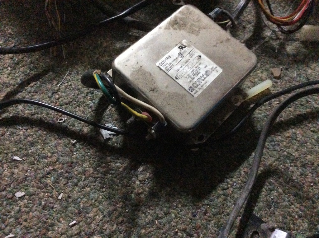

    I just have also the game CPU and board, but I do not want to use it, I am putting the sim ware from this site. I will be taking a photo in a few min and post it. There are 2 motors connected to a gearbox that is slow for sure. I hooked a harbor freight winch to it and it was way but way to slow. I did not see any sensors beside the potentiometer on each gearbox. But let me check again.The only thing left is a big ass transformer that probably transform 110 into 220v.

    Exactly why I am scared of using the 220v setup. I am from Europe but live in the USA and I know what 220v can do to you. I have a 220v already at my house in the USA for a car lift for my formula race car.

    There are no other sensors or board beside monitor and big power converter. There are 2 motors with a gear box. The gear box has a potentiometer attached to it. There are a few buttons and the lever cable and throttle cables. That is it, nothing else
