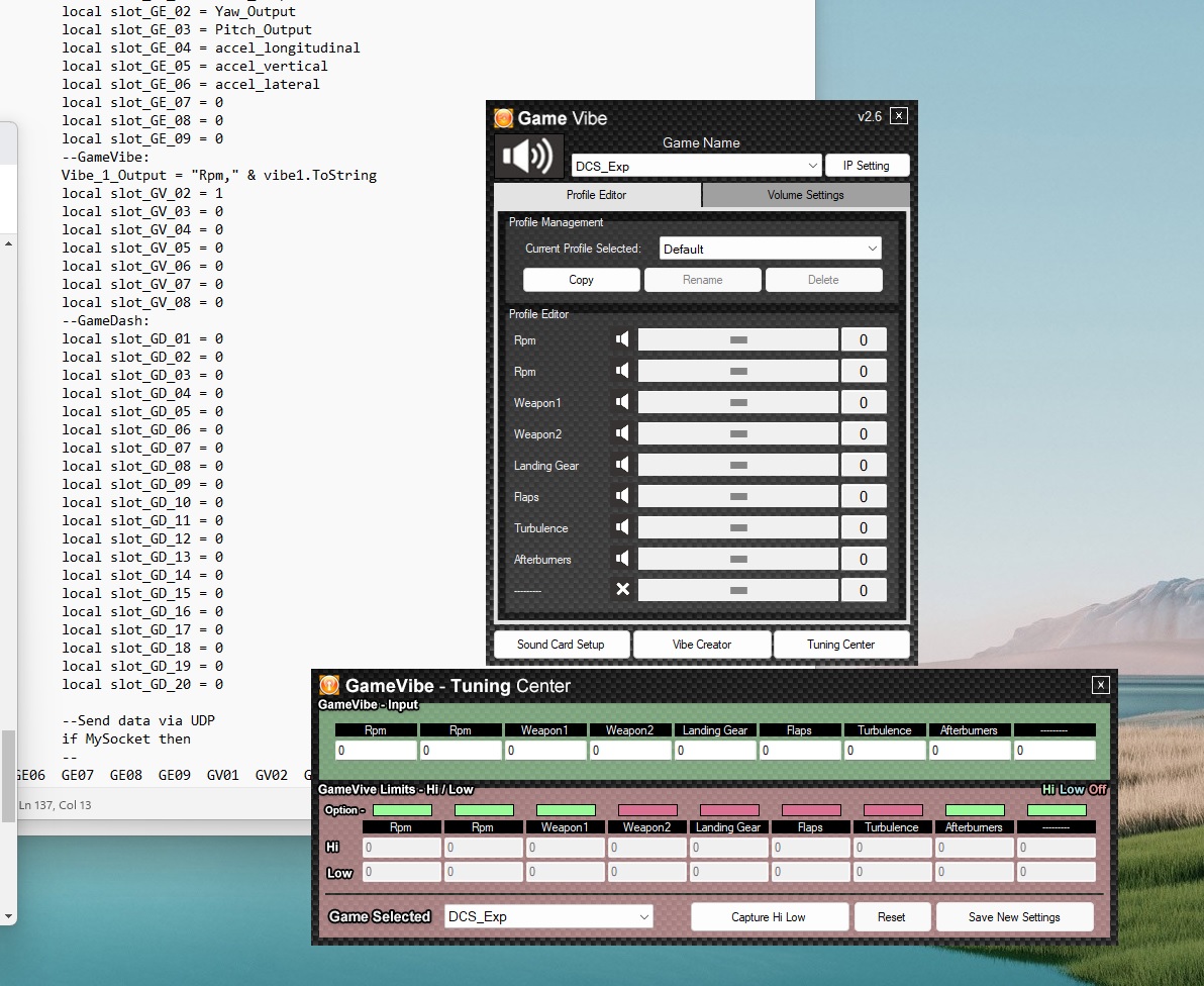

    Hey dirty. I can upload the profile fine and it says Connected and successfully patched. I've edited the lines of code in the actual LUA in the hooks folder in saved games and the main DCS folder but I'm getting no data for GameVibe input in the Tuning Center to be able to capture for the His and lows it says DCS_exp on everything as well. Thanks in advance!! I feel like Im missing a step somewhere.

    By "upload" I guess you mean you used the plugin updater? Can you post screenshots which line(s) you edited? You mean those?
    Do any values show up at all in Tuning Center? Are you using DCS or DCSopenbeta?
    If you can, post some screenshots. Makes it much easier to troubleshoot.

    Im using open beta. yes used the profile updater and successfully patched to dcs open beta. I get no parameters showing up at all in tuning center, they all just stay at 0. (ive gotten this to work perfectly with MSFS so I understand how to use the tuning center and adjust everything). I've tried changing all the lines of code in the LUA file in the hook folder of DCS scripts but as shown in the pic(this pic only shows one though)
    As far as the link you showed changing the parameters, for now I'm only making vibrations for my seat. G-seat is next.

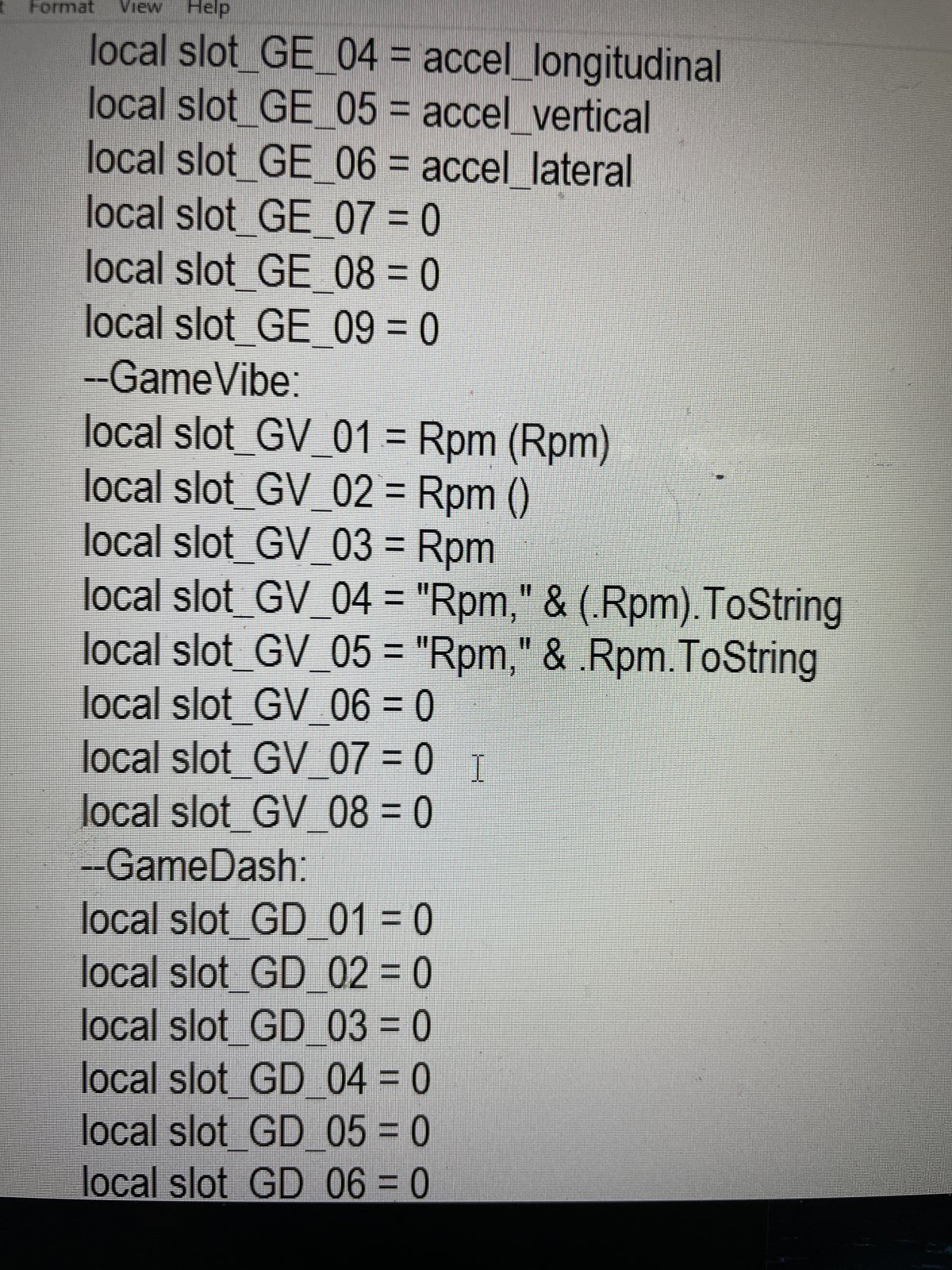

    finally got around to trying this but still no luck. Here are all the options I’ve tried as admin and not. I got the motion outputs to work though so at least that was good.

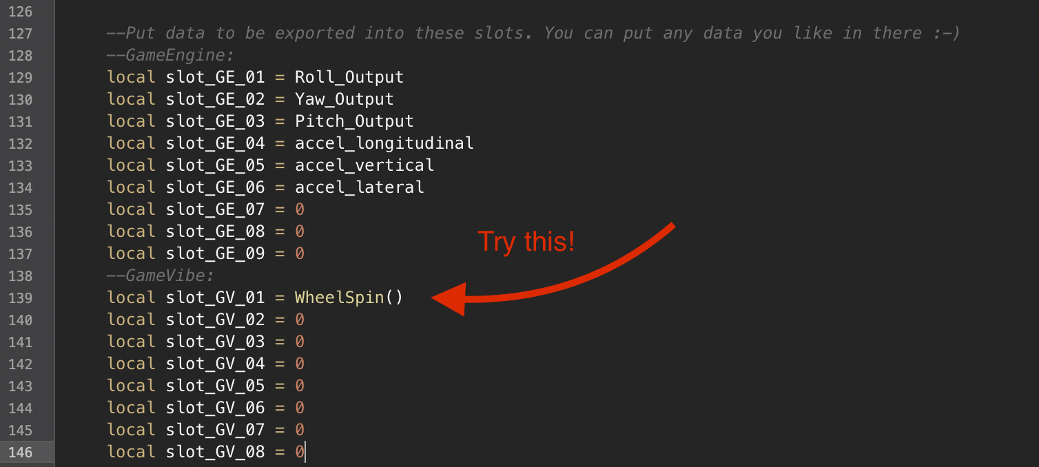

    Two things I can see from the image you posted:
    1. DON'T use Windows' text editor to edit scripts. Use Notepad++ instead. Always. I promise you, there will come a day when you spend 8 hrs troubleshooting code, only to find out that the windows editor (and its somewhat "creative" way of encoding characters) was the problem.
    2. DON'T change programming languages in the middle of a script :nerd The export script is a .lua script. You have added statements in VisualBasic! I hope you can see a bit of humor in that :-D
    Let's go through this step by step:
    1. Install the plugin and make NO modifications. Then restart DCS. Yes, from the desktop. Yes, I know this takes forever. Yes, it is necessary --> You should get NO data in GameVibe.
    2. Change line 139 to read...
    Code:
    local slot_GV_01 = 777
    ...and again restart DCS. Yes, from the desktop. Yes, I know this takes forever. Yes, it is necessary --> you should see the "777" show up in GameVibe. The "777" is just a marker to see if any data is transmitted and received AT ALL. You can use any number you like.
    3. Change line 139 to read...
    Code:
    local slot_GV_01 = WheelSpin()
    ...then restart DCS. Yes, from the desktop. Yes, I know this takes forever. Yes, it is necessary --> You should see numbers show up in GameVibe during TakeOff roll, but zero as soon as the aircraft is in the air.
    Let me know what you observe.
  16. Seth Miller
    Seth Miller New Member
    Dec 18, 2022
    20
    19Coins
    DC motor, Arduino
    @Dirty ! I got it!! thanks so much! It took about a million reinstalls and such to make sure it was a clean lua but finally working! followed all your steps too. have a great day!
