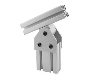

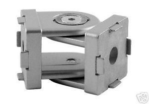

    I'm going to do a half DIY build using the simxperience universal seat kit. I know it could be done cheaper going the complete DIY route but this works for me. Now to my question. What different ways have people used to make the traction loss pivot, I'm not referring to the motors that make it move but rather how people connect the front of the frame to the support. I'll be building out of 8020 aluminum T-slot profiles would any of the following things work?
    8020 Pivot plate
    8020 pivot joint

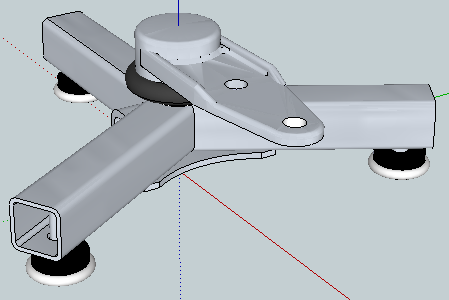

    a chair swivel - descriptions read as if you need pressure downward before they spin

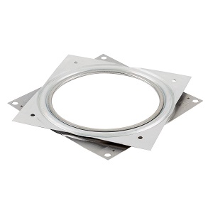

    A lazy susan swivel much like the chair one but I don't know if they are easier to spin or not.

    you could use a castor wheel, remove the wheel and bend the wheel mount flange 90 deg

    I think people have used lazy susan bearings for that purpose before. @Nick Moxley might be able to give you some insights.
  4. Nick Moxley
    17,056Coins
    +2,506 / 30 / -2
    I used a lazy susan on my rig and am currently working with a large 1 1/4" bearing and 4 side castor support for a buddy's rig,
    A Chair swivel and lazy susan would be the exact same thing.

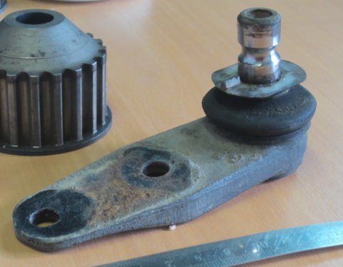

    Personnellement j'utilise une rotule de pivot inférieur avant de Renault Mégane. N'importe quel rotule de pivot de suspension automobile peut faire l'affaire, neuve ou d'occasion. C'est économique et facile à adapter.
    I personally use a lower pivot ball before Renault Megane. Any automotive suspension ball joint pivot can do the trick, new or used. It is economical and easy to adapt.

    @momoclic I think what you propose is interesting but is more like a solution for yaw rather than drift.

    Je ne le pense pas, certes ce n'est pas de la dérive pure mais nous somme très loin du lacet.
    avec plus d'un mêtre de rayon et 15cm de déplacement latéral du siège ?
    Le 2DOF sera juste devant les roues de trottinette.
    I do not think so, certainly not of pure drift but we are very far from the lace.
    with over a radius of mêtre and seat lateral displacement of 15cm ?
    The 2DOF be front wheel scooter.
    21,595
    151,233Coins
    My mistake sorry @momoclic, I thought the pivot was going under the seat, but the video cleared that up to show the proper mounting.

    En fait dans ce cas il s'agit surtout de dérive du train arrière. En cas de glissade avant ça devrait être moins perceptible.
    In fact in this case it is mainly drift the rear axle. If slip before it should be less noticeable.
