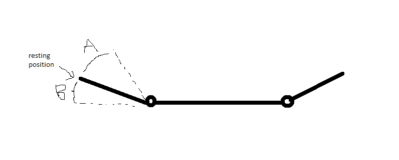

    Hello all, I'm re-working my G-seat, and I had a question about having different axis limiting for each way of a flap. For example:
    Flap movement "A" is larger than flap movement "B". I want to do this because I realize that although it is possible to just not use the negative value in the Tuning Center, there is some detail I will be losing on the "B" side. I do understand that I can increase the negative Tuning Center value so that "B" is half of "A" for example. However, this doesn't guarantee that the flap won't travel past "B", in which case, things will break mechanically.

    The easy way is to go to line 545 (bit below) in the SMC ardunio file and change the minimum axis limit and cropping it. That way you have a hard limit
    Here's mine.

    Another option is to use PT Mover where you can just crop negative wherever you want without any hassle and you can limit each force where you want it. Might not be exactly what you want but give it a look anyways. Its much much faster to check what value your pot is at and is great for testing. There's a remap feature that could maybe be used but i dont quite understand it yet. You also have logistic which is the same as the use % of axis in Simtools
    Here's the link and ive added my config file in the latest mover release so you can just tweak the com ports you need. Be aware you need to change your value range to -100 100 in the upper axis 1 and 2 as i have mine set so that center is at 323 for more range on my hall sensors. Also DO NOT power on or off before turning Mover on/off . PS Roll speed is amazing for Gseats
    https://www.xsimulator.net/community/threads/flypt-mover.13464/
    Im sure some of the great support on here will chip in with some insight too

    Awesome! Thanks a bunch for the detailed response. I'll first try the easy way you mentioned and see if that suffices ( I'm a bit intimidated by the second option).

    My bad, it starts at 483, ive just put 545 in as it brings me to the code.
    Here's the default. replace InputclipMin = to fks 512 to have it stop in the middle.

    YEEEEEEEEEESSSSSSS!!!!! I finally got it to work using your instructions!!! Finally, I'm able to secure the arms without worrying about things breaking :) Thanks a bunch!!!!
