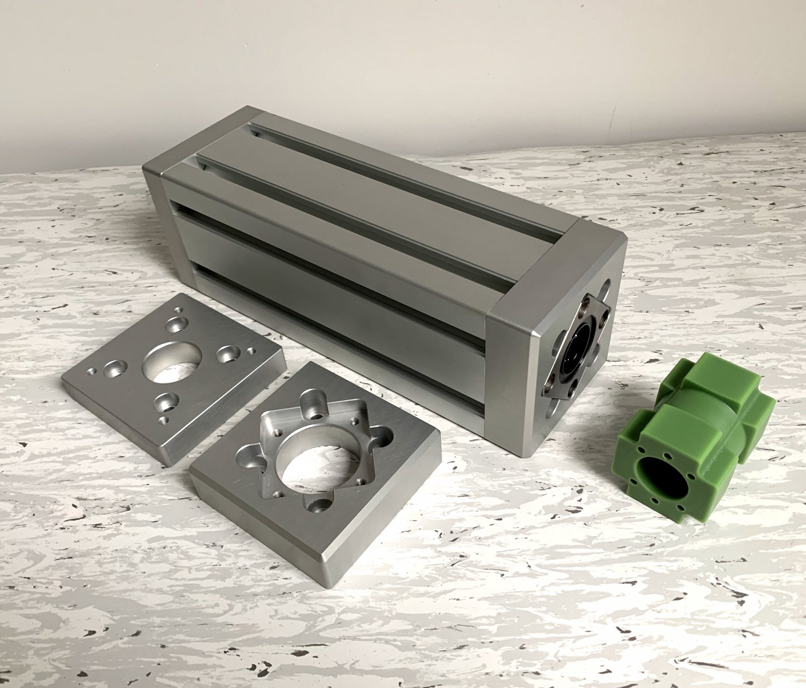

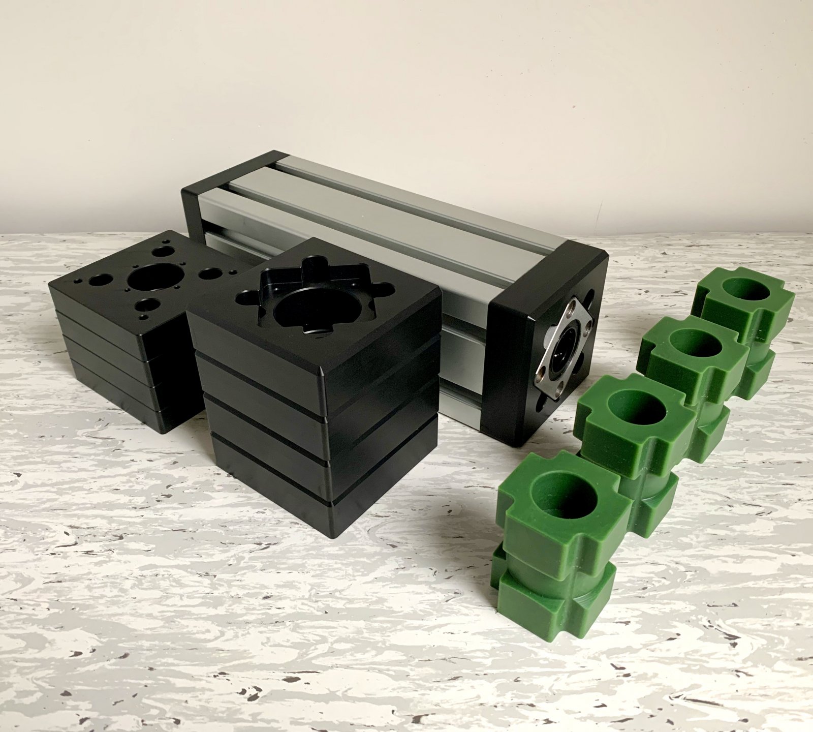

    Hi everyone, I've designed some new top and bottom mounts for the SFX100 and CNC'd them out of aluminum. It eliminates any flex from the actuators and improves overall performance :) The sliders are CNC'd out of a self lubricating plastic called OILON to prevent any wear and tear.
    As you can see the linear bearing sits inside the bottom cover and makes the actuators look cleaner :)
    Next thing in production are CNC motor mounts.
    I can still make these parts if anyone is interested in getting them for theirselves.

    @Luka Usenicnik do you make the "bump stop" part too? It is also usually 3D printed part inside the profile.

    Hi, yes its possible to make those parts too :)
