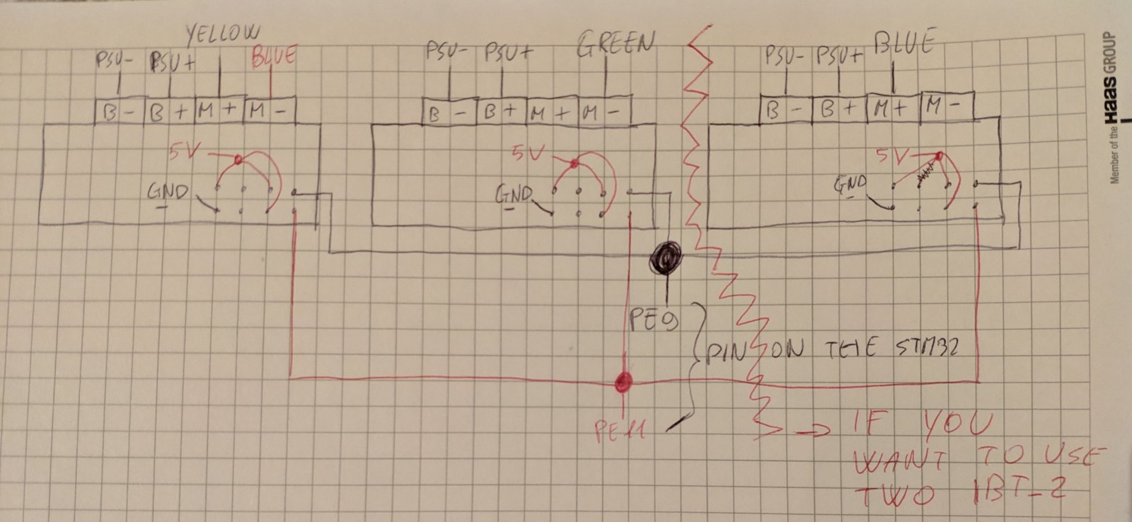

    Hi guys, sorry for my bad in these days I receive my 10 inch hoverboard wheel with a 350w motor and I try to use the IBT_2 for controll the motor like suggest @danove_b . I have a STM32 and use Mmos set to PWM(H-BRIDGE) as interface to the board and connect the pin like the project with MY1020 (Brush-motor). The problem is that the motor is in stall mode all the time and it's produce a small force when I rotate the encoder to 900 degrees the motor lock immediately like a true sterring wheel and then if I rotate the encoder in the other sense the motor return in his stall mode. First I use the hall sensor like a encoder but don't work the steering lock with my encoder works and I use two IBT_2 then I try with three IBT_2 one for phases and it's the same problem of stall mode all the time.I try different frequency in Mmos but the motor have the same problem. When I use RFRwheeltest and put the minimum force in Mmos to 3% the motor moves and then it return in stall mode. I attached a link of my work: https://drive.google.com/drive/folders/1mpiiB-54IC0ox19TH7jdAYaqu4d7rlcN?usp=sharing .

    Hi @RSP nice work , i have built 2 test setups fir Brushed motor DD FFB wheel and would like to try to get my Hoverboard motor setup working for test comparison . may i ask if you have even a basic connection diagram for you hover board motor test, i realize it not a fully working system yet , but as i cant get hold of the ST 11MH08 id like to experiment with the BTS7960 option . the description you posted above #146 sound like an option i could investigate ..

    Hi sorry for the horrible draw there are two options to connect three IBT or two. I try without connect to the 5v but only connect the GND the IBT and the wheel works with Assetto Corsa but not works well with RFRwheeltest or Wheelcheck.
    With the 5v disconnected the motor don't go in stall mode and works in the simulator (for this setup I try only with two IBT but things is the same result with three). What do you things about this @danove_b ?

    Yea, you still need code for the BLDC. The hoverboard motor is a 3 phase. You try to control it with 2 phase.

    still working on the project with the IFX007 shield but since I am using more hoverboard motors for another project the dual IBT2 option is interesting because it is cheaper.
    Please can someone with more knowledge than me give a schematic of the Arduino/IBT2s connection?

    @RSP @BiT0 @wannabeaflyer2
    As @danove_b explained you cannot directly feed the output of the AIWave Arduino or the STMDiscovery FFB board to the IBT2s or the IFX007 to drive a BLDC.
    The PWM output on the AIWave Arduino or the STMDiscovery boards is designed to control brushed DC motors. Brushed DC motors have two wires leading to the motor coils. With the clever arrangement of brushes and contacts inside the motor the amplified control signal from the FFB boards drives the motor. One H-Bridge (IBT2) is sufficient for the two motor phases. The direction signal of the FFB board tells the IBT2 which side to activate and by that what polarity the motor wires get.
    A brushless DC motor on the other hand has three wires leading to the motor coils. But there is no clever arrangement of brushes and contacts to guide the current into the correct direction within the coils. That has to be done externally. That is why danove_b is programming an Arduino to direct the right amount of current, in the correct polarity to the coil(s). I am using the currently not available combination F303RE/IHM08M1 for that purpose.
    An overview of a simple control method for a BLDC can be found here. They also show basic schematics for a driver board. But you still need a controller board to send the correct PWM signals to the three 1/2 H-Bridges of the driver. The shown control method is not a good one to build a DD-Wheel.
    A more sophisticated control method is space vector pulse width modulation or field oriented control. You find a link to a good description in post #3 of this thread. SVPW/FOC leads to higher torque and smoother movement off the motor. The F303RE/IHM08M1 combo is using that method and danove_b is adapting that method for his build.

    Thank for yout explain this is only an experiment and I know that this type of motor require FOC or SVPWM to controll the three phases. Or trapeziodal wave but FOC is the best method to obtain the maximum performance of the motor.

    My question was about using not a single IBT but two, to handle the 3-phase like danove_b pointed few posts above. That would be a cheaper (about half price) solution compared to my IFX007 shield.
    Was asking about a trustable schematics for the wiring of the Arduino (withe the bldc control software not the AIWave) and the two IBTs
