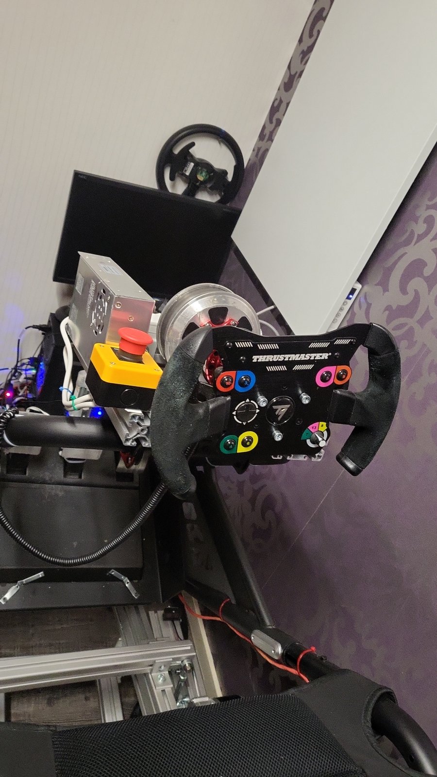

    Question... everything seems to work(Odesc 4.2 and FF beast). But....
    One problem I have, is that when with no game, just on power...when I turn the wheel from left to right and let it loose it moves very aggressive to 1 side.and keeps spinning...what to do about this? Also when I keep turning it..suddenly it speeds up to that direction
    thanx!! :)

    And the wheel is 100%... very impressed by the force and speed.
    Only thing is that I cannot get Rfactor 2 working.... steering and pedals are working, force is not working.
    I tried all things (remove Json files, set FFB positive and negative)...
    So anyone the golden tip...or can share their 2 .Json files?

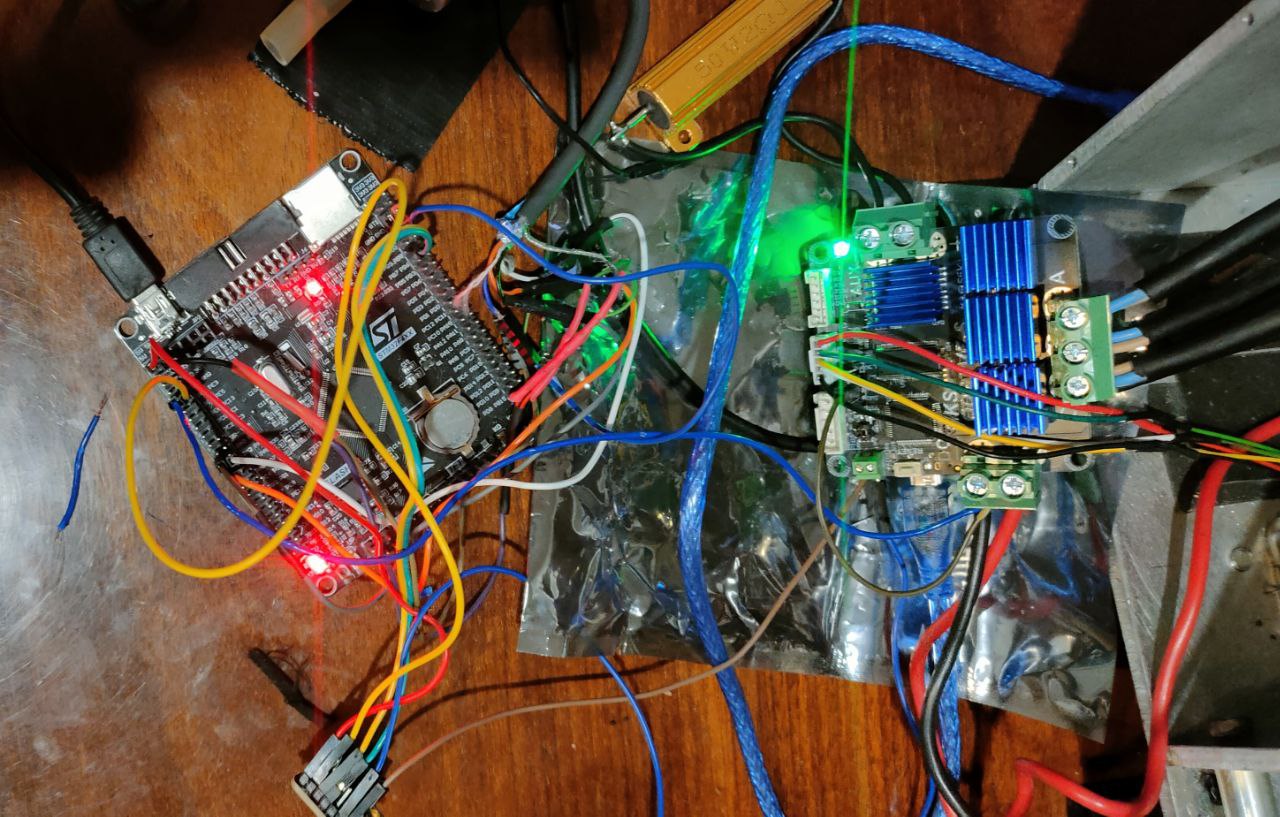

    Hello, came back to my project, have hoverboard motor and odesc v4.2, but do not know what software and firmware to use. If someone would help my with that question it will be awesome, THANKS!
    (Also do i need an ST-Link for an things to do??)

    Try the https://ffbeast.github.io/
    Compact solution. You shouldn’t need an stlink to flash the board, usb and dfu mode should do it

    DC motor
    Do i should connect odesc to arduino leonardo? Or what, trying to flash firmware to odesc, but that gives me nothing when opening ffbeast hardware setting ui, it doesnt recognize as device or any controller
  16. Chris_Beeves
    May 31, 2019
    380
    2,196Coins
    +259 / 4 / -0
    Everything runs on the odesc, but you have to flash it with a custom firmware and get a licence key from the author.

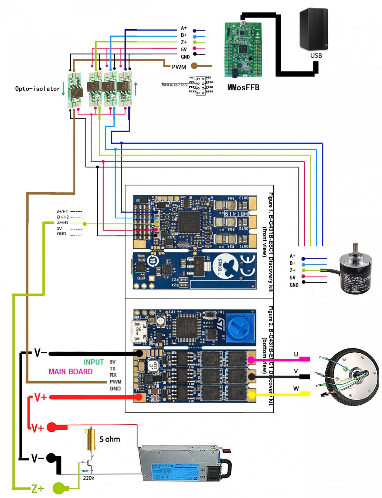

    license key? for stm32cubeprogrammer?
    where should i use it?
    Also do anyone have wiring diagram,because iam now with that type of motor controller (odesc) and 3 phase motor

    For activating the FFBeast unit after you flashed it. It's not necessary though if you don't need to add buttons and stuff.
    The motor wires can be connected in any way you want.
    The encoder is connected to 5V, gnd, A & B (leave Z free)
    The resistor to the AUX port
    That's pretty much it.

    So connecting arduino is not needed? i only need to flash firmware to odesc v4.2 with stm32cubeprogrammer and it should work after wiring done?
