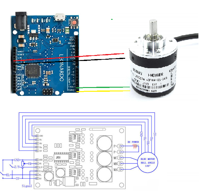

    Hi everyone.
    First I hope I can keep a conversaation with my poor english.
    Now I tell you that I´ve started with this project last week. I´m "handyman" but electronic s not my business.
    ok.
    Here´s my BOM:
    1) BLDC hoverboard motor
    2)JYQD v7.32e ESC (know that´s not ideal but is what i have to start)
    3) Arduino Leonardo whith EMC software/firmware
    4) 600ppr rotary encoder.
    Yesterday I was able to make the motor work with the esc using a potenciometer. The same start with arduino and encoder communicating with PC (proved in Automobilista 2 & iRacing)
    Now (and here s my first "with a little help from my friends") I don´t know how to connect arduino pwm to ESC. I dont´t know wich pins of arduino use for that.
    Ok friends.................too much for the first time
    THANK YOU!!!!!!!!!!!!!!!!!

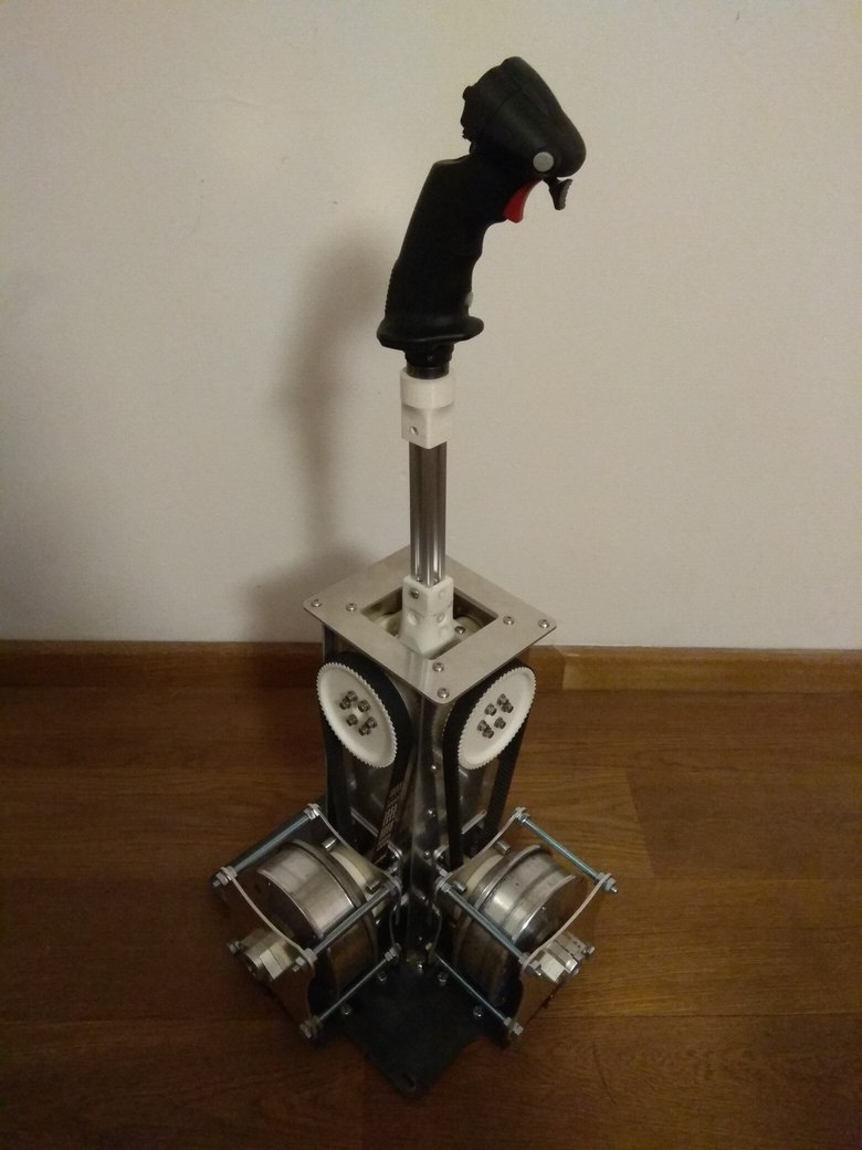

  14. Roman Smoliakov
    Roman Smoliakov New Member
    Oct 31, 2020
    20
    161Coins
    +30 / 0 / -0
    It works awesome. A bunch of guys copied my project and build their versions based on it.
    And i build FFB joystick based on two axis wersion of it:
    BUT. Because of global chip shortage it become very difficult to find components for it with resonable price :(
    That's why I developed custom firmware for ODrive and plan all my next build on it. It is compatible with ODESC3.6 as well. Schematic of connection as simple as
    And all development plans are for ODrives/ODESC3.6. Because it is easily sourced on aliexpress.
