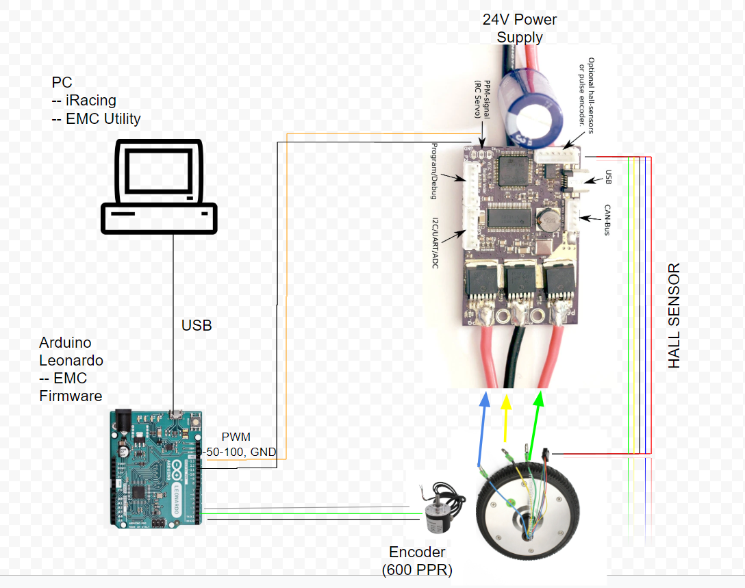

    Hello everyone I have been watching this thread for a while and I am currently building my own hoverboard FFB wheel using the 3d print files that @Feisty created. My current build is using an arduino pro micro running EMC utility, a 12v server psu, B-G431B-esc1 motor controller, and 600P/R encoder. To get my build running the only thing I am having trouble with is setting up the motor controller. Is there a specific firmware I need to load onto it? I'm definitely new to this type of thing and any help is appreciated thank you!

    this is very interesting, I saw the creator of EMC say that VESC is compatible with DC motors, I am thinking of trying! I have a 90v 1a dc motor

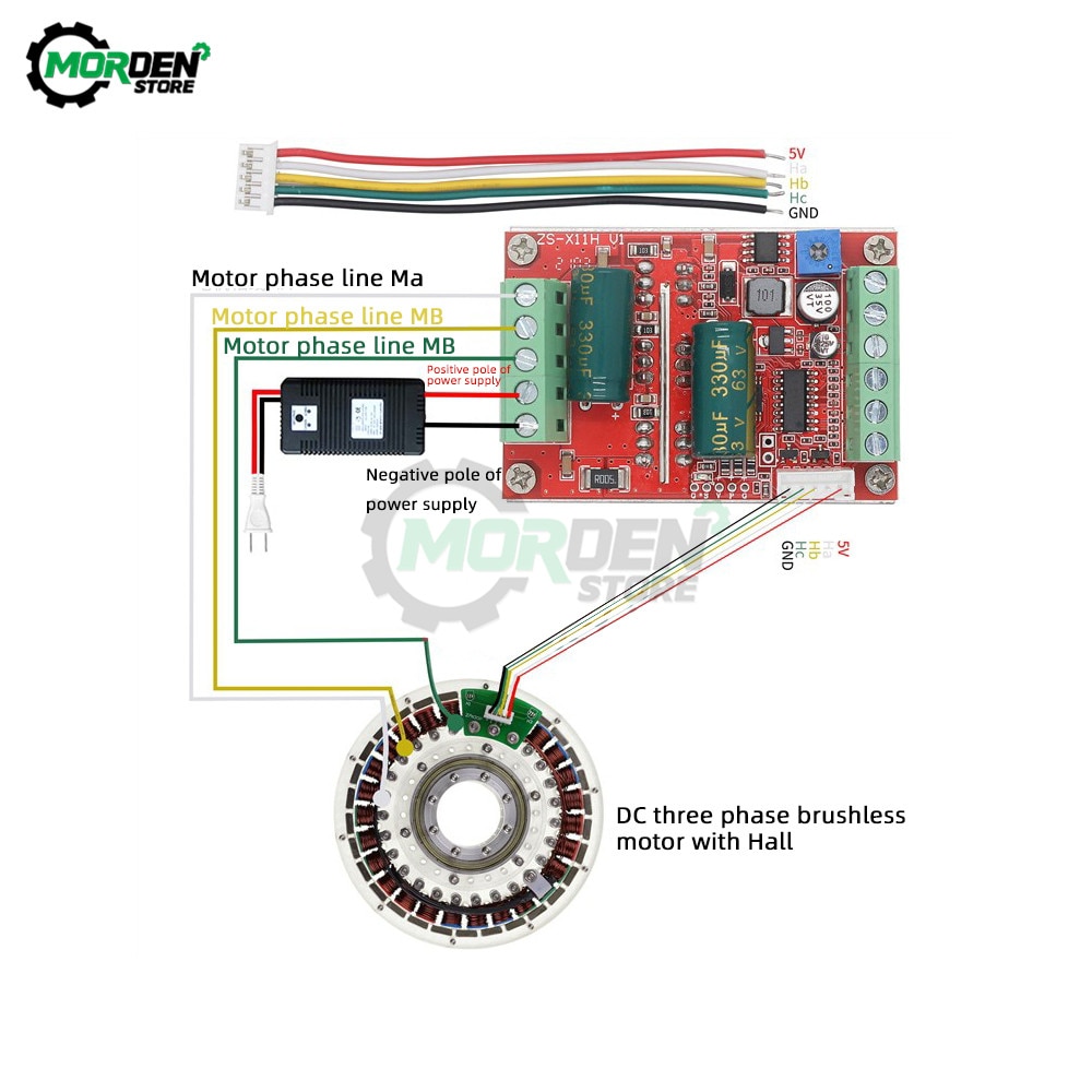

    A few noob questions:
    1. Can I use 2 hoverboard motors for a basic 2DOF sear motion simulator instead of a wheel? If I can get them free they look appealing. Can this kind of motor be used with such task?
    2. They are 36V, so what do I drive them with? Most motor drivers are rated up to 27V. Should I drive them with 24V or 12V or what?
    3. A very noob question: as much as I want to, the seat frame/platform can't be perfectly balanced. Let's say it's in neutral position, without any forces applied to the motors (I'm flying straight and level) So what is preventing the pressure from the whole badly balanced rig to rotate the motors? Or are the motors rigid when energized and are constantly applying power to keep them from rotating?

    Hello!
    Cool idea!
    1. Technically, yes. But not without heavily modifying them
    2. Depends on how you want to use them, but the lower the voltage, the slower they get. Running them at 12V you max out at about 160rpm, it linearly increases with voltage pretty much
    3. The motors would need some kind of structure around them. Search for DIY actuators here on the forum, something like that. In order to control the position, you will need encoders on the motors. That will enable the controller to electronically keep the position
    Using them for traction loss axis would probably be the easiest, then they can just be used ‘as is’.
    Keep us posted on your progress!

    OK, so then my best bet is to get a 24V power supply, and use with IBT-2 controllers that allow up to 27V, correct? I'm aiming for low angles / fast movements budget 2DOF, so I'm planning to use the wheels themselves as the levers normally used with wiper motors etc.: Just drill a hole as close to the edge of the wheel as I can and screw in a push rod end. If I need more leverage I can screw in an extension arm, I I think no arm would be needed. The motors have strong attachment points in the hoverboard structure that should screw in to the 2x4 wood frame I'm planning on building. I would have to attach a gear onto the wheel center to drive an encoder. Those motors have built-in encoders I think, but I doubt they can be used by Arduino easily. Or I can extend the frame a bit and feed encoders directly by the wheels via those flexible joints placed at the wheel center hub on the outside, if I can make it precise enough.

    They have about 10Nm of torque in them. Supporting the weight of a driver without any type of gearing will probably use all the power they have and make both the motors and controllers work hard and get quite hot even at a stand still.
    I don’t think it’s a good solution.
    Also, you can’t drive brushless motors with IBT’s

    Ah, what can I then control them with? Will it work with the usual SMC3 software? If another driver is neede, maybe it will suport 36V so I can feed them 36V to use their whole power.

    Can I control them with something like this, and will it still work with SMC3 software? This one does 36V. I can test with 12V supply and see if it works, then buy 36V to use the full power. I think this board is actually supposed to read the hall sensor data, but the question is can it be used?

    I'd probably use the original hoverboard motherboard and flash it with esk8 FW.
    If you plan on using them the way you said in the previous post I wouldn't bother with higher voltage. You don't need speed, you need torque, and that's proportional to current. Better to keep voltage down, it keeps the wattage and heat down.
    You should start a new thread for this, since it really doesn't have much to do with DD wheels.

    I was referred to this thread, because it's the only one about this type of motor, but you are right, I will start a new one after this reply. I don't know what esk8 firmware is and how could I flash it to a proprietary board, I doubt it can work. But the driver I mentioned does work with hoverboard motors, I found a YouTube video where this is shown and controlled by Arduino. The big question is if it's possible to interface with SMC software, so Simtools can control it.

    The esk8 branch of the hoverboard firmware hack works with PWM, so shouldn’t be a problem if you are a bit handy with a computer. SMC3 outputs PWM.
