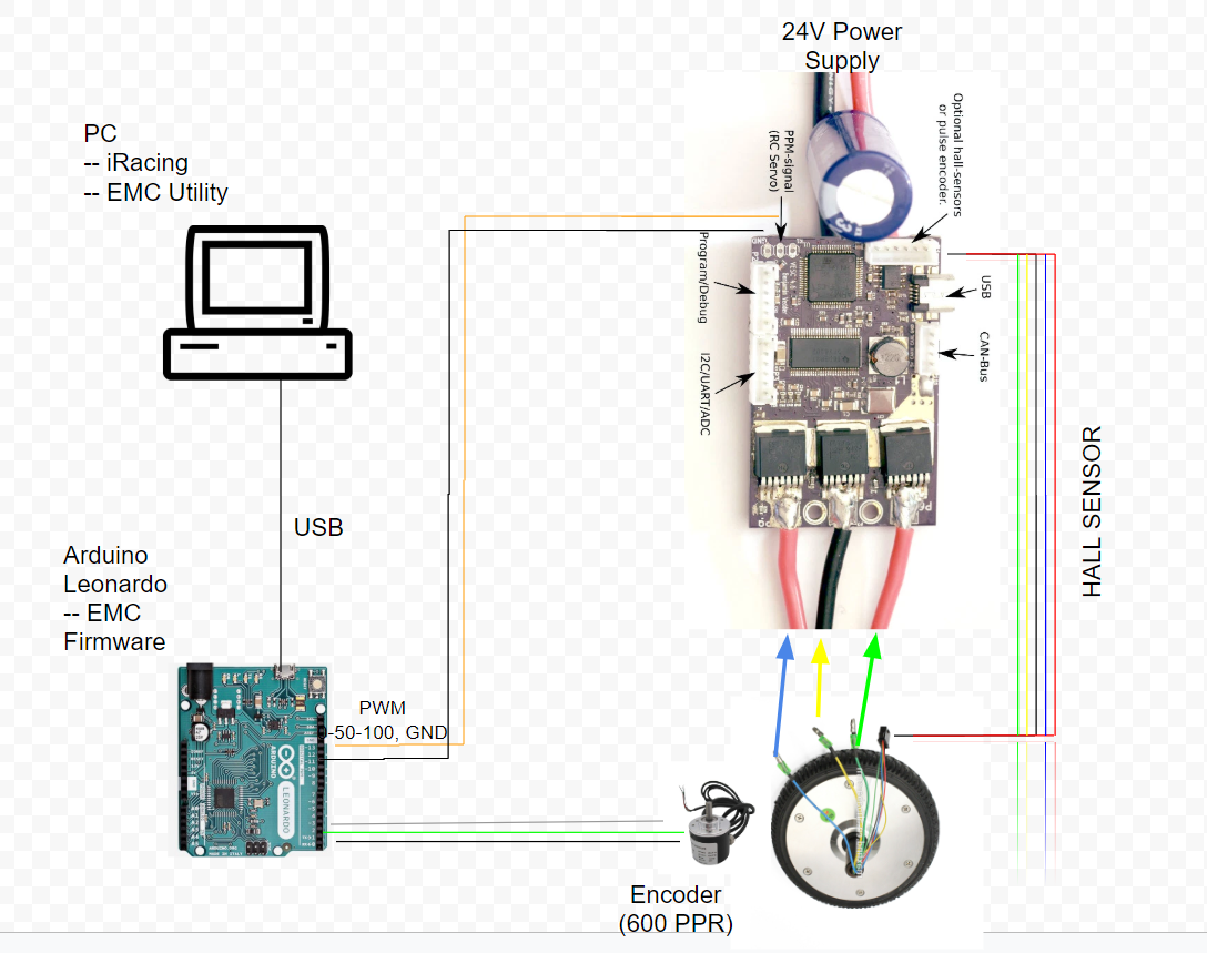

    Update on my latest configuration.
    I have struggled to get the b-g431b-esc working in my set-up, so i broke down and ordered a VESC off Amazon. while at $80 it was more expensive then the B-G431-ESC it was a breeze to set up and get running with my hoverboard wheel. The VESC configuration software is excellent, and allows me to adjust any setting without having to change code and download firmware. Here is my new system diagram.
    Advantages:
    -- Higher voltages then B-G431-ESC, I am using 24V, but VESC can handle 48V.
    -- VESC configuration software. No coding, or firmware to adjust ESC configuration.
    -- Braking circuit not needed.
    -- More responsive then Hoverboard control board.
    Disadvantages
    -- Expensive -- $80 vs $20
    -- Torque Ripple --Uses hall sensor for position. Not sure if encoder would be better. A little better then Hoverboard Controller, Does not effect driveability.
    Definitely results in more responsive FFB. Can now feel the rumble strips which I couldn't when using the hoverboard controller board.
    Happy to help if anyone else wants to try.

    Nice work getting the vesc up and running, I was wondering if that was a viable option a while ago.
    I would definitely look at using an encoder. Hall sensors at 120 degrees results in 90 pulses per rev which is a resolution of only 4 degrees.
    In my setup I get 4200 ppr which means I get 0.09 degrees between each pulse
    I'm fairly sure I've seen an encoder hooked up to a vesc but I could be wrong

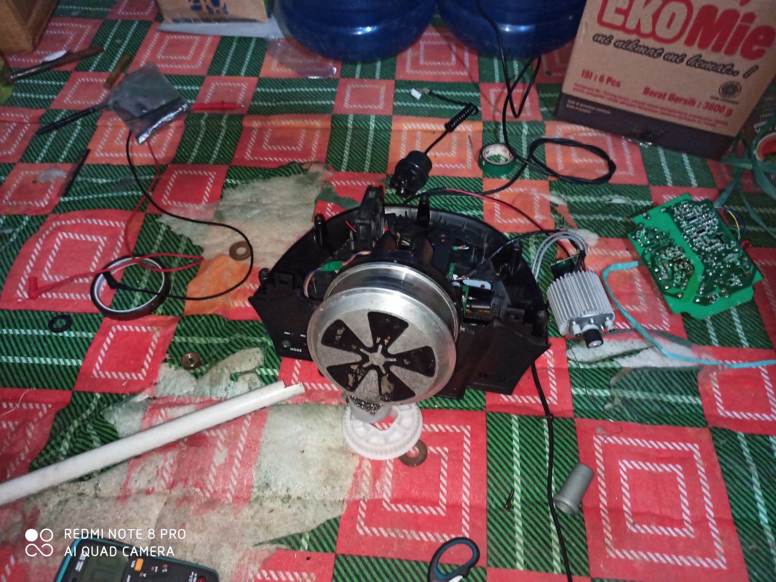

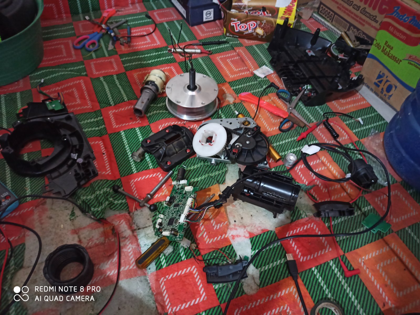

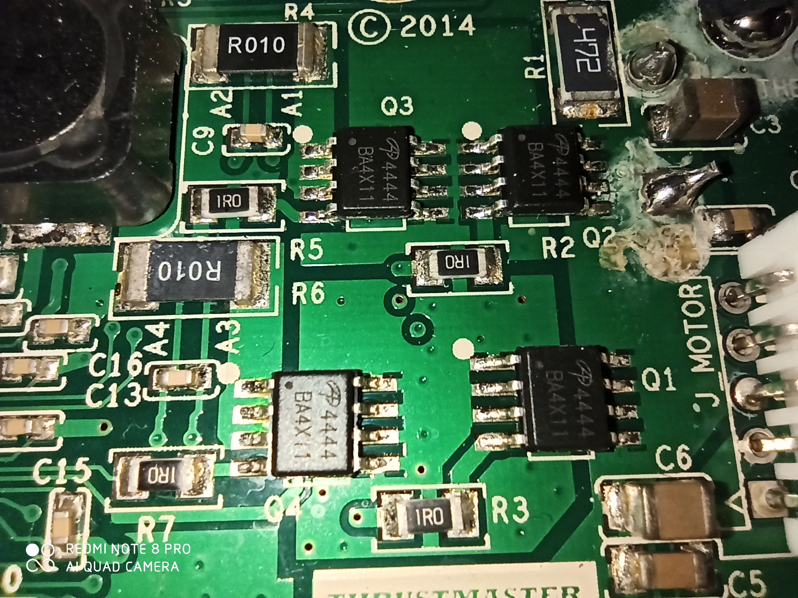

    I have a steering wheel thrustmaster T300RS, I want to try direct drive using a Hoverboard motor.
    does this work?
    T300RS driver specifications
    mosfet AO4444
    max voltage 30v
    max Ampere 20A
    sorry if my English is not good, I use google translate

    My guess would be no. Unless you can rewrite the FW for the driver board. The motors are very different.

    the thrustmaster t300rs uses a Brushless motor, I guess it's the same as a Hoverboard motor?
  16. Chris_Beeves
    May 31, 2019
    380
    2,196Coins
    +259 / 4 / -0
    Sure, both are brushless. I don't think they have the same number of poles though, and the encoder/hall sensor resolution will definitely not be the same.

    After trying it on the TM T300RS, it worked fine without any changes on the board.
