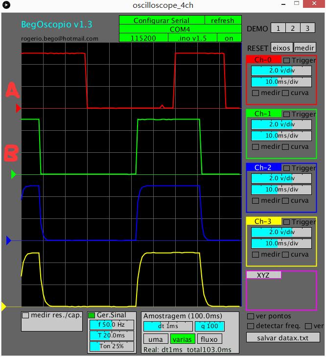

    Also, when troubleshooting my encoders in the past I have used an Arduino as a simple oscilloscope. It visualizes the signals coming in in a very good way. Do you have the possibility to do this? It should work on pretty much any arduino with analog inputs I guess.
    [edit] This is what I used:

    Hello your code cannot work.
    I use ArduinoPrintADC.ino can work, but only A0 can work. I separately test the AB phase of the encoder, which can output a square wave.
    I use Arduino Nano.
  16. Chris_Beeves
    May 31, 2019
    380
    2,196Coins
    +259 / 4 / -0
    I don’t understand what doesn’t work. Why only A0?
  17. fzxj520
    fzxj520 Active Member
    May 14, 2015
    176
    1,341Coins
    +90 / 1 / -0
    Only the A0 pin of the Arduino board can work (check the waveform).
    When connecting A1-A7, the waveform cannot be read.
    The code for this link works very well. I slowly rotate the encoder while observing that the AB phase waveform is normal.
    I judge the encoder is normal.

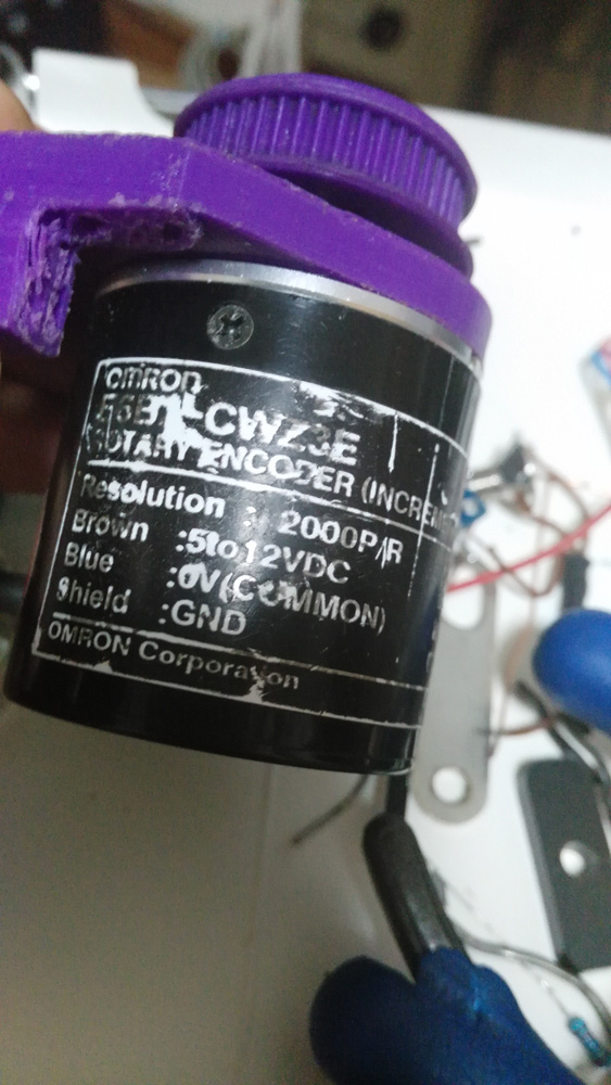

    1: Now use the encoder, parameter 2000ppr NPN voltage output. Motor and encoder rotation 1:1. mmos is set to 8000cpr.
    2: Testing the encoder through the Arduino board seems to work normally.
    3: After reconnecting the motor and the encoder with the timing belt, there is no error between the rotating motor and the encoder. After testing the wrong FFB problem is still the same.
    3: I also bought a new encoder, parameter 1024ppr NPN voltage output.

    I still suspect you have the same problem as I have with my ESC boards. Check the signals to the ESC with the motor activated. You might have a lower pullup-voltage on one of the inputs (Think it was A), and then you need to mount a extra pullup resistor.
  20. fzxj520
    May 14, 2015
    176
    1,341Coins
    +90 / 1 / -0
    I used pull-up resistors, and independent and combined tests of A and B did not solve the problem. (Remove the optocoupler isolation test) I have no multimeter to measure.
    I estimate that there is no voltage problem with the encoder. Each optocoupler isolation module has a led. The led indicates signal input. When there is signal input, the LED brightness is normal.
