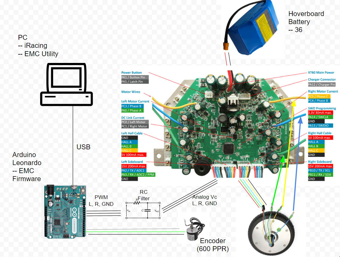

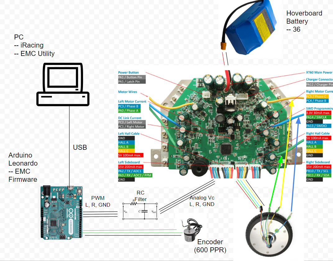

  17. marccohn
    marccohn New Member
    May 5, 2020
    26
    301Coins
    +10 / 0 / -0
    New Working Solution
    After learning a lot about PWM and burning up my ODrive board I have a new/simplified FFB Solution that I have been driving with in iRacing for the past few days. I am now using the original hoverboard control board.
    As this is my first FFB wheel, I have nothing to compare it to, but I am very pleased with the results. I can definitely feel forces build in a corner and loss of traction through the wheel, which is the most important. Also can feel vibration when braking, or driving over rumble strips. Can't turn it all the way up unless i want to work up a sweat while driving.
    Here is a diagram
    Notes:
    -- Gave up on power supply and used the 36V battery. Extra voltage provide plenty of power. No more need for braking resistor circuit, lasts about 6 hours on a charge, so if you run the battery out, you have been racing too much.
    -- Hoverboard control board is running hacked firmware based on FOC motor control. https://github.com/EmanuelFeru/hoverboard-firmware-hack-FOC I have used this firmware on a different project and it is solid and bug free.
    -- Converting PWM signals to analog signals with an RC filter feels like cheating but it works. Might slow response time down slightly, but simplifies project and can't really feel a slow response.
    -- All in cost less then $50 (Encoder $16, Used Hoverboard $20, Leonardo board $12)
    Its not perfect:
    -- The wheel does need some mechanical friction to keep from oscillating. Might be a function of slow response time. EMC Friction adjustment has no effect. Trying to tune out on the hoverboard controller firmware. Stay tuned.
    -- "Coggy-ness" - you can feel when the rotor moves from one magnet field to the next in high force low velocity motions. FOC should minimize this, but still feel it. Probably less than perfect commutation. I assume hoverboard controller uses a standard commutation table because there is never a commutation cycle at start up sequence.
    I will work out some of these issues and share details soon.
