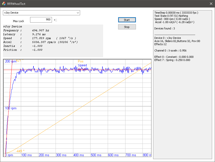

    Couldn't wait... I connected remotely to my home computer and did some tests with wheelcheck and it actually seems that it works. I had almost the newest SDK, but I have read an old documentation before. Now I found the correct helper function for constant force and now I get magnitude values! Will write a test application and test against the real wheel when I'm back home, but as I can see for the moment it should work. If so, there is no need for HID supported hardware, just a serial connection!

    I did a test with fernandoigors fork of ESP_WHEEL with my BLDC code included. Almost identical result as my previous test with vJoy. rfactor2 worked perfect, LFS worked but behaved a little strange with low forces and rfactor1 didn't work. the wheel just turned to right as with my vJoy application.
