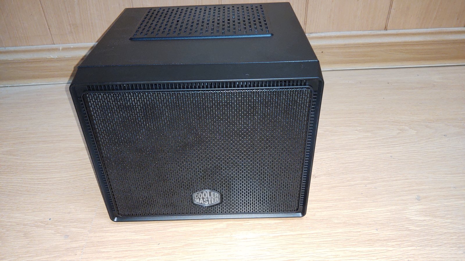

    Cooler Master Elite 110 RC-110-KKN2 Midnight Black Steel/Plastic Mini-ITX Tower Computer Case

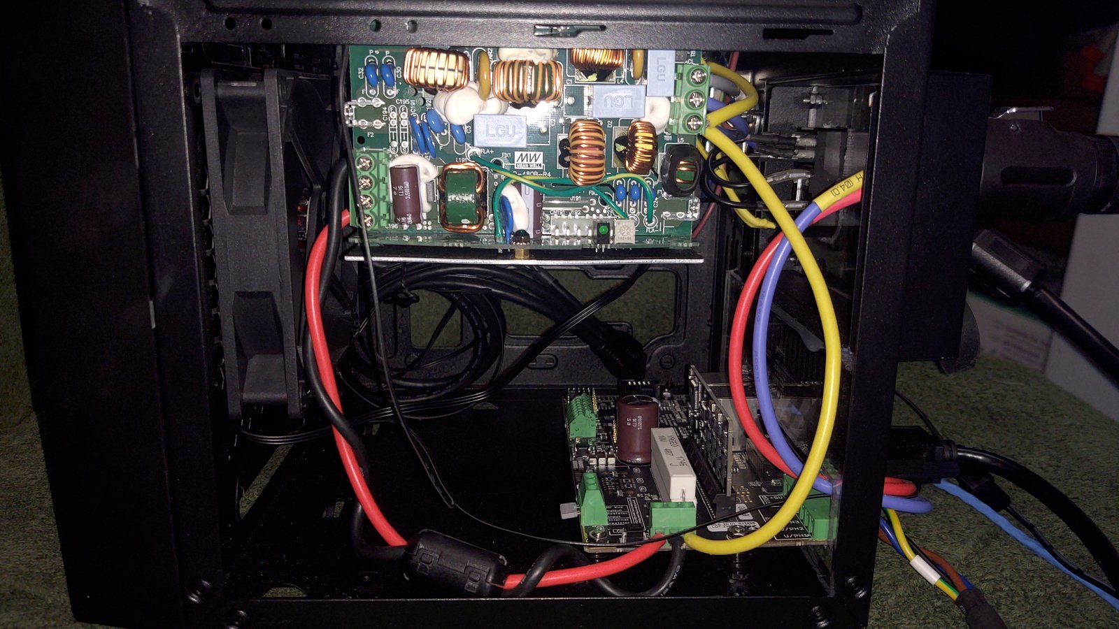

    Case and PSU assembly

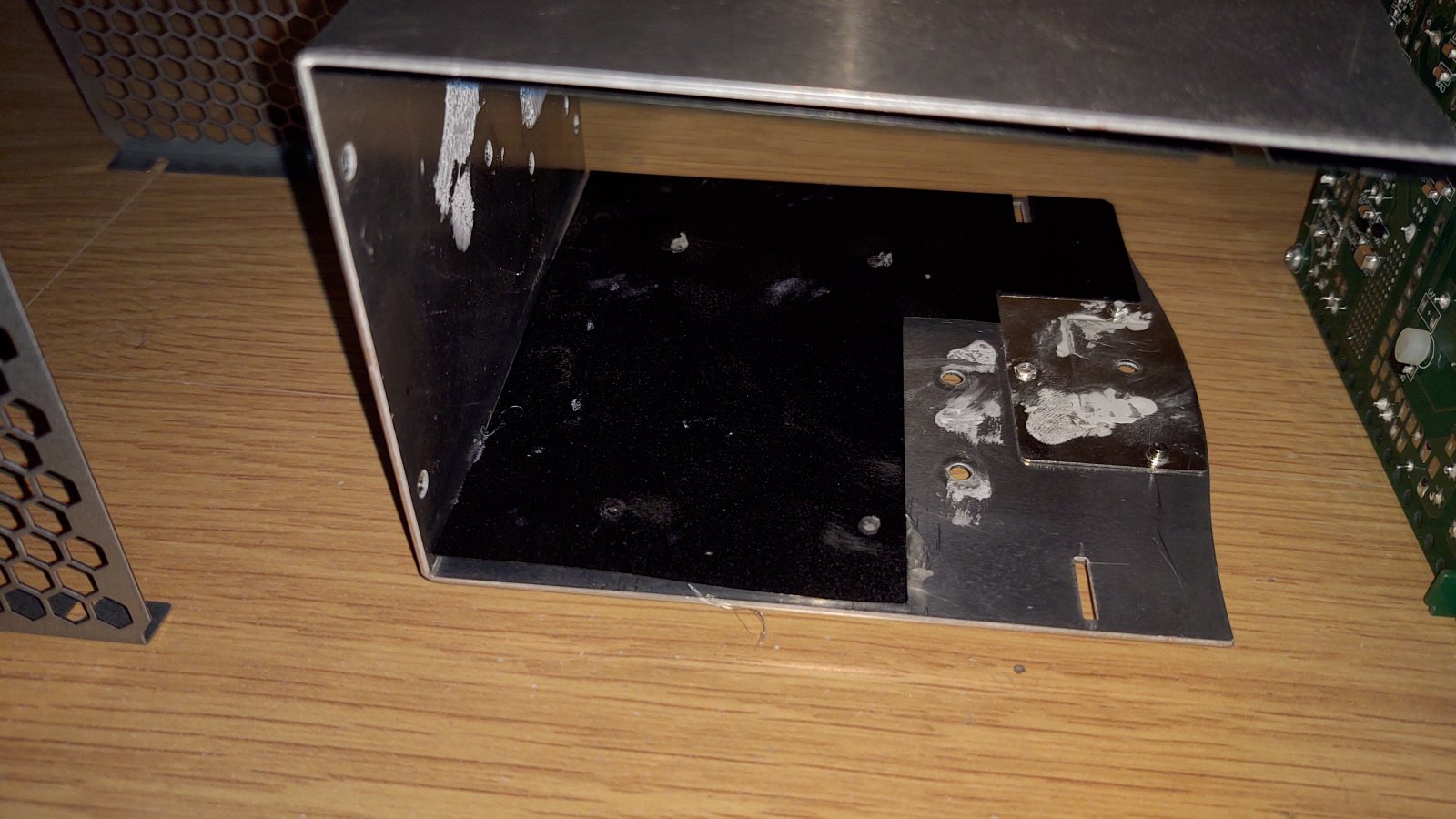

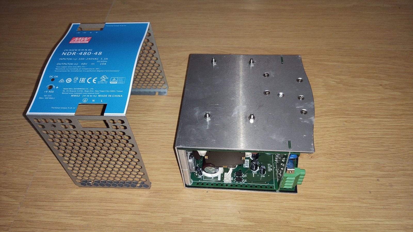

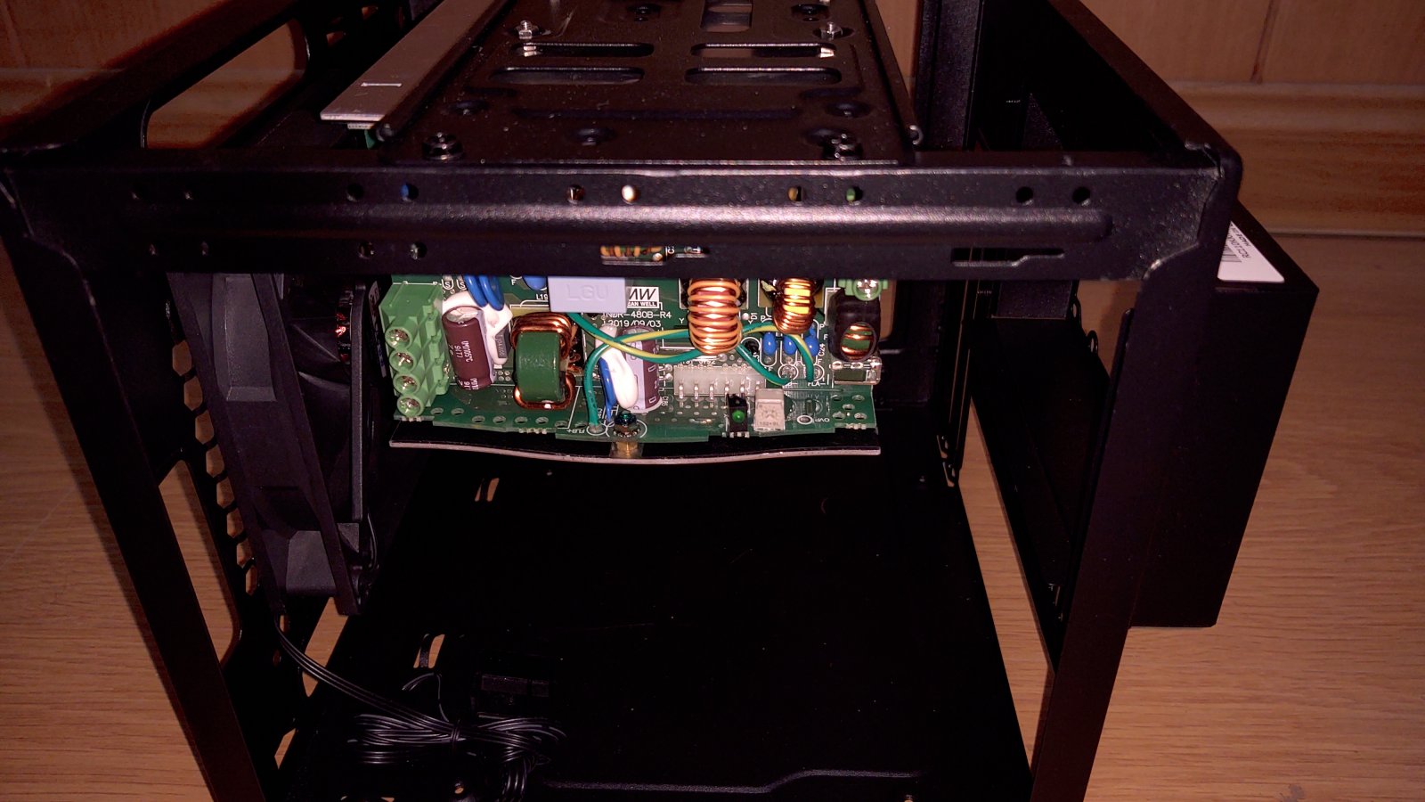

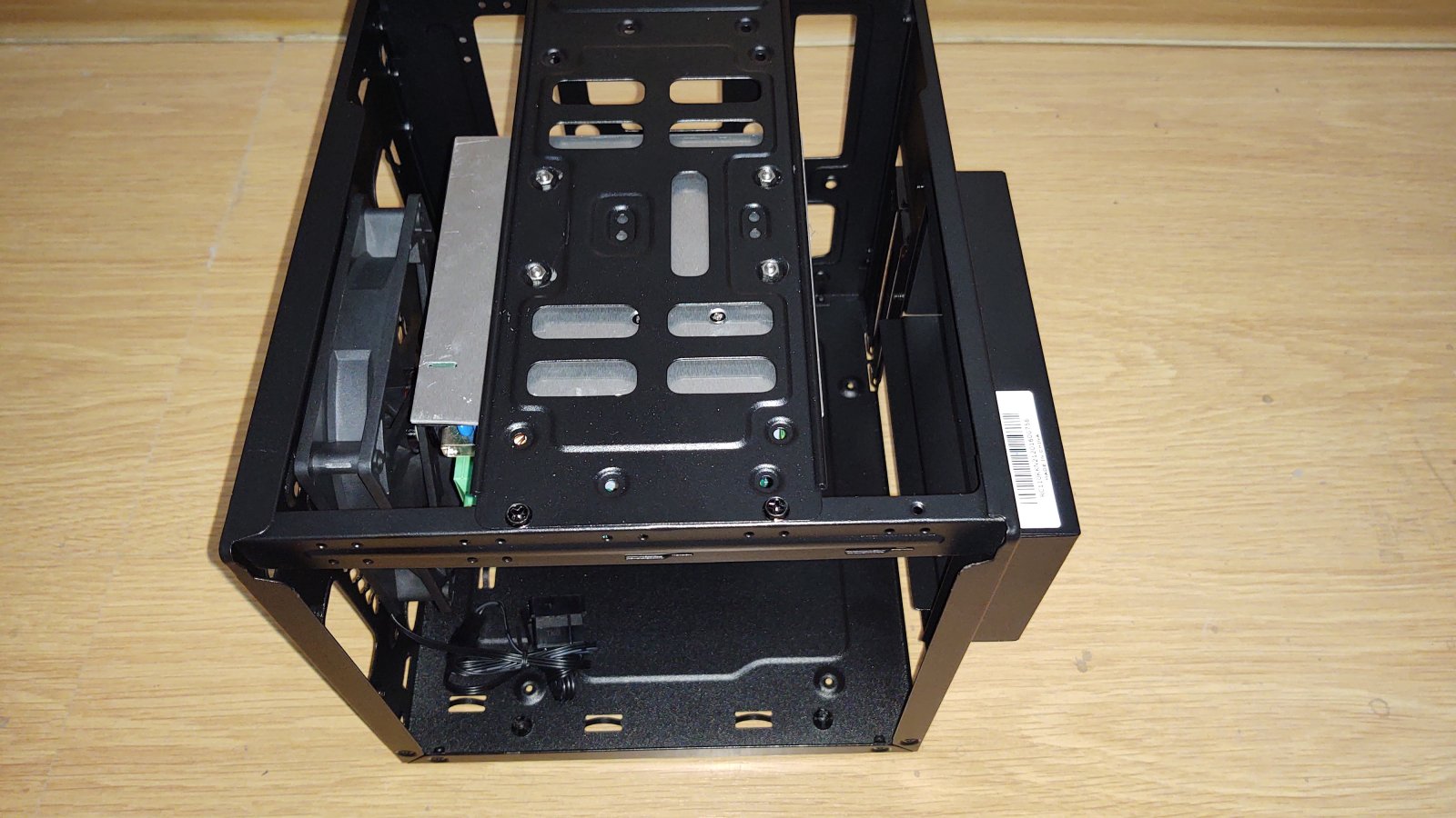

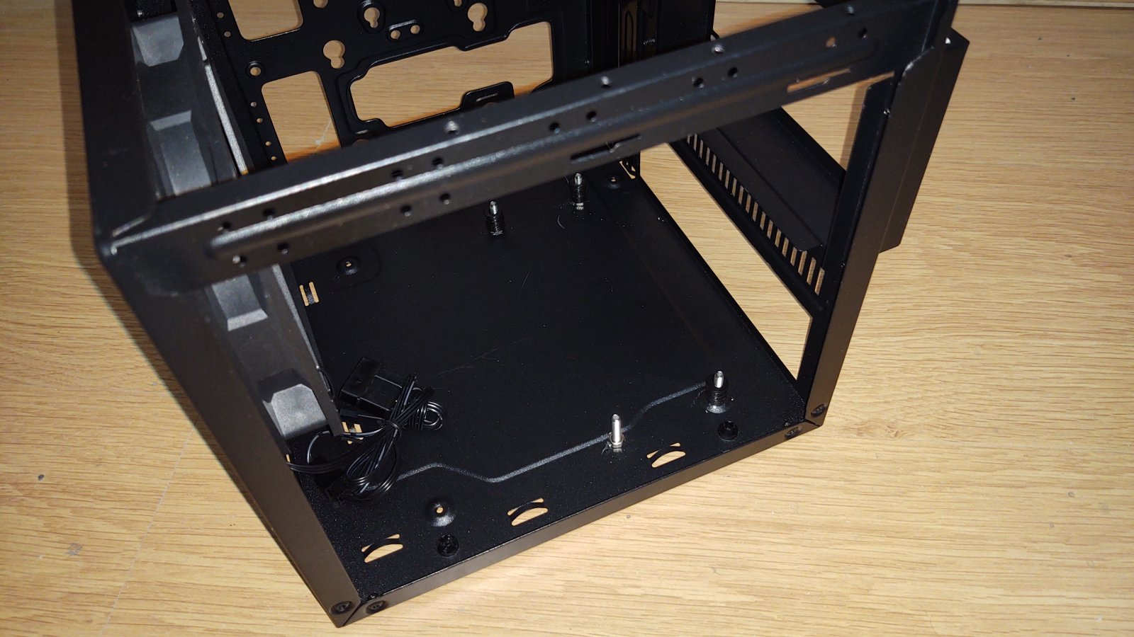

    The case i purchased to put all of the electronics, came with a fan (Issue with the Fan at the bottom ) so I dissembled the PSU and mounted it on a top rail so it would have good air flow across the internals.
    To attach the PSU to the rail, after disassembling the PSU ( be extremely careful if you decide to disassemble the PSU, they have capacitors which hold a charge and they can KILL YOU! ) i used the the top rail to mark where i would drill the holes in the aluminum housing. While the PSU was apart i added Thermal grease to the PSU heat-sink. The stuff that was on there was horrible stuff and was just enough to just stain the metal.
    I put the bolts thru the Aluminum housing and used a nuts to secure the bolts to housing prior to attaching to the Mini ITX case. This would allow me to be able to remove the PSU at a later time with out fear of the bolts coming loose inside the PSU.
    I also used Hot glue on the head of the bolts prior to reattach the plastic sheet which acts as insulator between the aluminum housing and the PSU circuit board. This was just my OCD making sure i would never have any shorting issues.
    Then i attached the PSU to the top rail on the Mini-ITX case in front of the Case fan (came with the ITX Case )

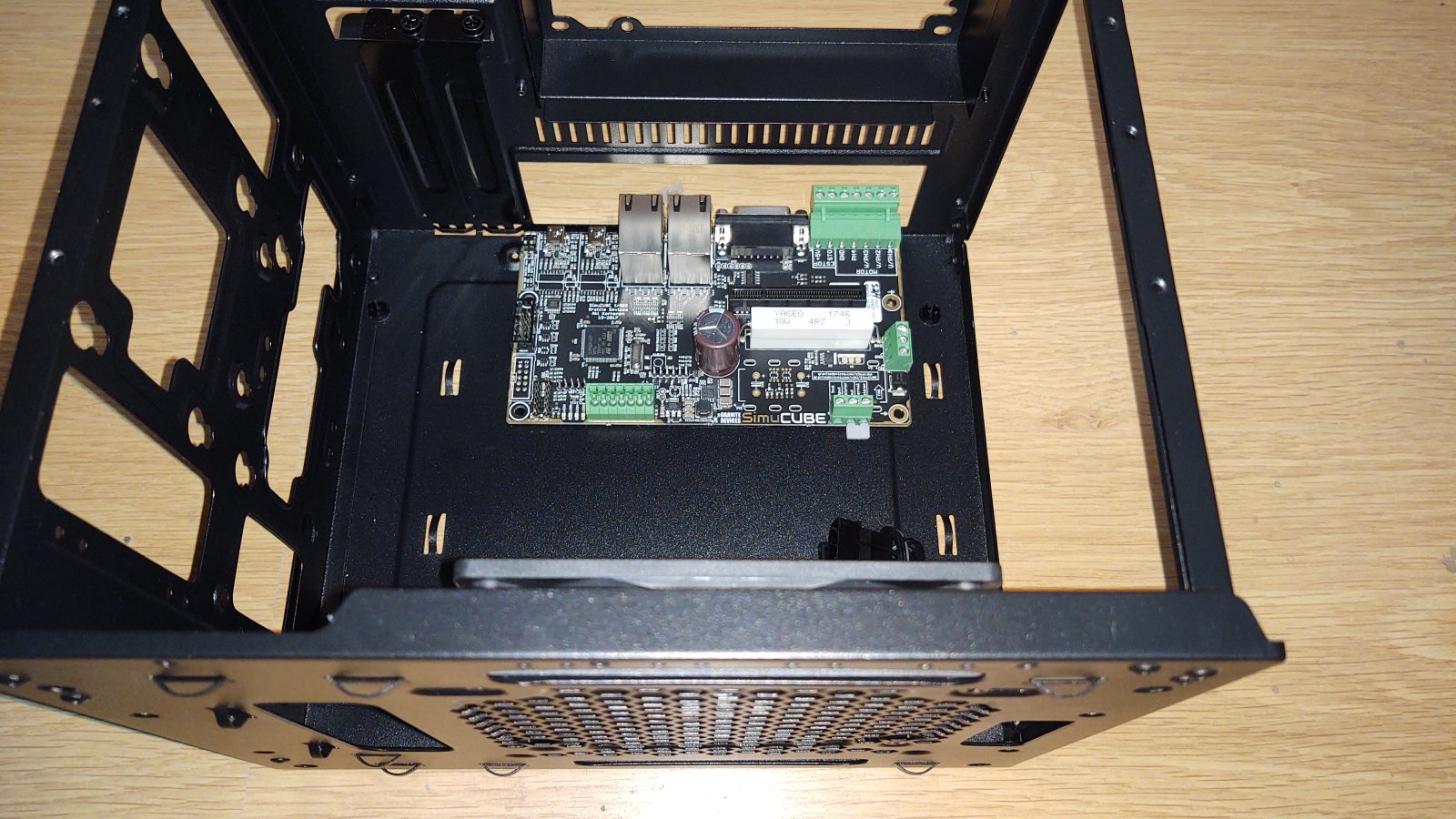

    Simucard Install

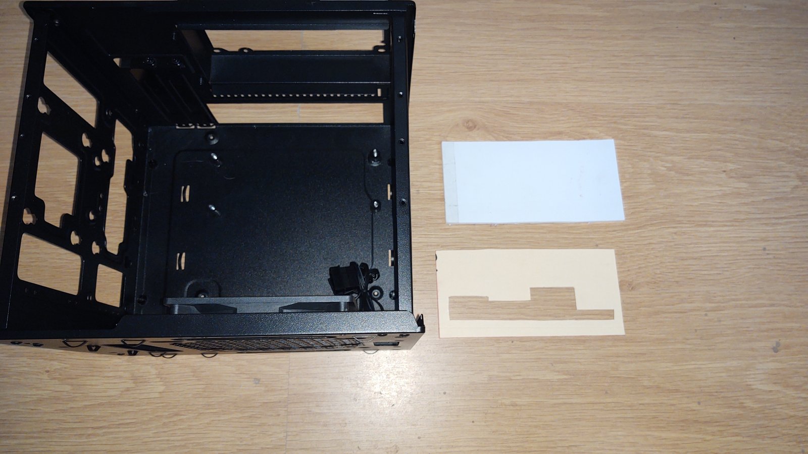

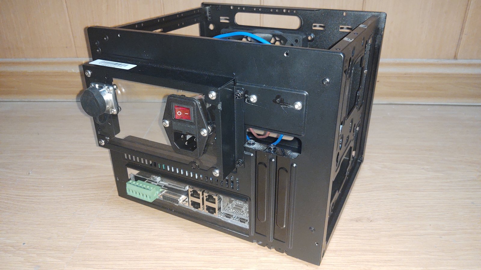

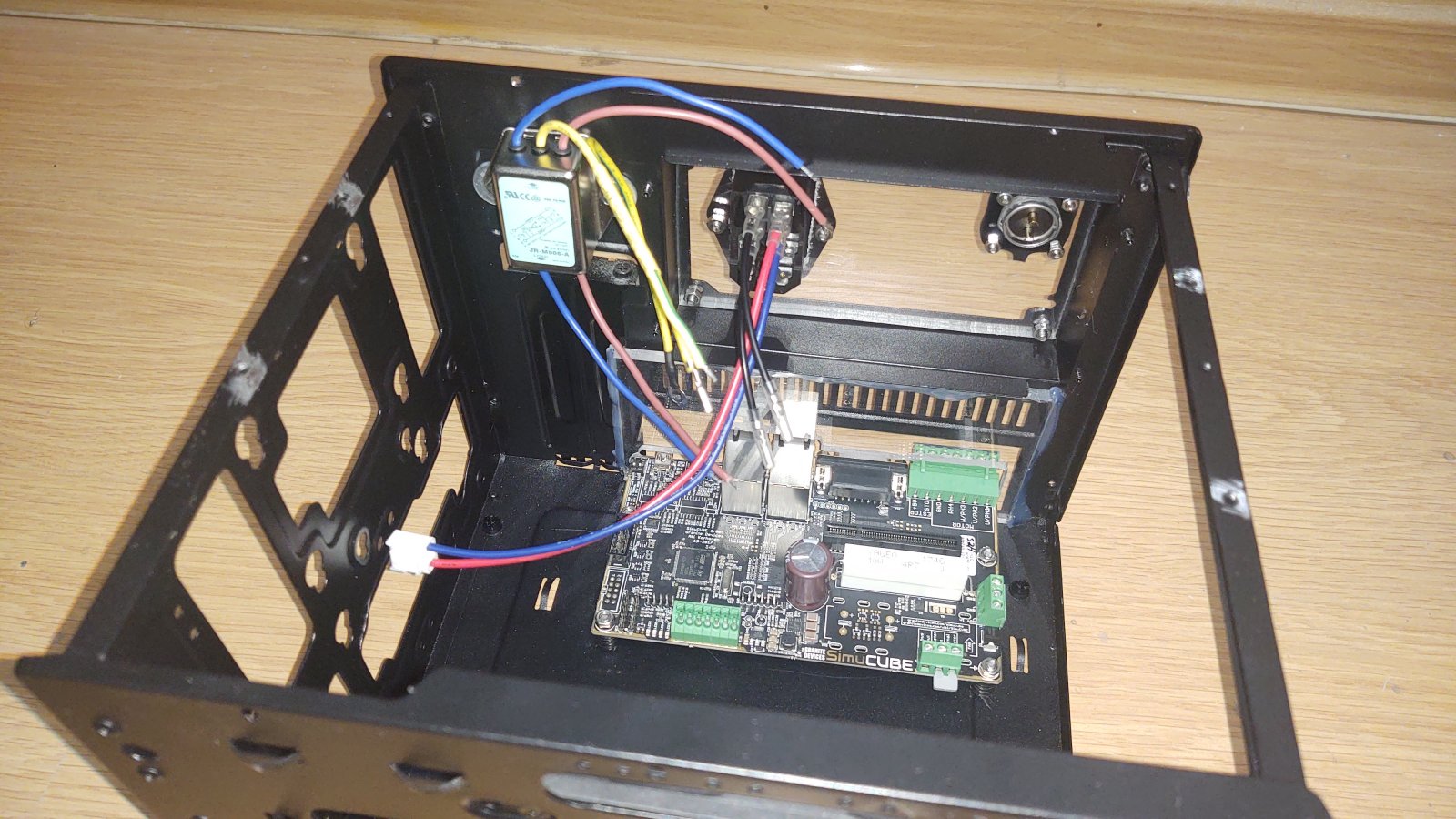

    To install the Simucard i paced the card in the case and marked the holes and drilled holes in the case and used bolts to secure it in place. One thing that I did on the Simucard to of the bolts holes are for ground. The bolt holes for those specific holes. I made sure to remove the paint from where the head of the bolt would come incontact with the case so the Simucard would have good grounding points.
    I used plastic washers for the spacing on the bolts to get the Simucard in the correct place.
    To create the shield for window where the Simucard would sit and where I would attach the ON/OFF switch and the Emergency stop connector. I used a piece of manila folder to create a template, then cut a piece of plexi-glass out to fit in those spots.

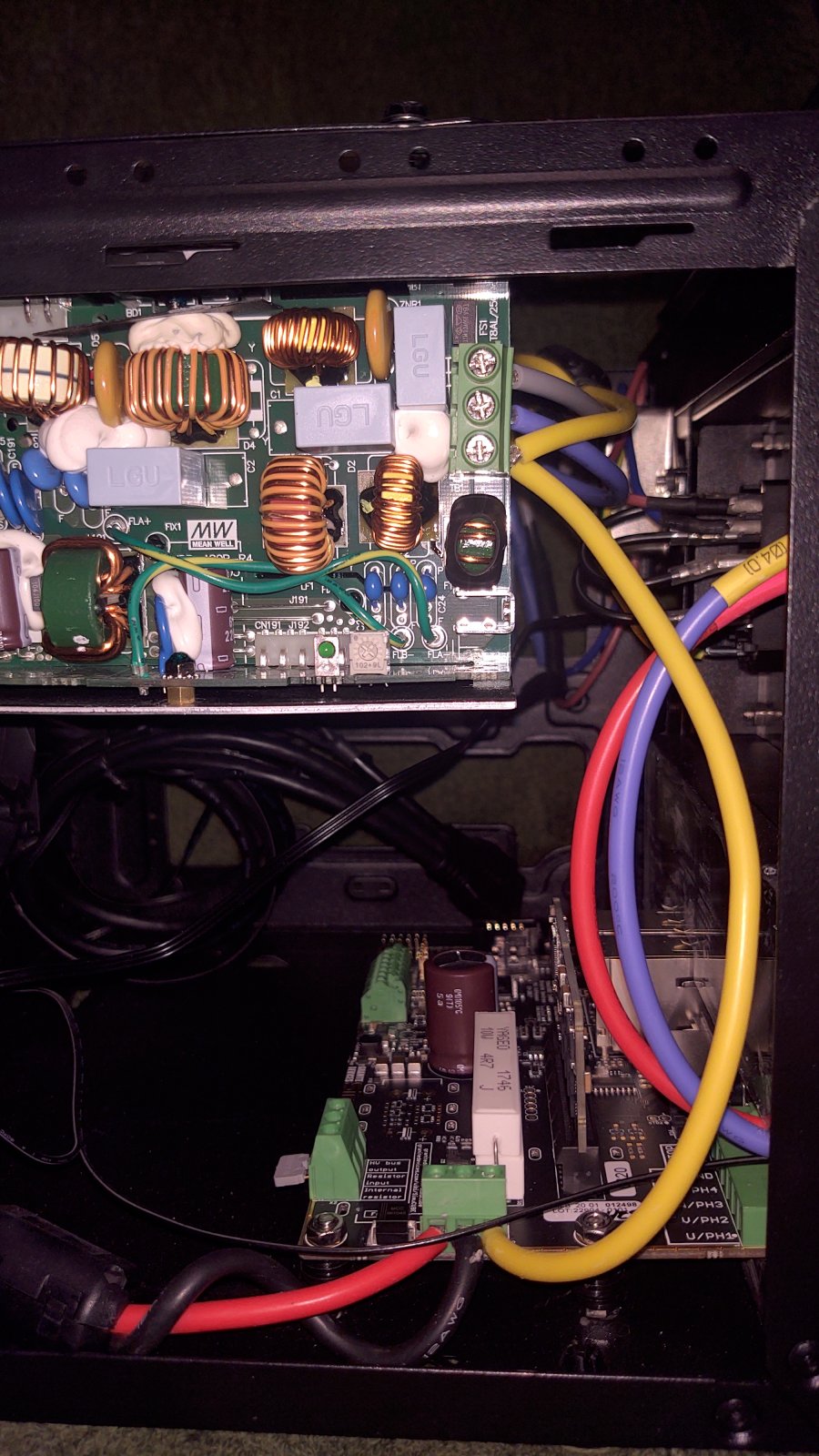

    Wiring

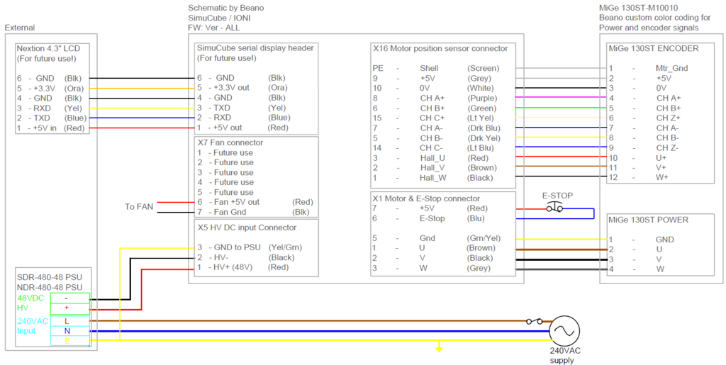

    The wiring is pretty straight forward once you realize that the colors aren't exactly right and they are not what you use to verify the connections, In the Diagrams there are numbers that are next to the colors, those are accurate based on what the cables actually show. I was pulling my hair out, trying to make sure I was wiring everything correctly. Last thing I wanted is for this thing to go up in a Plum Of Smoke!!! ( ask me how i know, that $h!t happens )
    This are the diagrams i used to do the wiring.
    This Pics where taken from SilentChill's thread, He got them or someone else placed them on his thread, But they where a great help.

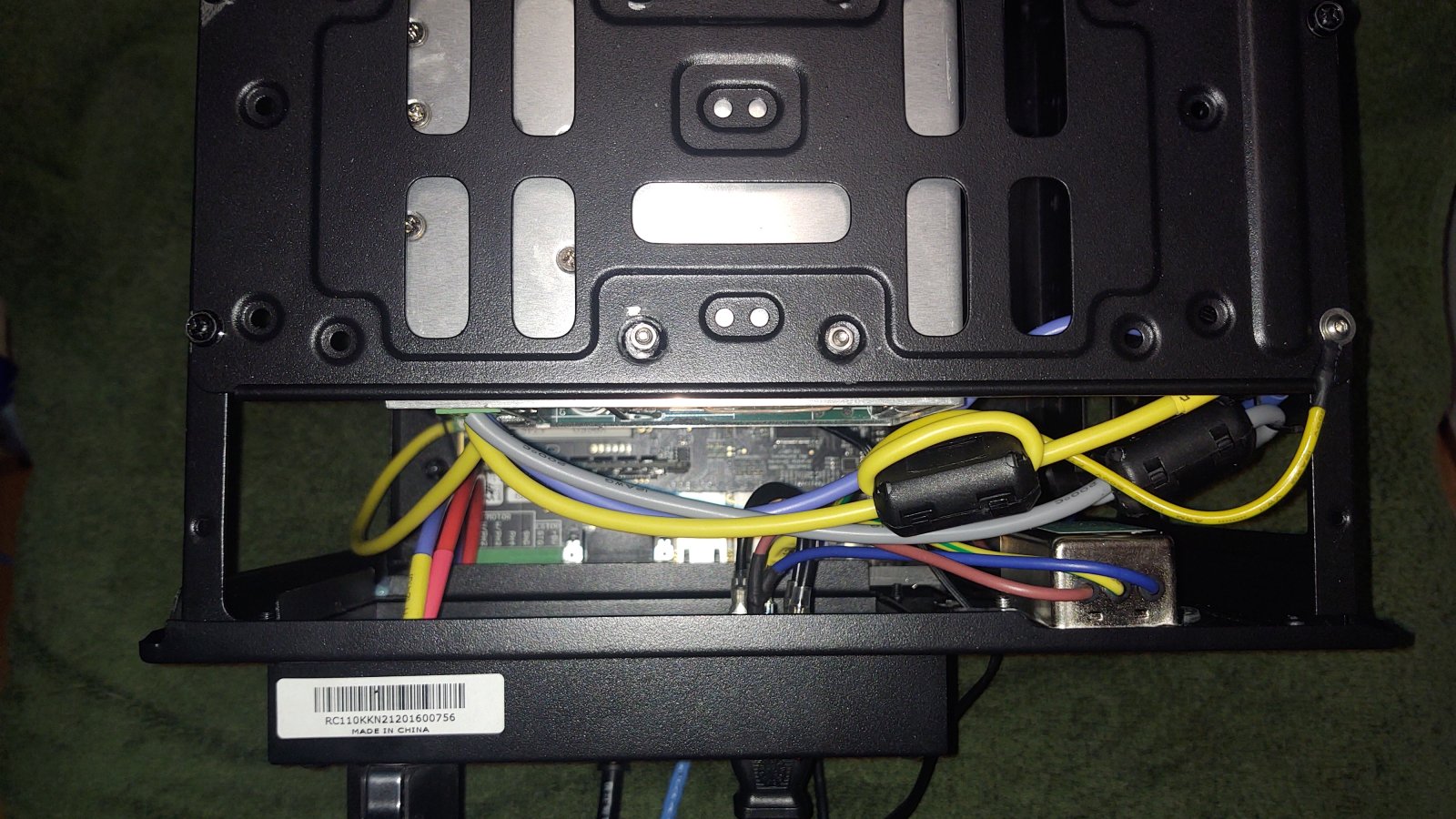

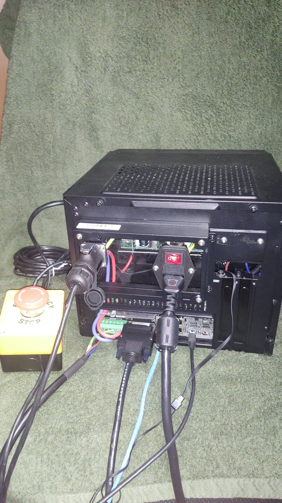

    You will notice that in my case i have a noise filter. I hate tracking down and correcting noise interference, That's why i always use the largest wire I can, the Ferrite Core Cord Rings, and multiple good grounding points. Was it necessary? Truthfully, probably not. But its an expense that i will always add in.
    One thing to look out for, if anyone has grounding or wiring issues. While I wiring everything together I was testing the connections with a multi-meter, and noticed that one of the grounds appeared to be in the wrong place ( that's when i realized that the numbers next to the colors where correct and colors didn't really matter ). Well, I took apart the Mige cable and saw that the ground for the Shell ( the metal of the connector ) was soldered onto the retaining ring for the connector. That soldering point was garbage, as soon as I touched it, it came apart. I soldered it back together and now its solid. If any one has grounding issues, it might be something you might want to look into ( it was the Data cable not the Power Cable ).

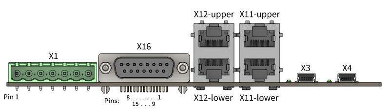

    My main issue was, that for some reason I had originally thought that to program and update firmware I had to use the X4 connector on the Simucube. I must have read or thought i read that. But that was wrong, which lead me down a path, a very long path which made me think i needed a SimpleMotion V2 USB adapter. Turns out you do not need it. ( But as luck would have it, I ordered it, before i realized i didn't need it. Its nice to have extra parts, that you don't need :rolleyes: ).
    What I needed to do was attach the my USB cable to the X3 connector on the Simucube card ( that would have saved me HOURS!!! and the attempt to build an adapter cable :mad:)

    ** So the Fan that came with the case is 12v I eneded up just attaching the fan to my PC's molex adapter with a an extension I made so it could Push the 12V needed for the Fan. I originally was going to buy a voltage reducer and attach it to the PSU and run the fan that way. But it will be easier to just buy a 5v Fan and wire into the Simucube. It has a spot specifically for a 5v Fan. For now the fan works great the way it is.
    ** The case comes with a LED light which i tried to wire into the emergency stop 5v pin, but I guess the LED was 3v ( shouldn't surprise me it was for the LED portion of a motherboard ) So eventually it blew.
    ** When I wired the ground of the Noise filter and the PSU, I attached them both to a single point in the case which i removed the paint and bolted down. Grounds are extremely important with electronics in metal cases for no other reason that a loose wire or a short can charge that case with a current and if there is no ground, If some one touches that case now they are the grounding point. ( ask me how i know :blush ) It is very dangerous.
