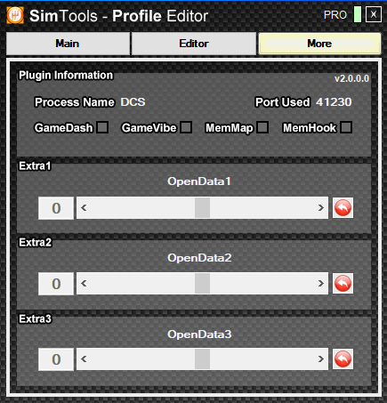

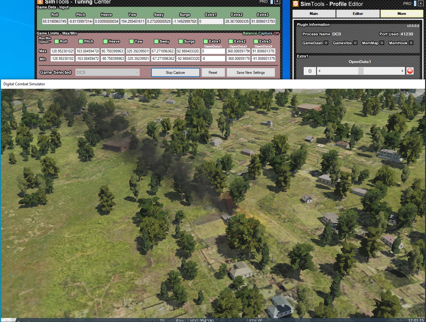

    In tuning center they have output but I can't get axis data from Network UDP. I use DCS_GamePlugin_EXPERIMENTAL v0.06 plugin
    For another game I don't have any problem,I can get all axis data

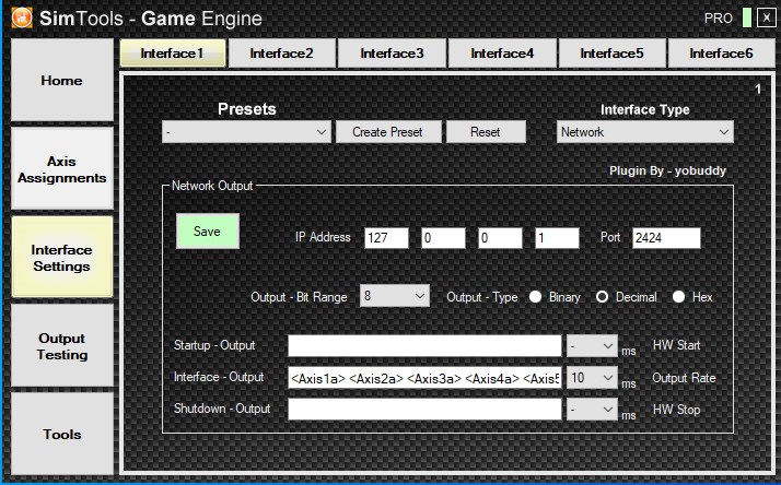

    I have a problem that DCS plugin didn't send Axis data via Network UDP. For other game I can't get it only DCS didn't work.
    Tuning Center have value of Yaw, Pitch, Roll ....... but no Axis data send through interface

    Indeed, as far as I know GameDash and GameVibe are not supported in the Experimental DCS plugin I made. To be honest, I don't even know exactly what they are :) I mean, I heard those names before, but since I don't use SimTools I never invested the time to get familiar with everything going on "around" SimTools. I just assumed that the data in the 3 Extra slots could be used for anything.
    I will take a look at the code again to see if I can add GameDash and GameVibe support. Is there example code around somewhere from a plugin that uses GD or GV?

    Both GameDash and GameVibe have a var to turn them on.
    Here is GameDash's
    "Private Const _Enable_DashBoard As Boolean = True"
    Then you just assign inputs, much like the motion stuff.
    Code:
    'Dash
    Dash_1_Output = "Speed," & .Speed.ToString
    Dash_2_Output = "Gear," & .Gear.ToString
    Dash_3_Output = "RPM," & RPM.ToString
    'Vibe
    Vibe_1_Output = "Rpm," & RPM.ToString
    Vibe_2_Output = "Gear Shift," & .Gear.ToString
    Vibe_3_Output = "Collision L/R," & .GForceLatitudinal.ToString
    Vibe_4_Output = "Collision F/B," & .GForceLongitudinal.ToString
    Vibe_5_Output = "Road Detail," & HeaveAcc.ToString
    Let me know if you need a hand buddy.
