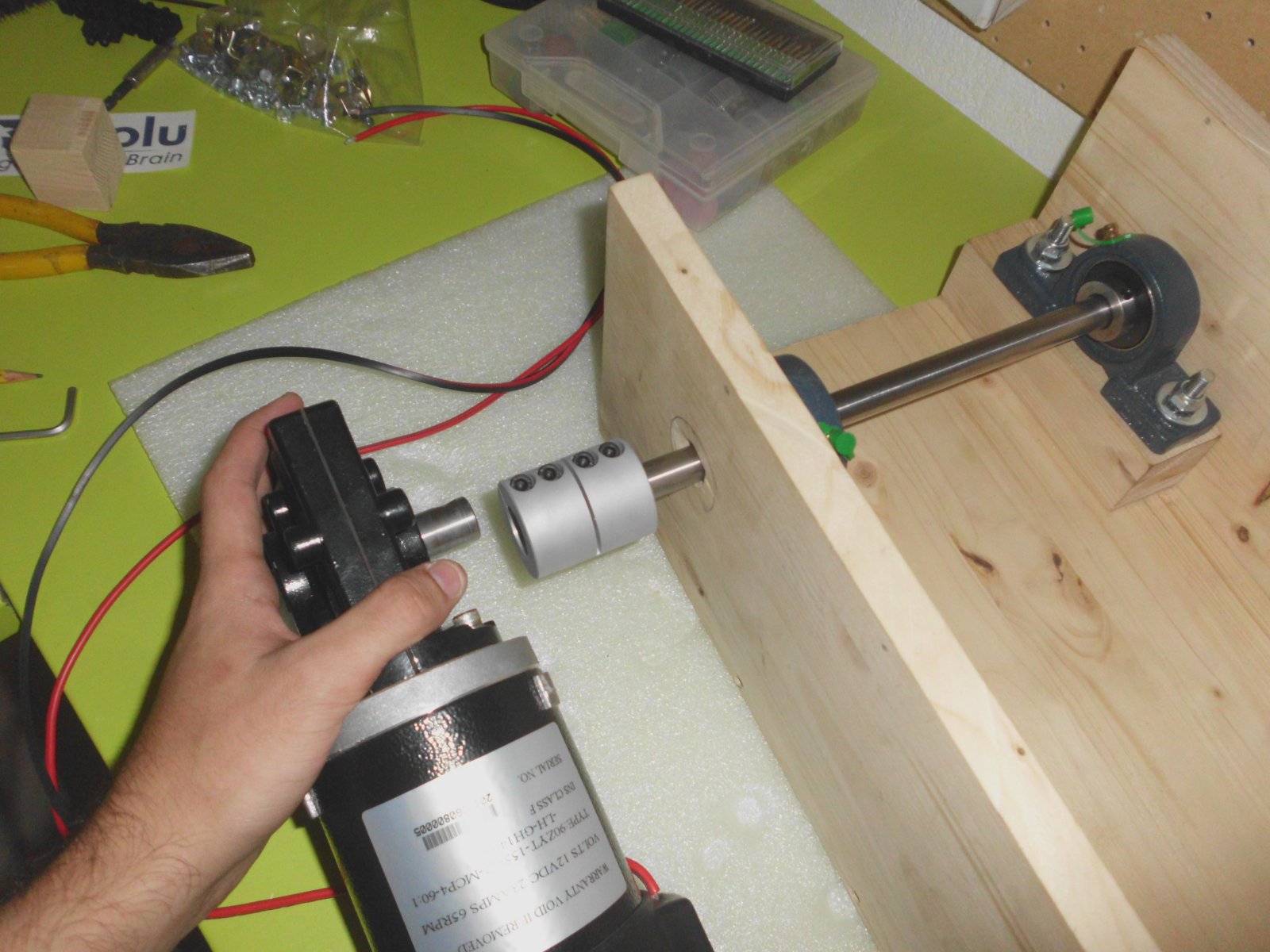

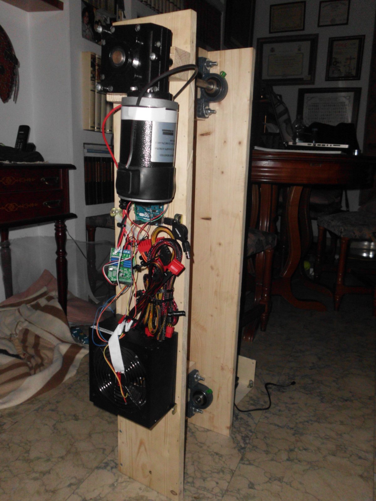

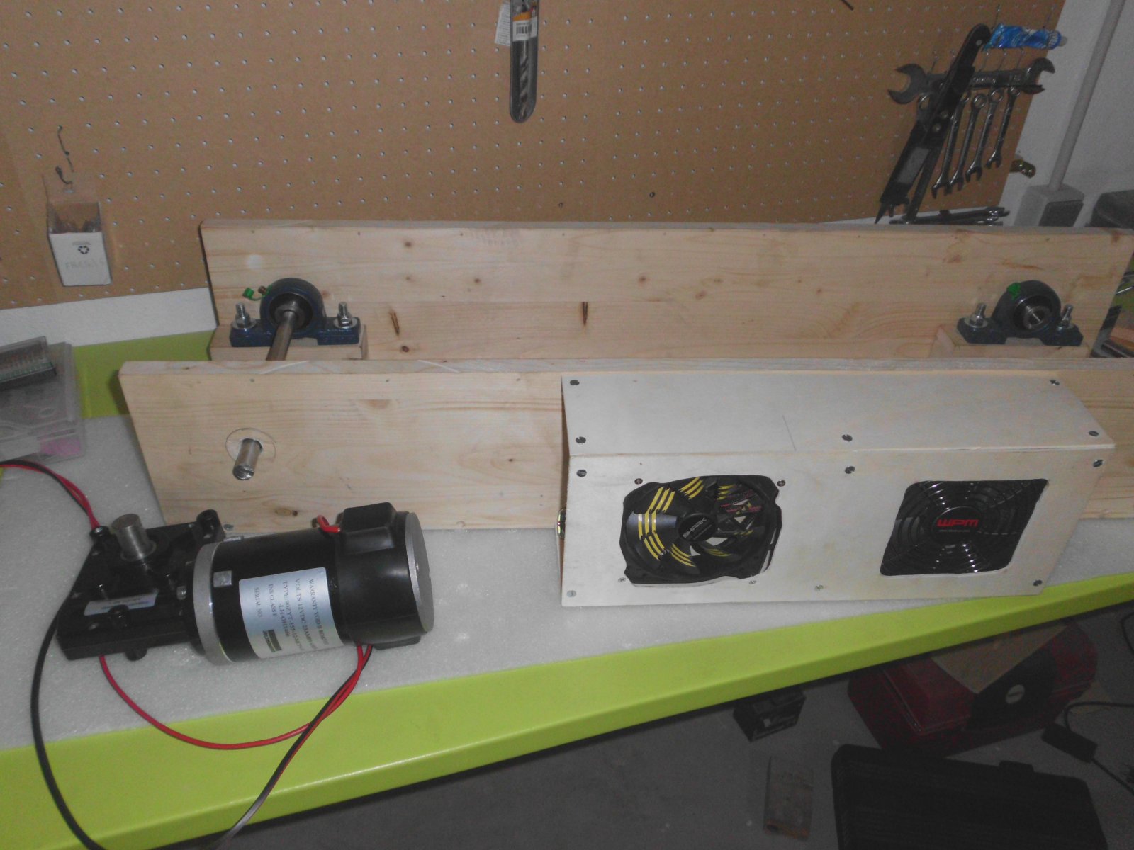

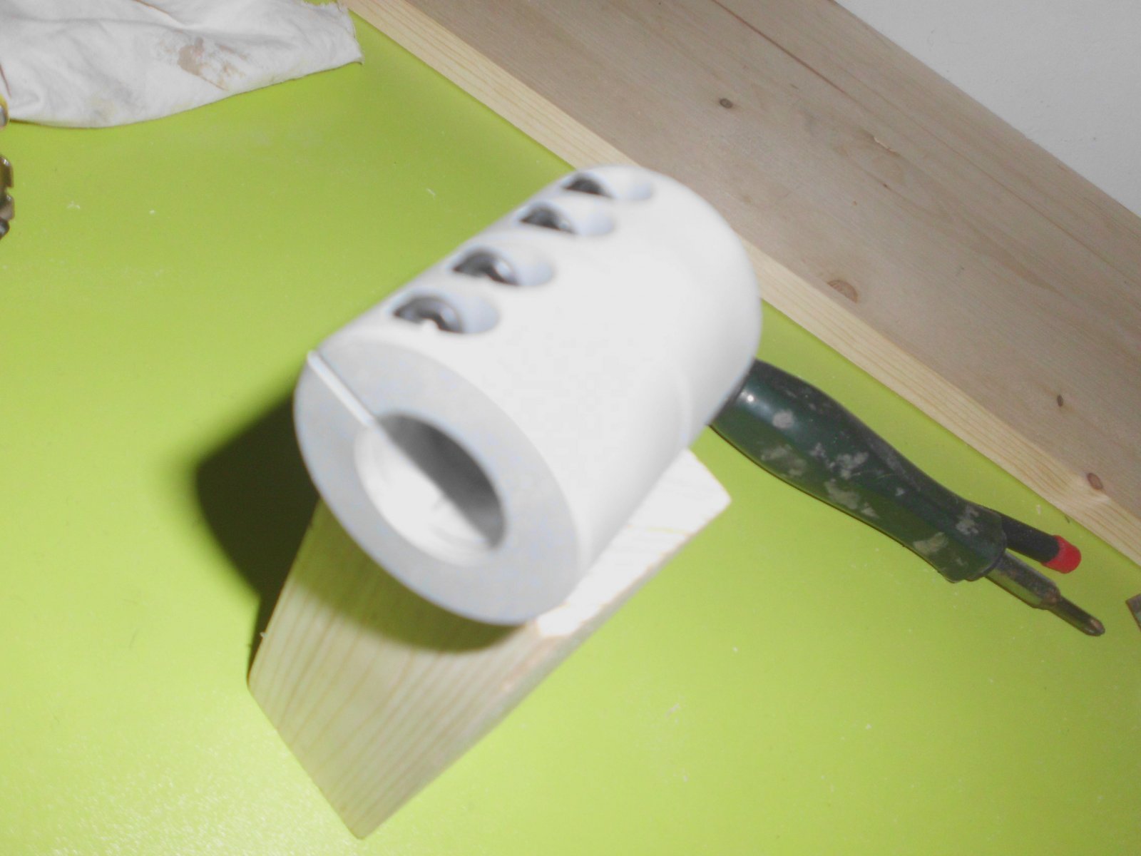

    Hi guys I got the solid coupler.
    Here is its final place.
    IMG_5337.JPG This is why i choosed the solid model, i though it was essential in that piece.
    This is an overview of the actuator.
    No electronics finished. need to fix motor to the side first, and need to open a 45mm hole on the shaft side to let the coupler introduce to the side and close down the motor to the external shell. Since i dont have the correct crown to drill it have to wait until tomorrow. Tomorrow I spect to receive the small pulleys and then i can mount the pot and show you. There is also a fan grid incomming. Imprimation paint is on the way too and im still thinking on color, any suggestion?? :p
    Dont horror about the size, think i'm planning 50cm travel, and possibility of software changes ( just limit the pot) to achieve up to 70-75cm of travel, since i have some range on the pot turns ( used only 6.5 / 10) and some space ( still to determinate )
    :grin
    EDIT: photo makes some distorsion, note dimensions are (mm): 180 x 270 x 950.

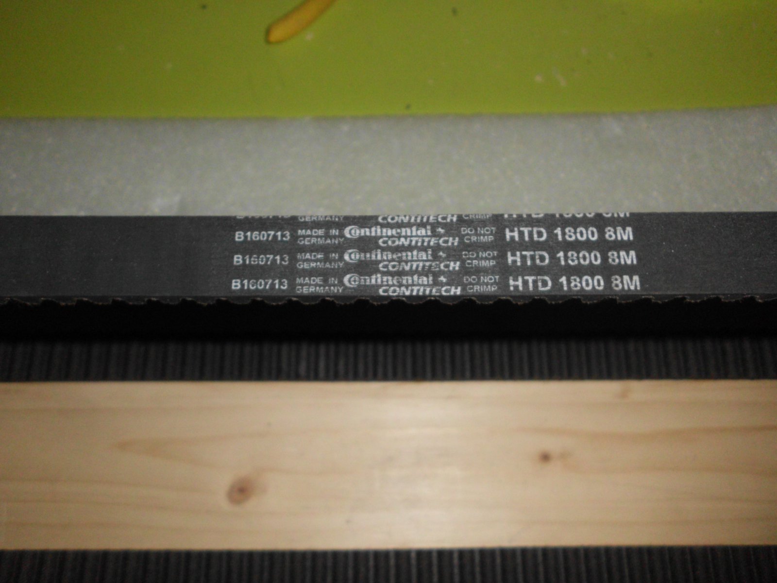

    IMG_5448.JPG Quality belts Continental german belts.

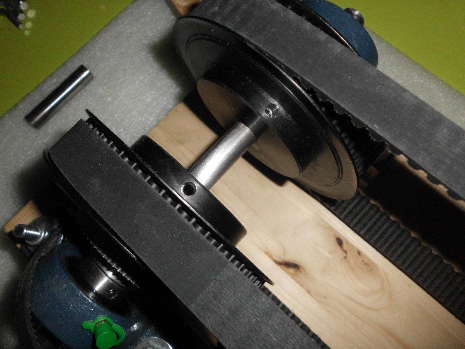

    IMG_5449.JPG Finally made 2x m6 grabscrew holes on each pulley

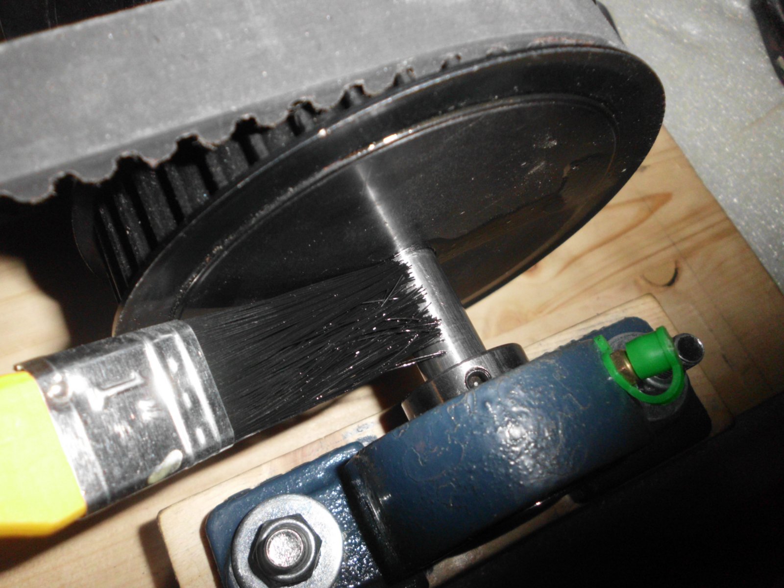

    IMG_5450.JPG Some oil to avoid rust on every shaft

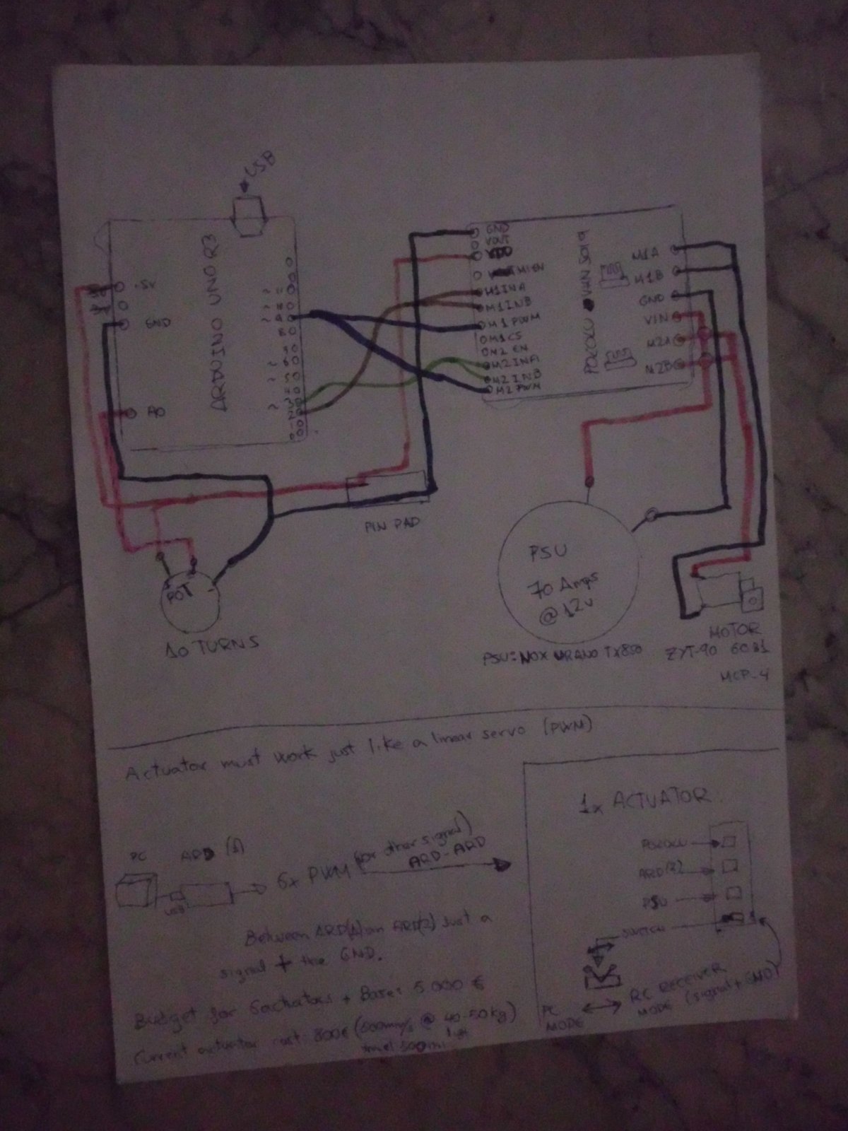

    IMG_5457.JPG Wiring diagram made by me, will do it with paint or something when have time.

    I must say it actually works, it follows the target but i made some mistakes with the drivers wiring and screwed it up.

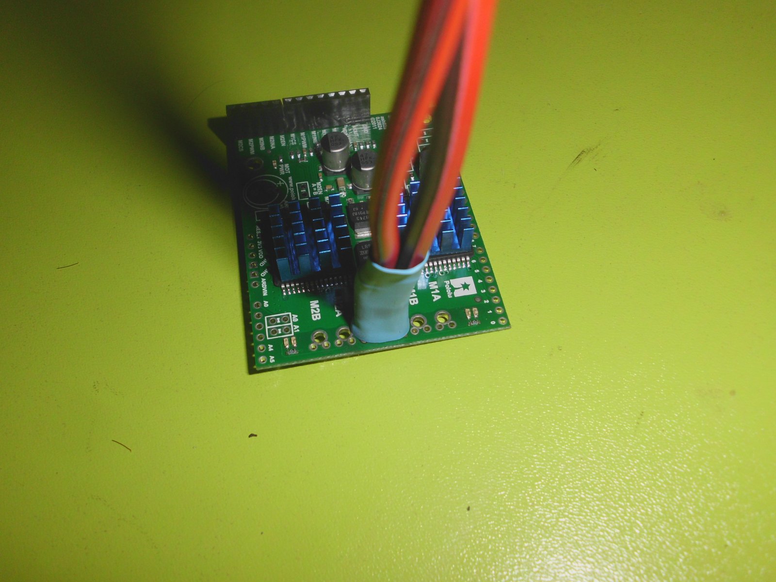

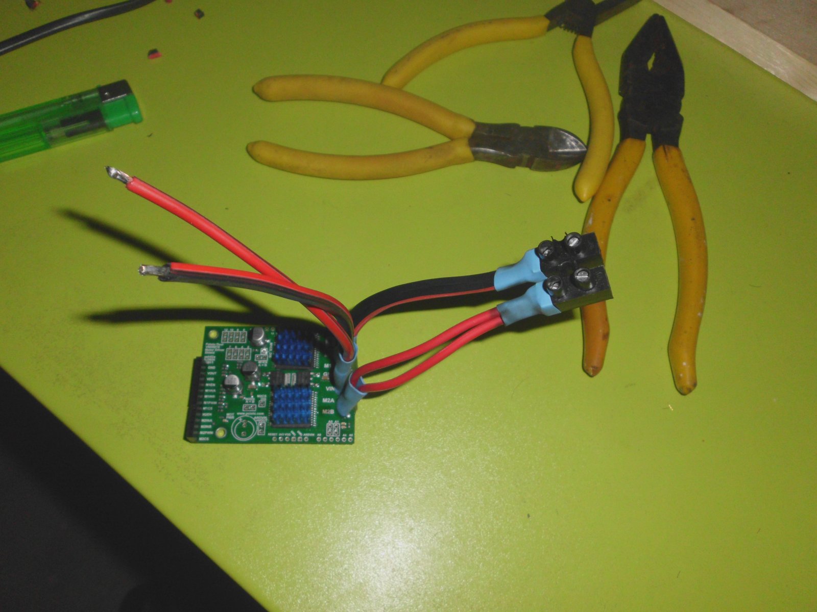

    Well new pololu and new wires and new procedure to make it work.
    IMG_5503.JPG Clean solder.
    IMG_5505.JPG Ready to plug.
    I tested a 7.4v lipo and the Traxxas motor. Everything was ok.
    Here is the result. I'm affraid now this is working i dont want to kill them with high values.
    What do you recommend for now?
    I was not able to stop it with 1 hand. Also did not want to trap my fingers with pulley haha
    Now:
    When the motor reaches the target, it inverts and backwards. how do I configure to use the "coast mode" ??
    I learned in the slot cars world that if you connect both terminal of a DC motor, it brakes. Is this the "coast mode" ??
    I want the motor to brake, and when the pot speed is 0 ( motor speed 0) start to reverse. I think I would have a faster direction change, since this motor is 4900rpm and gear makes 80 rpm with 60:1, and takes hard to stop it.
    I know this can be pòssible with the SMC3 util, but please show me some light on what parameters and how much to start trying.
