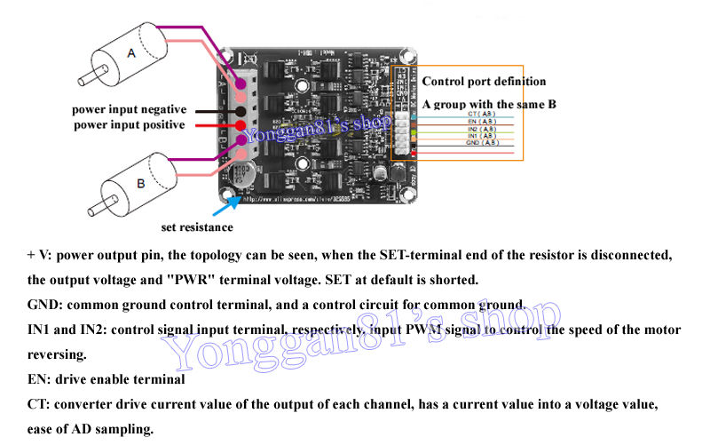

    Hi all
    Can you tell me what Arduino code should I use with this HBridge?
    http://www.ebay.com/itm/50A-Dual-Ch...for-Arduino-Robot-Chassis-Servo-/171442705595
    And have anyone tried this HBridge?
    Marc

    After sometime experimenting (frying Hbridge ,arduino ,USB port) solved it
    Only wired up :
    ARD - Hbridge
    PIN 2 - IN1A
    PIN 9 - IN2A
    PIN 4 - IN1B
    PIN 10 - IN2B
    SMC3 MODE 2
