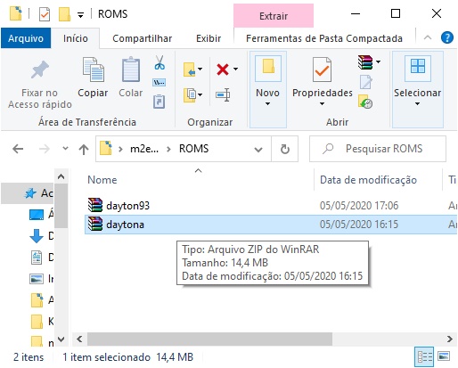

    Hello.
    Which version of the game does it work on?
    I only managed to play Dayton93 here, but the simtools didn't work.
    In the patch you have no option to choose which folder to indicate.
    Did I do something wrong?

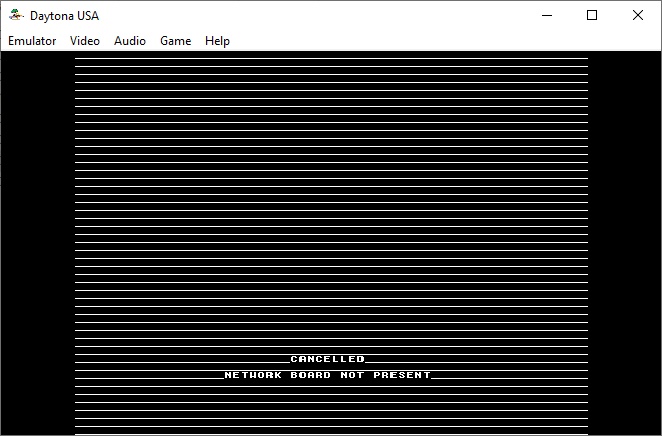

    In Daytona (no 93) this network information appears when i try to open the game.

    for 2 players, ( or more until 4 ) you have to put a notepad file on each pc !
    About game, just ignore message about network. its a internal link for use with service mode on a real arcade physical machine. Go to emulator.ini file, adjust resolution and another parameters ( as you wish ) and save. Run emulator multi cpu.exe, game configure controls. after this, emulator , load rom, test mode, adjust settings, as describe on Boomslang post and have fun !

  18. Leandro Kemp
    Leandro Kemp Active Member Gold Contributor
    Oct 14, 2015
    161
    Brasil
    - 10Coins
    +34 / 0 / -0
    It worked.
    Thank you.
