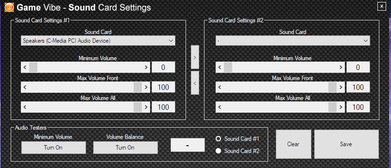

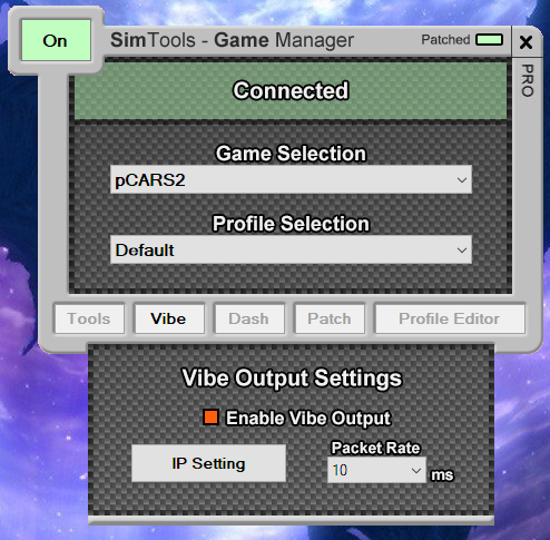

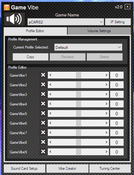

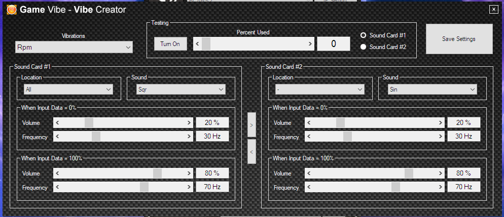

    Ok so i'm starting to play around with sim vibe but i must honestly say it is not really user friendly but apart from that i'm fialing to understand the manual on the manual it shows RPM chassis ect on my it only shows Gamevibe1 Gamevibe 2 ect can anyone explain to me why. The game I'm using is project cars 2
    21,592
    151,215Coins
    Can you please verify what version of SimTools and Game Vibe you are using and also post pictures of all of your settings.

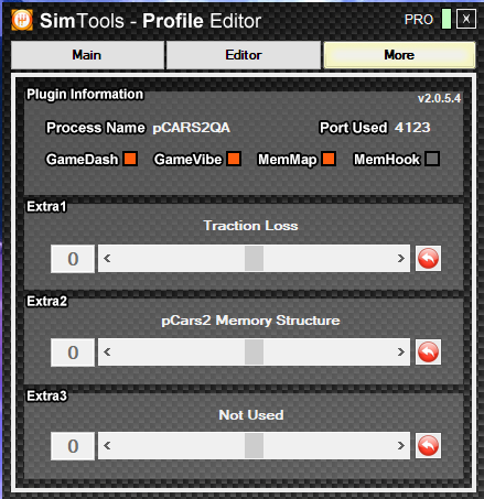

    Hi Noorbeast please see the attached pictures as requested

    Yes it has been sim tools works with the 2 Dof rig that i made and works perfectly the only thing is on game vibe i do not know what is what as it only indicates Game vibe 1 and Gamevibe 2 etc. Not RPM Chassis etc in the game vibe app so you don't know what you are changing if you change gamevibe 2 for example.
  12. noorbeast
    21,592
    151,215Coins
    Seeing Game Vibe instead of RPM and the like suggests PC2 is not running.

    Ok new problem when project cars 2 starts gamevibe closes
  14. Cartman_SP69
    Cartman_SP69 Member
    May 17, 2018
    60
    IT
    South Africa
    384Coins
    +15 / 0 / -0
    Ok i have figured it out Game vibe crashed if you use the following settings on project cars 2.
    Shared Memory : Project Cars 2
    UDP Frequency : 2
    UDP Protocol Version : Project cars
    It Works Perfectly if you use the following settings.
    UDP Frequency : 2
    UDP Protocol Version : Project Cars 2
