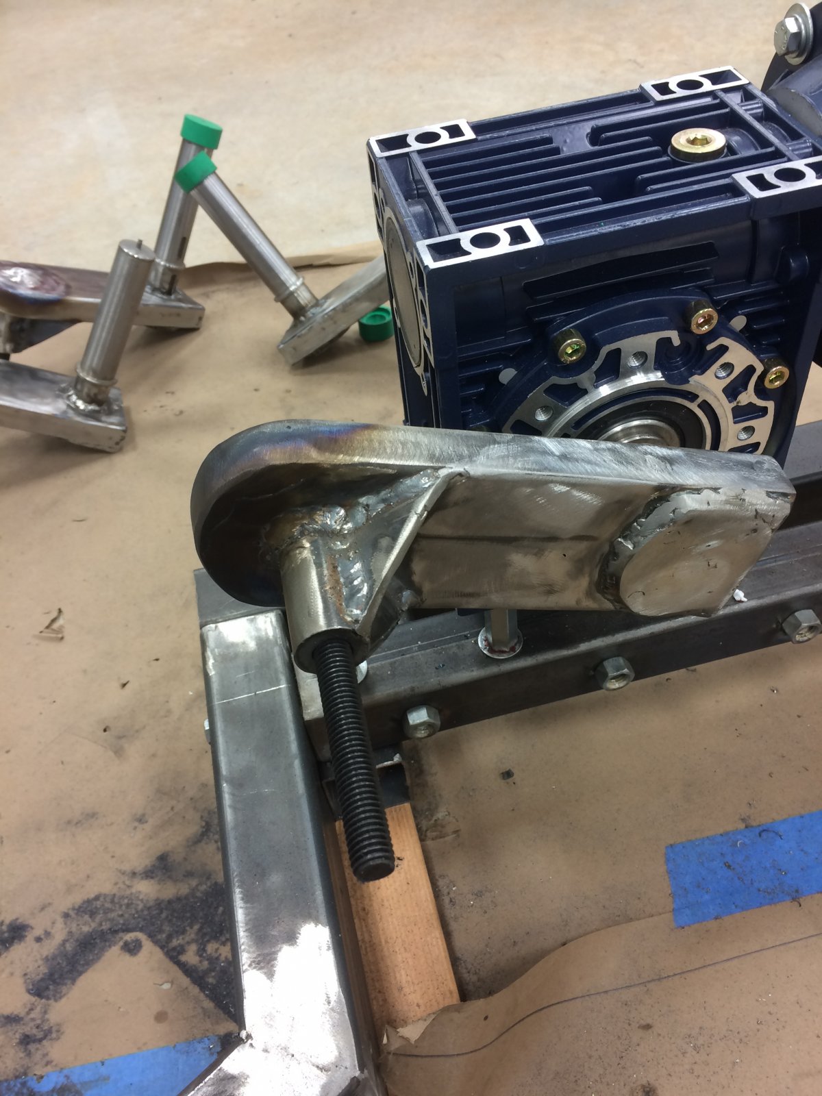

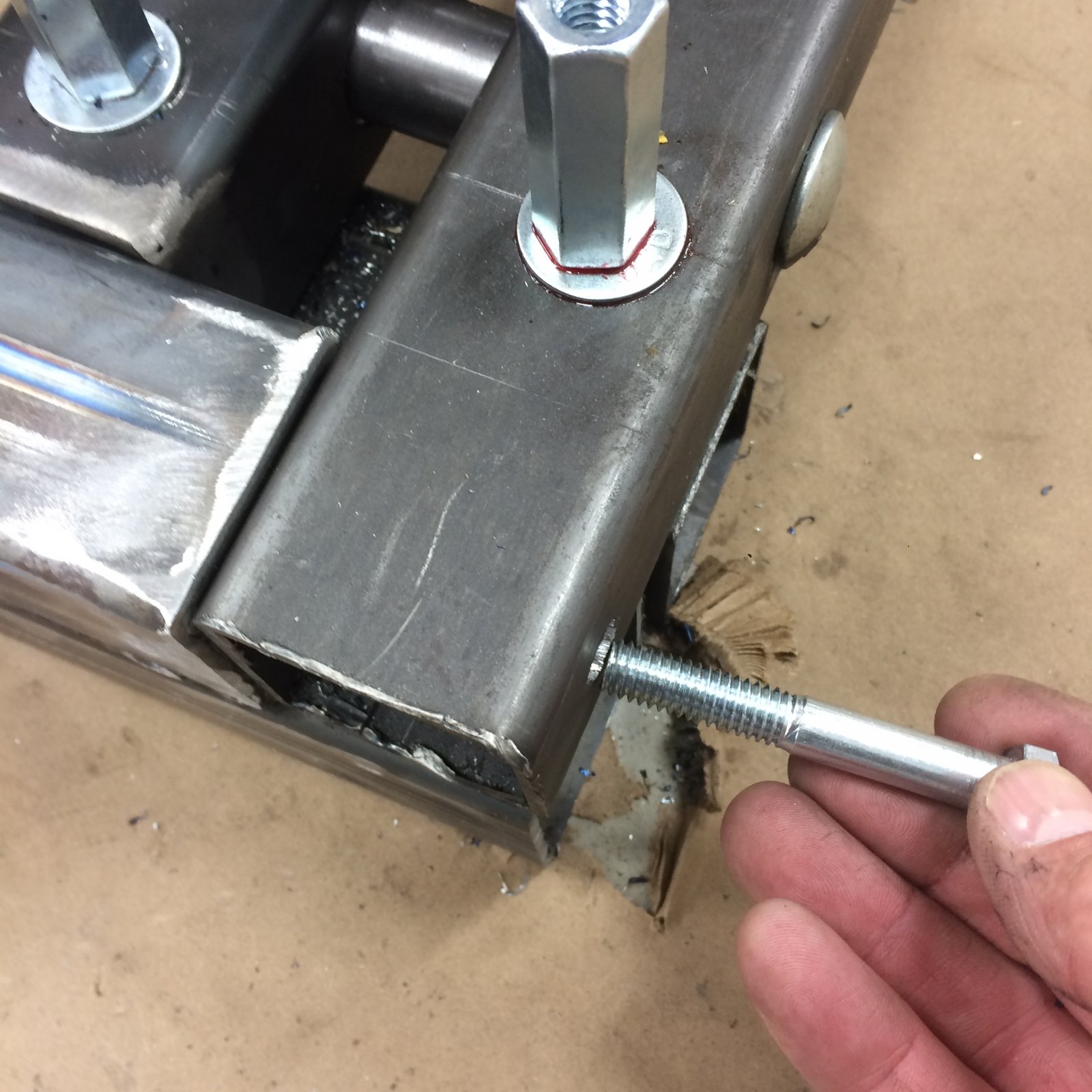

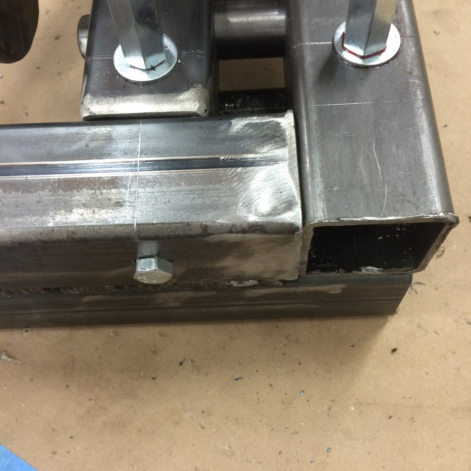

    Completed lever arm. 1" x 3" x 9.5" long. Shaft to hemi joint 160mm. I will be smoothing and painting this weekend
  8. GA-Dawg
    GA-Dawg Active Member
    Feb 16, 2016
    34
    Woodstock, GA (US)
    240Coins
    +136 / 0 / -0
    AC motor, 6DOF

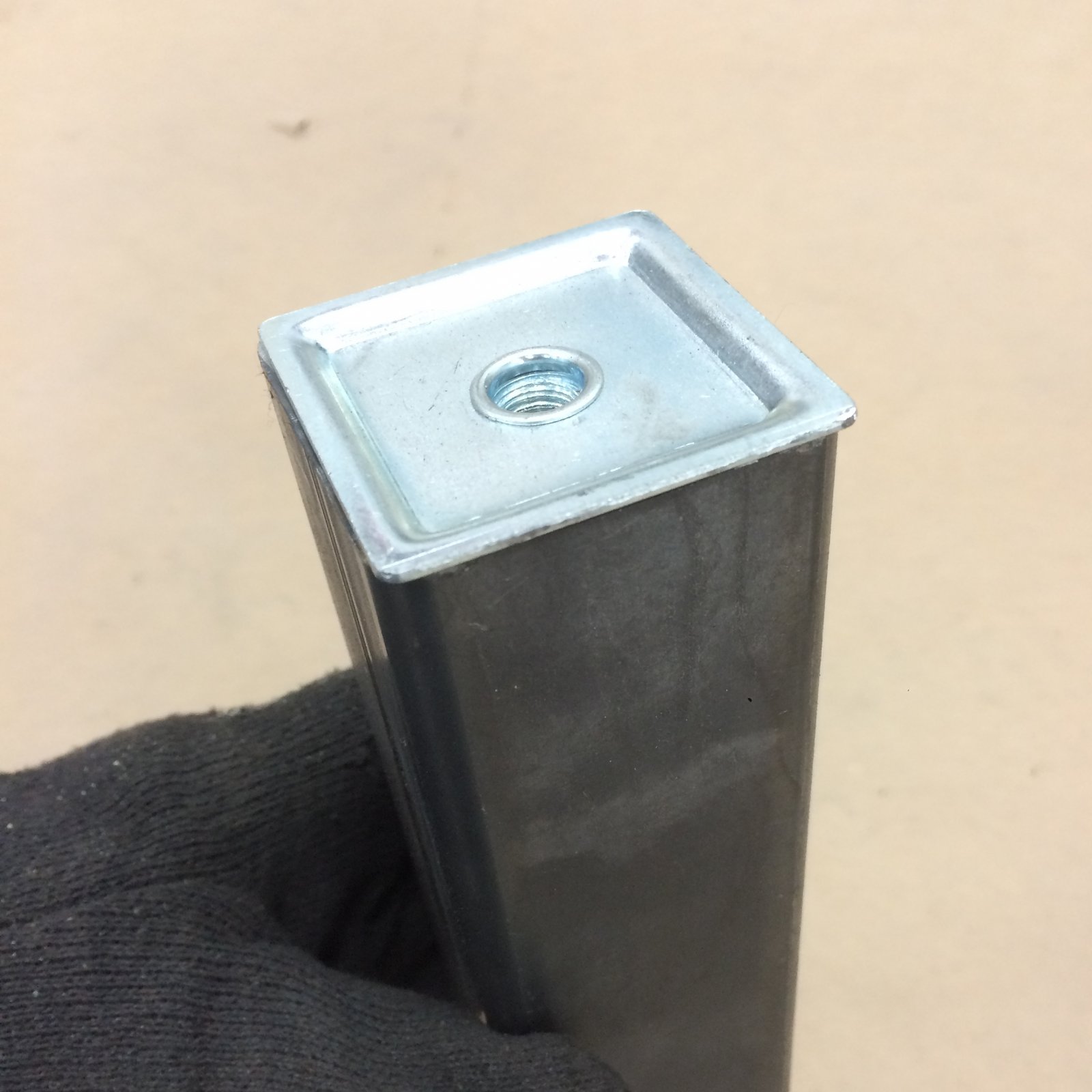

    Details of the ends. I made them interlocking by using end caps

  9. Nick Moxley
    17,057Coins
    +2,507 / 30 / -2
    Nice update Dawg, and Dayum are those Lever's thick mamma jamma's, smooth moves with the end cap's for joining the sections. :thumbs:thumbs

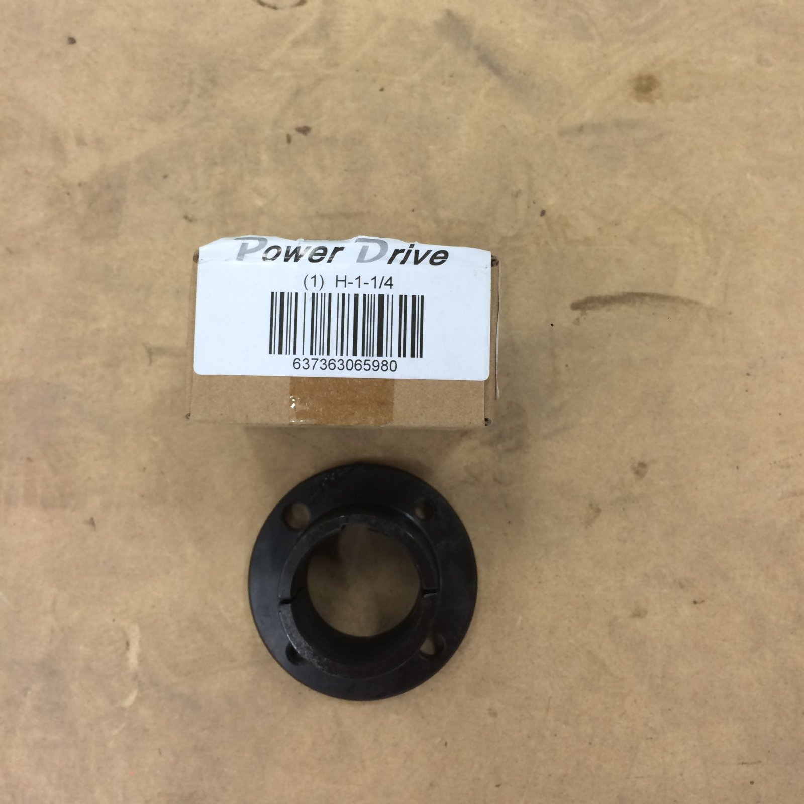

    Little bit more on the levers. They are not solid (part of the DIY plan) but still large. This was to accommodate the use of these power H drives as the outside diameter is 2.5" 23757718783_f587be3f0e_o.jpg 24419194140_57840a58ce_o.jpg
  11. Nick Moxley
    17,057Coins
    +2,507 / 30 / -2
    Ah icic. That makes sense.

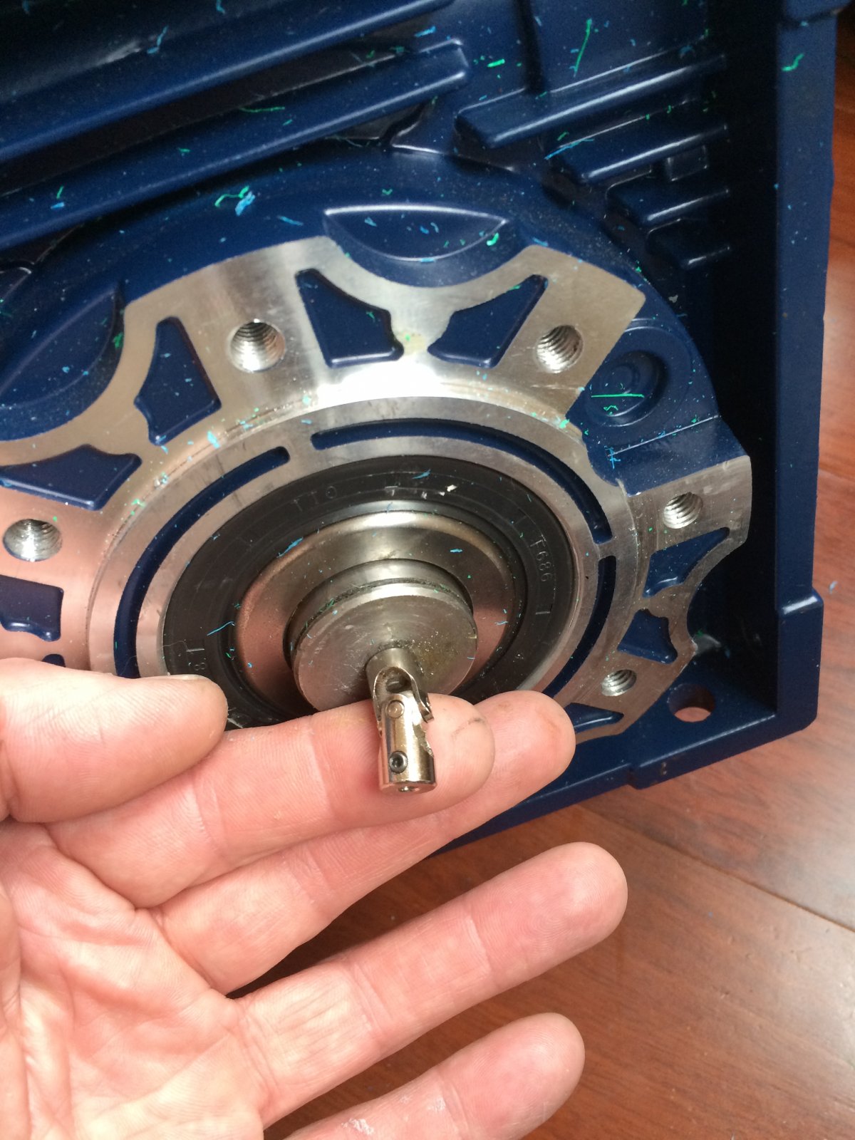

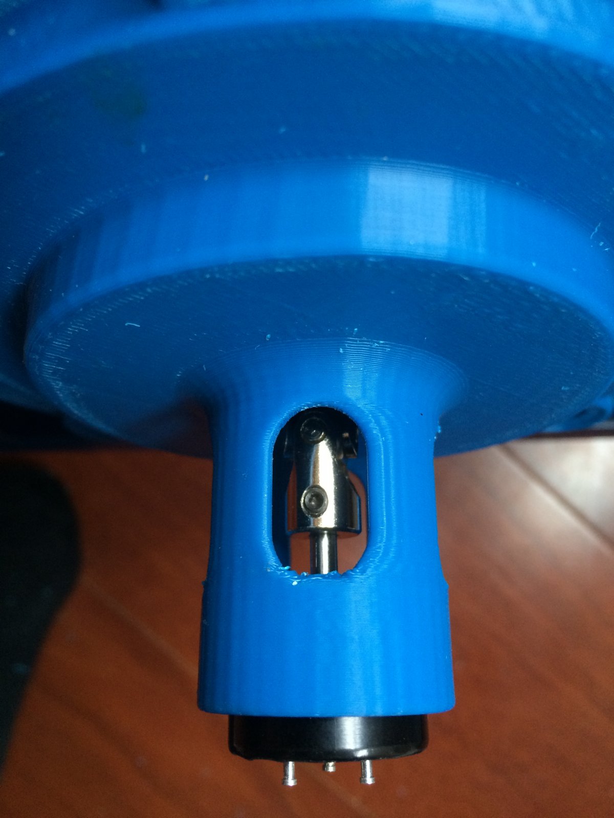

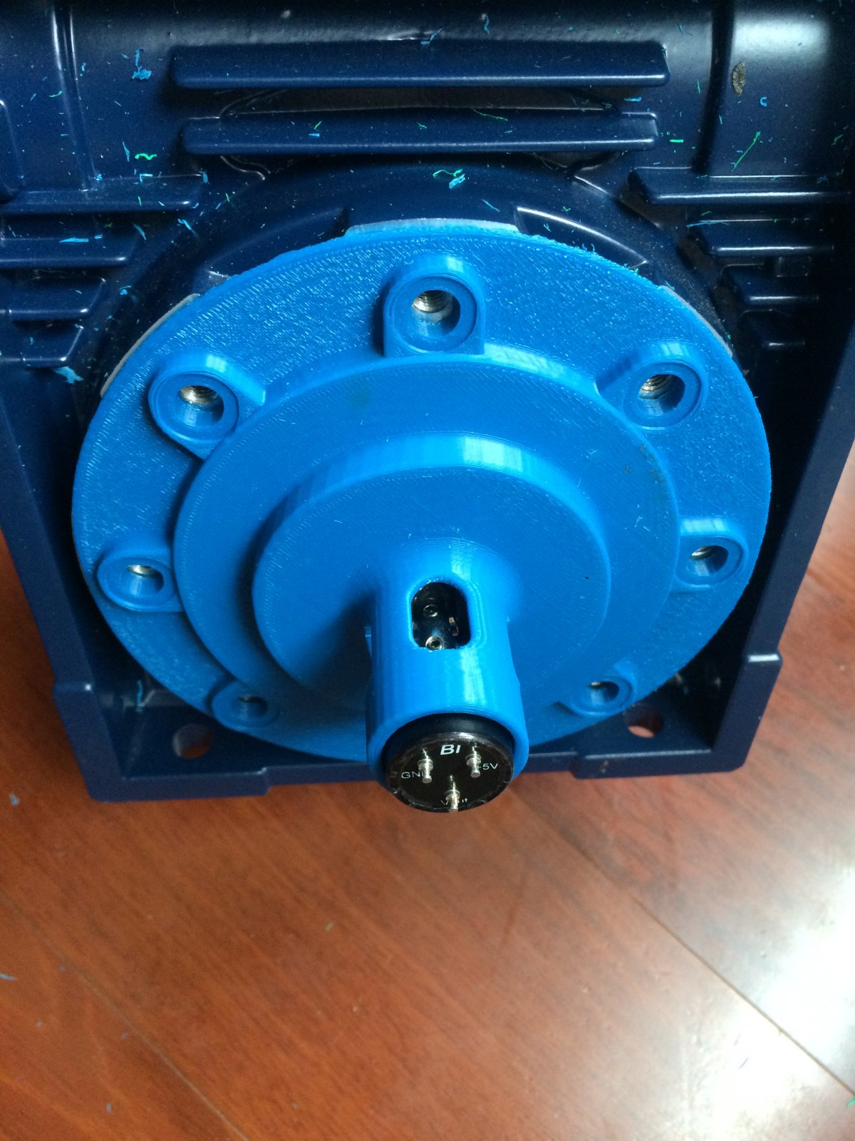

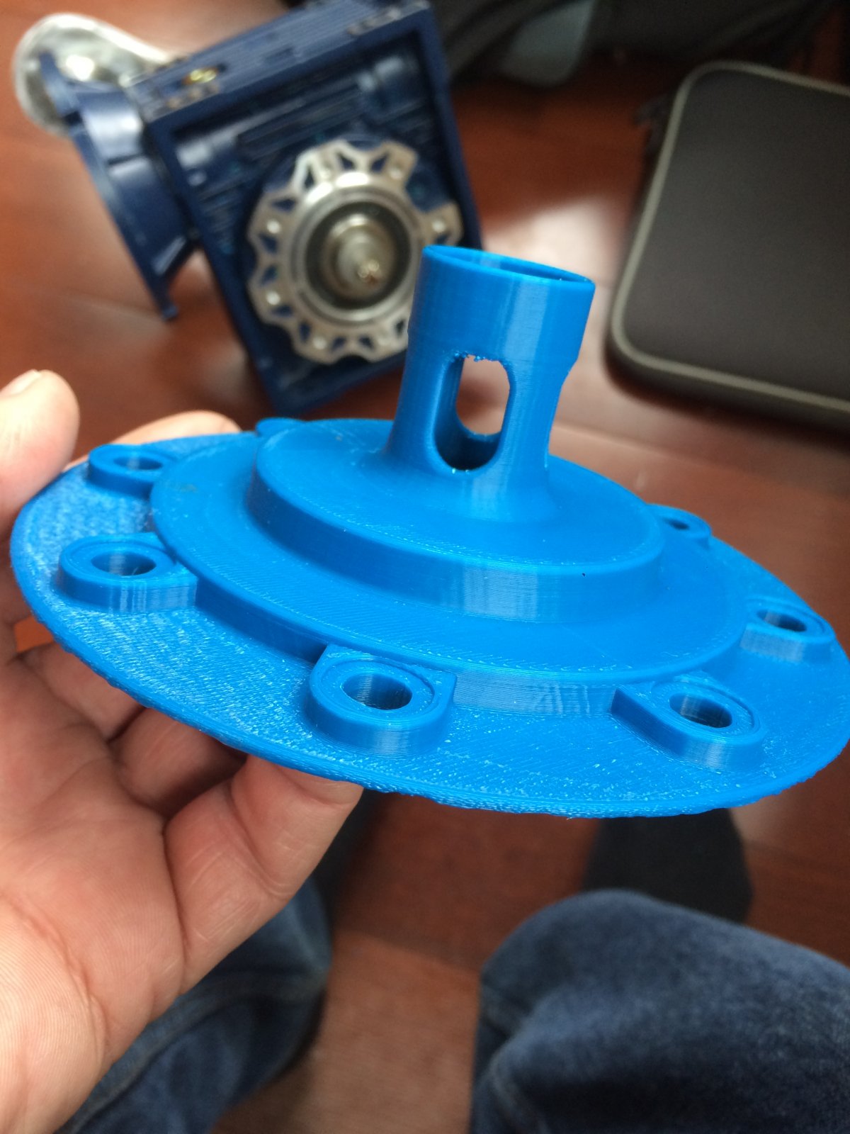

    Finish designing the position sensor mount. I am using a RC u joint to attach the shaft to the sensor. I attach the .stl file if anyone wants it.
    24858206320_5be8b5c8df_o.jpg 25035620732_66e6a6f75c_o.jpg 25060612011_22c93e3809_o.jpg
    • Creative Creative x 4
  13. wannabeaflyer2
    Jun 12, 2015
    724
    london uk
    8,359Coins
    +958 / 7 / -0
    Hi @GA-Dawg Man o Man don't you just love 3D printers , That is some sweet Work you have done on the Pot Mounts , very Impressive sir , But Then agin I expect nothing less from you , given the amount of detail you put into your Build Log .. can I ask What software you used to design the parts and produce your STL files for the Pot Mounts :)
  14. GA-Dawg
    Feb 16, 2016
    34
    Woodstock, GA (US)
    240Coins
    +136 / 0 / -0
    AC motor, 6DOF
    Thanks for the kind words. I have done everything in Solidworks. I included the Soildworks file in the zip. If there are other formats people would like to experiment with please let me know and I will see if it will let me convert.

    Nice 3d print stuff:thumbs, but how is the pot fixed in the housing - pressure fit?

    On the pot. I am using a small headless allen set screw (it's on the underside in the photo so not visible)

    Cool pot mount Dawg. I hope there is ZERO play in that U joint you picked up, Last thing you want is a Tiny Tick of play that is taking some of the uber fine detail away due to a little slop or play that developed in the joint. What car/brand is it from ?

    @Nick Moxley ...There does not seam to be any play in the u joint BUT I would agree it could be a problem, only time will tell if it does not work out I could print something. :) And I got it from Amazon. it's a 4mm to 1/8 u joint.
