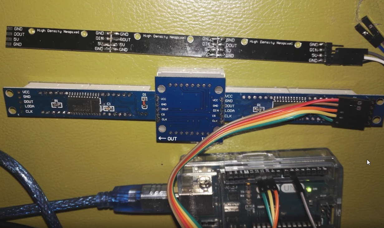

    DashX2 offers the following configuration:
    • Arduino uno/nano validated. Beside power, only 4 pins are needed. Gear and 7 segment modules are cascaded. Should you change the cascading order, just update the order in the code using the #define statements.
    1. Pin 10 =TM1638 Data
    2. Pin 11 =TM1638 CS
    3. Pin 12 =TM1638 Clock
    4. Pin 6 = RGB Leds

    Wiring is extremely simple as you can see:

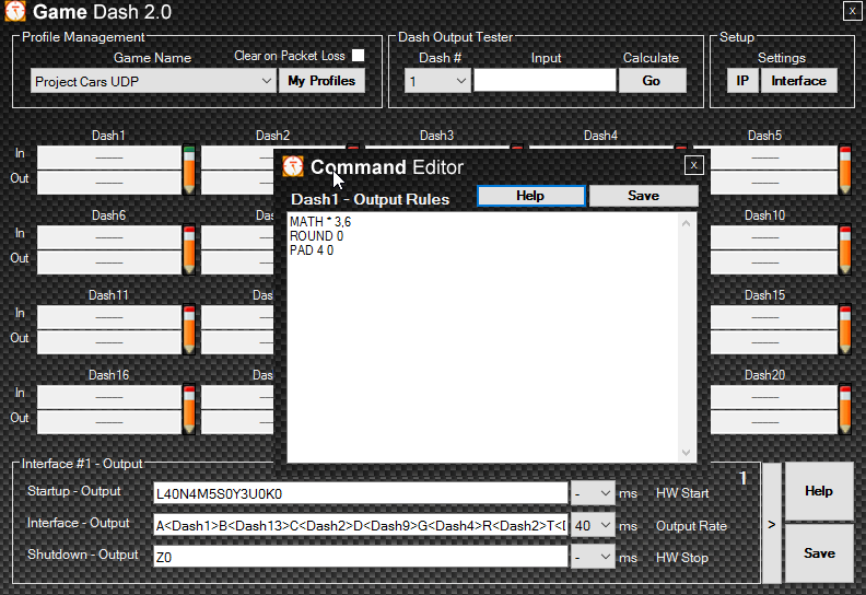

    Usage using gamedash is simple. In the interface Startup put the init string you want, and in the interface output the values you want to display.
    For ProjectCars, using the UDP plugin I made, the following settings work nicely :
    Do not forget to put the math rules to convert values to integer !!

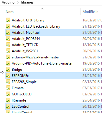

    The needed libraries, if you do not have them already are in the file DashX2_libraries.zip. Just unzip the content to your arduino/libraries folder as follow:

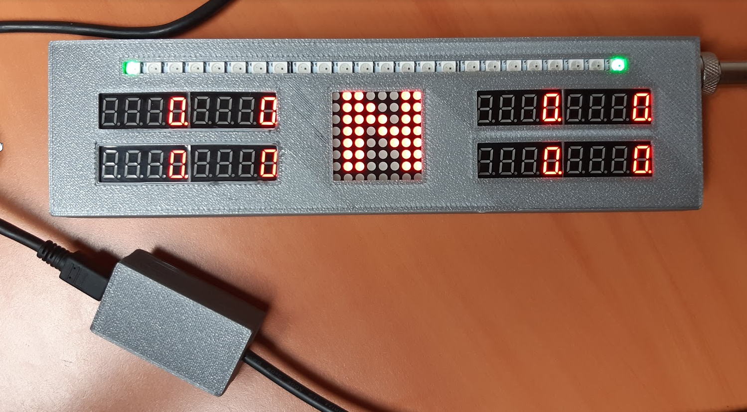

    Hello !
    It has been a long time I didn't post anything ;)
    Now, I'm back with my fully finished DashX2 that includes 8 4 digits LEDs (4 MAX 7219 modules in fact), and 3*8 RGB LEDS for RPM and a gear indicator.
    Here is the display after boot:
    The small box contains the arduino nano. The display box has a "dumb" 6 pin connector exposing all signals (3 for the cascaded MAX7219 and one for the RGB LED), so it can be re-used easily.
    The github repo is updated with this latest version if you are interested.
