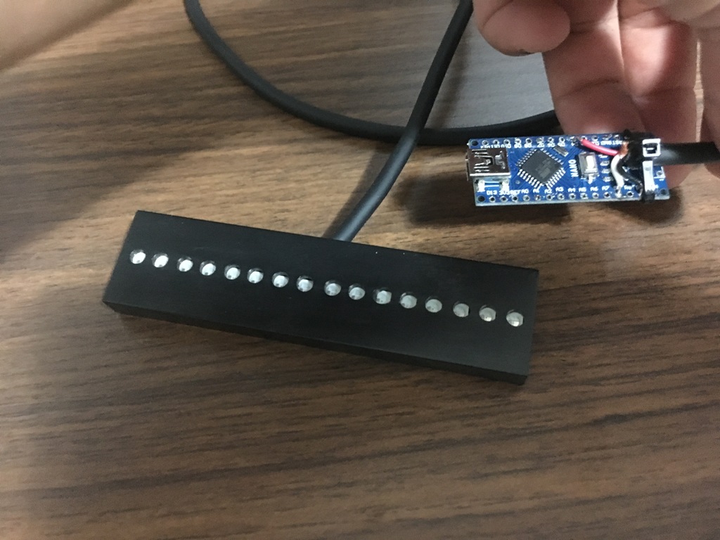

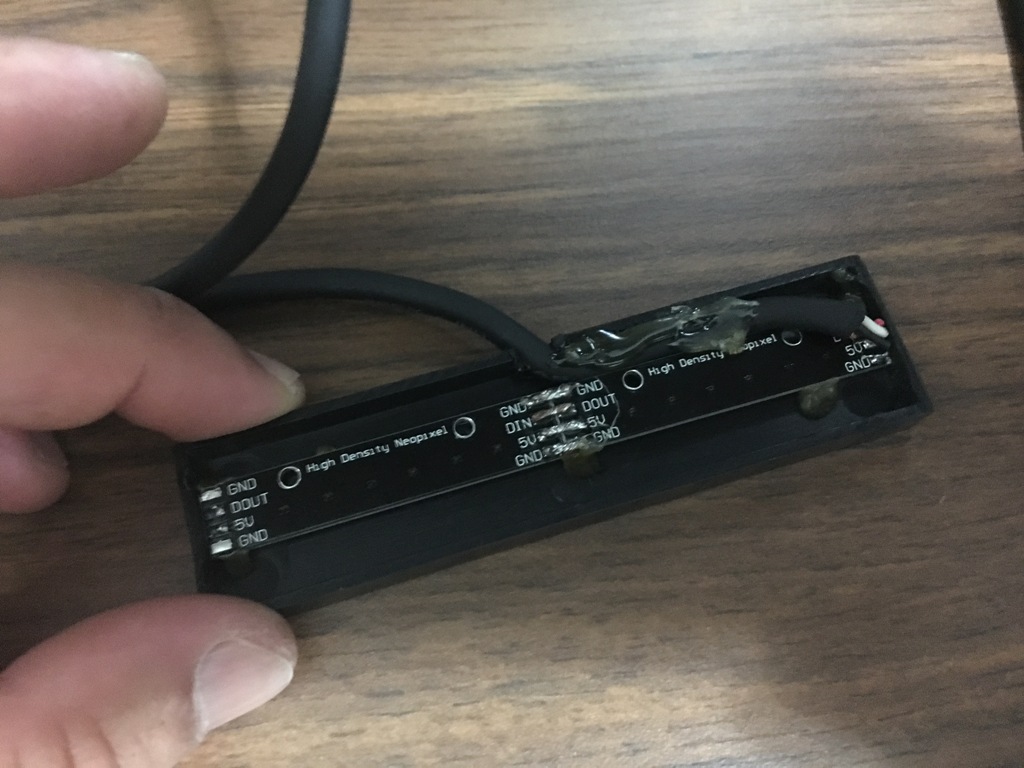

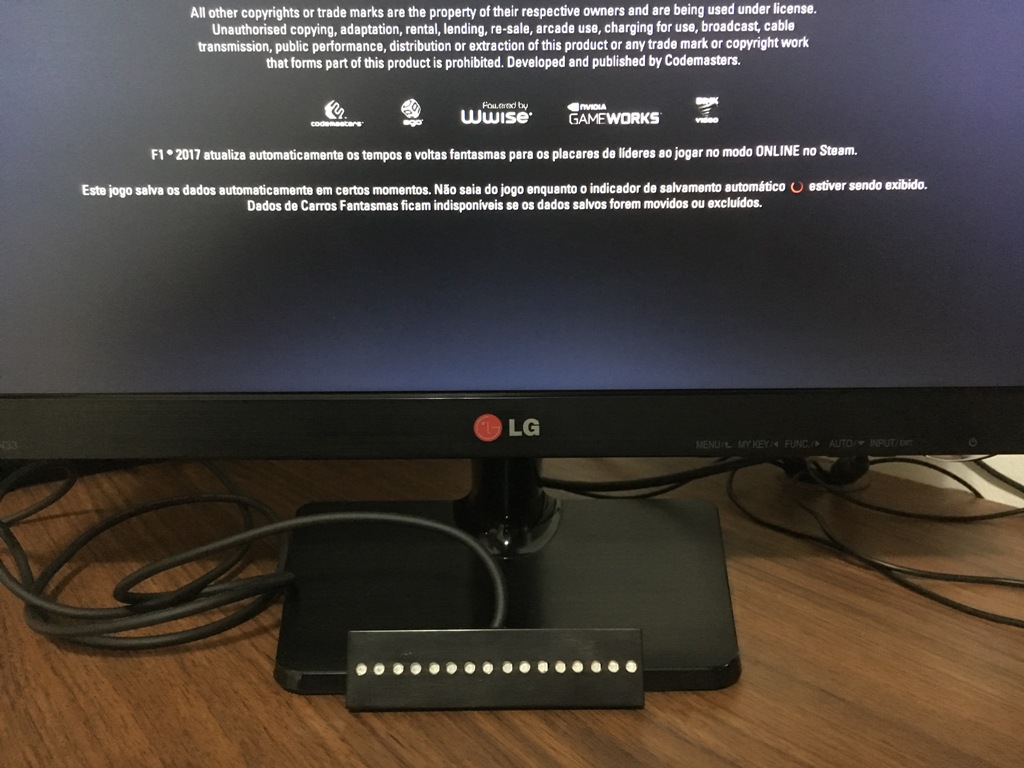

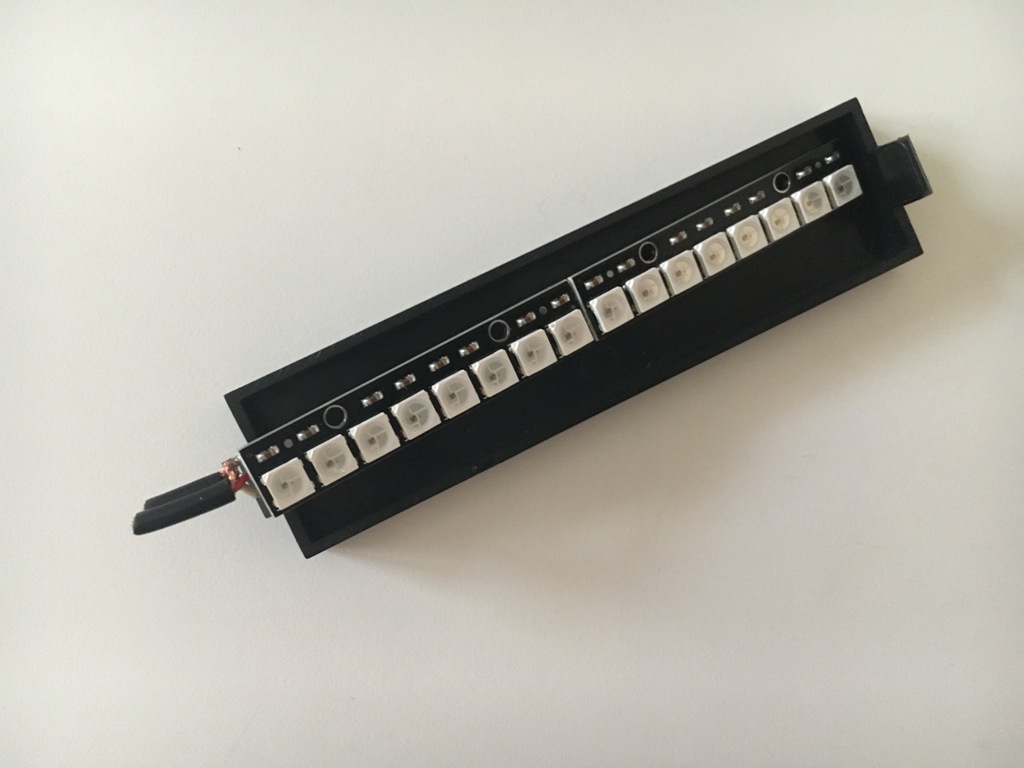

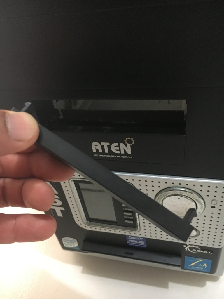

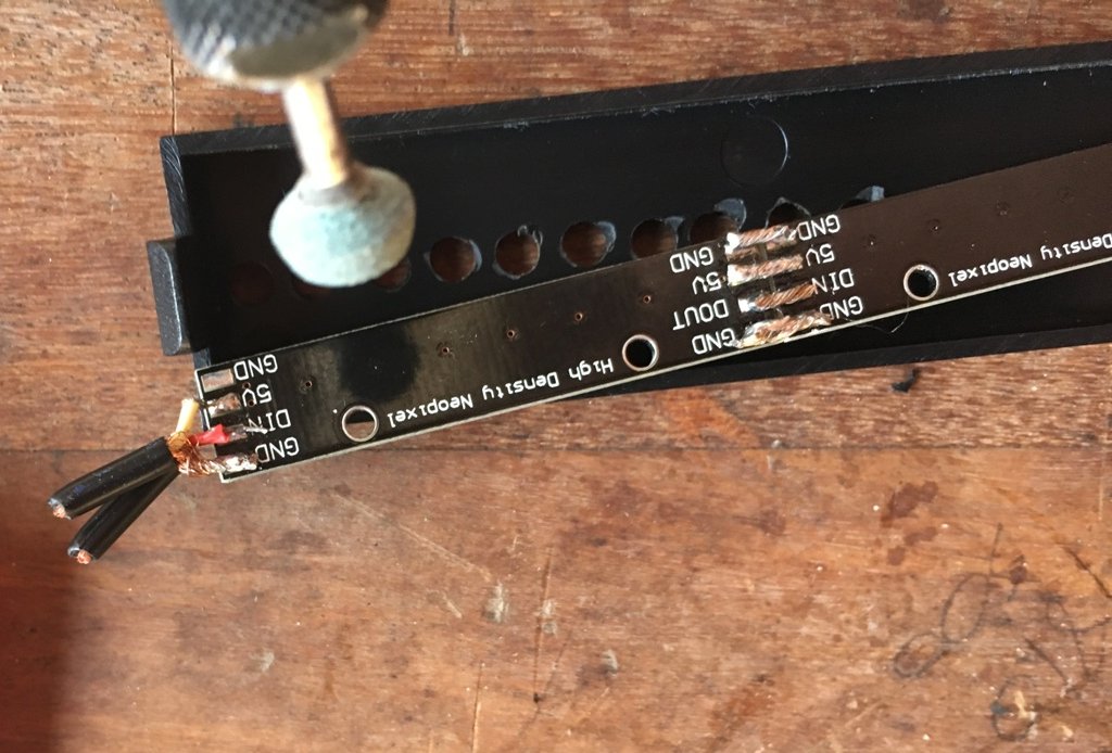

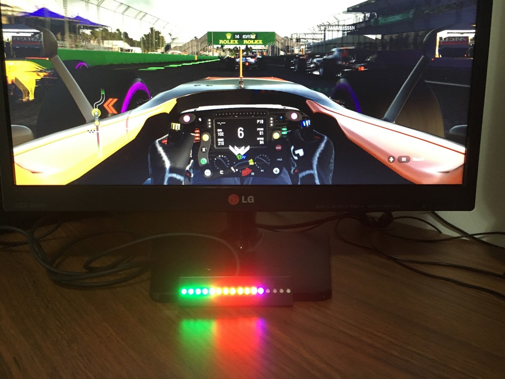

    I made a RGB LEDS as simhub software with low cost taking advantage of a 3 1/4 "drive cover.
    I'll use it in my 2dof simulator I'm making.

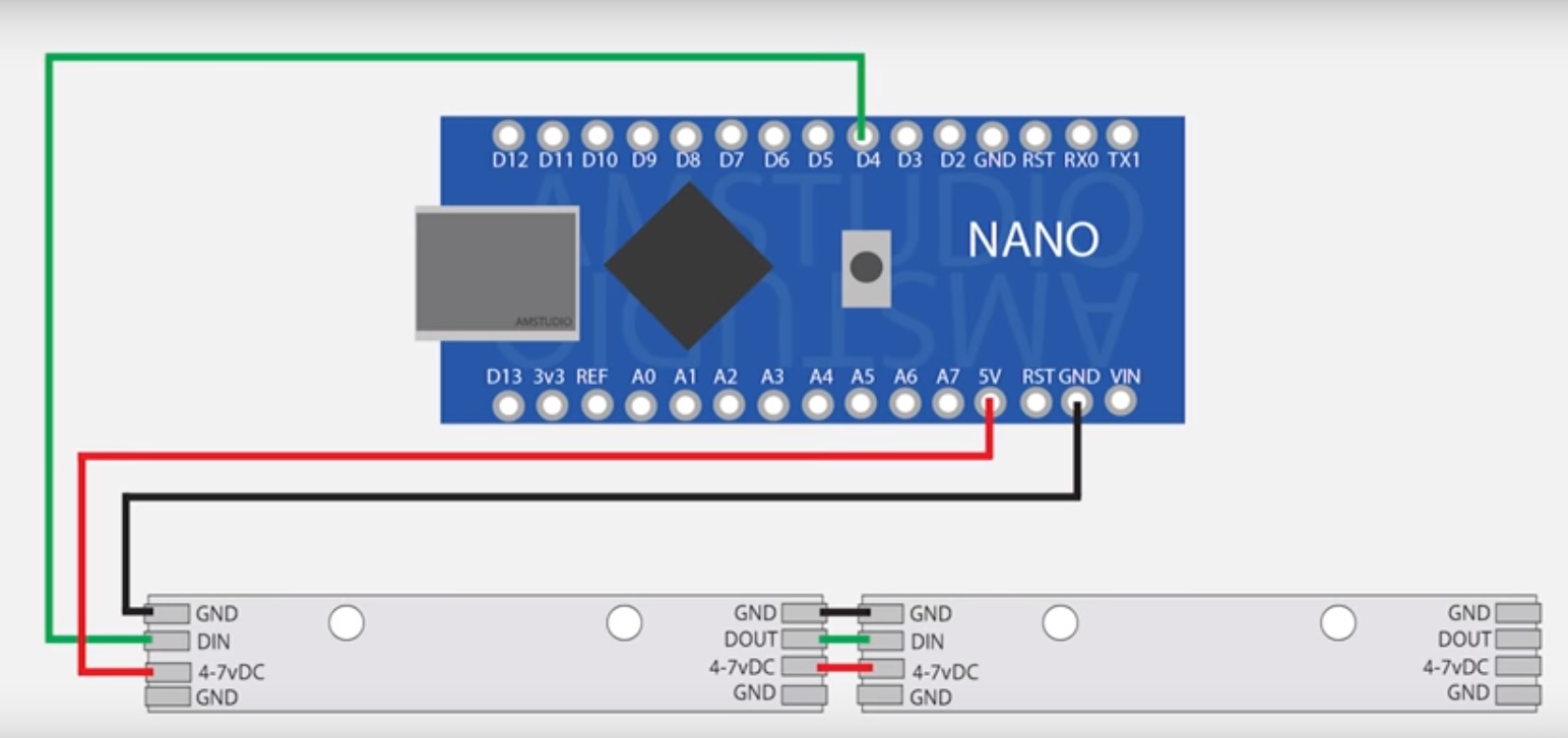

    Materials:
    Arduino Uno
    2 RGB Leds card
    50cm microphone wire
    Old computer plate of 3 1/2" drive
    Wiring:
    Photos:

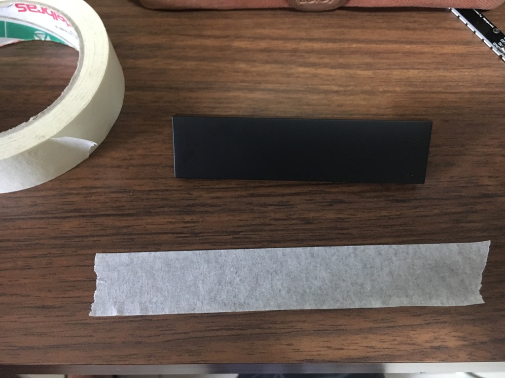

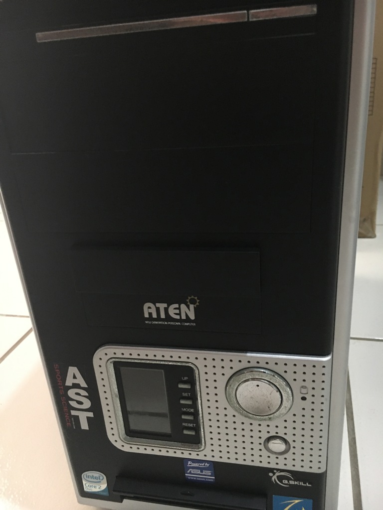

    Using the front cover of a 3 1/2" drive from an old enclosure:
    Two RGB LEDS cards will be installed behind the cover:

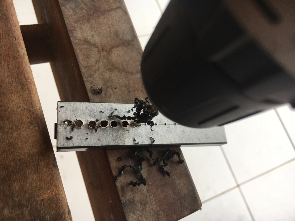

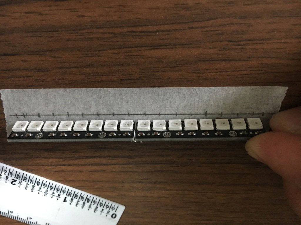

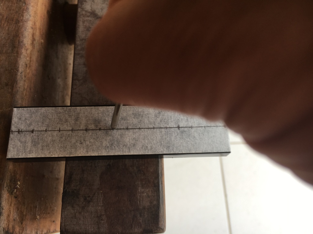

    Using a crepe tape we mark the points where the holes will be made:

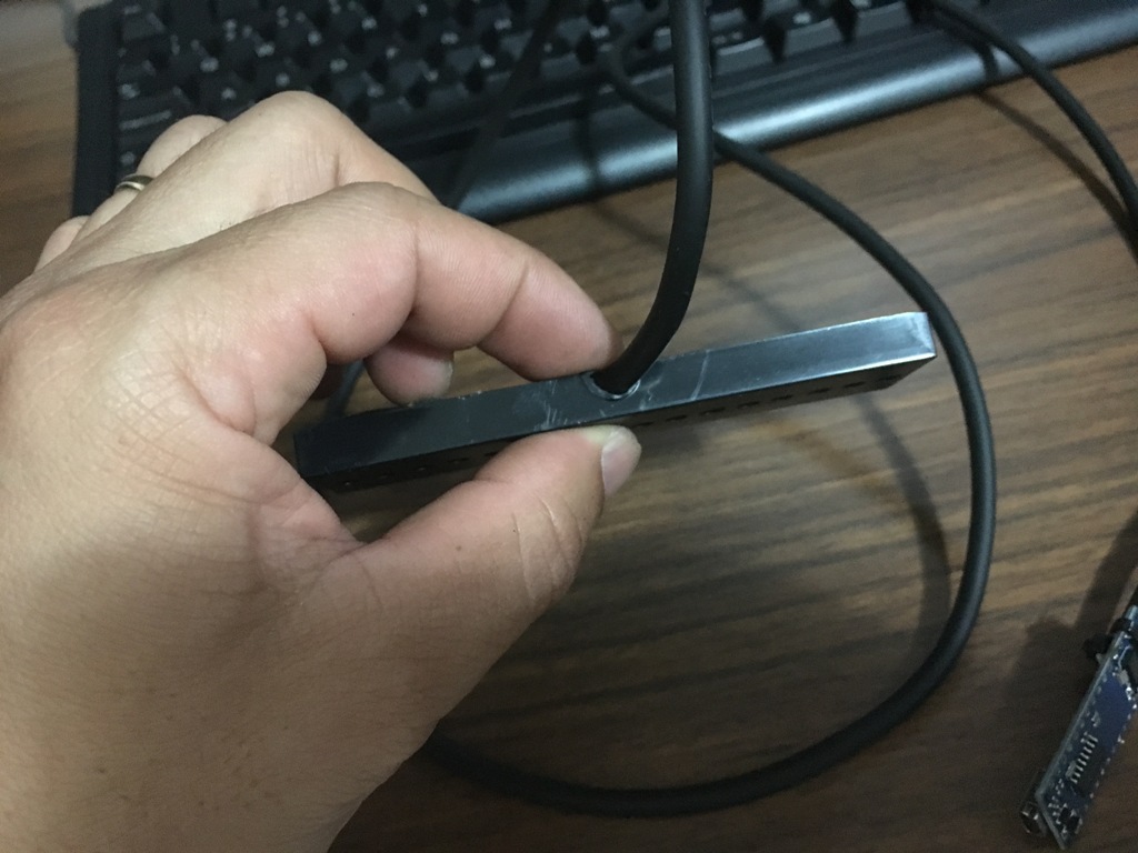

    Finish using a sandpaper and a small drill to make sure the two plates fit snugly:
    Ready now the finish:
    So easy and very, very low cost!

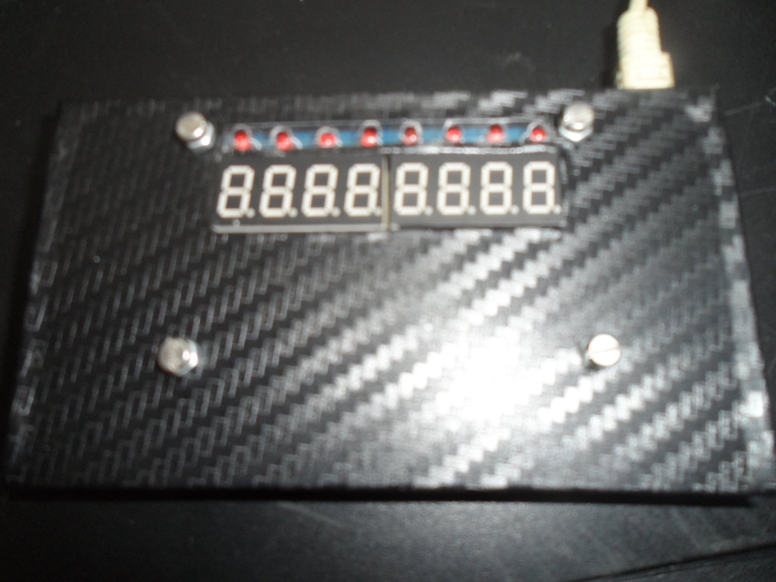

    I thought we could not show involving other Software like Simhub.
    Mine is ready too (TM1638)
    I followed the "amstudio" tutorial on youtube. (I've already mentioned it here in the community as well.
    I saw you are in Brazil. COOL.
    I'll post a working video
    the dashboards work very well on the android too, for those who can not spend with a Nextion display
    I'm still trying to work with XSIM
