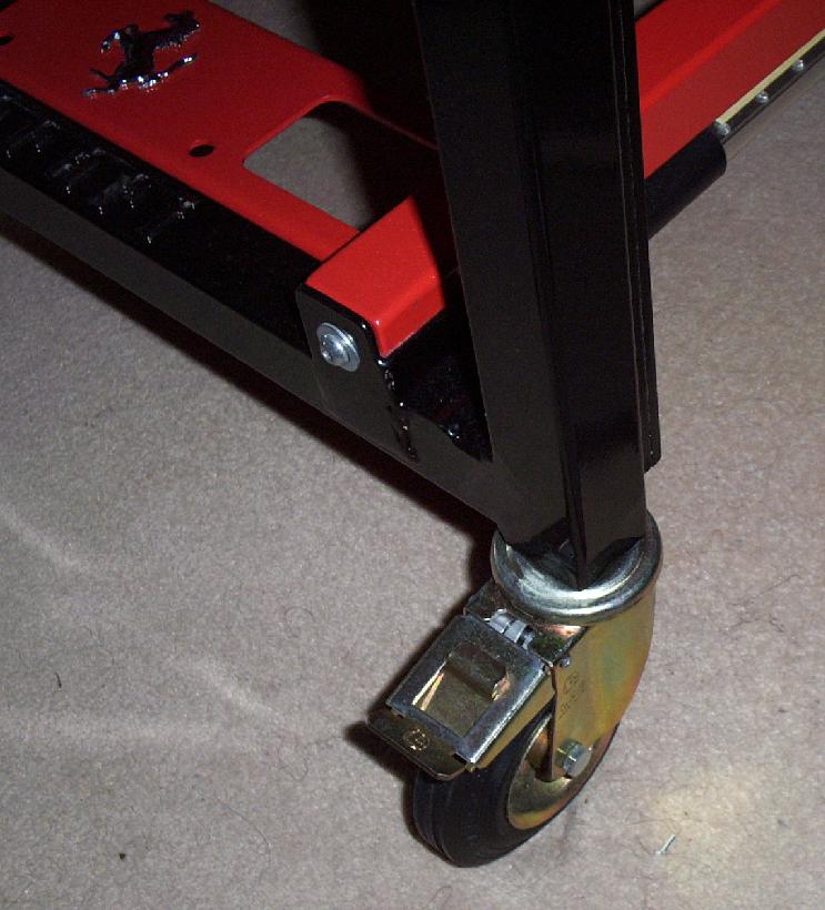

    Please see picture. I had buttkicker once and these caster wheels stopped alot of viberation, more than these dampers I think can do. Because none of the frame is touching ground and only 3mm of rubber touches the ground x 4 wheels.

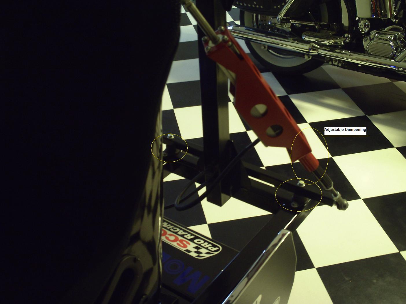

    Well, here is what I came up with for dampening. This approach solved two problems for me.
    1.) Most Frex and frex derivatives that I have seen tend to jump around on the floor, or display unrealistic vibration in other areas of the simulator.
    2.) My simulator lacked realism in that the effects were very abrupt and lacked the fluid motion that you get in a real vehicle due to the springs.
    I used one set of custom-built hand adjustable inline dampeners for removing hopping and unecessary vibrations in the non-seat areas of the simulator. This worked out very well.
    The second dampener (the dampening bar) is not adjustable and is responsible for helping to provide more fluid motion like that of the springs in a car. It is able to torque left/right and forward/back due to the angle of the actuators. My simulator simply doesn't feel as realistic without it. To be quite honst, I made this discovery by accident. :lol:
    Here's a quick picture of the final result.

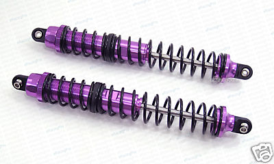

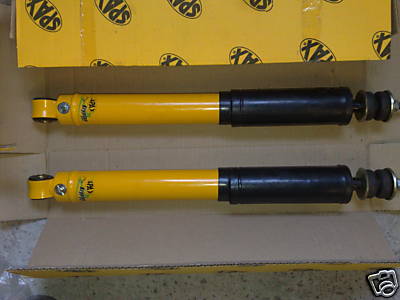

    That adjustable damper bar. I seen these on ebay. Any good?

    @Fahim..these are not the type of dampeners that I used. I considered shock absorbers like these originally, but they remove too much of the road texture. They do an adequate job of removing shock and vibration when sized properly, but they always removed too much.
    Therefore I designed my own and experiemented with various rubber and neoprene options. I finally settled on the dampening bar, which has the ability to torque and twist a little...the effect of this torquing and twisting is that is has a controlled snap-back. This helps to create the illusion of weight transfer like a cars springs. Before adding the dampening bar there was no sensation of weight transfer.
    The actuator mounts have inline adjustable rubber-based shocks as opposed to fluid dampened shock absorbers. This wound up working better because it could be adjusted to remove uneccesary jumping around of the motion base yet it still allows for the sensation of the road surface.
