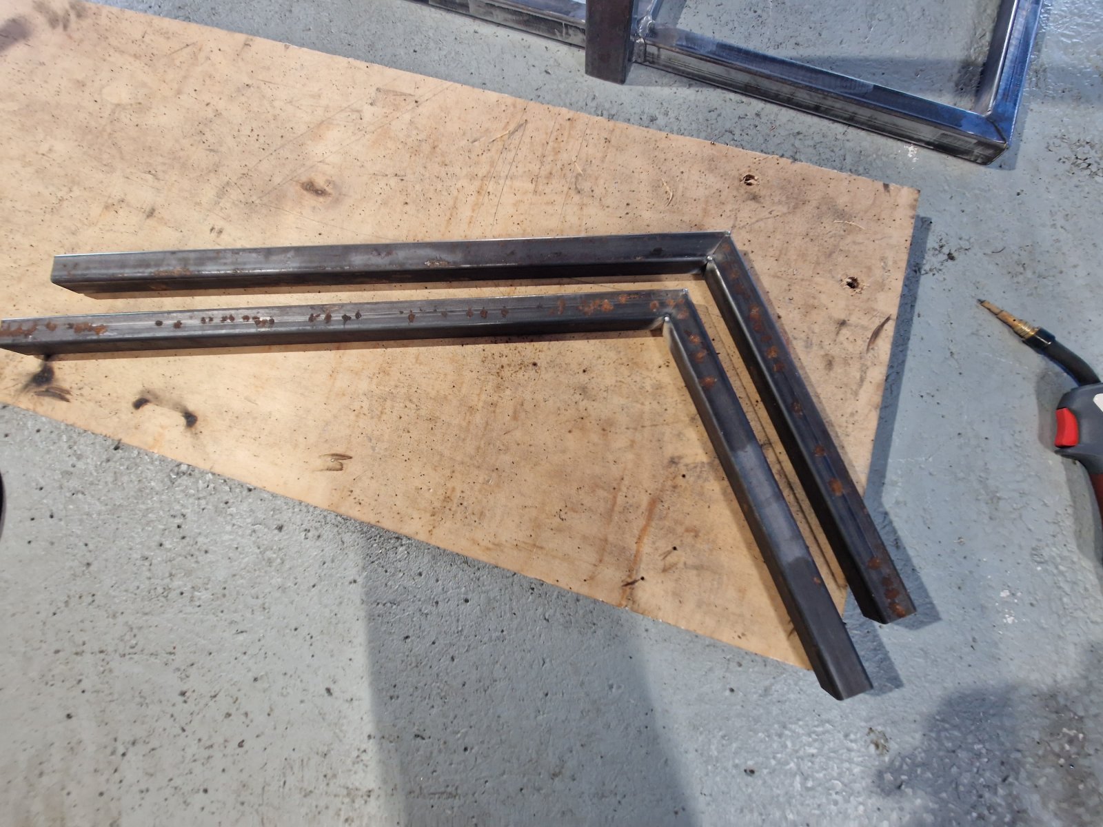

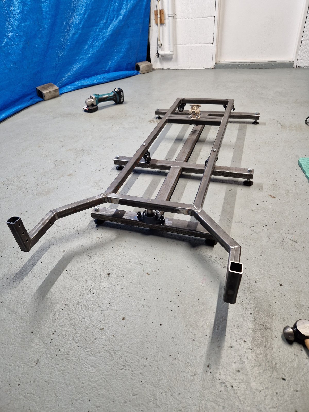

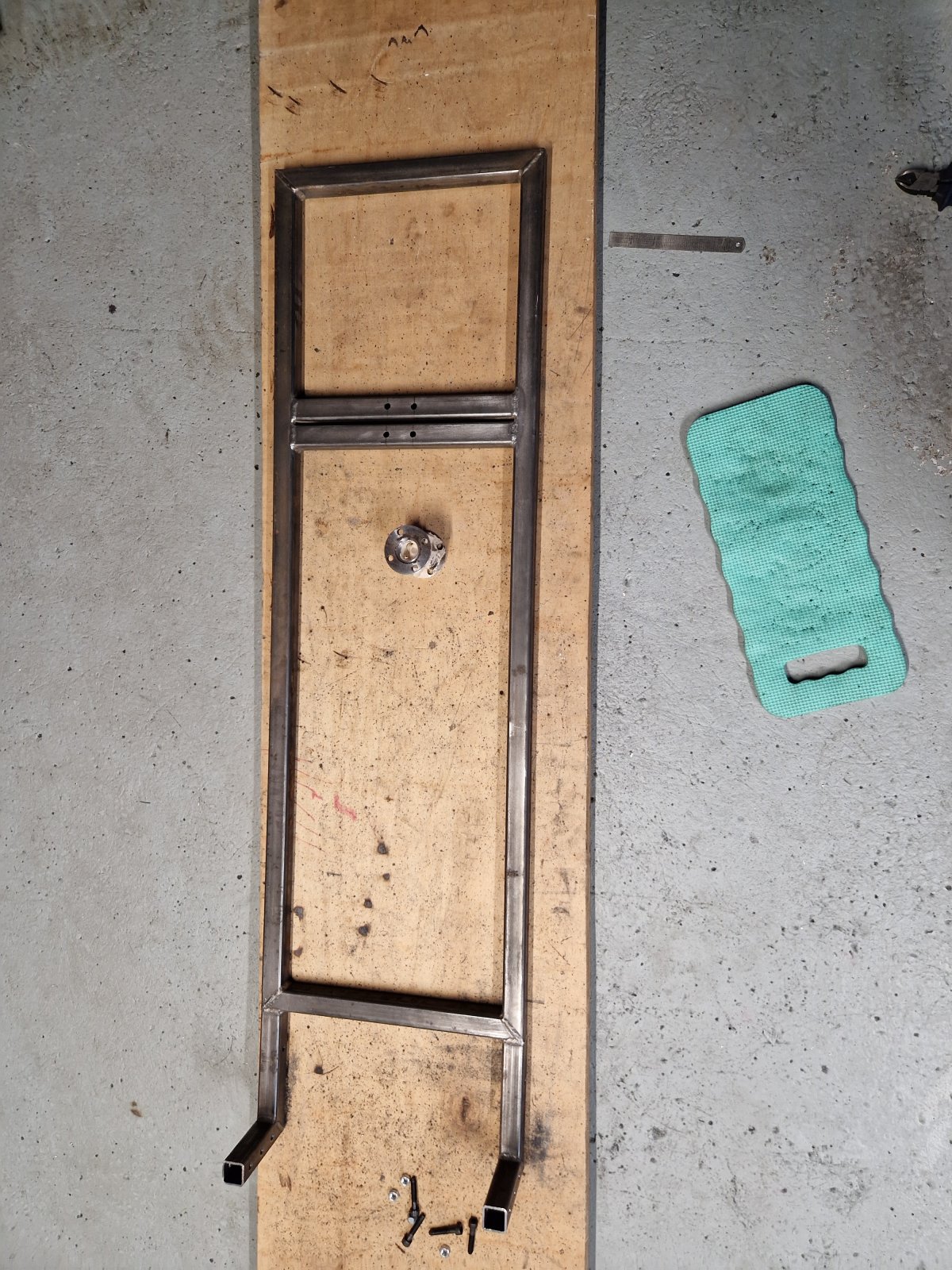

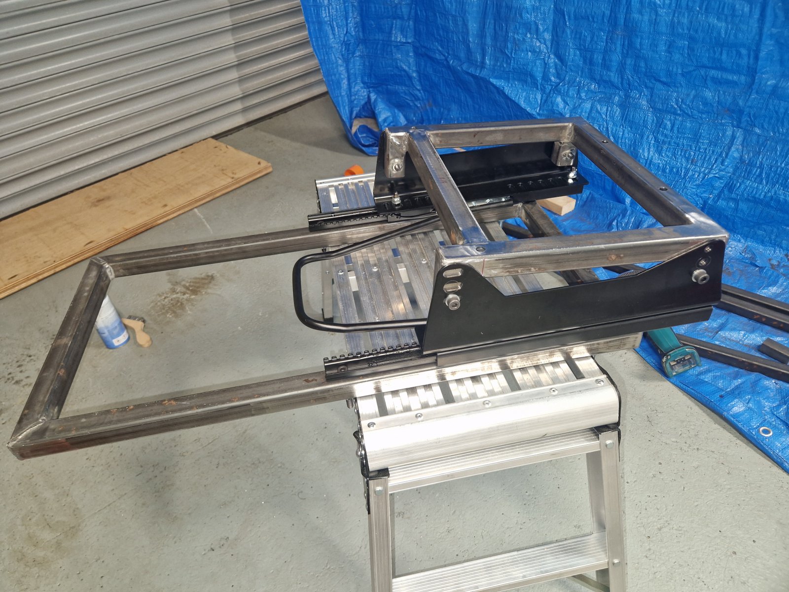

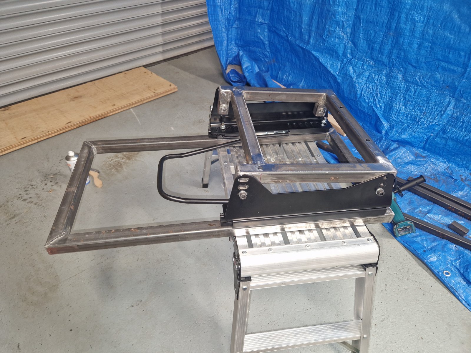

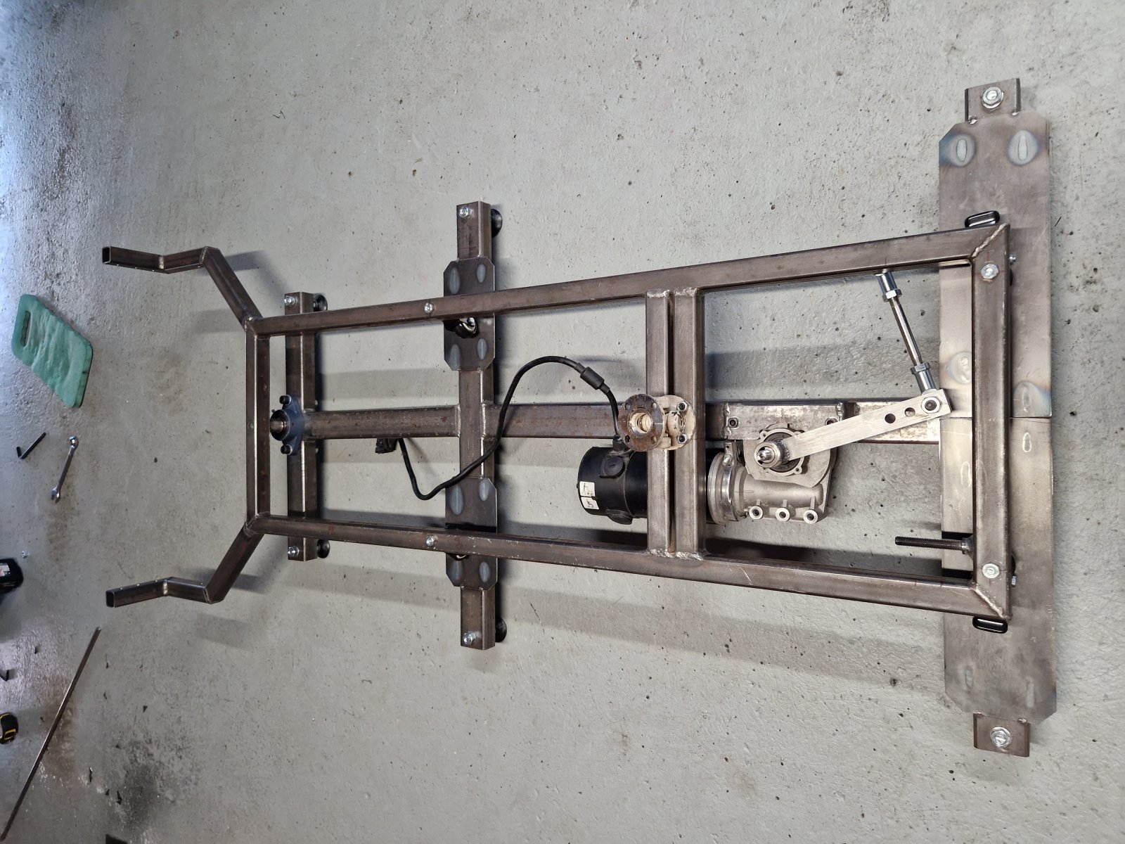

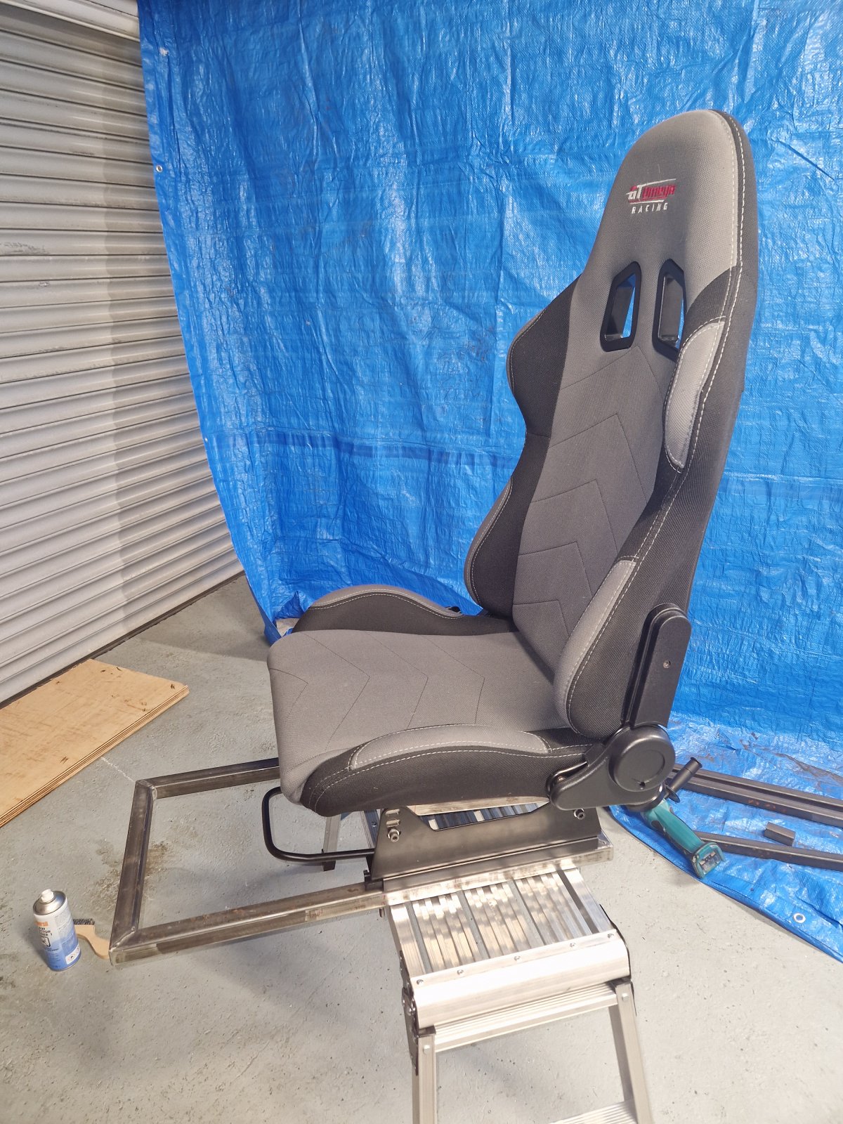

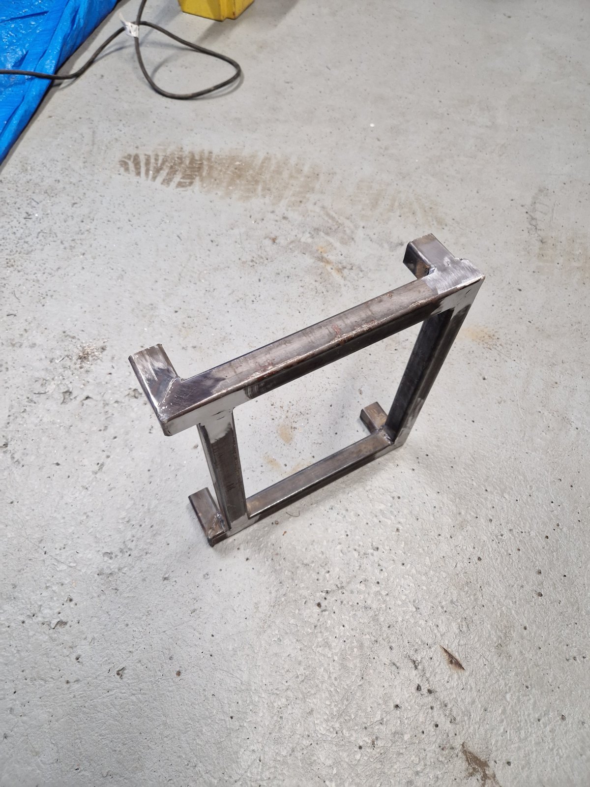

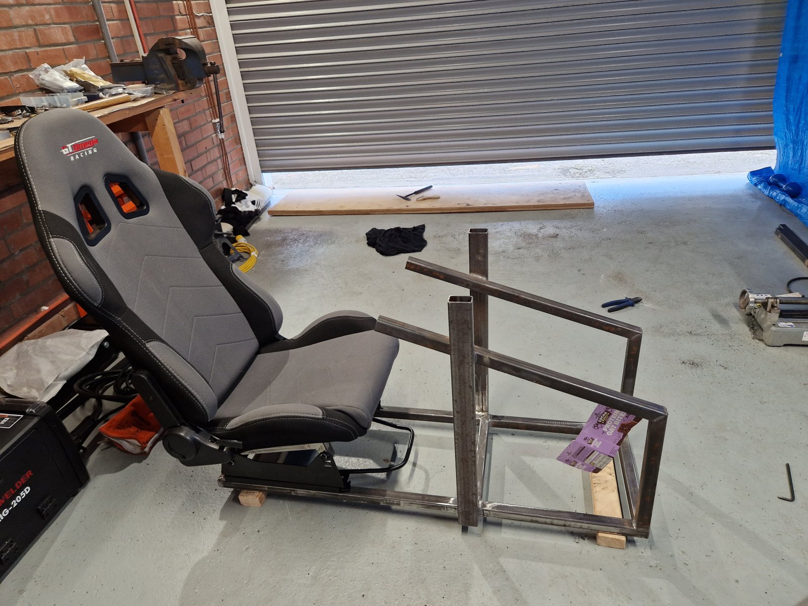

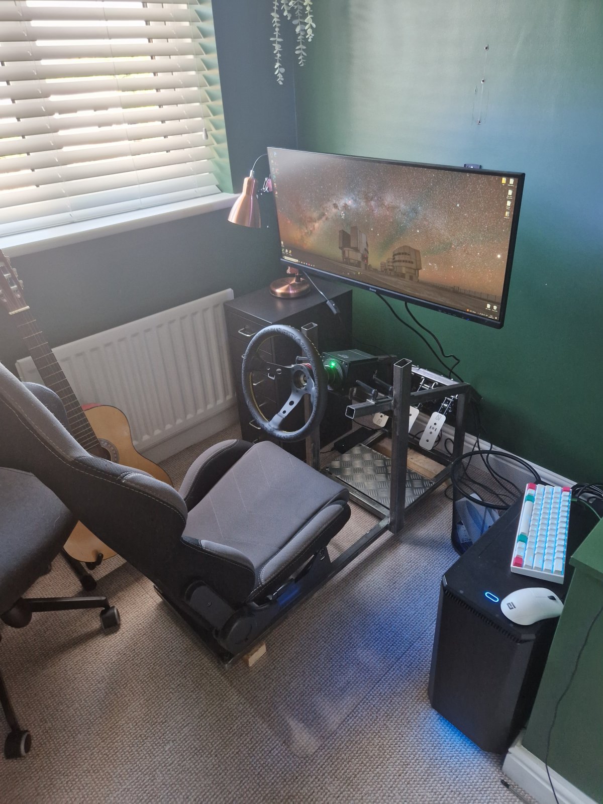

    Back from holiday and finally have everything I need to make a start. Few bits left to make / order but will cross that hurdle when I get to it.

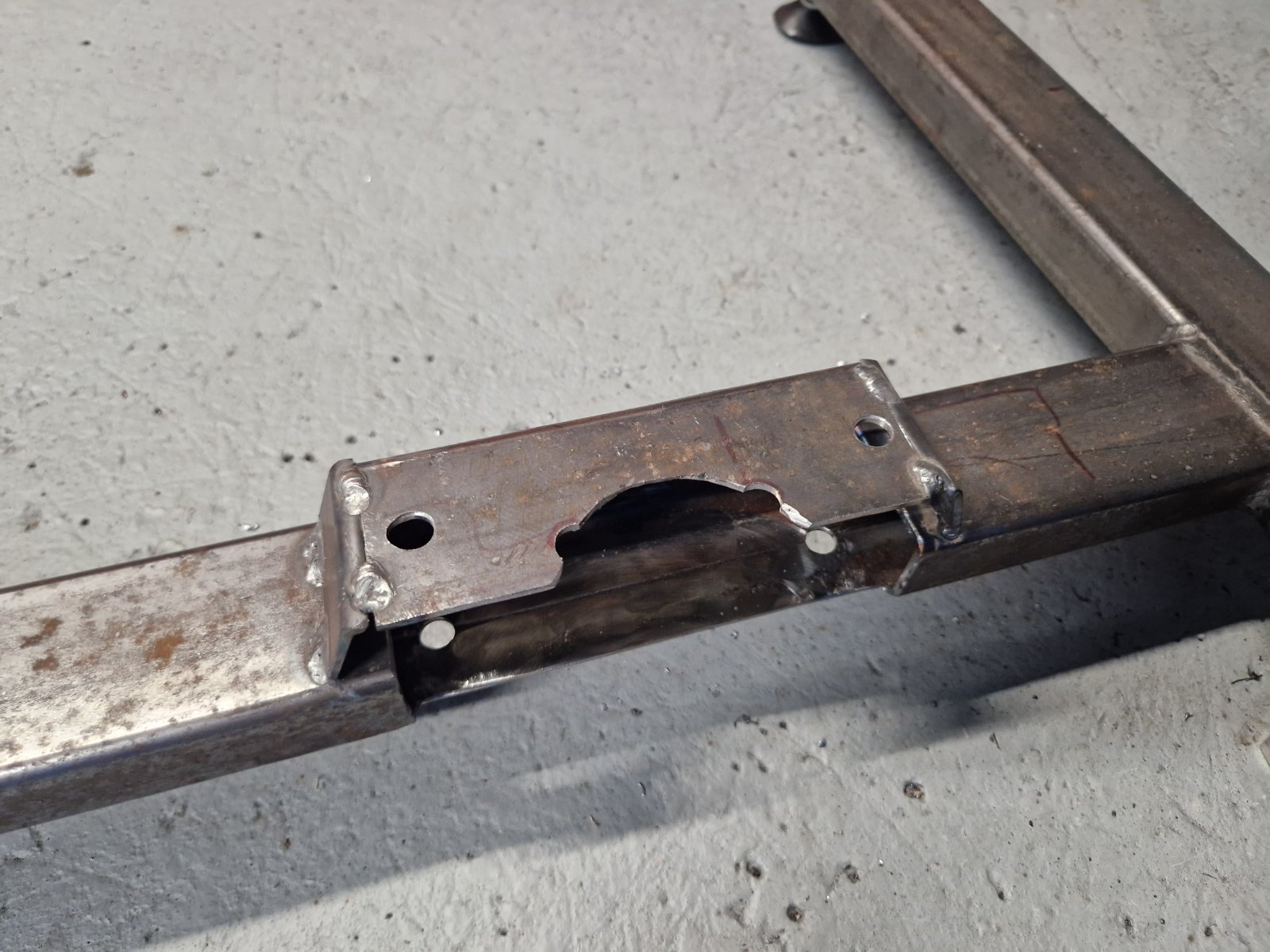

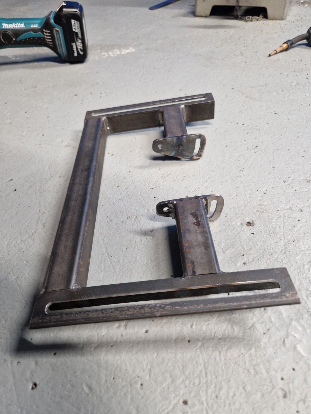

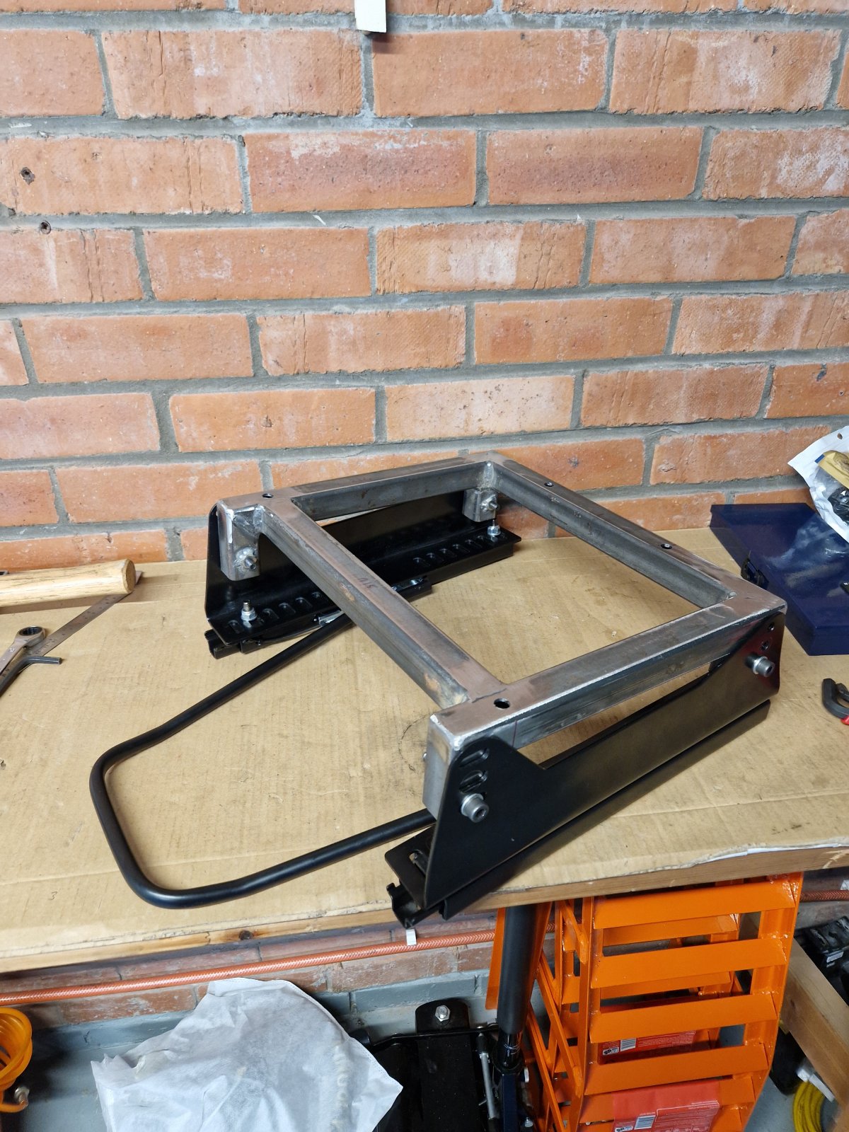

    Fabricating seat frame and mounting it to seat brackets and sliding rail

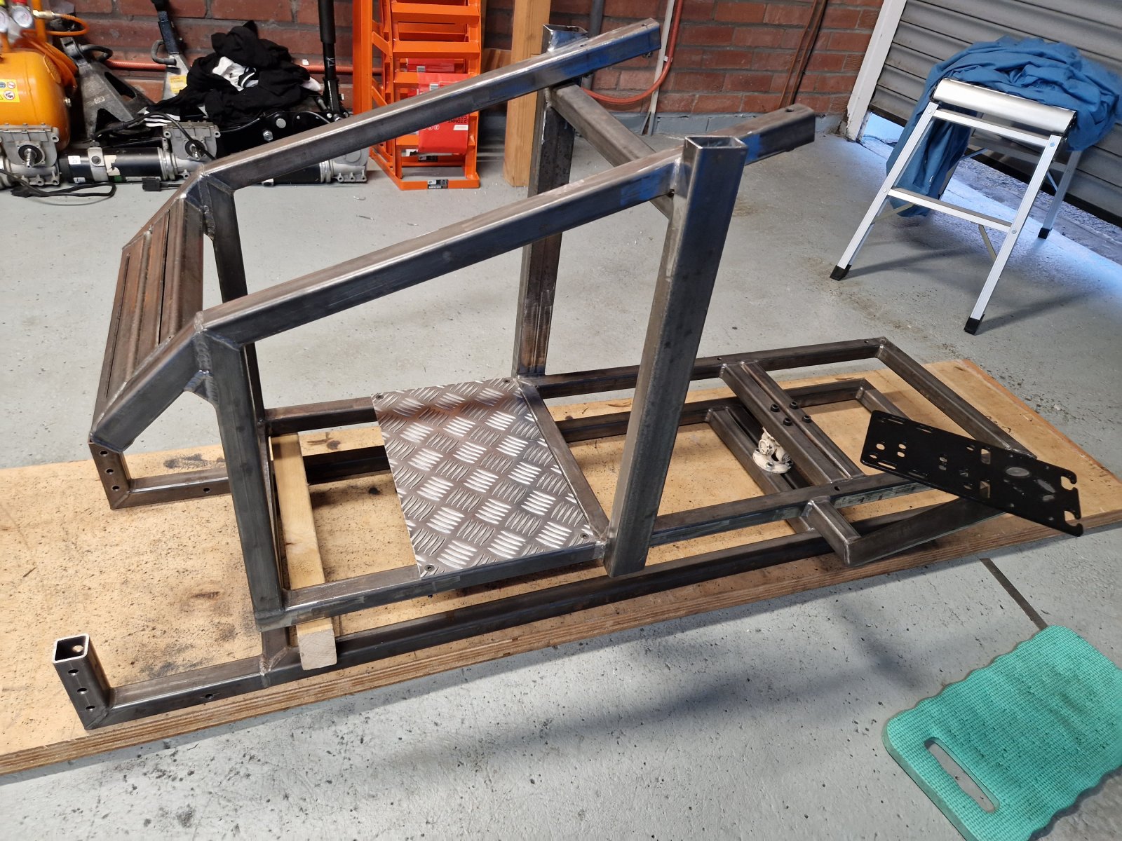

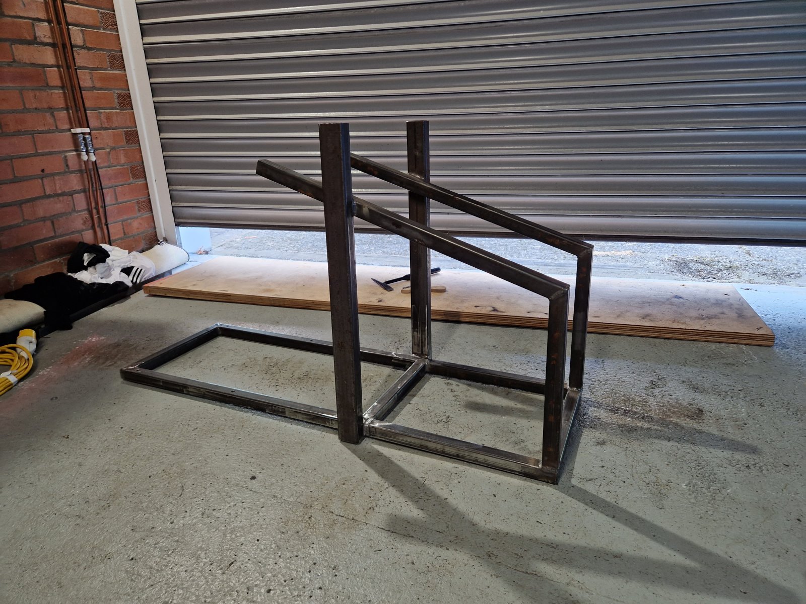

    Main section of cockpit frame, which wheel frame and pedal frame will attach to.

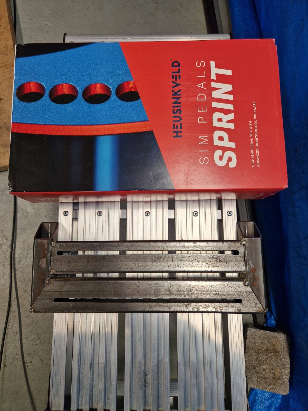

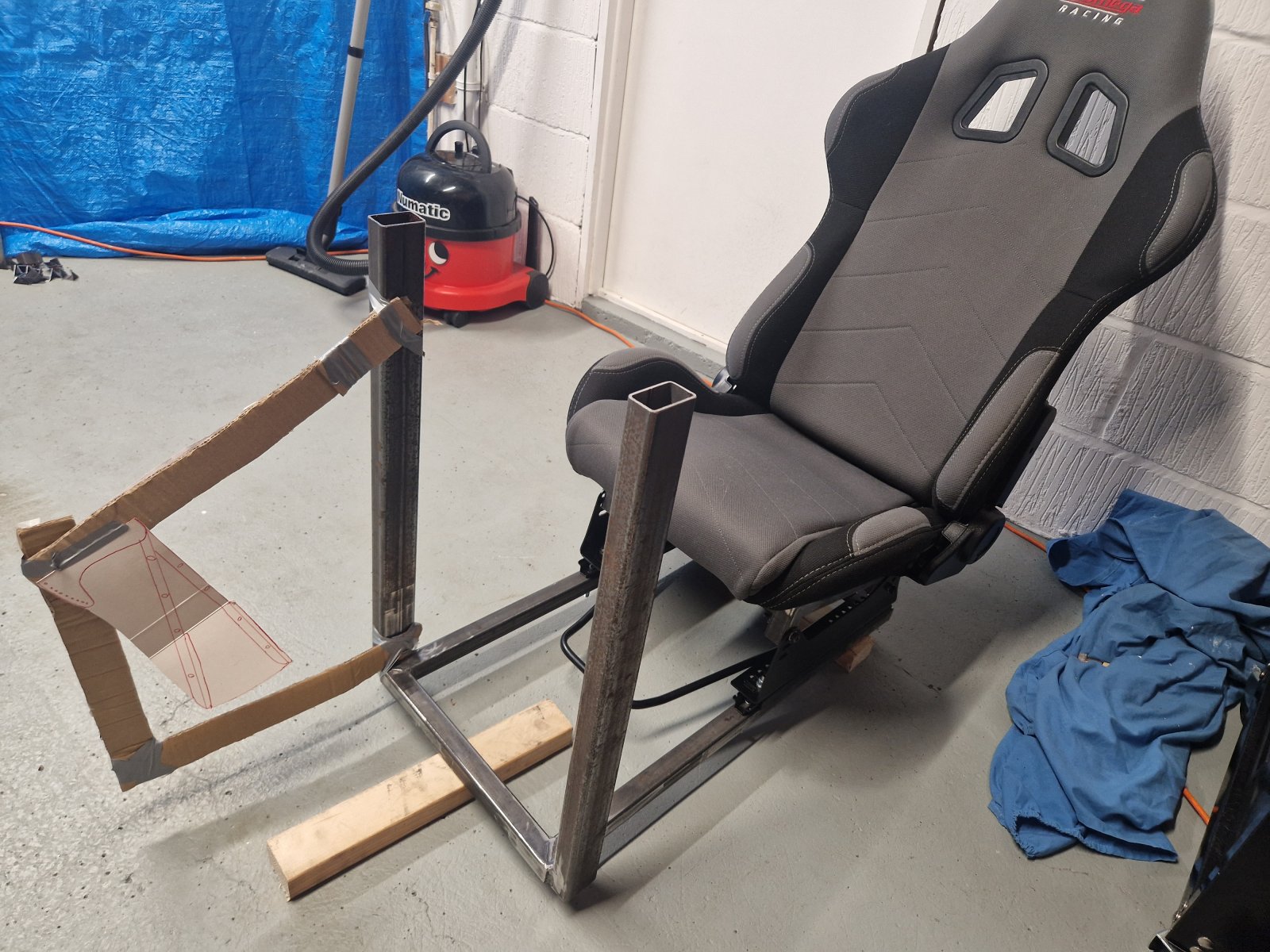

    Hoping to find some dimensions online for the pedals I'll be ordering, so I can possibly make a template and work out the pedal frame.

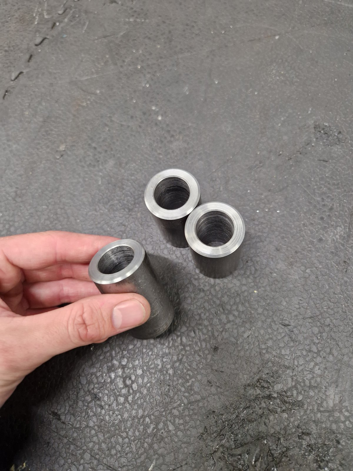

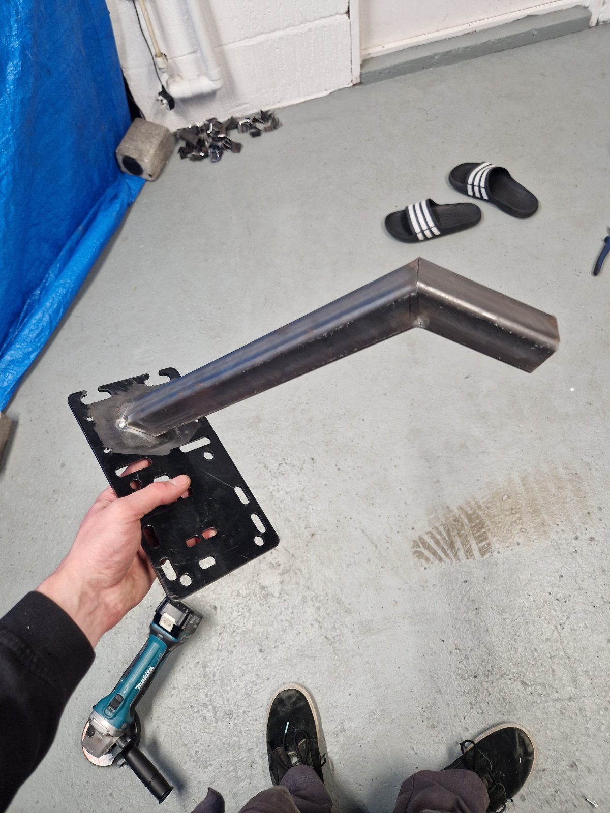

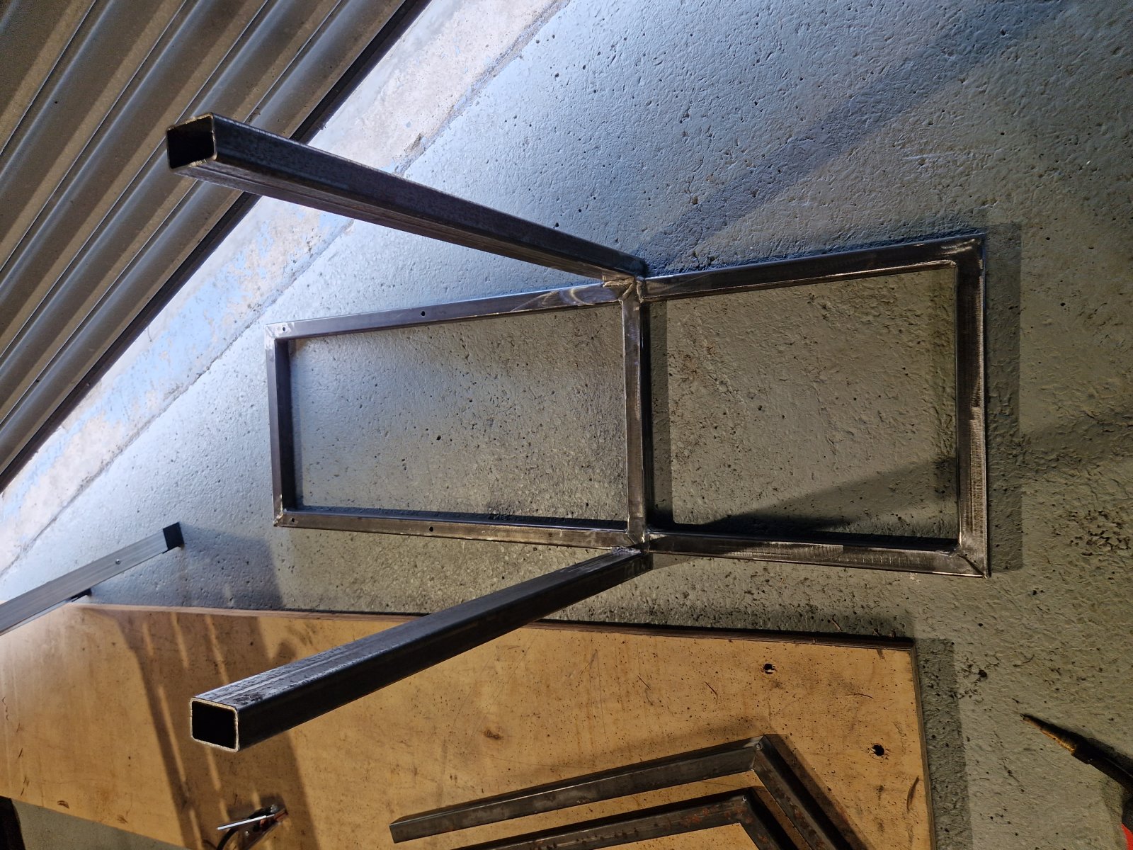

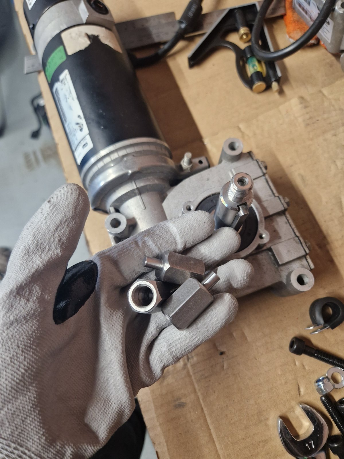

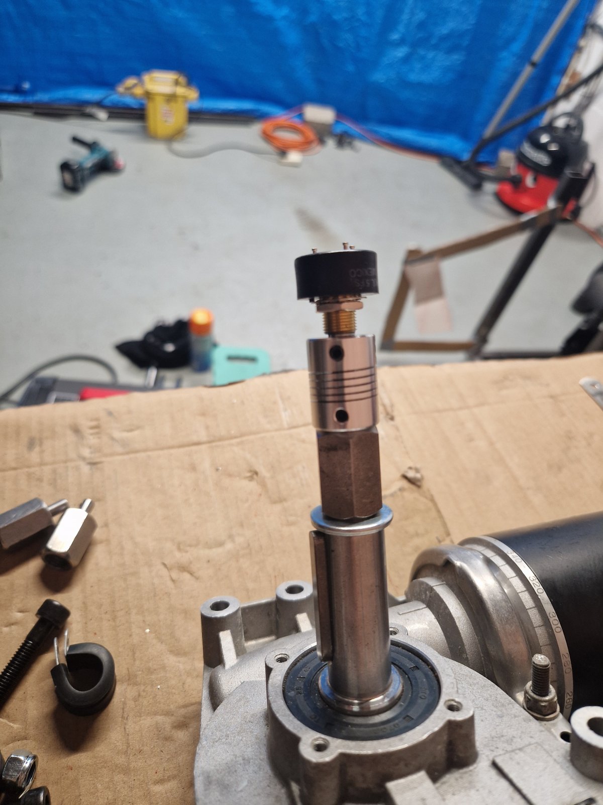

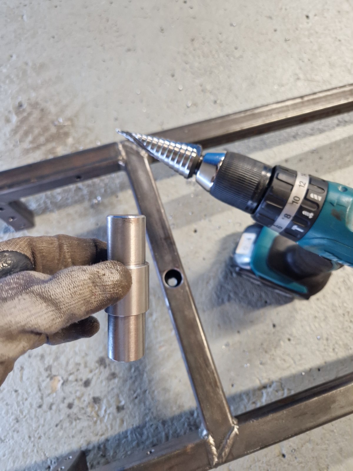

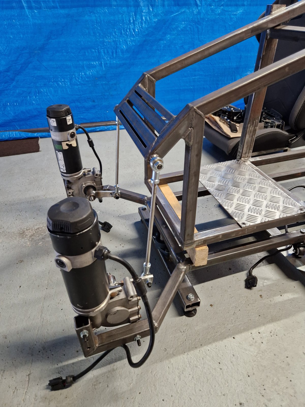

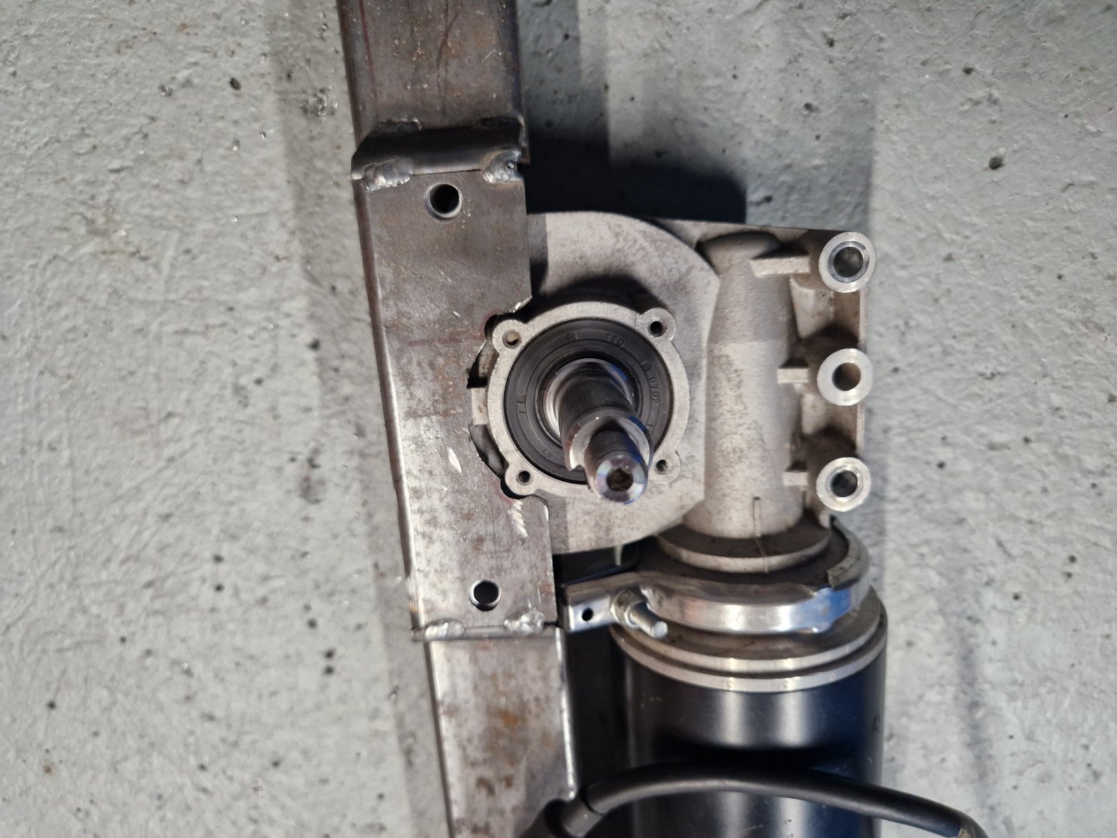

    Turned some adaptor pieces to attach motor shafts to hall sensors

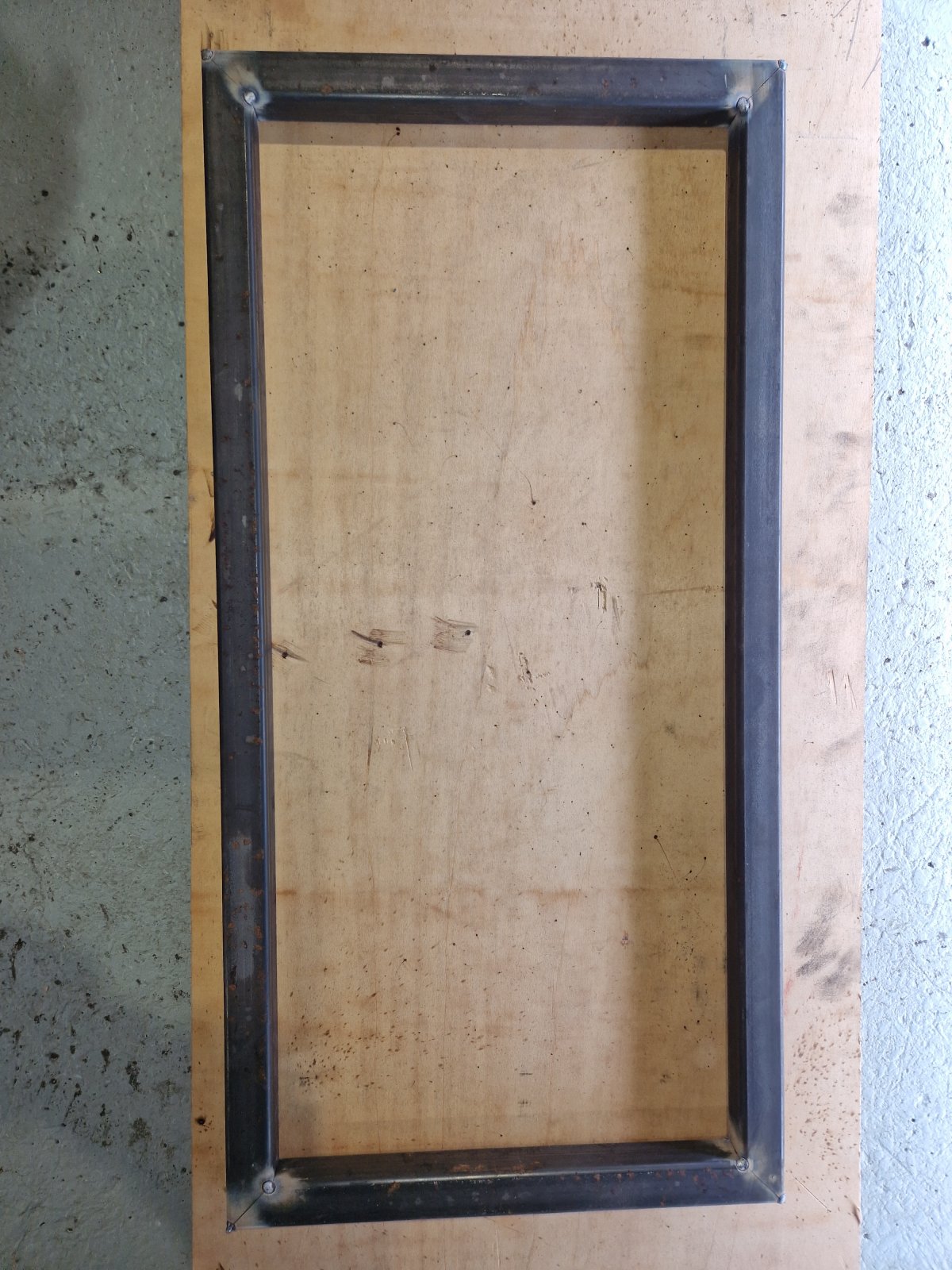

    Also more progress on the cockpit frame, found some dimensions for pedals and made a template out of cardboard
    Then metal

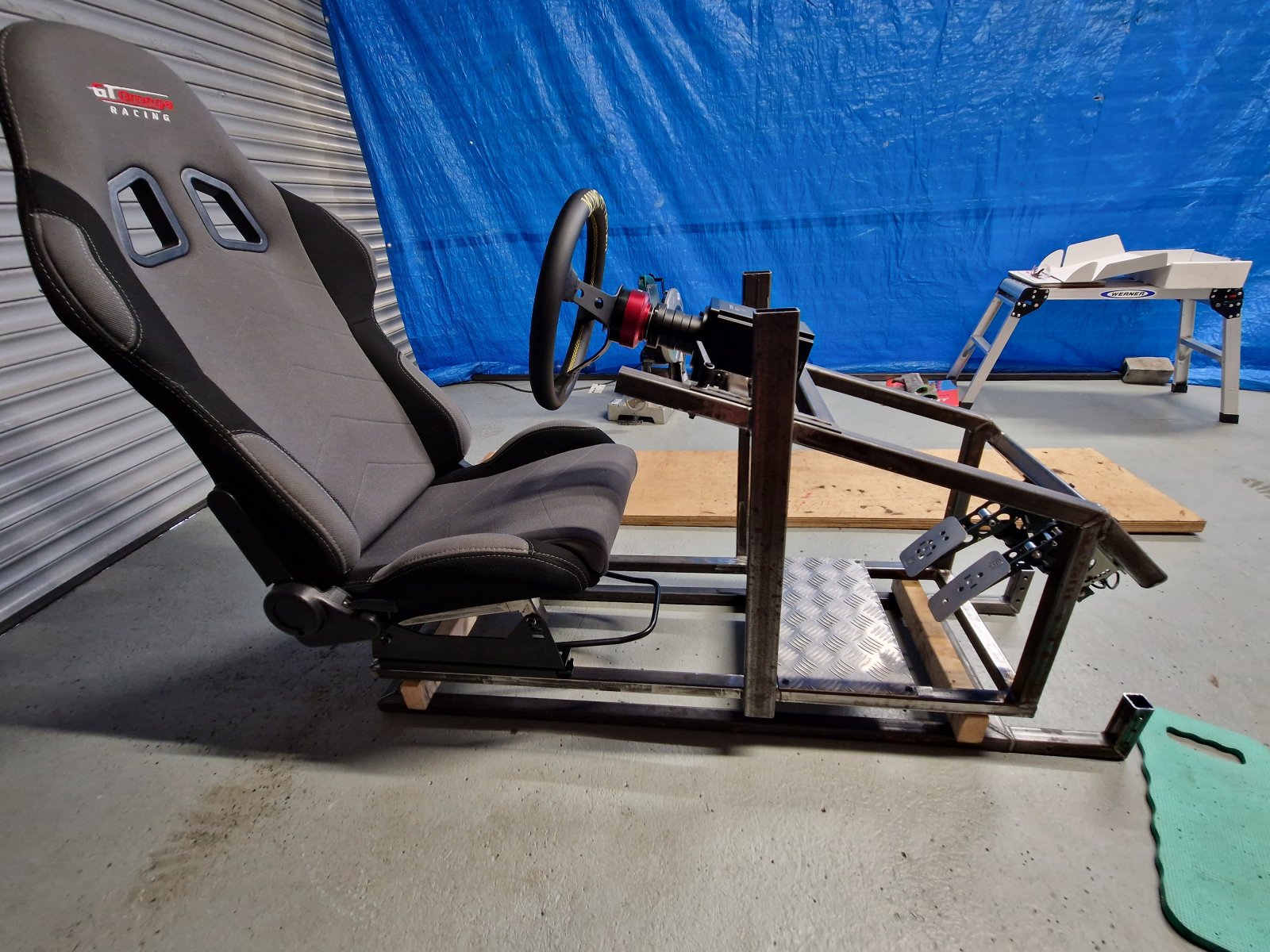

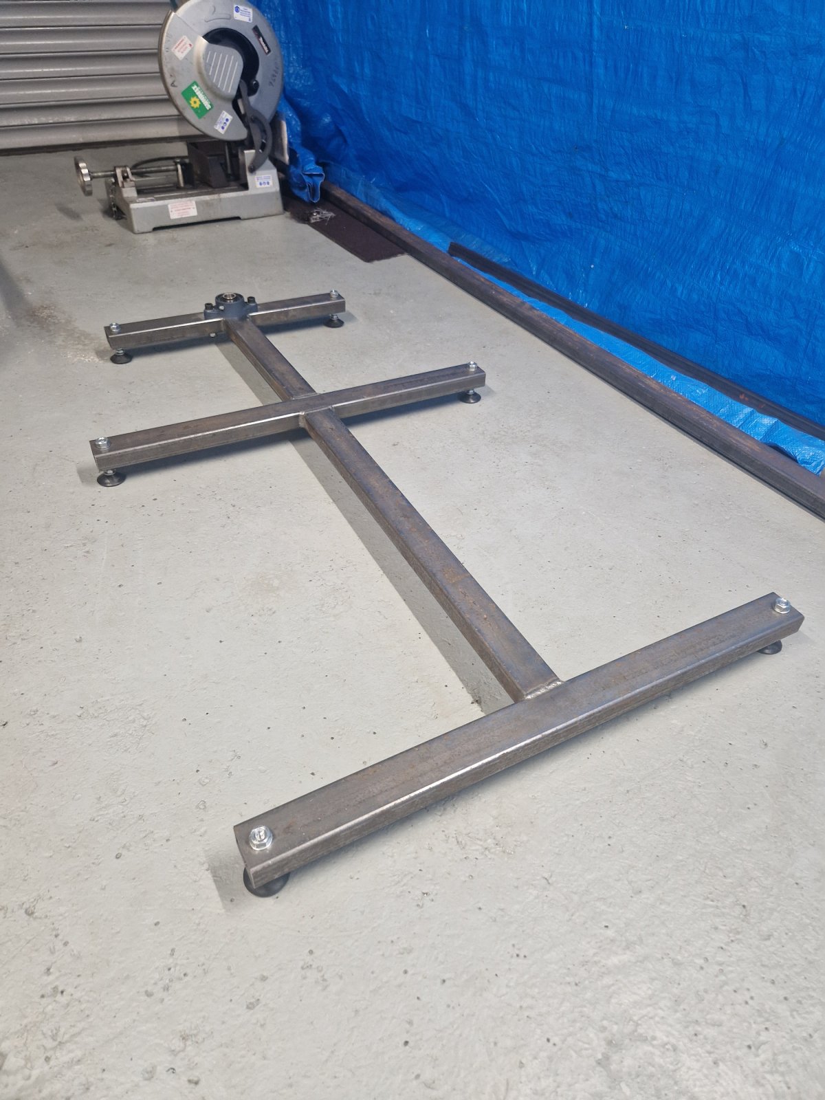

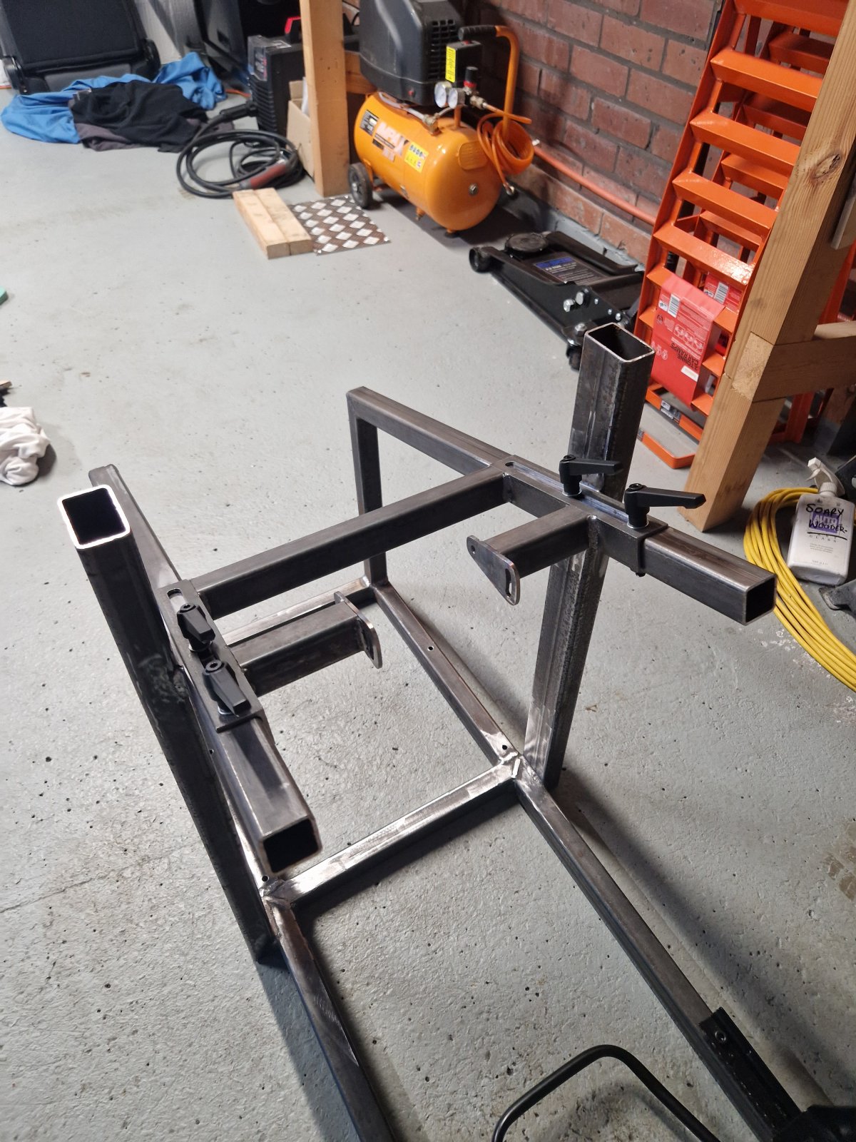

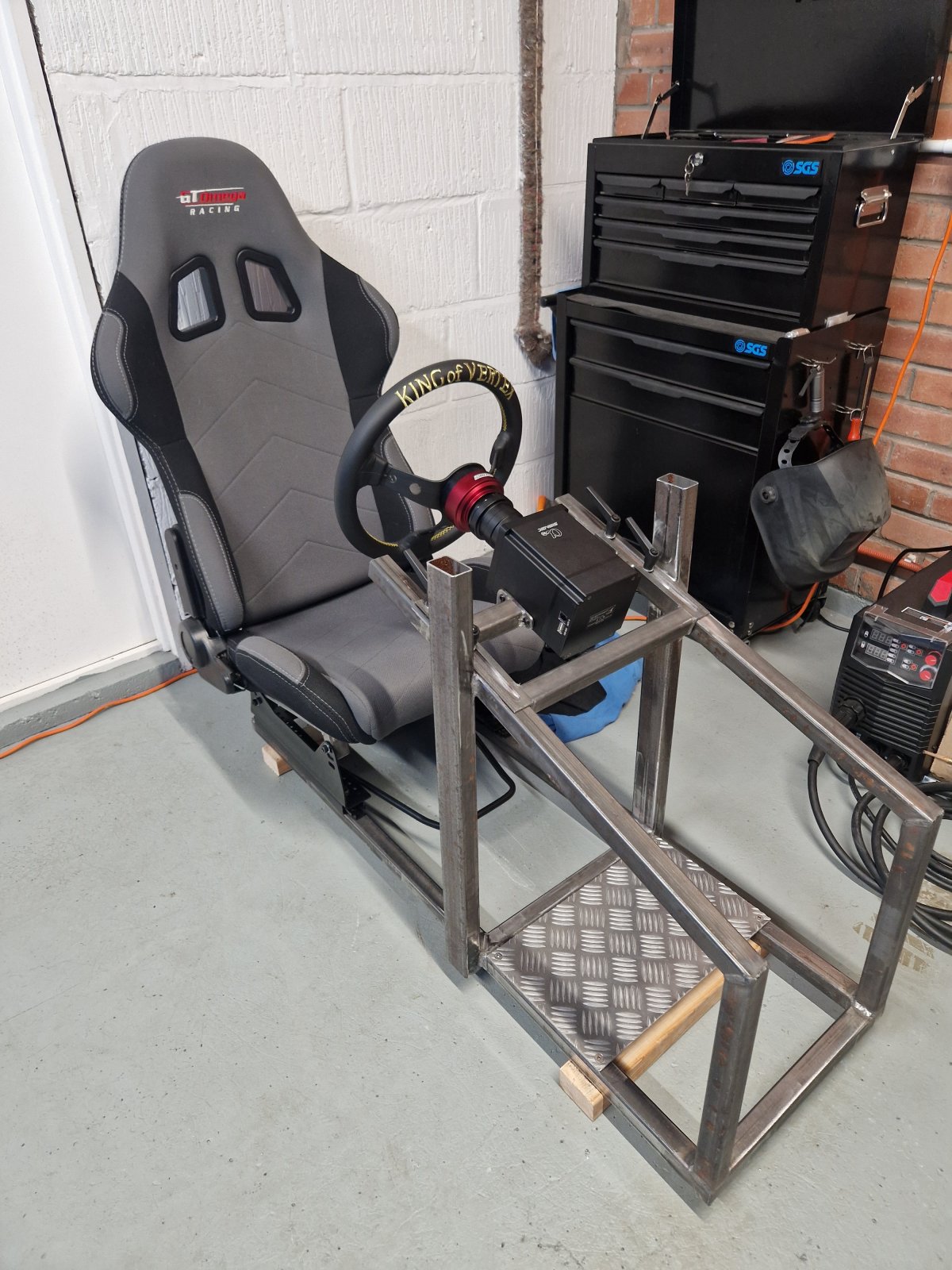

    Made the wheel bracket, cockpit almost done just pedals to mount next

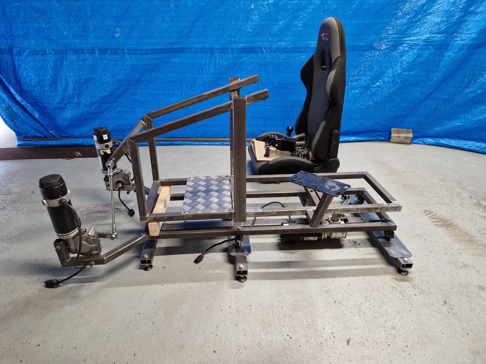

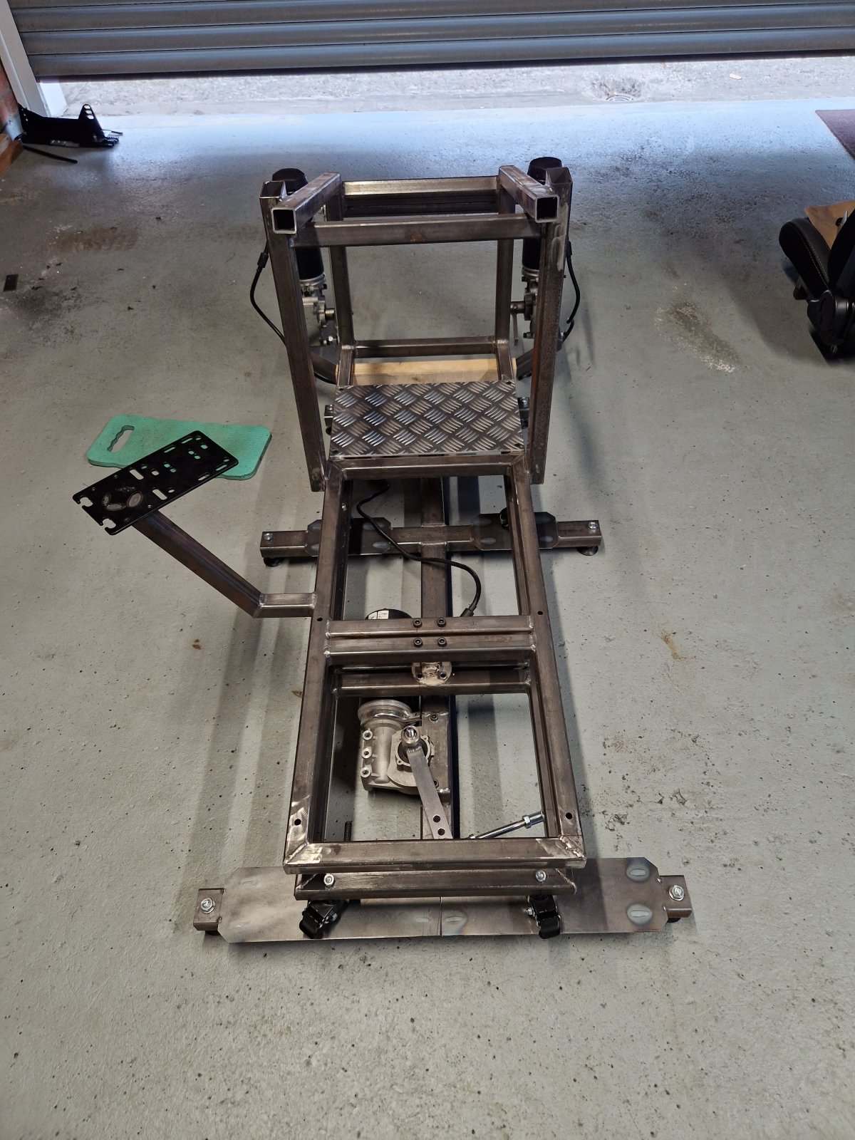

    Got the pedals mounted then couldn't wait to try the cockpit alone while waiting for some parts, back in pieces now.

    Finished the construction, now waiting on PSU's.

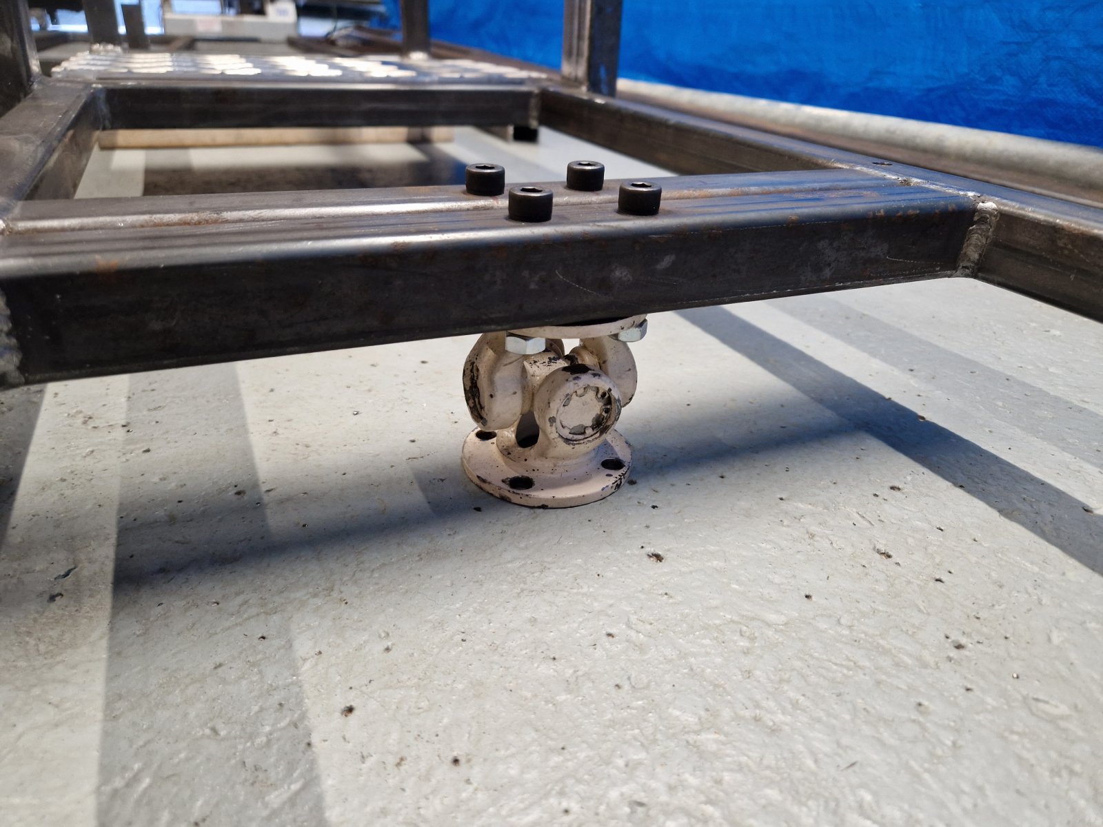

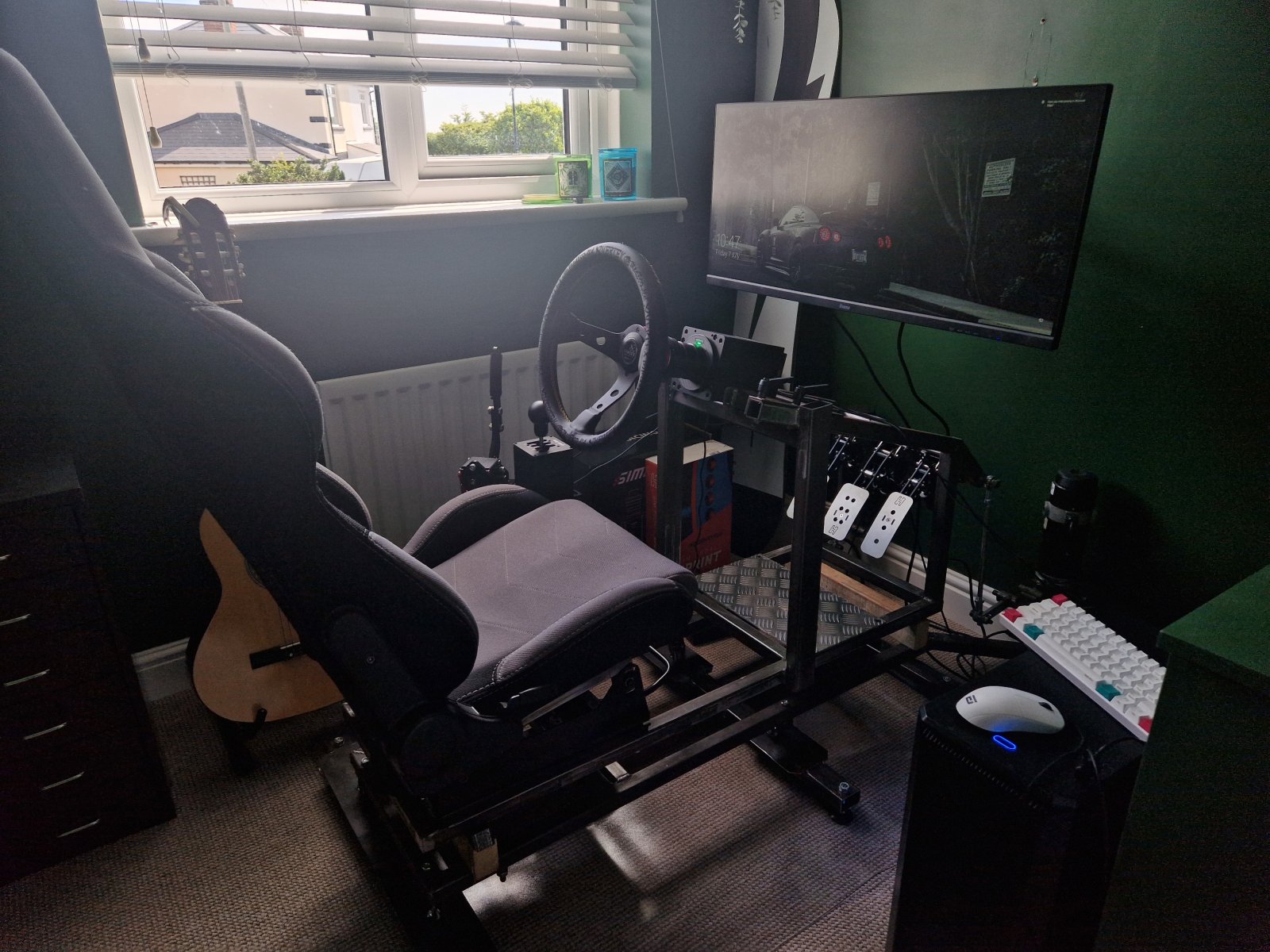

    It's finally alive, very happy with how it feels and motion is even more agressive than I expected.
    Haven't connected up the traction less yet, it's ready but the roller wheels have flats on them so require an upgrade before using.

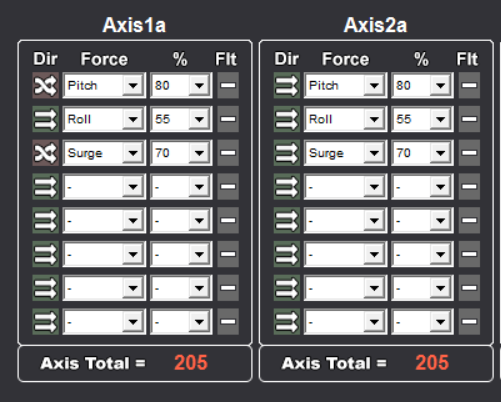

    At slower speeds when accelerating / braking, the motion is too much and feels like it's vibrating, anyone have any tips on how to reduce this? I'm assuming its my SIMTOOLS settings.
    1st test video:
    v=SPLsYQIY1yw&ab_channel=Aaron
    My current SIMTOOLS settings:
