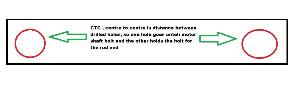

    Centre to Centre, the distance between holes drilled

    Keep that motors man, 86rpm is fine, also lots of torque and power (200watts), do as @bsft said and drill diff. CTC holes and try, then if you really don't like them, get the crab pot motors.

    Stall current is sometimes not mentioned in motor ratings, usually rated and max current. But stall current can be anywhere between 2 - 10 times or more rated current. Even if these motors are 200 amps max, JRKS will not run them, in fact, you would need an arduino and one might big h-bridge.
    As for RPM, its been discussed before and one example I remember is a 240v motor with 33 rpm at the shaft. Sure he got finer vibration , but the lever was 250mm long CTC.
    We have suggested he hunt up PG saw motors and forget the wheel chair motors.
    You could get good vibes from a 86 rpm motor, but to match a 150 rm motor, you would need a much longer lever on it. I recall @Nick Moxley runs a 65mm CTC lever, on 150 rm motor/gearbox.
    I suggested a 50 MM CTC on his set up with motor mount C . Its compact, will give nice vibration and will keep the motor arm setup compact.
    Apart from Nicks videos, here my desk racer with 40mm CTC lever and the JRKS were not set very high in power
    Thats pretty good vibe. A shoulder mount 50mm CTC lever will twitch even more.

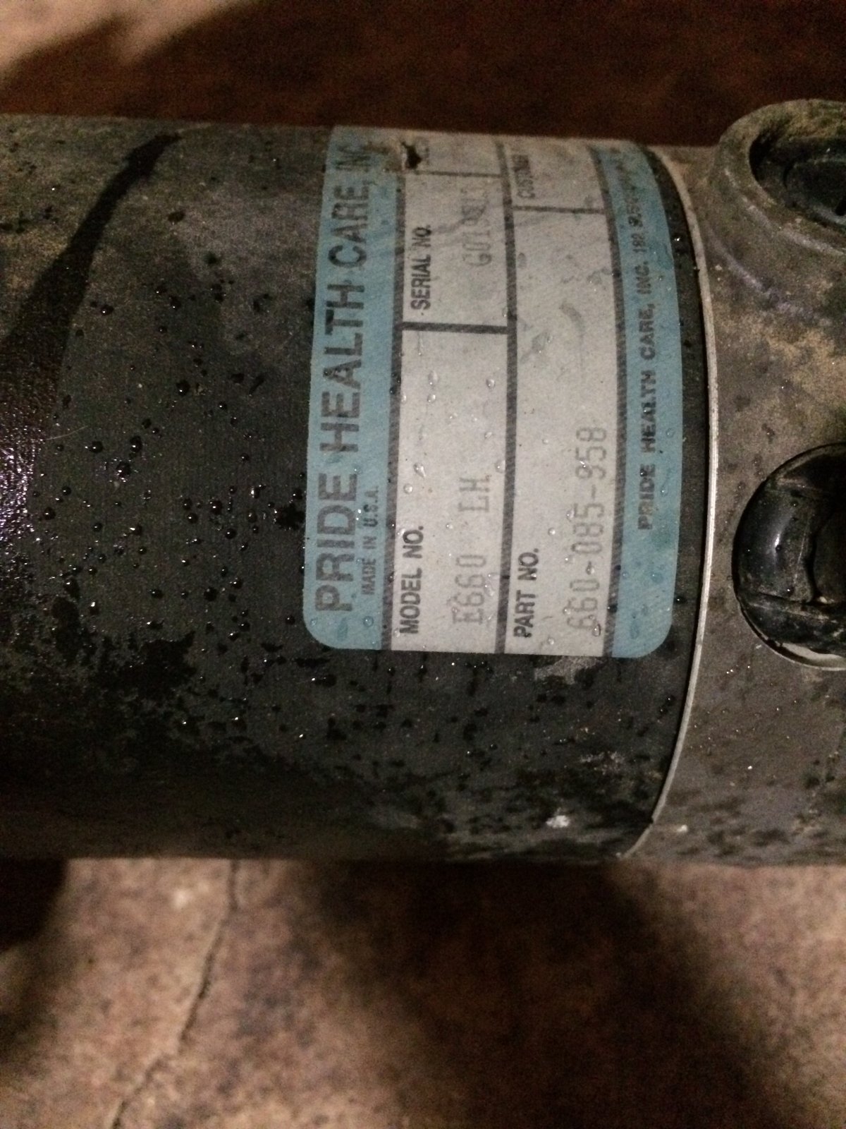

    This may help on the Wheelchair Motor , somehow does not have a Spec Sticker on it, I took a picture of the only sticker on the motor and this is what I found:
    PRIDE HEALTH CARE INC.
    Model NO: E660 LH
    Part Number: 660-085-958
    Serial NO: G019x13
    I was conveying what the previous owner told me about the motor spec when I bougth it at the Garage sale.
    I hope this helps.

    Most sure, but I'm not willing to pay what it would be something like U$S700 for a motor (puting in relation with earnings in diff parts of the world...)
