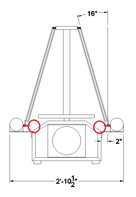

    I vote B despite C being significantly narrower and more compact, Leverage is never a Bad thing.
    22,228
    154,837Coins
    +11,227 / 57 / -2
    I agree with @Nick Moxley that leverage is never a bad thing. But given you are not a big guy, and my personal bias is toward neat and compact, I would go with C as being more than adequate.

    I vote C, aesthetically better, you have powerful enough motors, I don't think that you will need more angle to get great movements.

    Design C , you are light enough to allow a narrower lean on rod arms.
    I know from personal experience this will work and still be compact.

    Yes i have specs!, my wheelchair motors are 12v 5600 RPM 65:1 ration with 200 amps at high peak and on idel 6 amps.
    I notice that they are slow but the torque is amazing, the wheelchair was for a 400 lbs person, i bougt it at a garage sale.
    I still need help on finding the correct motor for my weight and high and want to feel evey little bump on the road.
  14. bsft
    Get the 12v 200 watt 25:1 PG saw motors, use a 50mm CTC lever with about 90 deg travel of swing. That will make you feel the bumps, and have enough linear speed and enough torque. By the way, what control boards are you going to use?

    That would mean it is 86rpm at the gearbox shaft.
  16. bsft
    If you are going to use JRKS, they will not sufficiently drive the wheel chair motors, the rated current is way too high. Maybe use them to line up things, but thats about it.

    Totally agree with @bsft, but as you are a compact person you may even stretch the CTC a little further to 60-65mm, which will make the sim even faster and more responsive.
  19. bsft
    Dont push your luck, if anything set up a lever with predrilled holes at 40mm , 50mm, 60mm, and test each one. I suggest 50mm as I talk from EXPERIENCE, not just reading.
