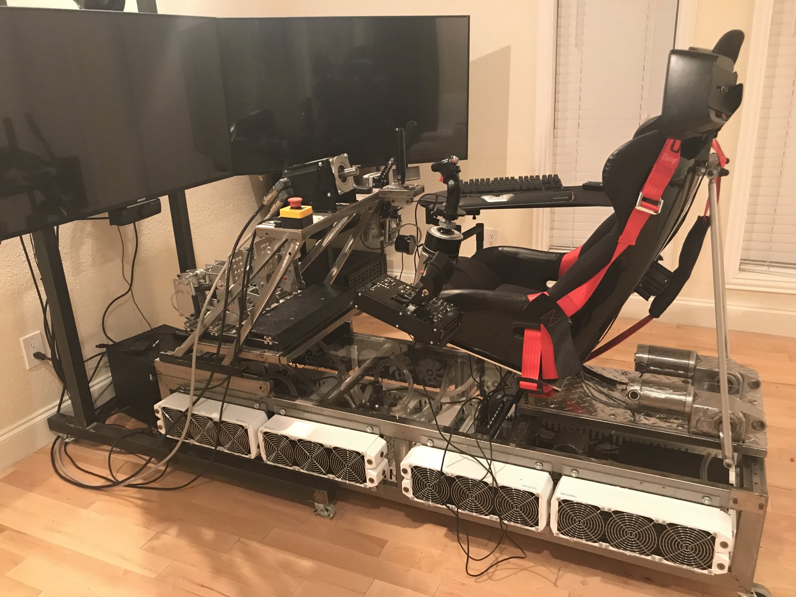

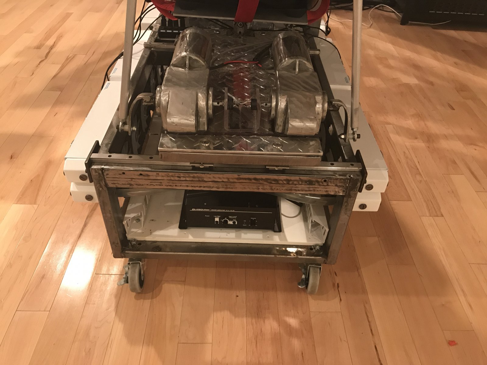

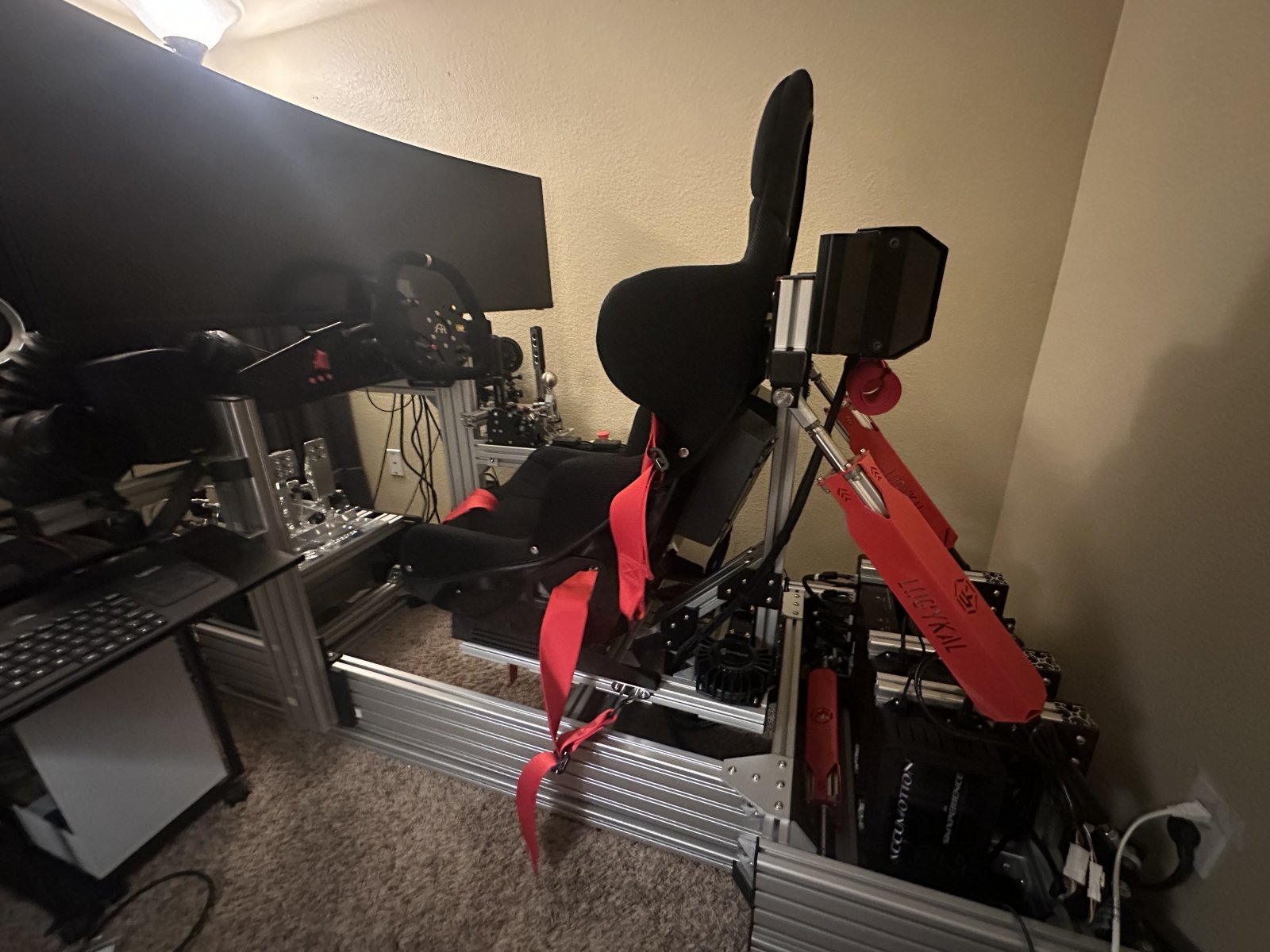

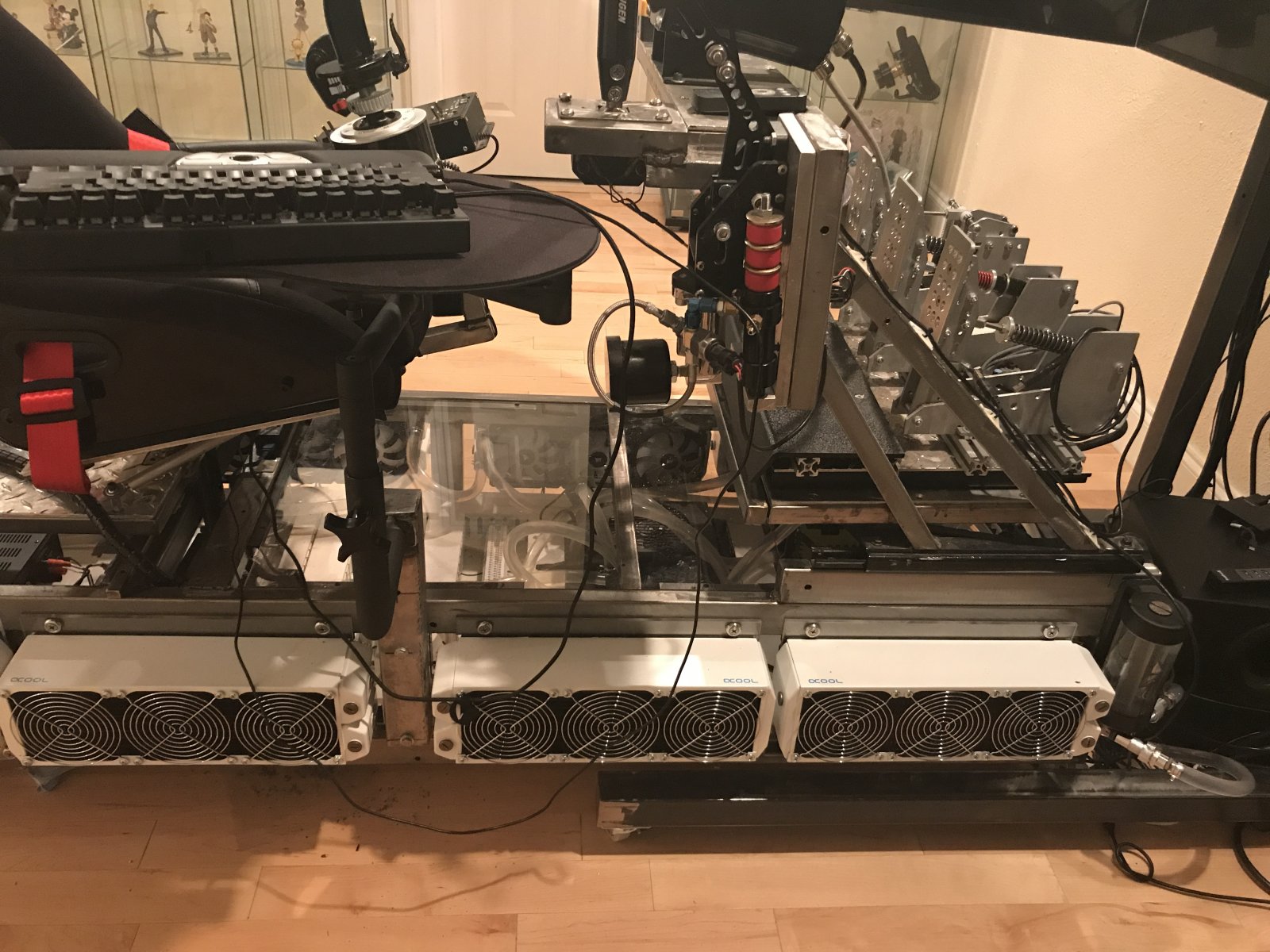

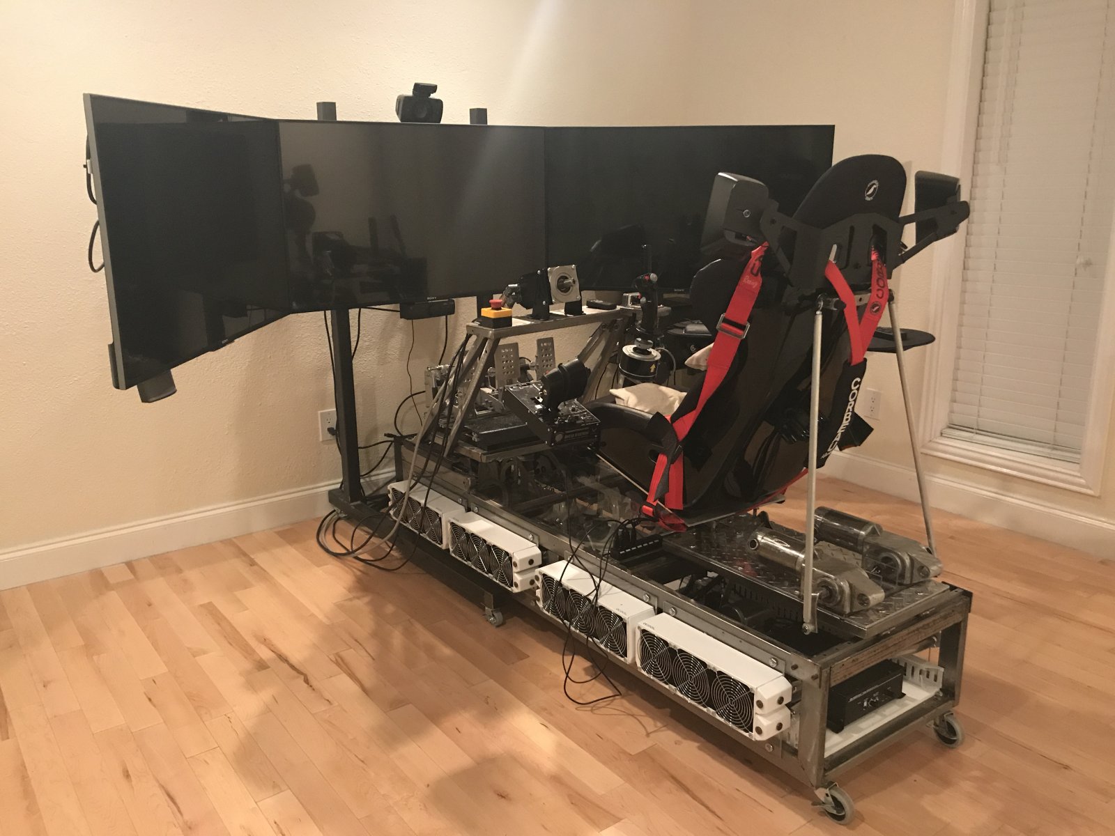

    @zgseat Thanks! and Yes it is very heavy i also added wheels to the TV stand and Simulator Rig i can move it around easy see pictures:

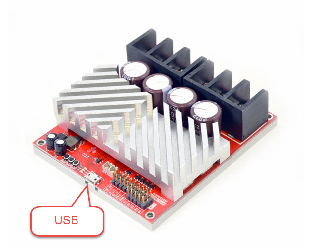

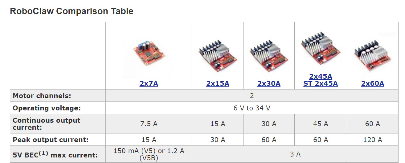

    Hello everyone, any of you is using the RoboClaw Motor Controller? i want to replaced my JRK's...
    Let me know i have questions and i need recommendations.
    Best,
    Milton
  3. Milton
    Nov 11, 2015
    345
    Dallas Texas
    1,989Coins
    +320 / 4 / -0
    3DOF, JRK

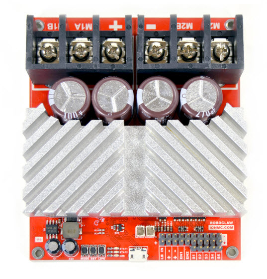

    This Motor Controller it seam promising but i was wondering if it works with SimTools directly?
    Specs:
    It can control two brushed DC motors from 7.5 Amp upto 60 Amp with Maximum peak of 120 amp
    has A built-in PID routine speed control
    voltages from 6 V to 34 V
    Motor speeds can be read directly from the RoboClaw for use with an external control system. Analog feedback is also supported.
    Has a USB interface that acts as a virtual serial (COM) port
    TTL serial for use with an embedded system

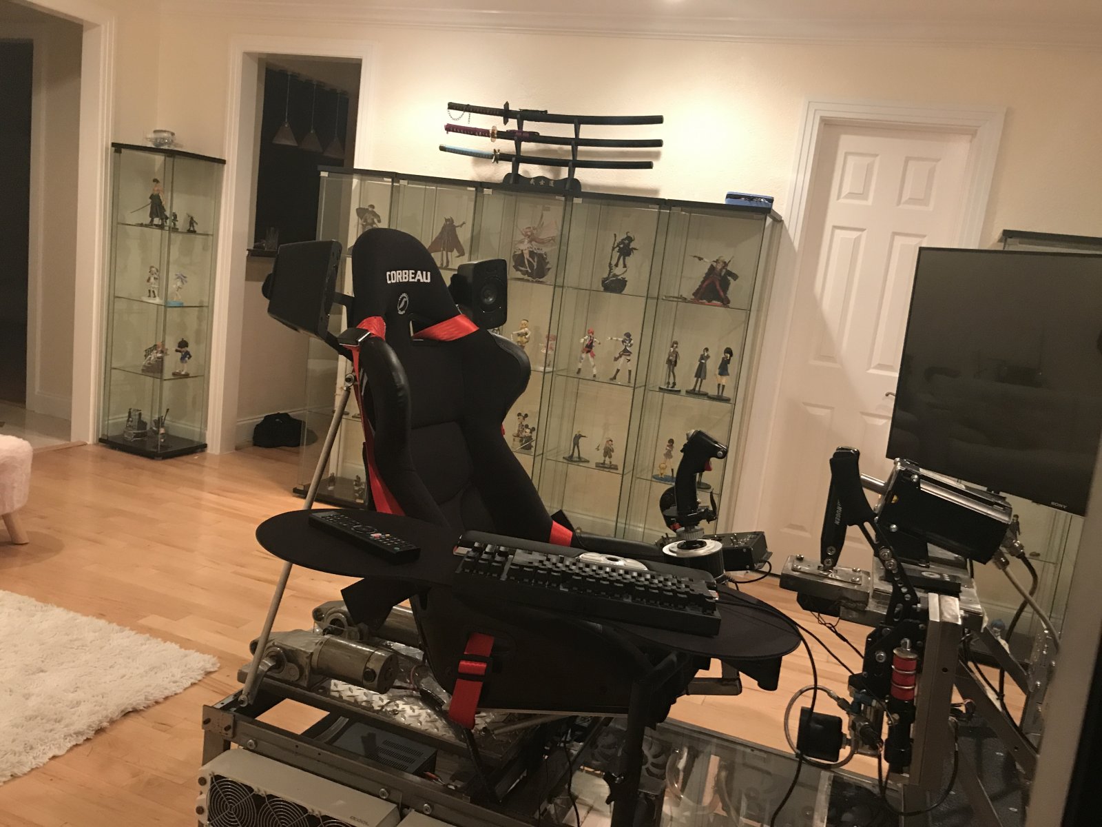

    Impressive installation, respect !
    My wife would kill me if I had that :)

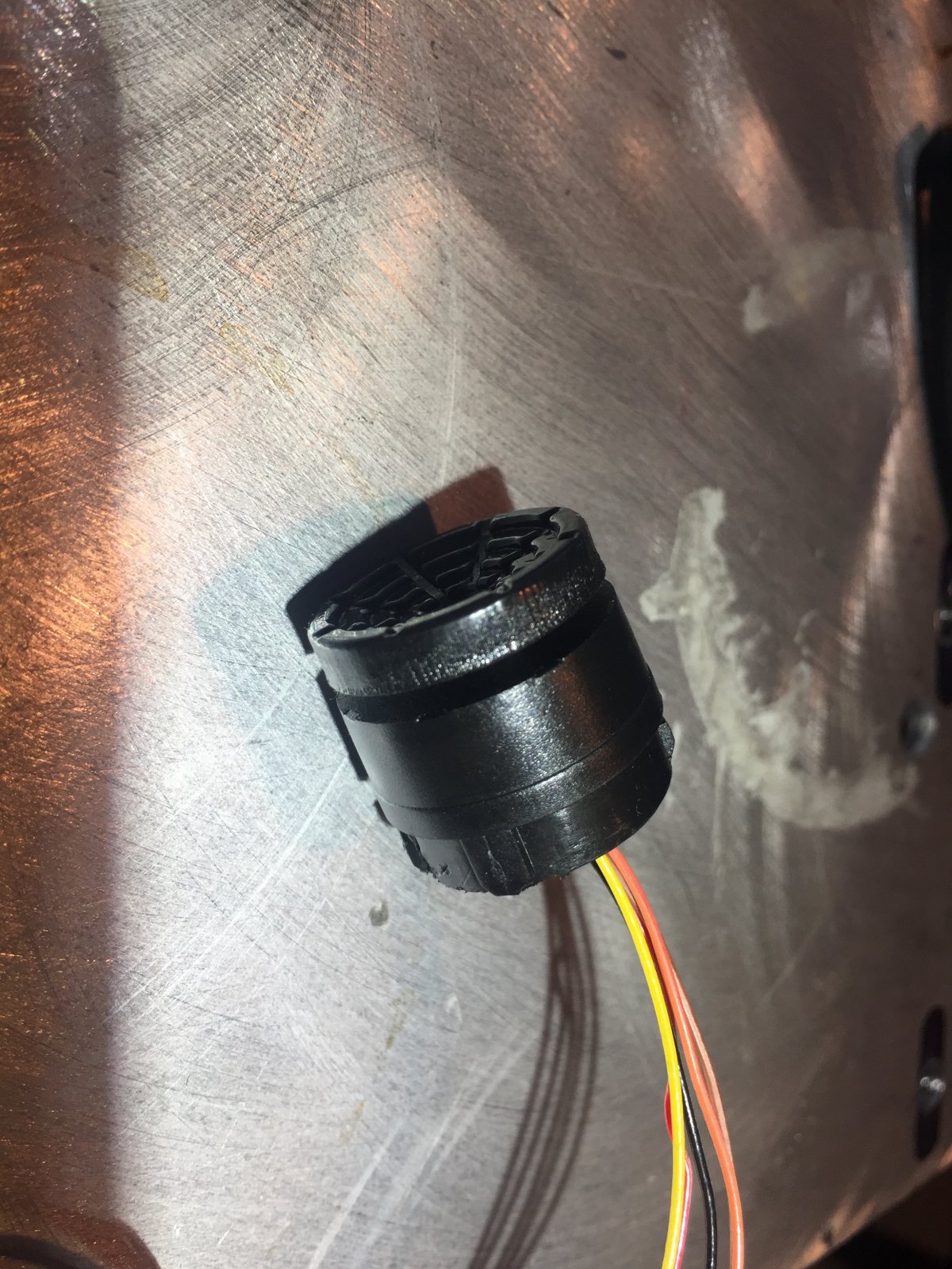

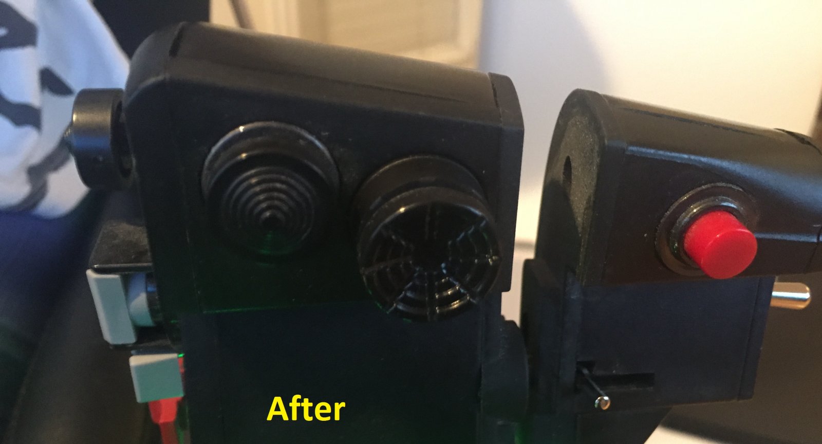

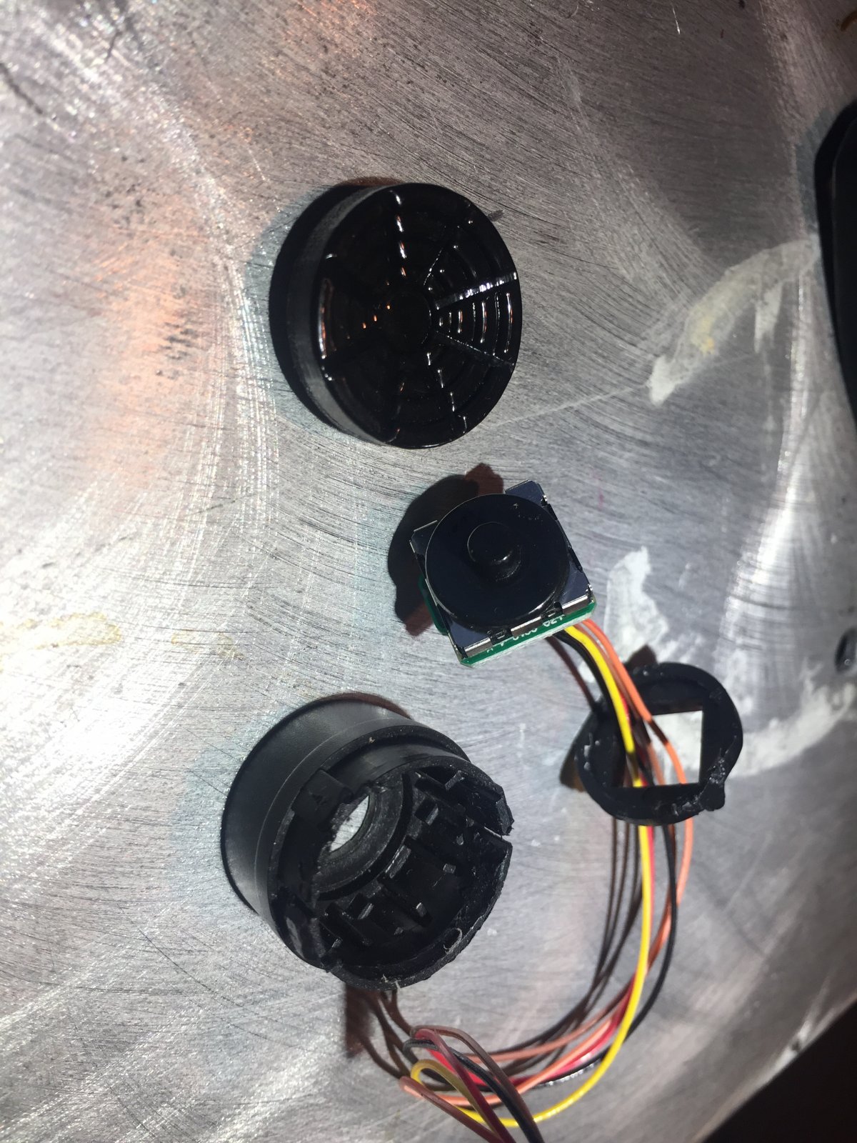

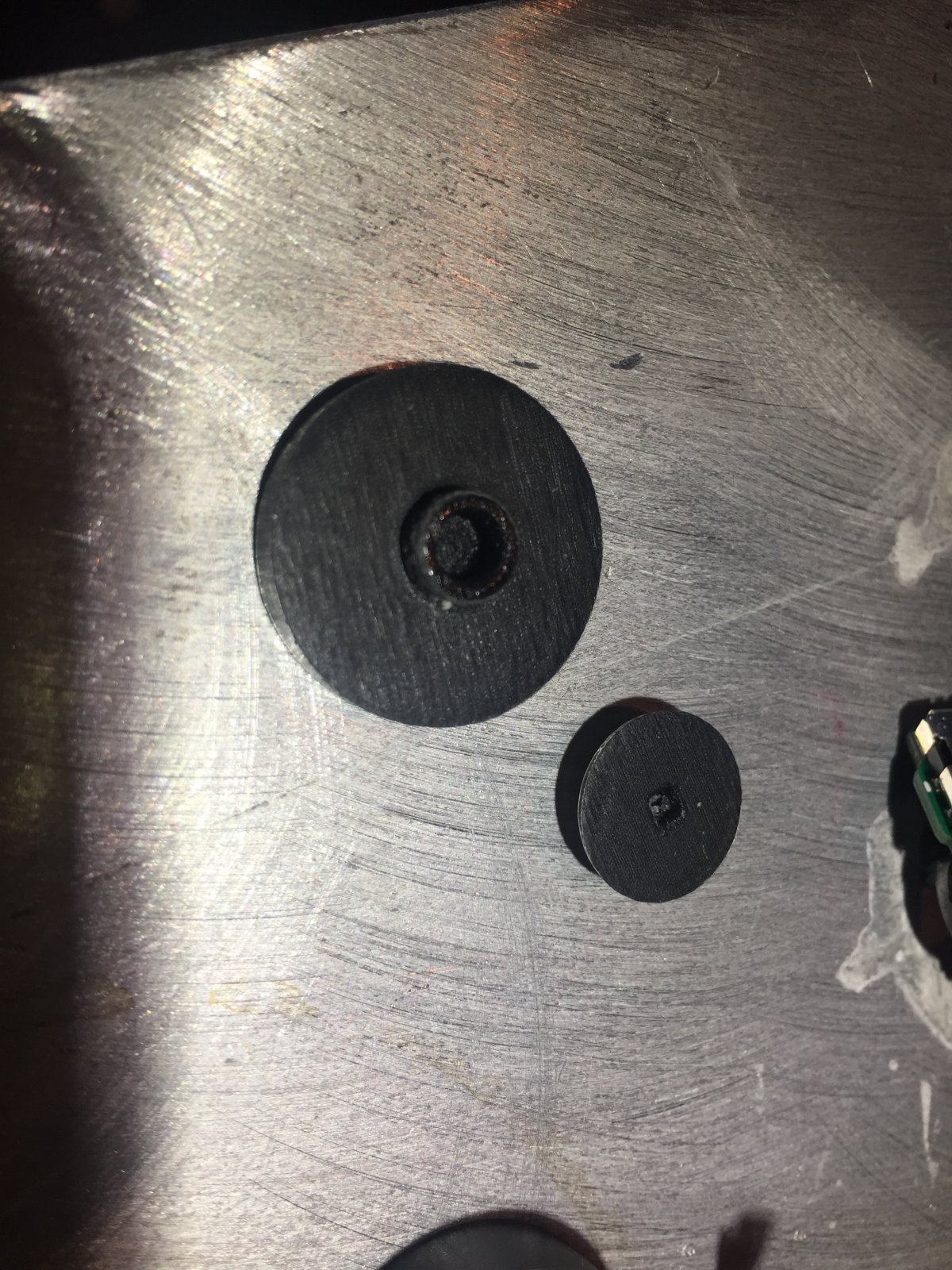

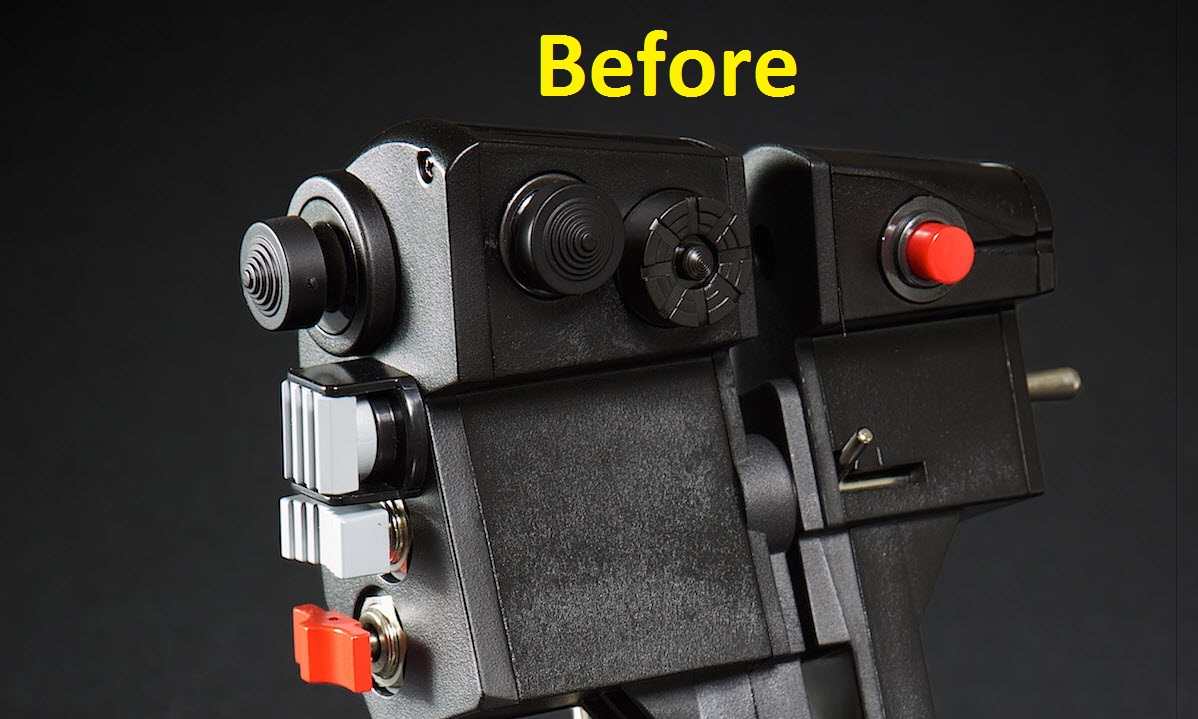

    I made a modification to the Thrustmaster HOTAS Warthog
    Dual throttles mouse cursor
    It is a 3D Printed part.

    +17 / 0 / -0
    The feeling of button is better with this modification ? Because stock, the feeling is hard in DCS A10 for use the camera pod.

    What a creation !!! Here is a competition machine.
    awesome
  9. Jon B.
    Jon B. New Member
    Oct 23, 2018
    6
    136Coins
    Wow, great job welding the frame. Mine takes a little inspiration from the cxc.
