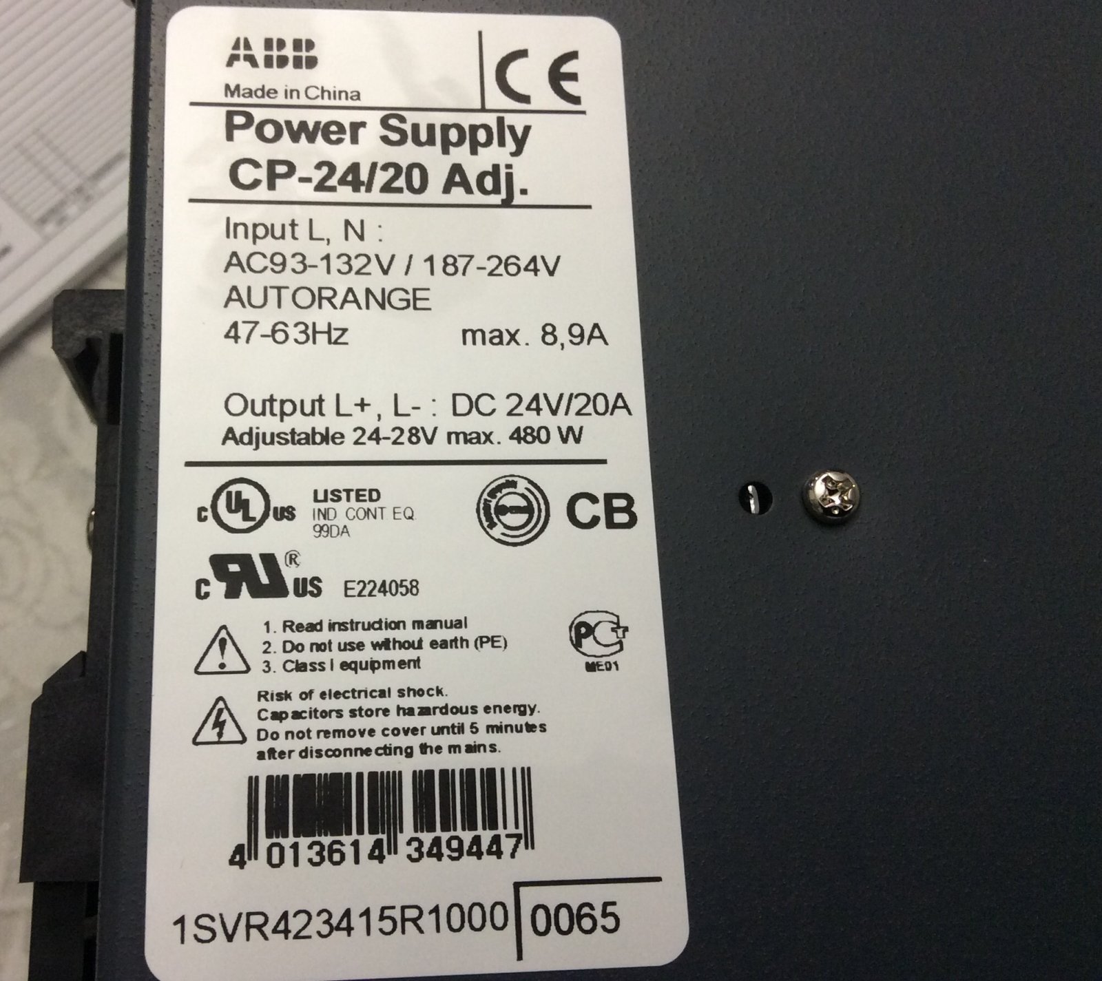

    Nick, thanks! I was wondering if I can still used this PS? I notice that the Granite Devices website Description for the SimuCUBE shows voltage range from 24vdc to 48vdc.

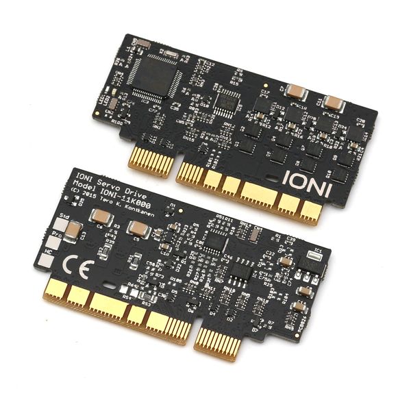

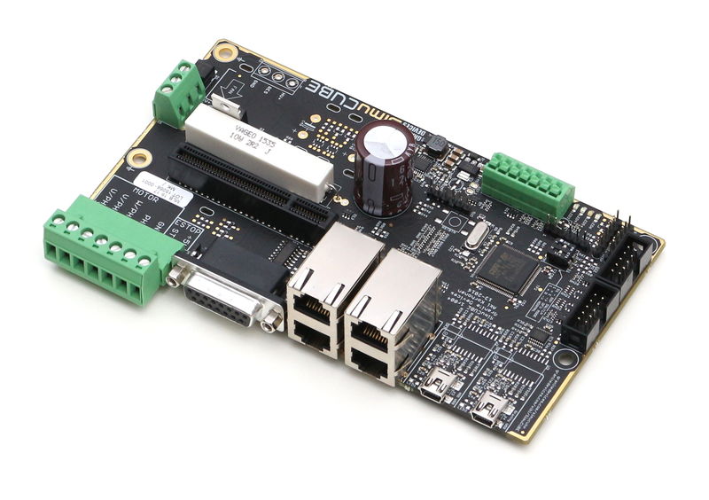

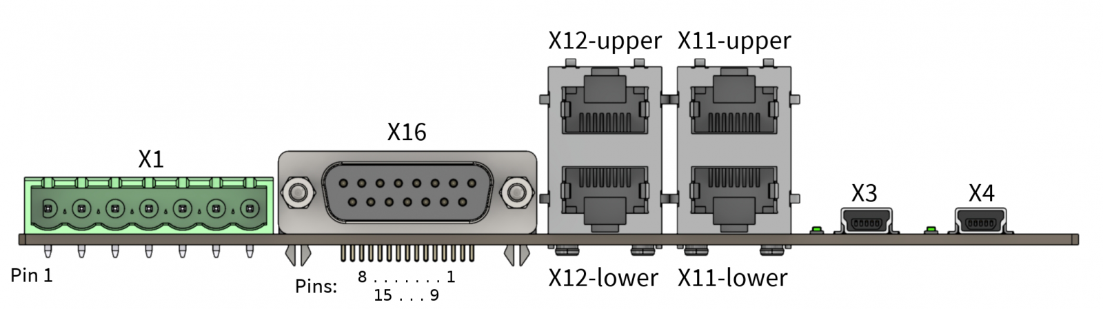

    1) IONI Pro or Pro HC controller
    Wikipages: http://granitedevices.com/wiki/Category:IONI

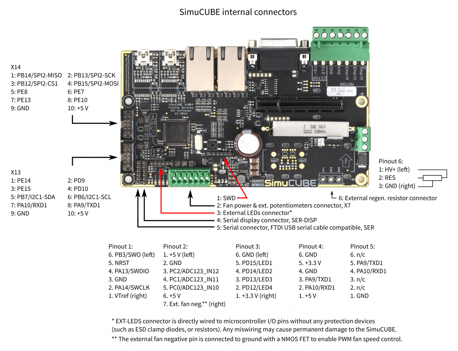

    [​IMG]2) SimuCube motherboard
    Wikipages: http://granitedevices.com/wiki/SimuCUBE

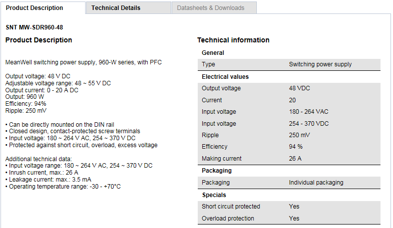

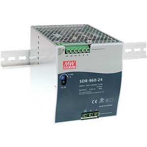

    3)Meanwell Powersupply
    Note I am using the SDR-960-48 for my Lenze and AKM53K servo setups, and the SDR-480-48 for my big MiGe setup. For the smaller MiGe, I can recommend the NDR-480-48 unit.
    Photos below of the 24V units, you need 48V PSU!! It is the best to google for a supplier closest to you.
    SDR-960-48 (for Lenze, AKM53/54 servos)
    https://www.reichelt.com/SNT-MW-SDR960-48/3...CH=mw-sdr960-48
    [​IMG]Please note the specs of this one, this will not work well on 115VAC input power!! At that voltage, it is derated to ~the same wattage as the 480W units!

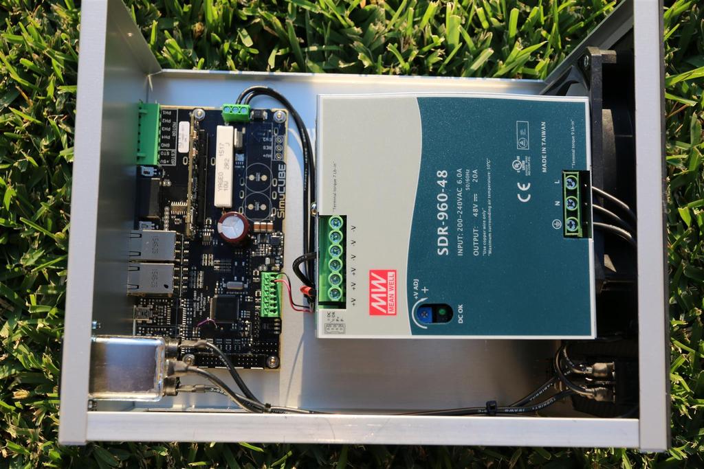

    A few photos of a quick and easy built I have done for my Lenze servo - this is based on the Prototype board Tero kept for me - I am honoured to have this bit of history, it has performed exceptionally well over the past >2 months:
    And a render of a nice acrylic case, similar to what will be supplied as a complete built unit, or upgrade kit - case by Aki!

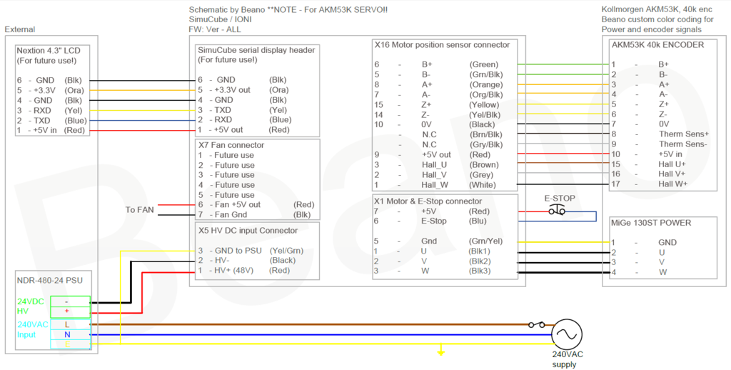

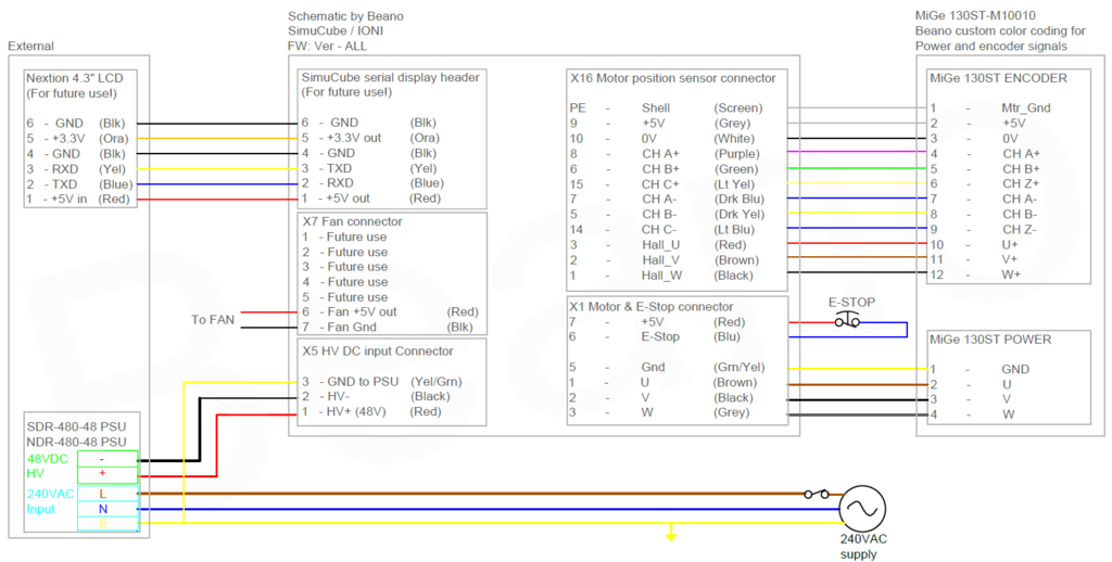

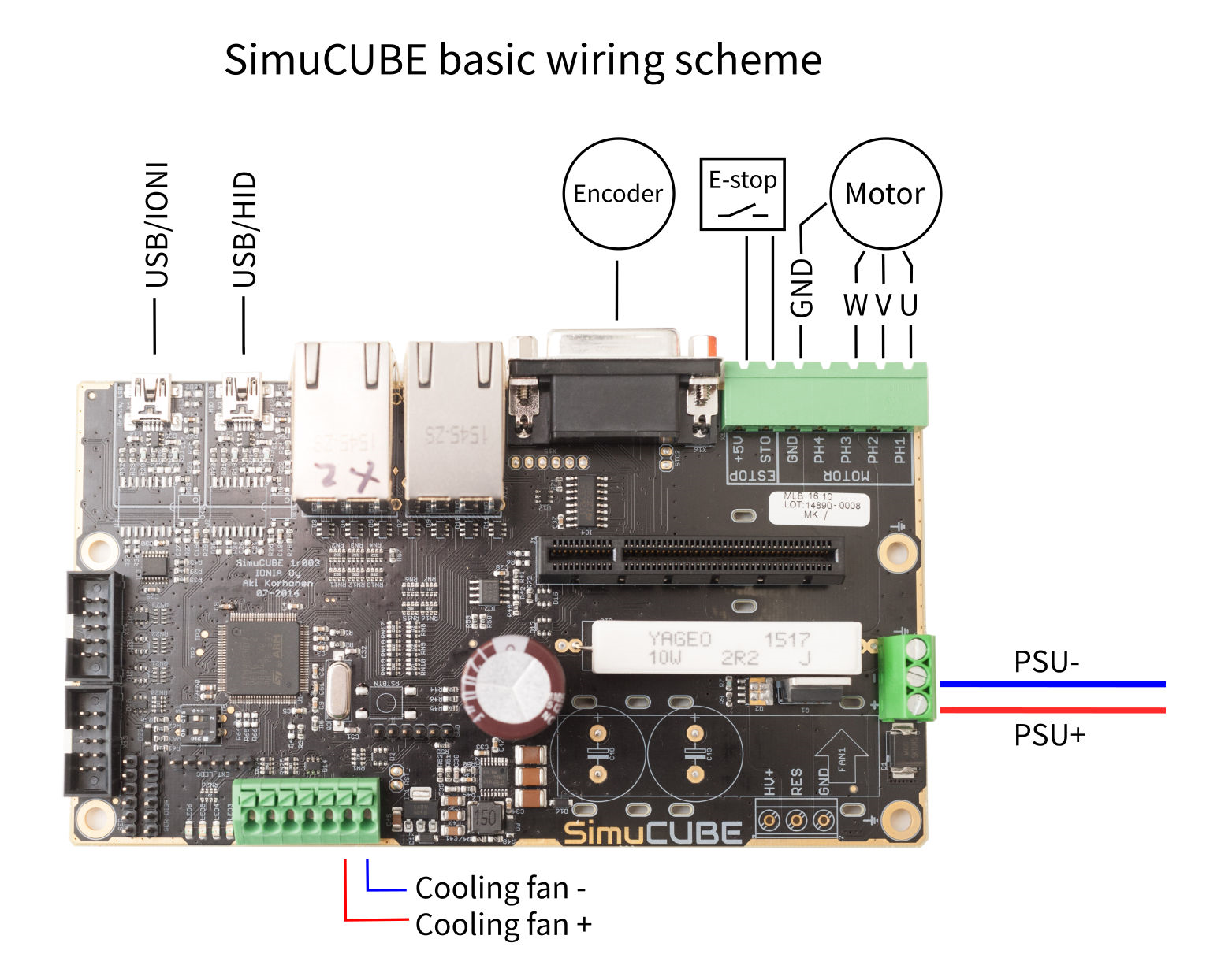

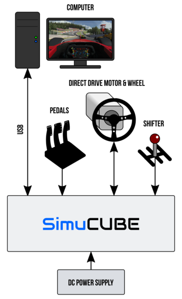

    SCHEMATICS AND WIRING DIAGRAMS
    Please find below the basic block diagram, wiring diagram (both borrowed from Granite Devices Website) as well as a wiring schematic I have made to ease the process for you fellas DIY'ing the SimuCube build
    I will update this section as receive the 1x Cube hardware, please note the schematic below is only applicable to the 4x Cube and Single IONI Drive as per my prototype testing.
    Block Diagram of the SimuCube/IONI Sim Controller
    *image taken from Granite Devices Website!
    Basic Wiring Diagram
    Wiring Schematic - Please use this for both small and big MiGe Servos
    Wiring Schematic - Please use this for the AKM53K series servos
    *Wiring should work for the AKM52/53 G and K servos to, please verify beforehand.

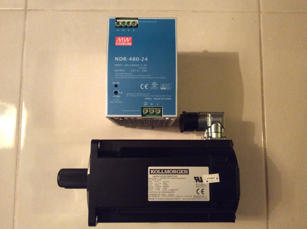

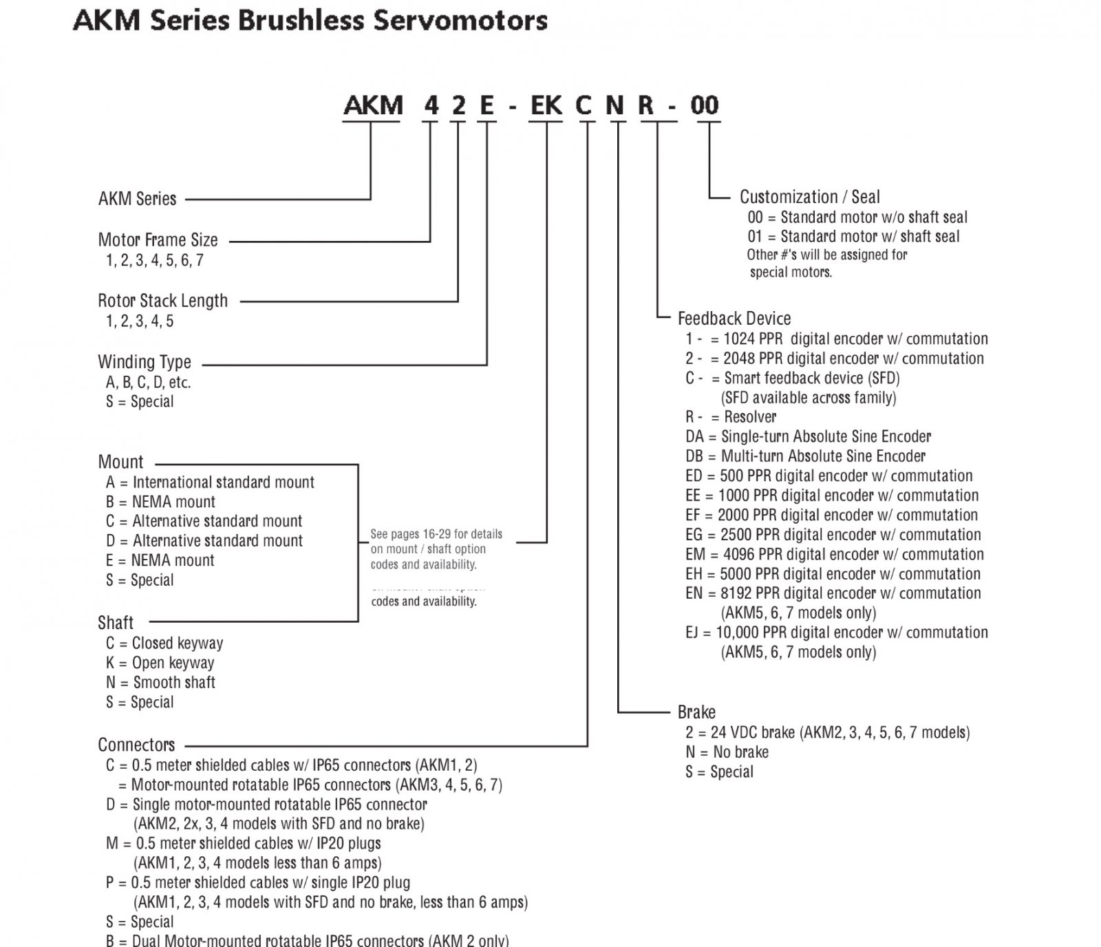

    Some time ago, I got my hands on a brand new AKM53K servo, it was from a sale Davy Watts had on iRacing. I got one of the few with the 40k Comcoder option, as such it will make for a very good platform for an OSW, wouldn't you think?
    Well, the one caveat about using the AKM-K series over the AKM-G series servos, is the fact that the K series is wired for speed, as opposed to the G-series' torque. The K have a speed of 4,500 rpm, and as such, it would be totally animalistic if paired with a 48V psu.

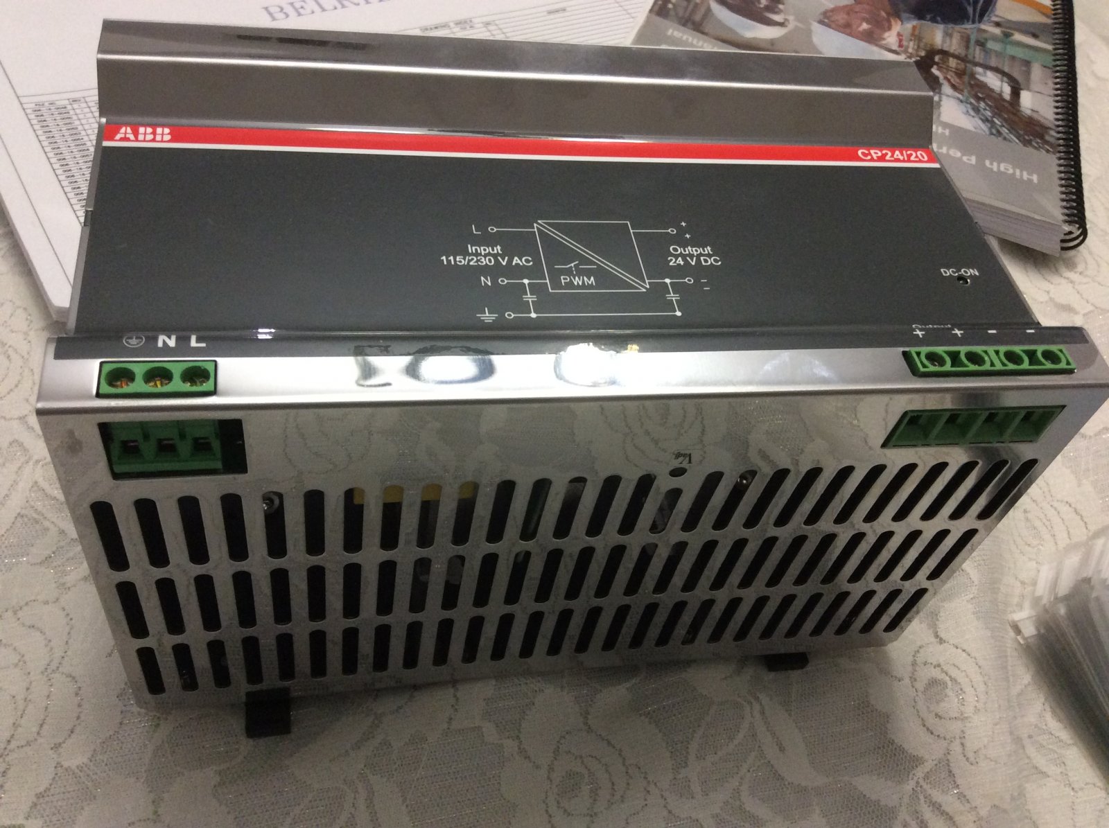

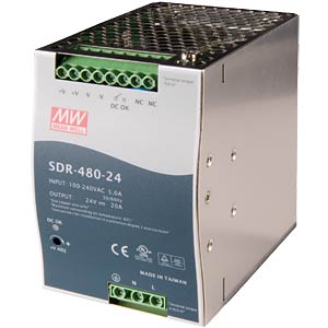

    Well, Ollie Aina over in the UK has requested me to do some 24V testing on the SimuCube, as he has experienced phasing issues at this voltage with some of his earlier IONI builds, and I have decided to pair a very nice NDR-480-24V psu, with the AKM53K. (Thanx Ollie!)
    The absolute beauty of this NDR-480-24V is, that it seems to be using the same enclosure as the SDR-480-48 psu....why is this important......SimuCube was released recently, and I ordered 2 upgrade kits, which, as we know, allowed for several psu options...mine was the SDR psu upgrade.
    One unit has the SDR 48V psu installed, it is up and running and powering my Lenze setup currently - whilst I have decided to pair the 2nd unit with this 24V psu, and use it to drove the AKM53K servo. It works out really well, as now I can drive the K-servo to its peak of ~30NM as well, having heaps of torque, with realising the benefits of a super smooth servo [​IMG]
    Fun times ahead!
    Finalised the wiring for both motor and encoder in short order, and got it up and running with the SimuCube - makes for a nice and compact combination, drop-dead seksi imho [​IMG]
    Just a shot of a quick bench-test, I will do more testing once I return from Indonesia in ~10 days.

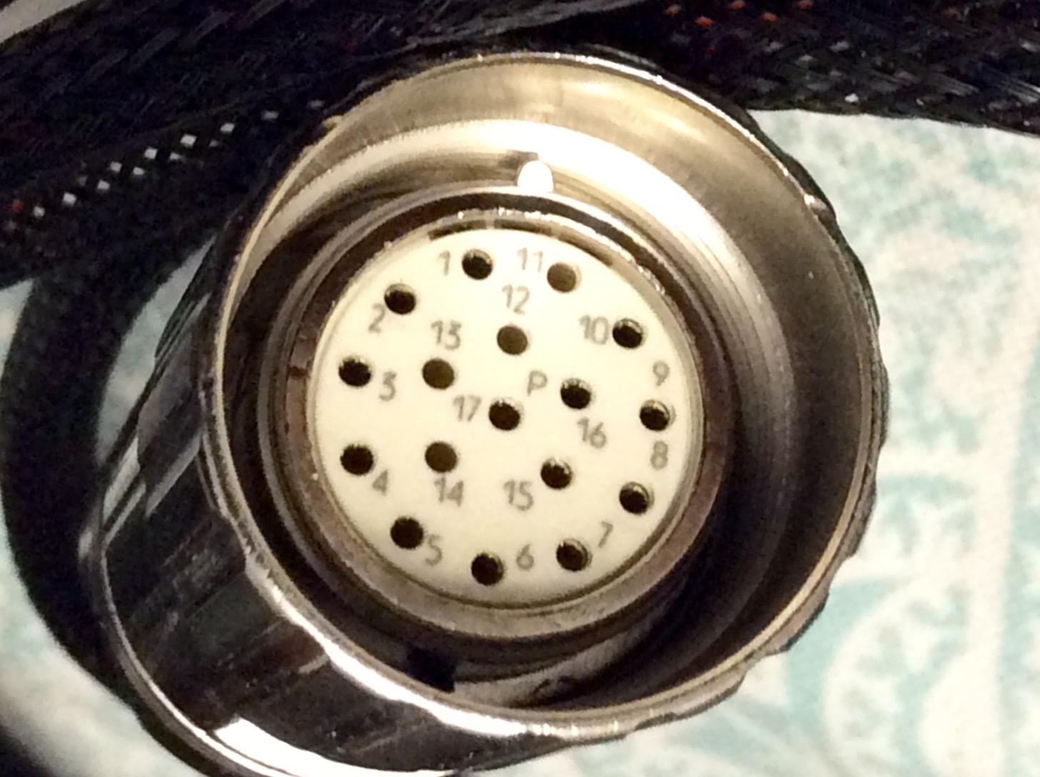

    Any one knows if the SimuCube will control a Resolver Motor?
    in advance Thanks
  12. Nick Moxley
    17,057Coins
    +2,507 / 30 / -2
  13. Milton
    Nov 11, 2015
    345
    Dallas Texas
    1,989Coins
    +320 / 4 / -0
    3DOF, JRK
  14. Nick Moxley
    17,057Coins
    +2,507 / 30 / -2
    There's a good reason I linked you what i did Milton, the answer to your question is No.

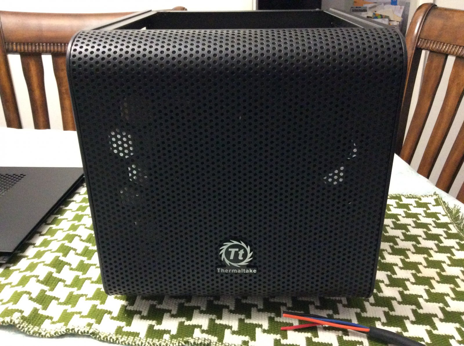

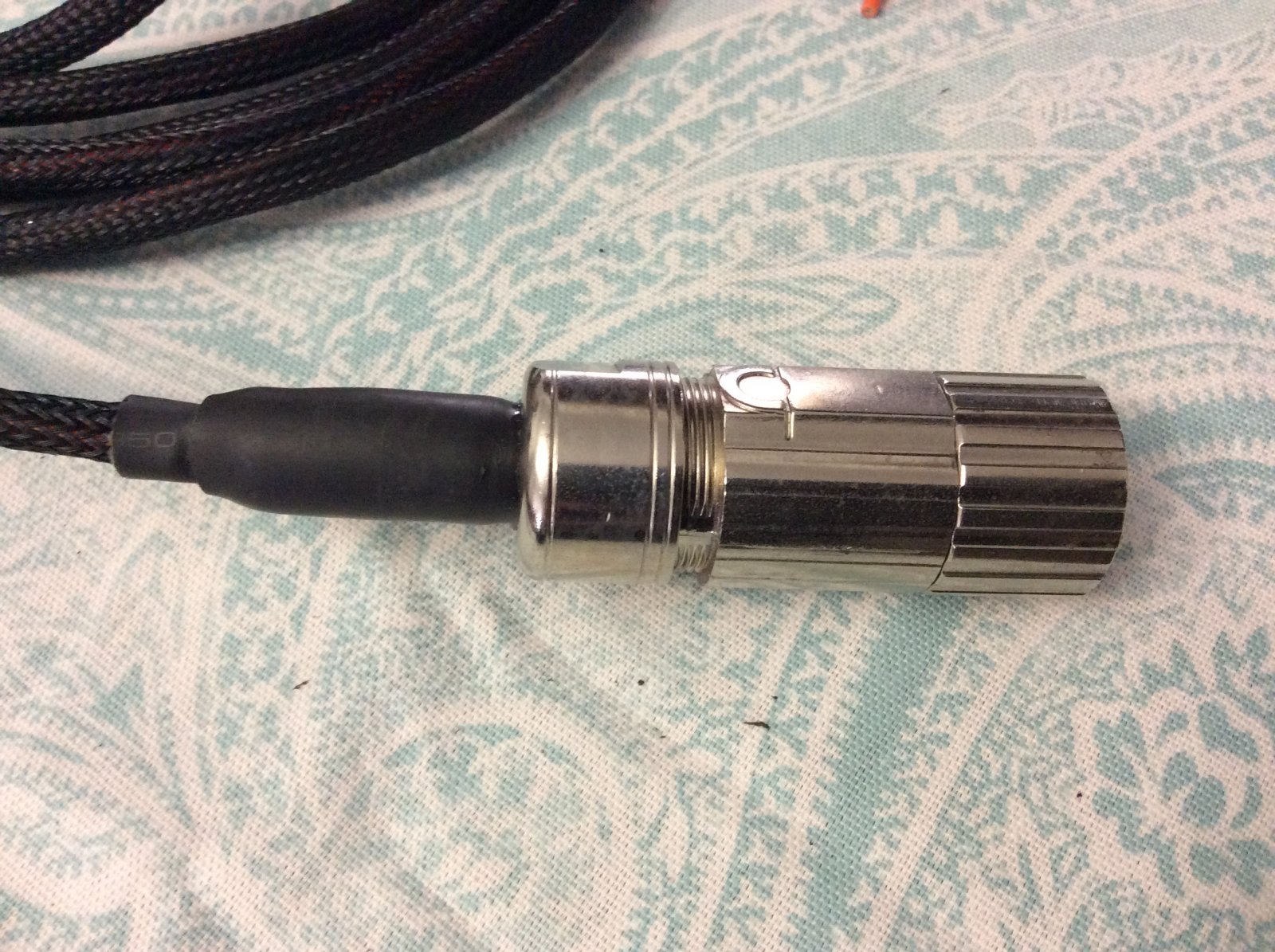

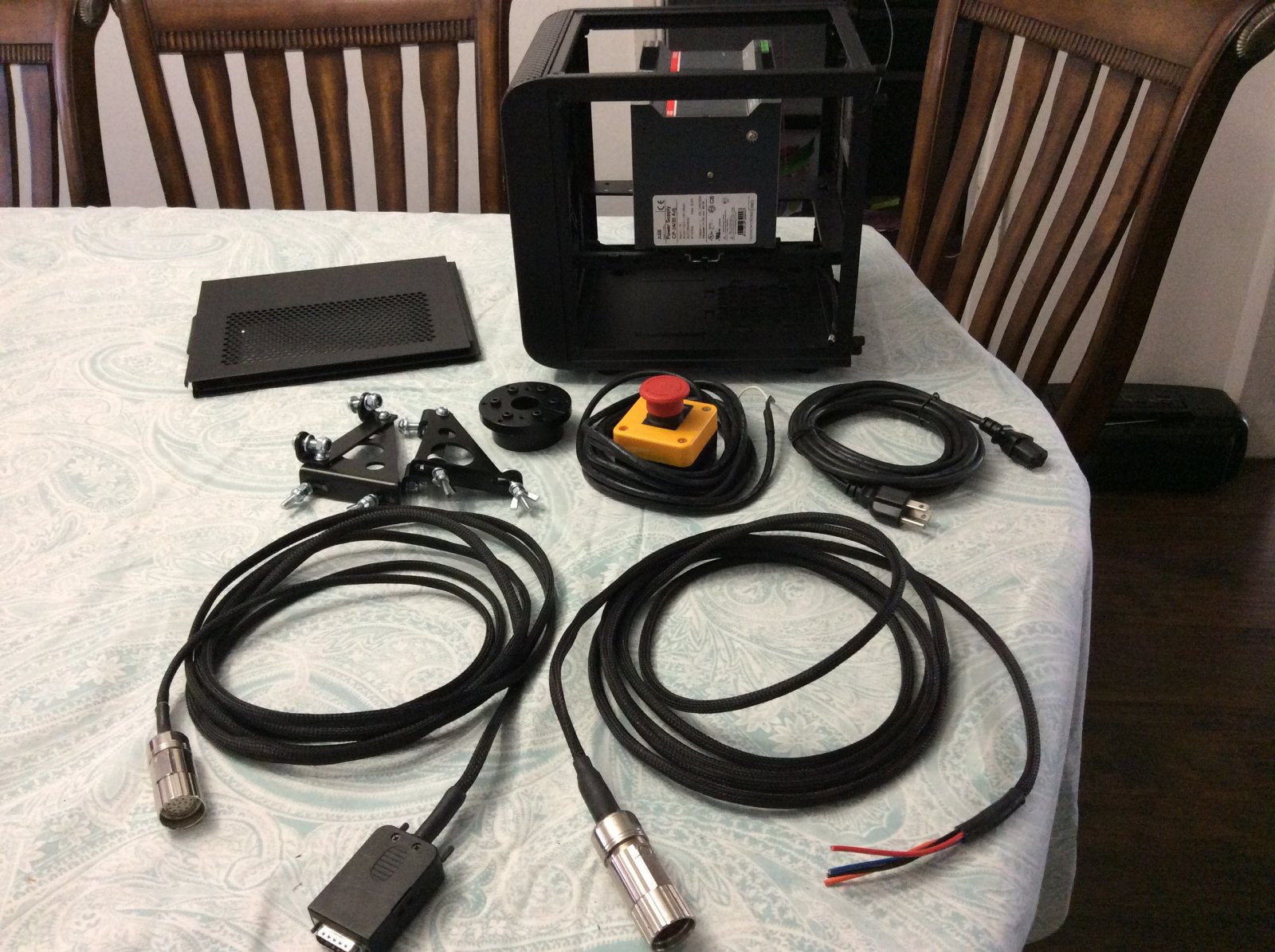

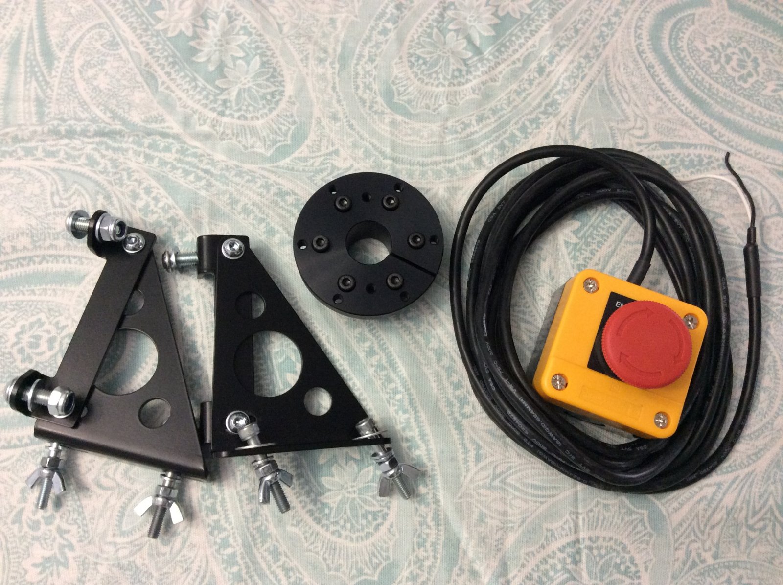

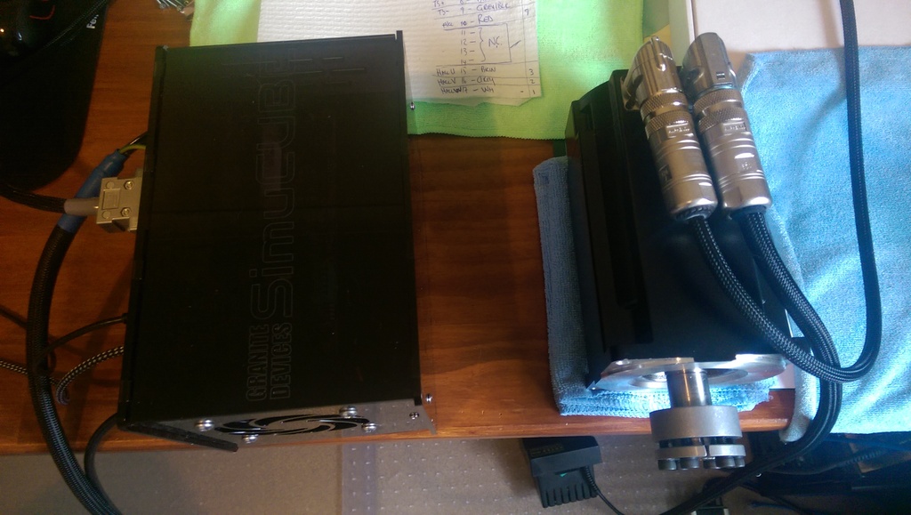

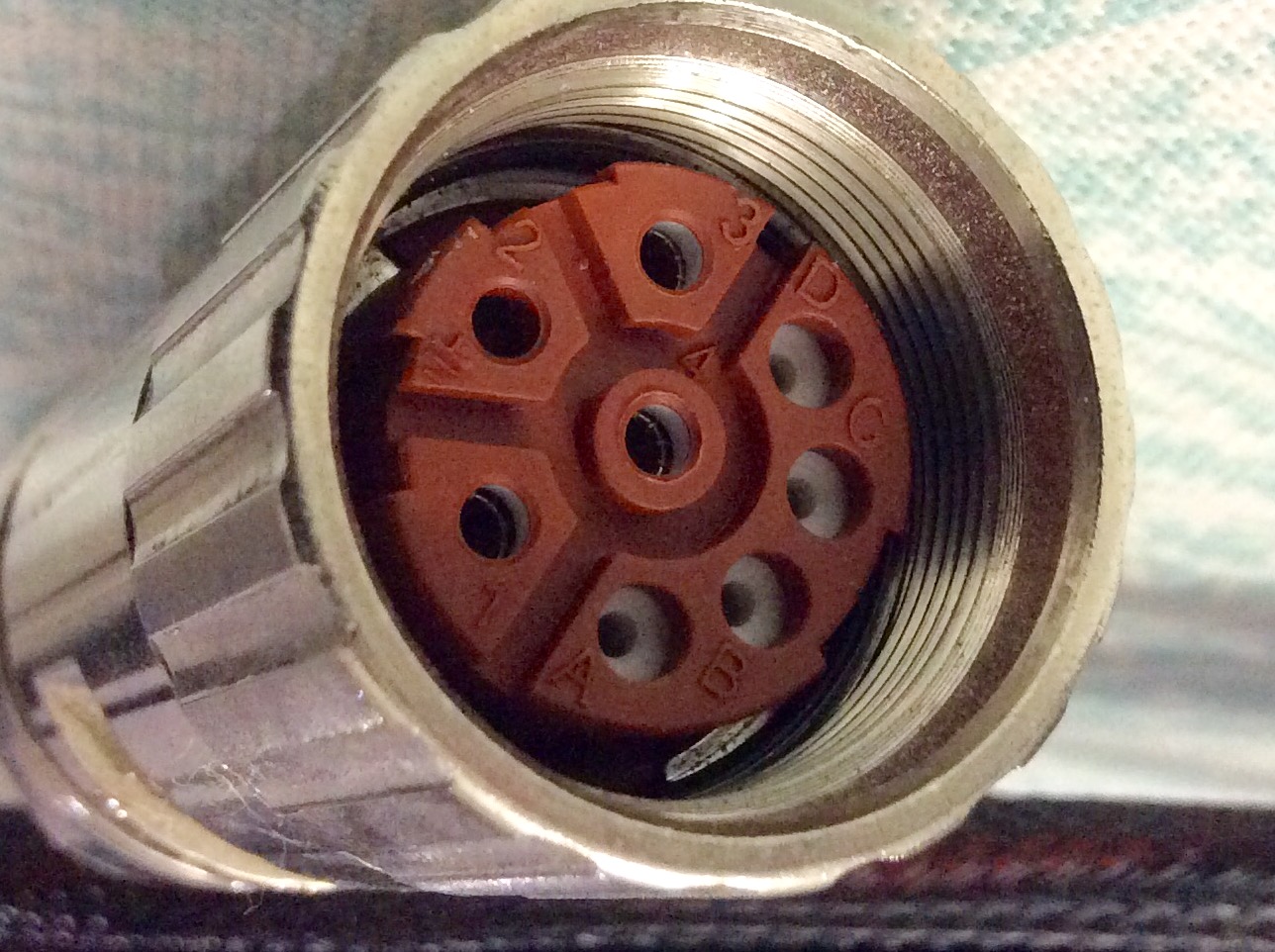

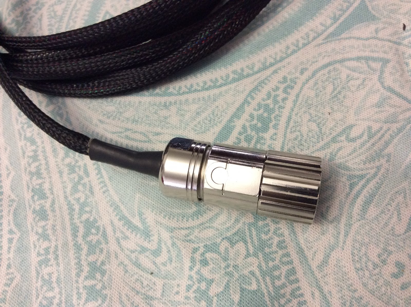

    Here is an update on the OSW project see pictures:
    IMG_4486.JPG IMG_4482.JPG IMG_4476.JPG IMG_4484.JPG IMG_4475.JPG IMG_4485.JPG IMG_4472.JPG
  17. Nick Moxley
    17,057Coins
    +2,507 / 30 / -2
    Yay for Lenze motor.........Booo for the Hit your wallet took. :grin
