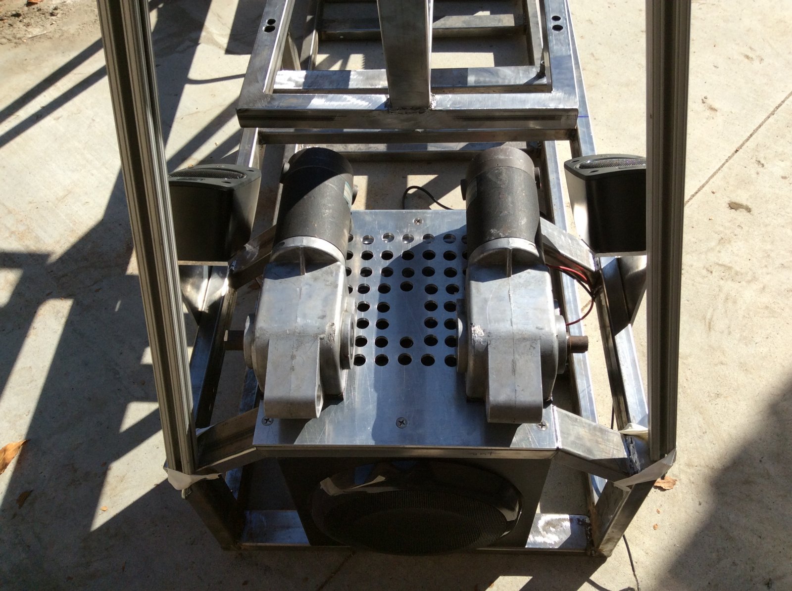

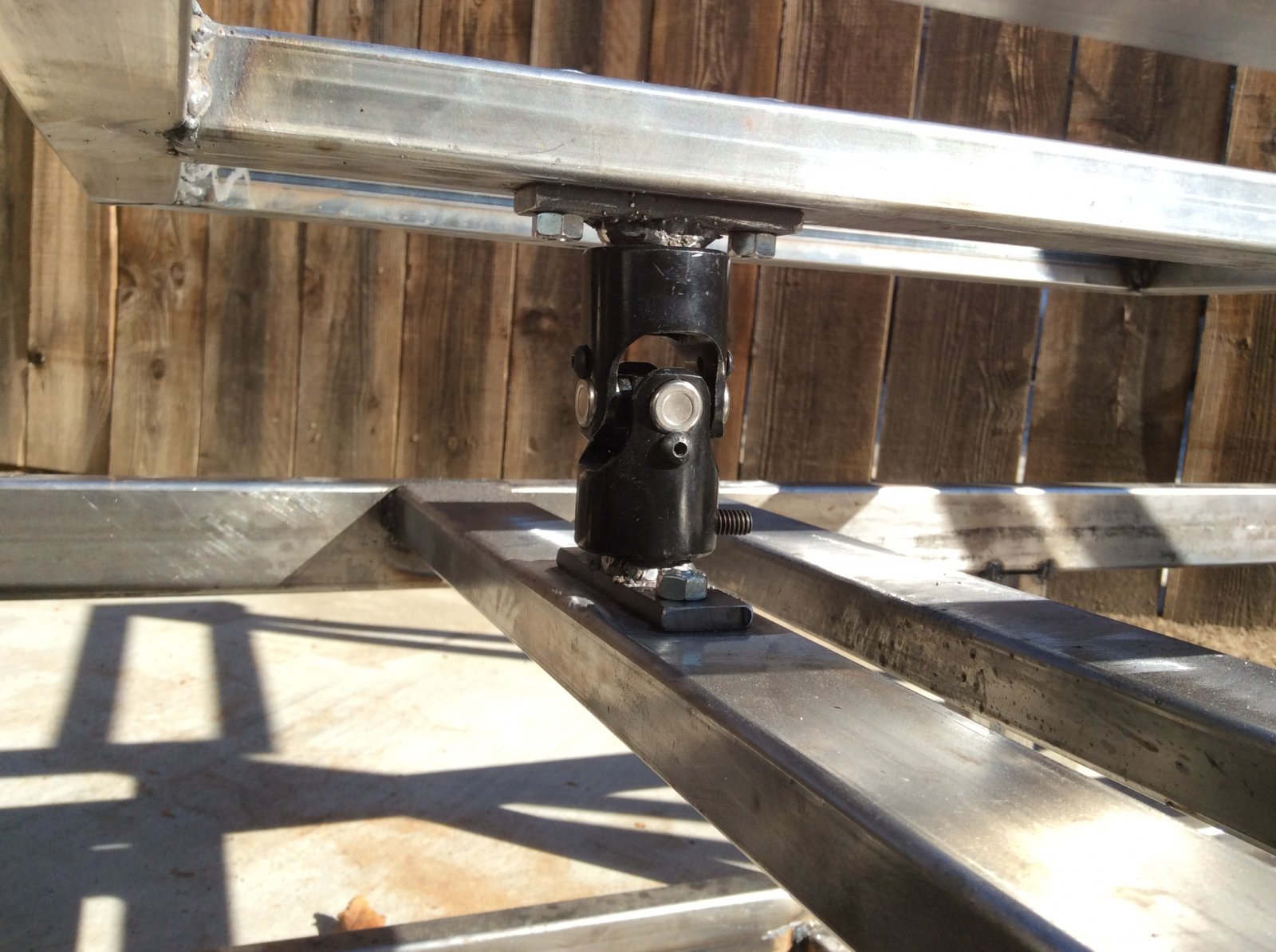

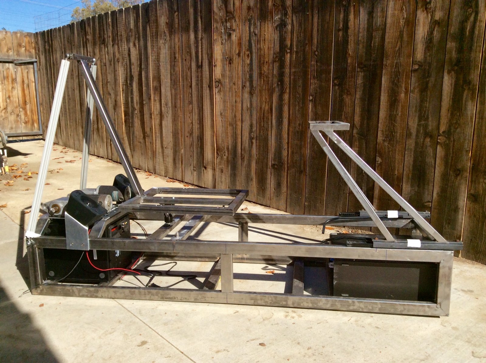

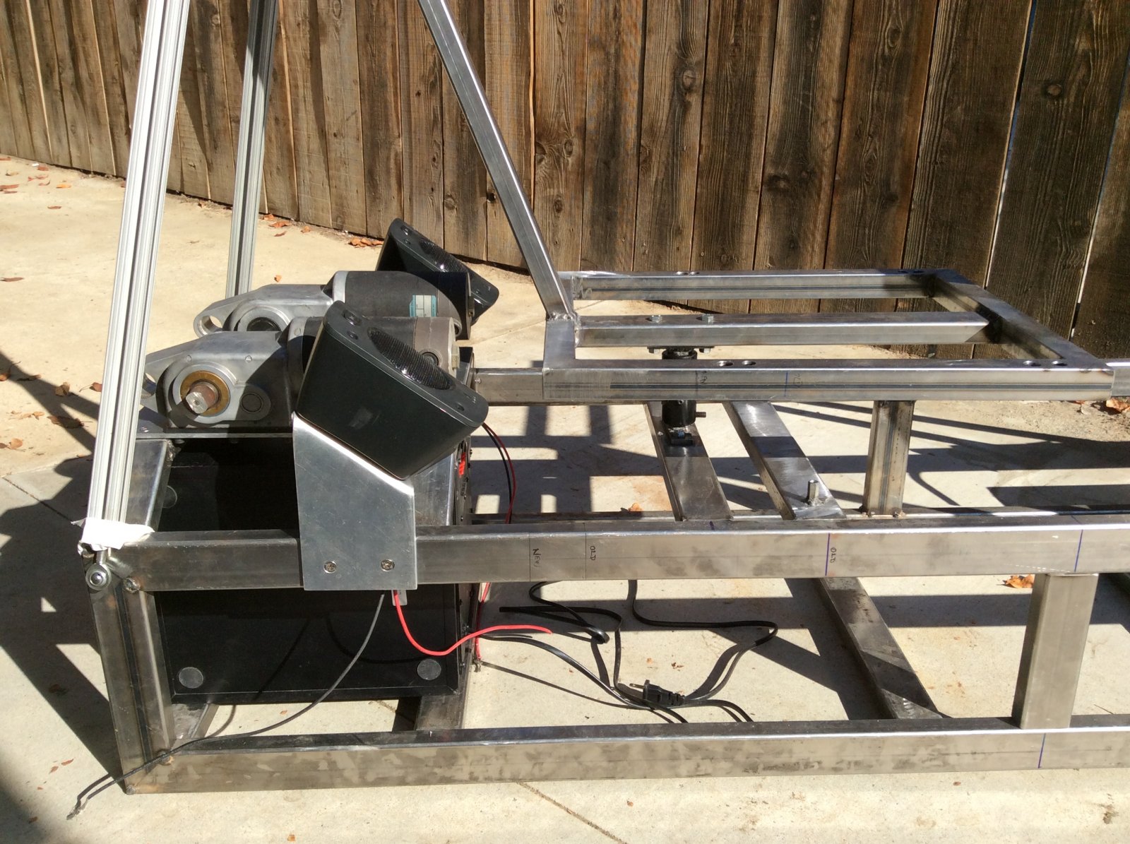

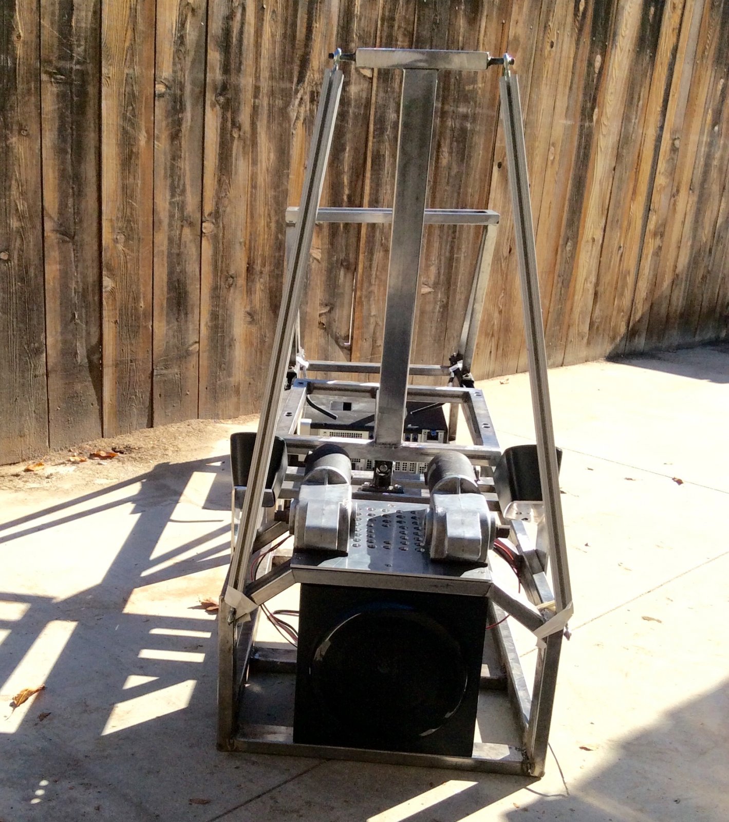

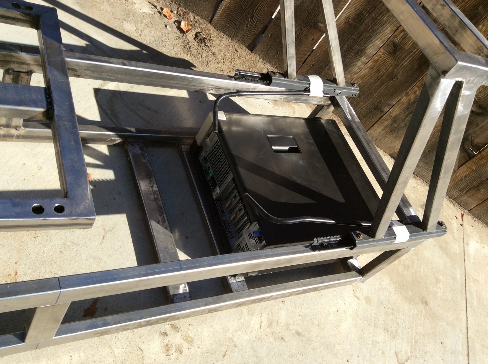

    Progress update, i re designed the sit joined connection so i can adjust or move, i finished the wheel motoer mount that slide on car seat brackets, i also added the rear speakers and the motors, here are some pictures:

  12. Nick Moxley
    17,054Coins
    +2,504 / 30 / -2
    Is that where you plan to mount the motors ?
  13. Milton
    Nov 11, 2015
    345
    Dallas Texas
    1,989Coins
    +320 / 4 / -0
    3DOF, JRK
    Well! Yes and no i still do not know maybe on the side so i can get a biger angle, what do you recomend?
  14. Milton
    Nov 11, 2015
    345
    Dallas Texas
    1,989Coins
    +320 / 4 / -0
    3DOF, JRK
    The original CXC simulator is 24 inches wide and mine is 21 inches wide i guess i will need to install the motors outside, also my motors are from a electric wheelchair so they are big in size alot of torque and very slow, i am planning on using the JRK 12x12 Motor controller but i will need to buy new motors.

  19. Nick Moxley
    17,054Coins
    +2,504 / 30 / -2
    I would recommend mounting on the side's to get the angle's you want/need.
  20. shannonb1
    shannonb1 Well-Known Member
    Mar 12, 2008
    1,107
    Sales Intelligence
    Virginia
    8,909Coins
    +598 / 5 / -0
    The cxc also uses SNC5 actuators so the angle for those is a bit different then the gear type motor. I would also recommend moving those out. Another thing that you will notice is how much your seat will move side to side at idle with the pitch that steep. Spreading them out allows the weight to settle and they will feel more locked in.
