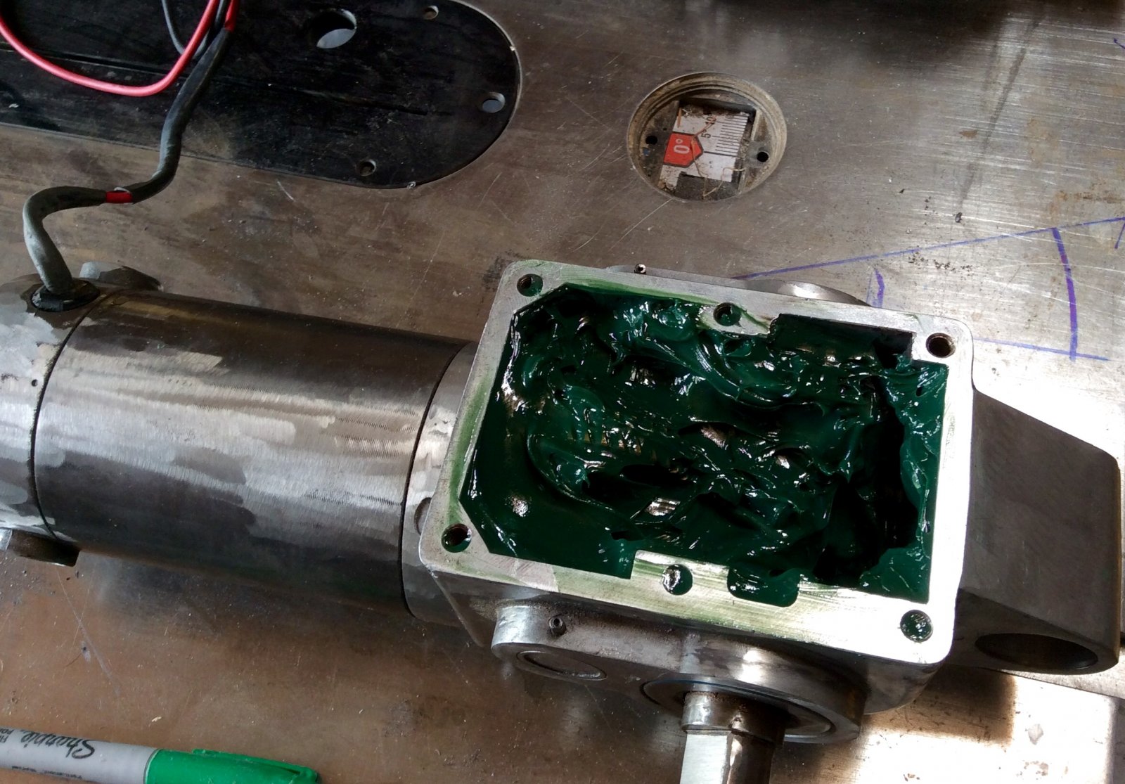

    I Notice by greasing my motors they are very quite!
  14. Nick Moxley
    17,057Coins
    +2,506 / 30 / -2
    Any pic Pre the greasing to see the gears? Ill be opening up mine sooner or later, More curious than anything.

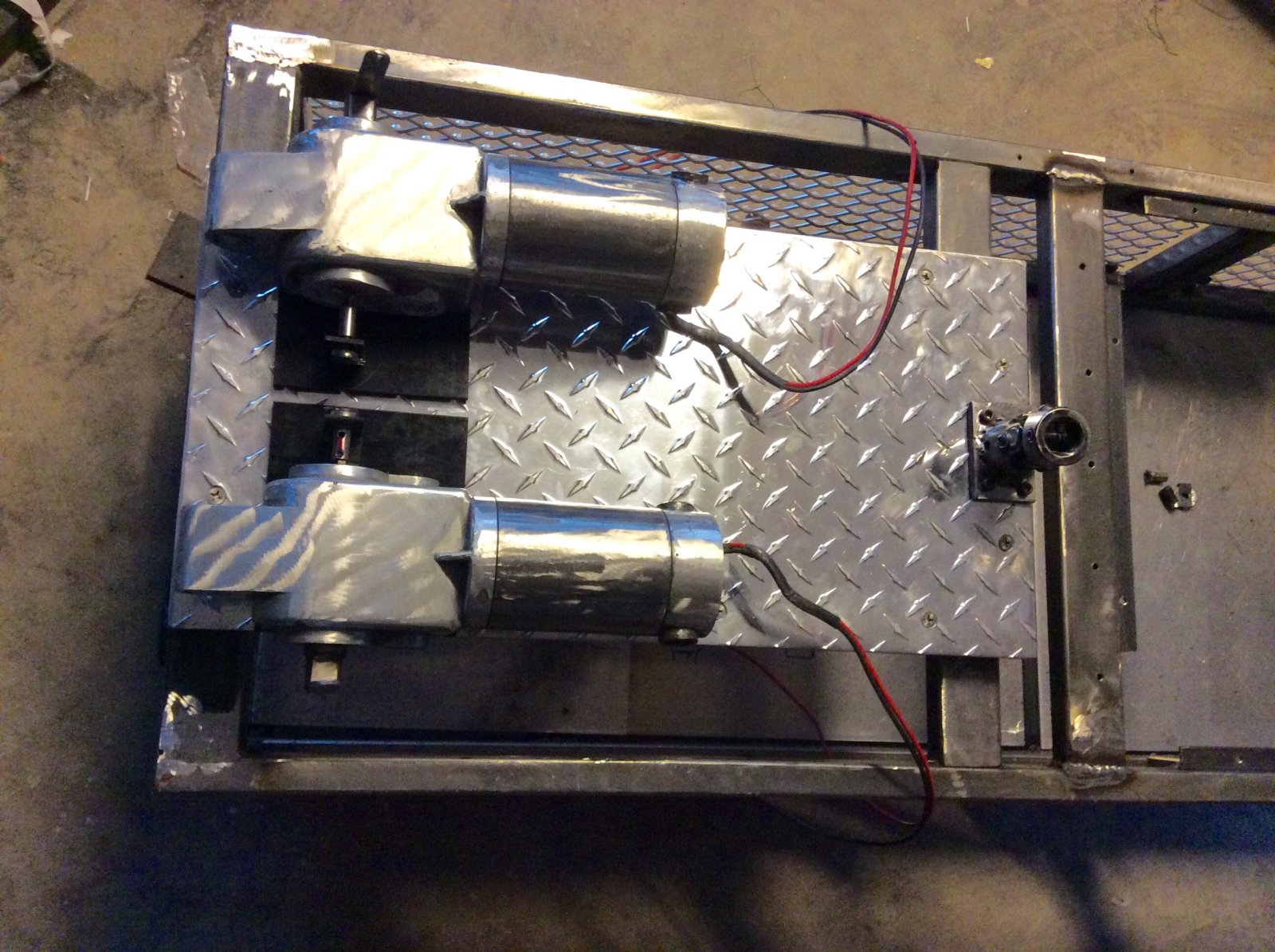

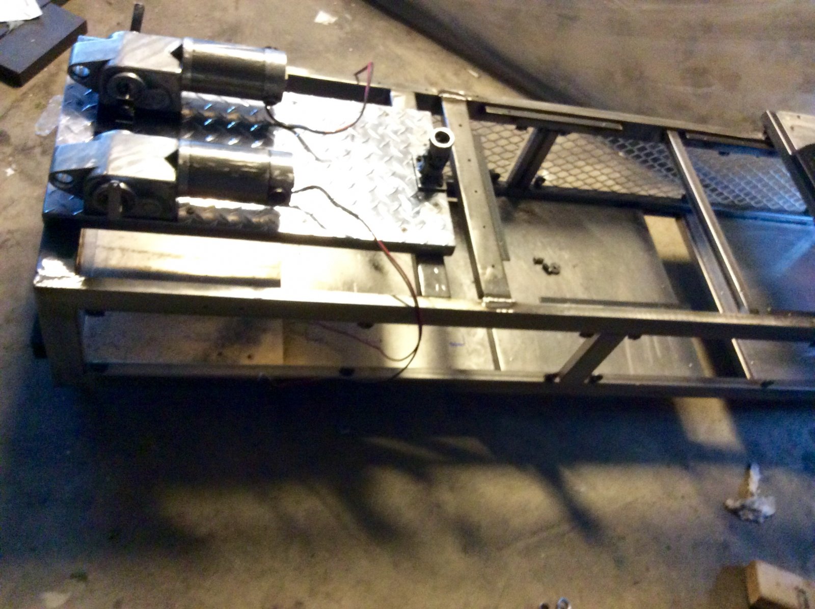

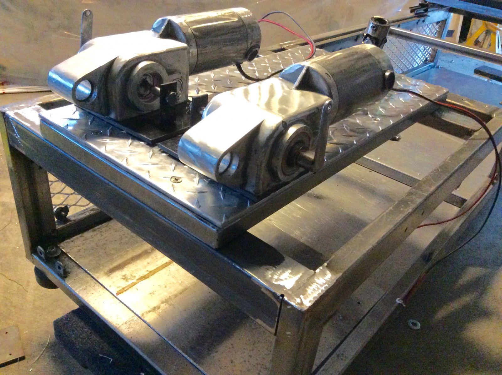

    An update on the traction loss mod see pictures:

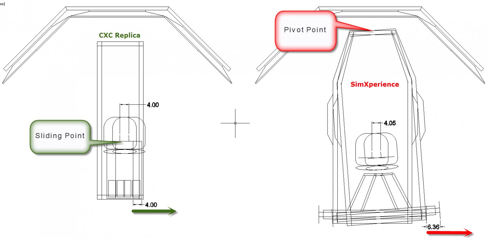

    I draw my CXC Replica and the SimXperience Statege 4 Rig in AutoCAD to 1:1 Scale, and compare the motion and distance of travel of both system, the chair on both systems are traveling the same distance but not the Rear, measurements are in inches see picture:

    You got some Overly twitchy forces going on there Milton. I suggest you rework your Tuning center. Surge for example should not be as abrupt as you have it. I can see when your chick Barely TOUCHES the gas pedal, you get a Full surge moment, That isn't right at all. Traction loss should also be a nice smooth linear force, Not twitching back and forth, and Overall "intensity" of the motion wont change that. So You 100% need to work on your tuning center #'s to smooth out that motion.
    Hrmm, also i dont see the 4" of head movement you specked out in your CAD drawing.....i see overall very little actual distance travelled out of the TL.
