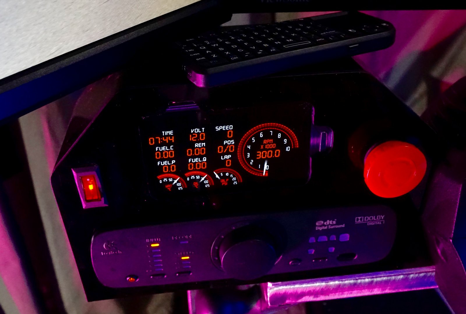

    But! stay tune to the continuation of the CXC rig I am adding a Dashboard with buttons it will be done using a computer keyboard.

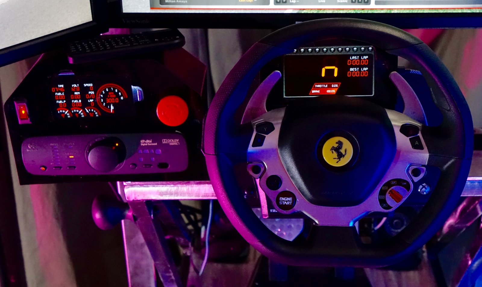

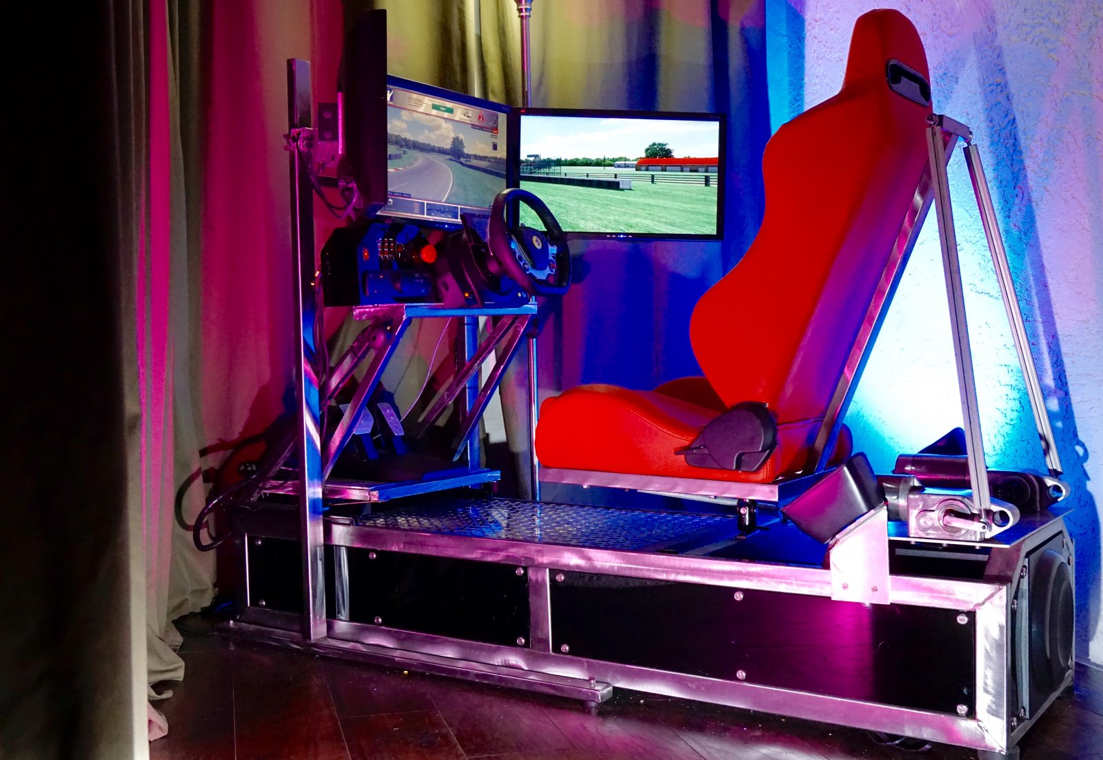

    Check this out! My new sim racing rig!

    Great job, can we expect a video of your rig in action for Chistmas?

    I must say... I am impressed by the construction progress.
    Bravo.

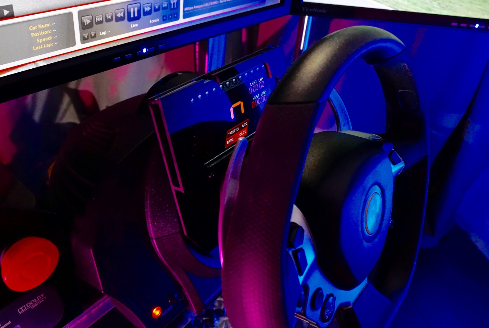

    I really like the adjustable controls. It makes it very to setup for other people to use the sim. Nice Job!

    Your rig did not cost 90k, but it performs just as well.
    The details like the dash and adjustable controls are just superb :thumbs

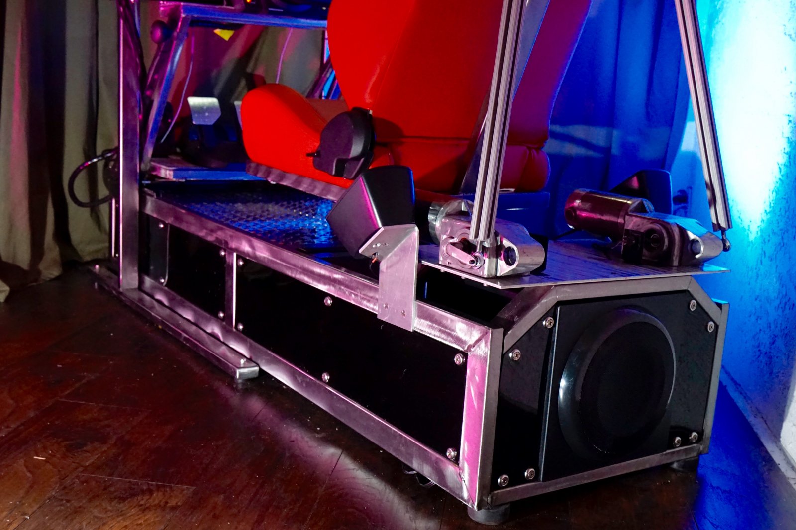

    Lots of these motor's are available on ebay for a decent price too........Interesting.
    1 Thing after watching the video, I can see @ 2:47 the seat has a Decent amount of flex which is "softening" some of the heave detail. i suggest adding a block of stiff foam between the seat frame and the seat itself. or bring the seat closer to the frame itself and same thing, use a block of foam to prevent it touching under flex.
    Also the following shot @ 2:52 it somewhat looks like the whole motor plate is wiggling a bit....might just be the camera angle/shot, but thought i would mention it.
