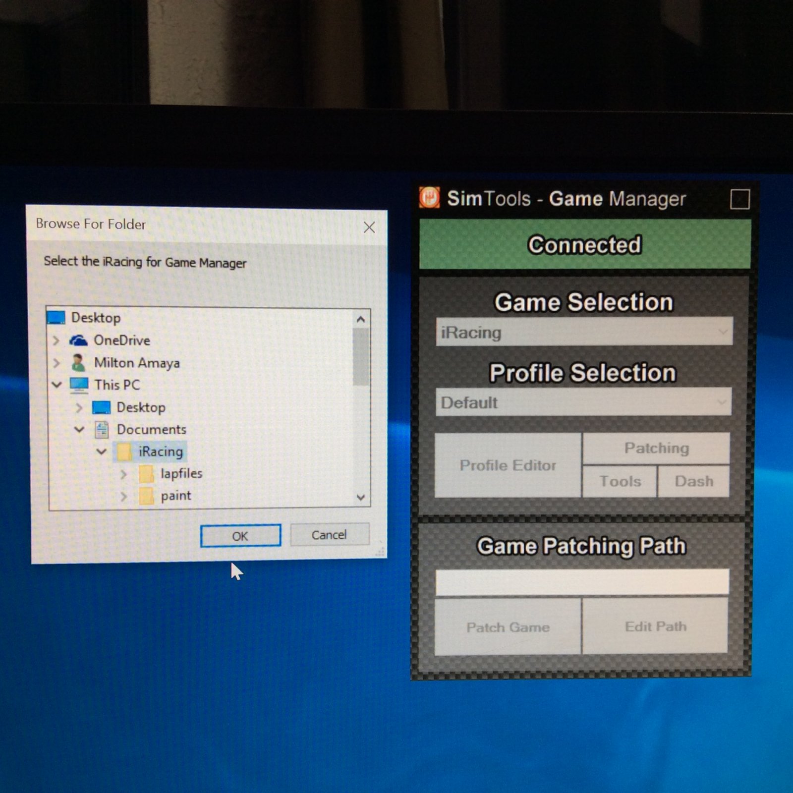

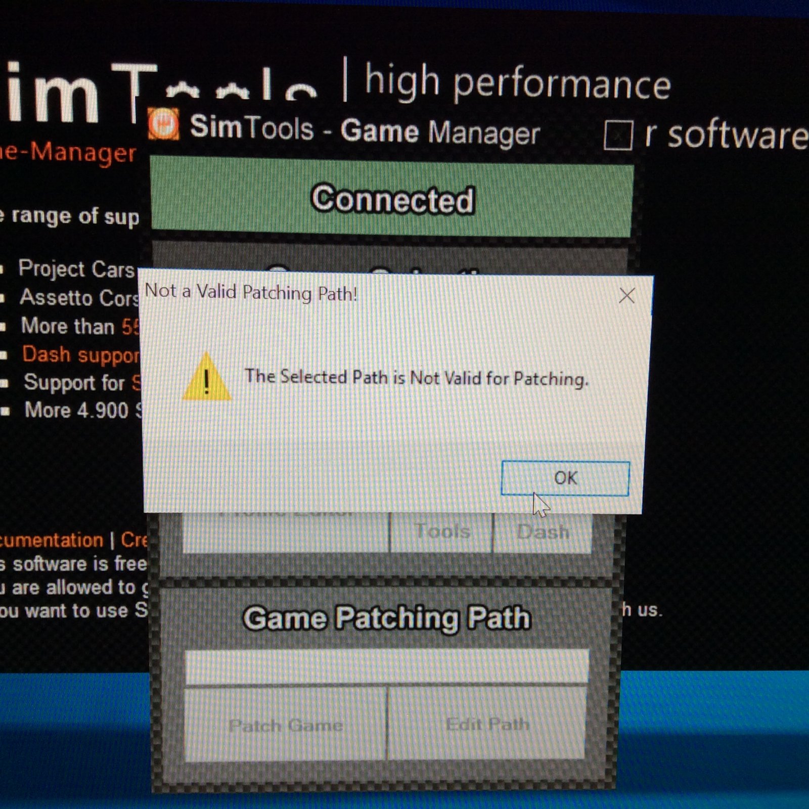

    Help!, i am almost ready to test my sim and i encounter an issue trying to "Patch" iRacing, anyone knows how to fix this! Or i do not need to Patch a game?
    See picture:

    SimTools runs fine with Win 10.
    Can you confirm that you completely closed down SimTools, right clicked on the launch icons and chose to run as Administrator.
    I can't see the full folder you are trying to patch to in the image. Is that the actual game install folder for iRacing that contains the iRacing executable?

    You need to pick your game folder not the one under "My Documents"
    So for me I use "C:\Program Files (x86)\iRacing"
    If you have installed it in a different folder then you want to pick the folder that has the iRacing EXE files in it, not the settings folder under my docs.

    You are correct! That worked thanks!
