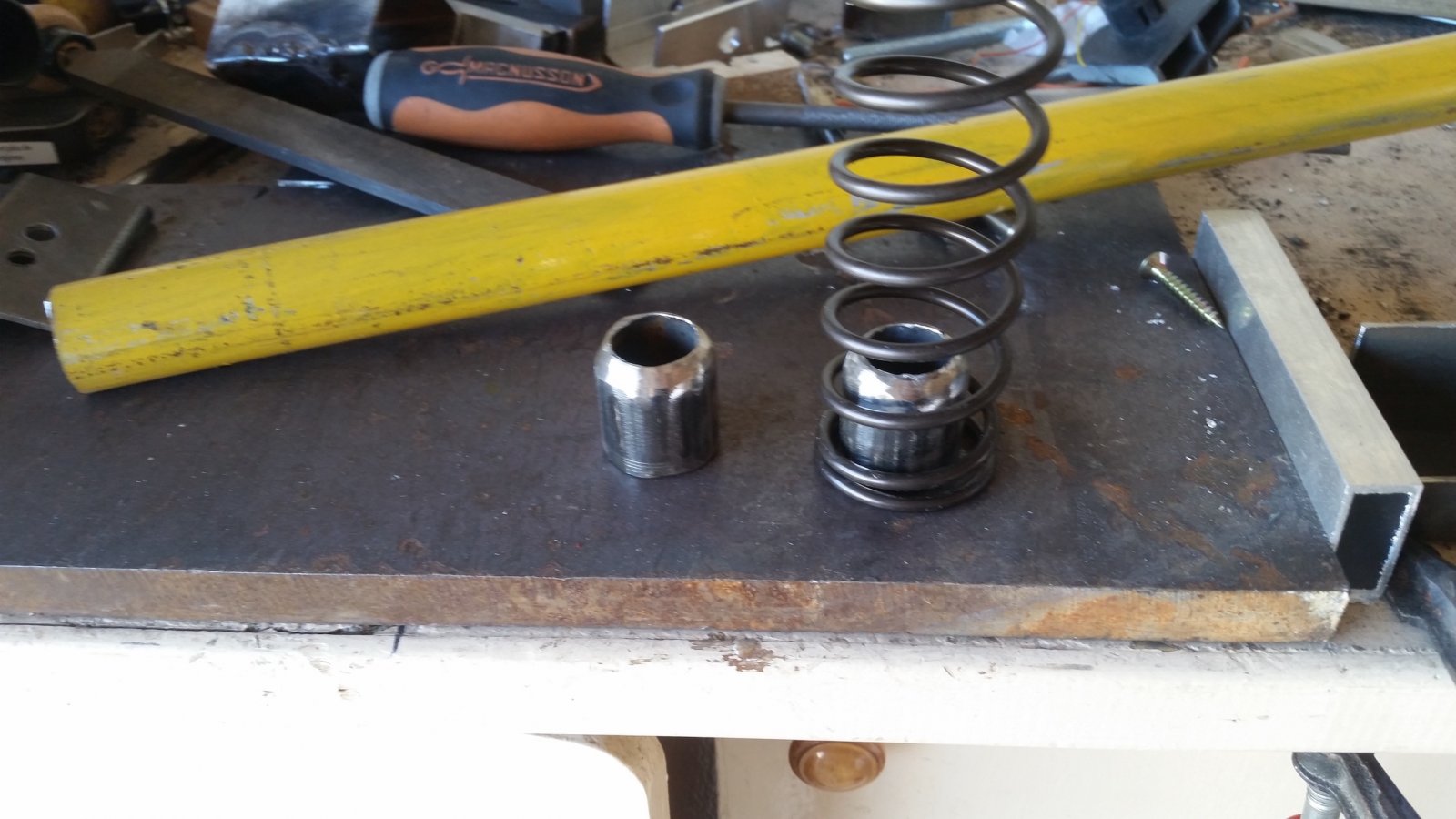

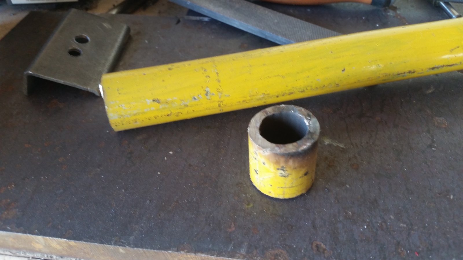

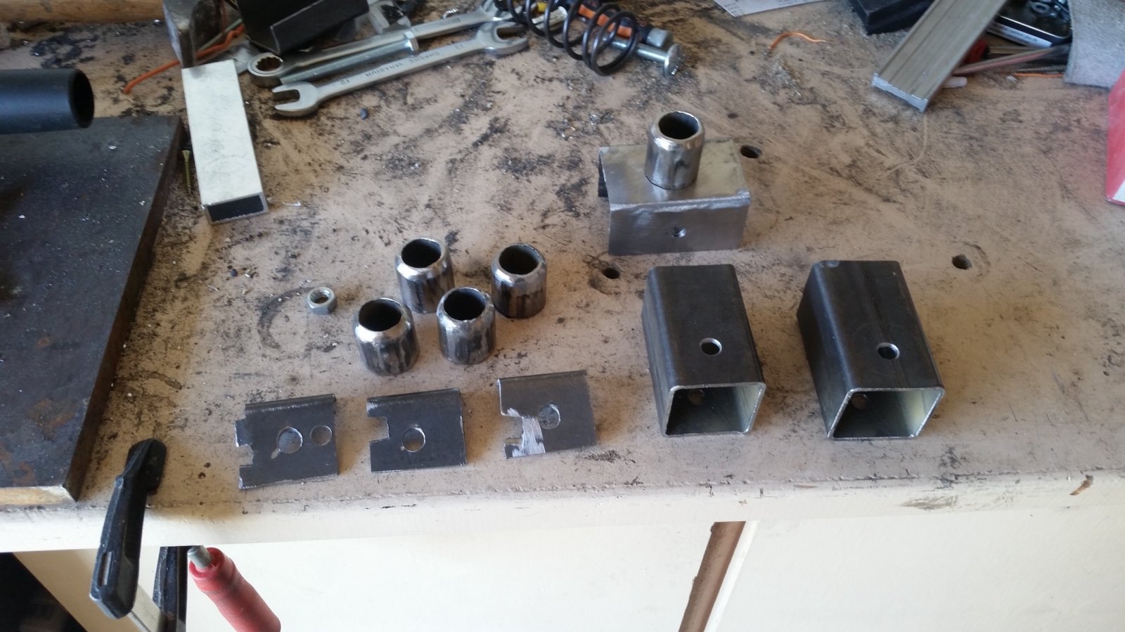

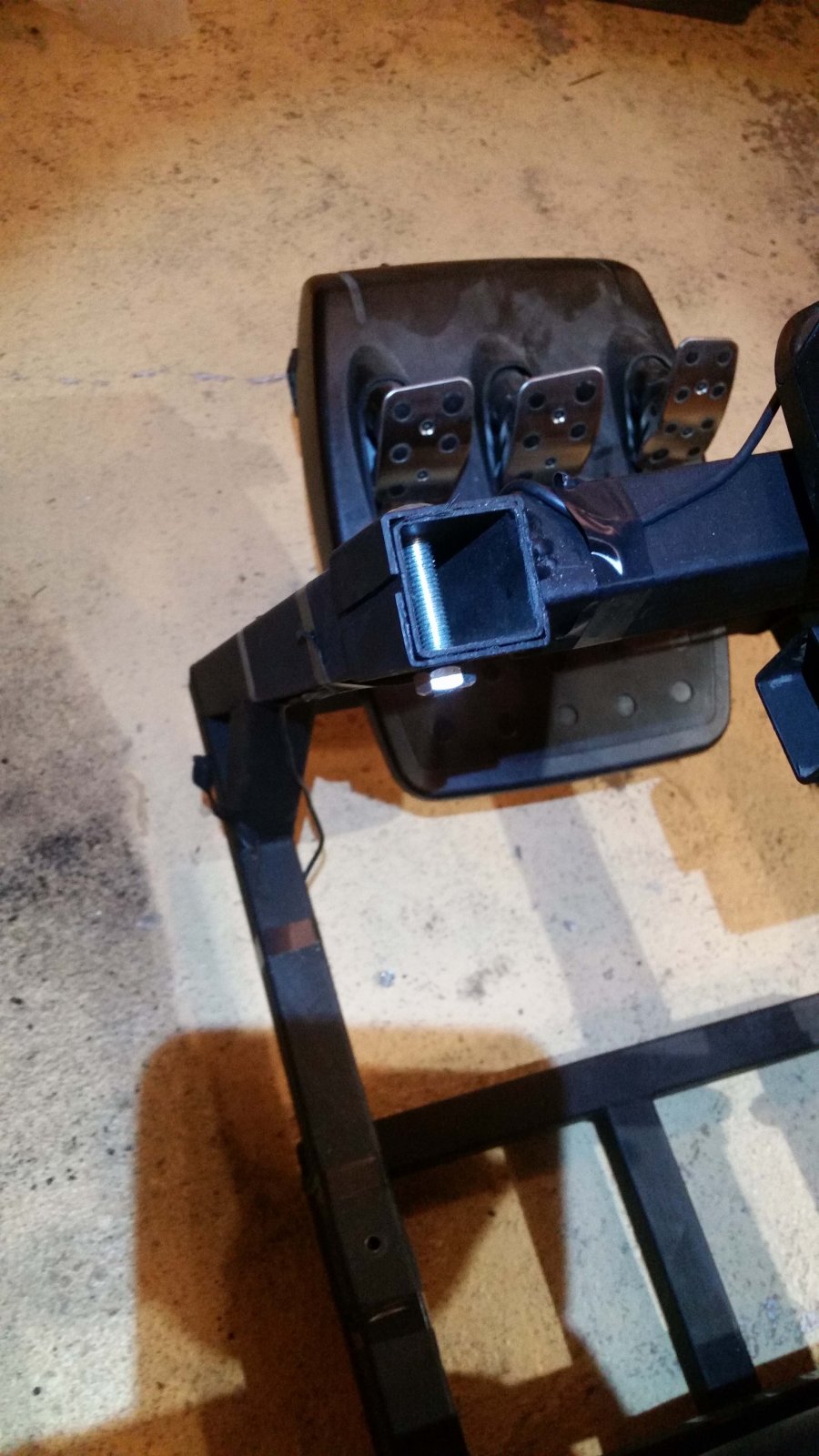

    building the supports for the springs

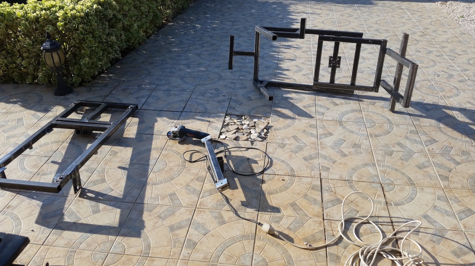

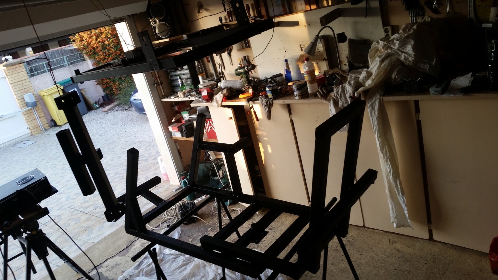

    Sanding all the simulator before painting

    Painting all the parts

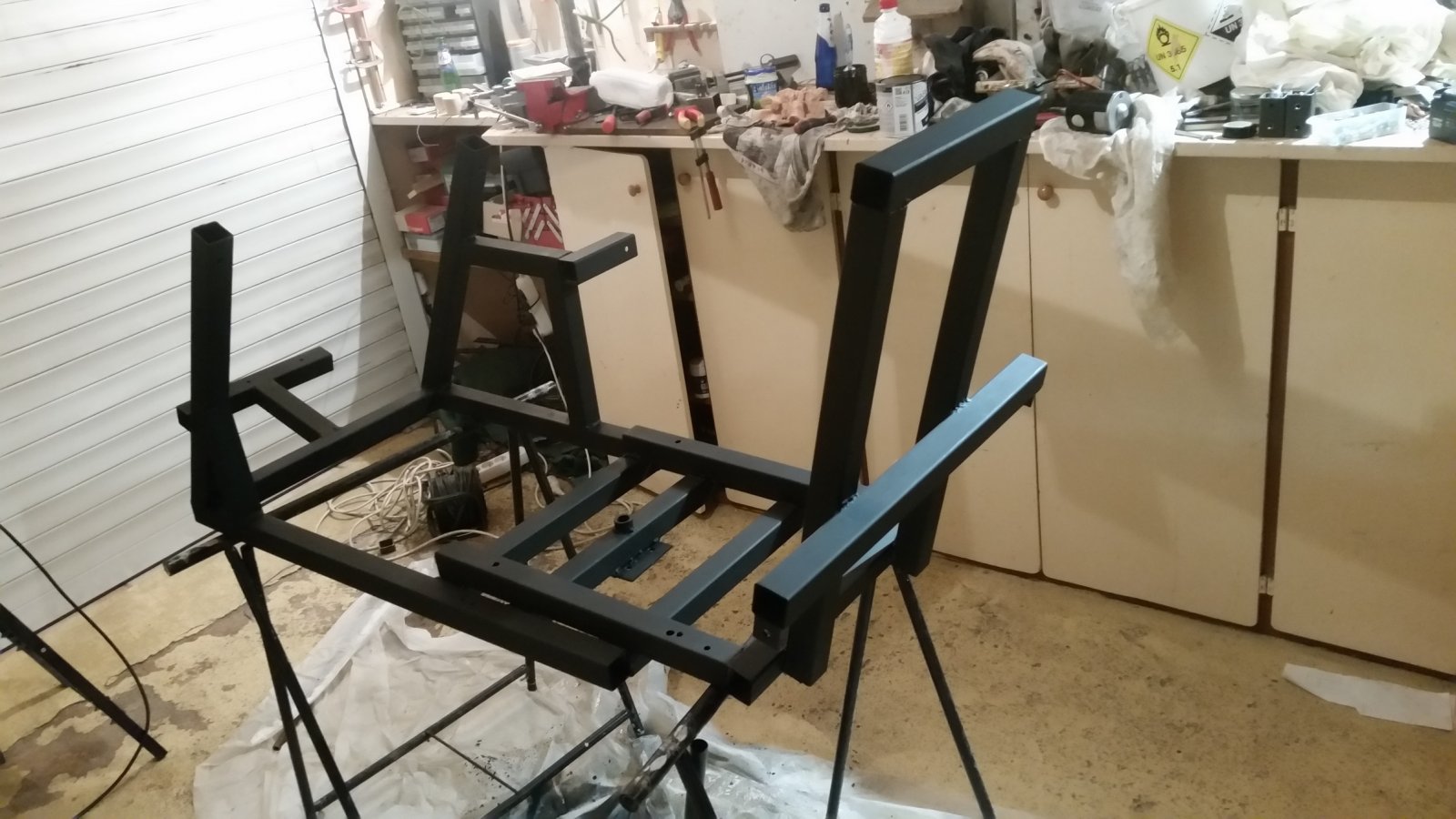

    2nd layer of mat black

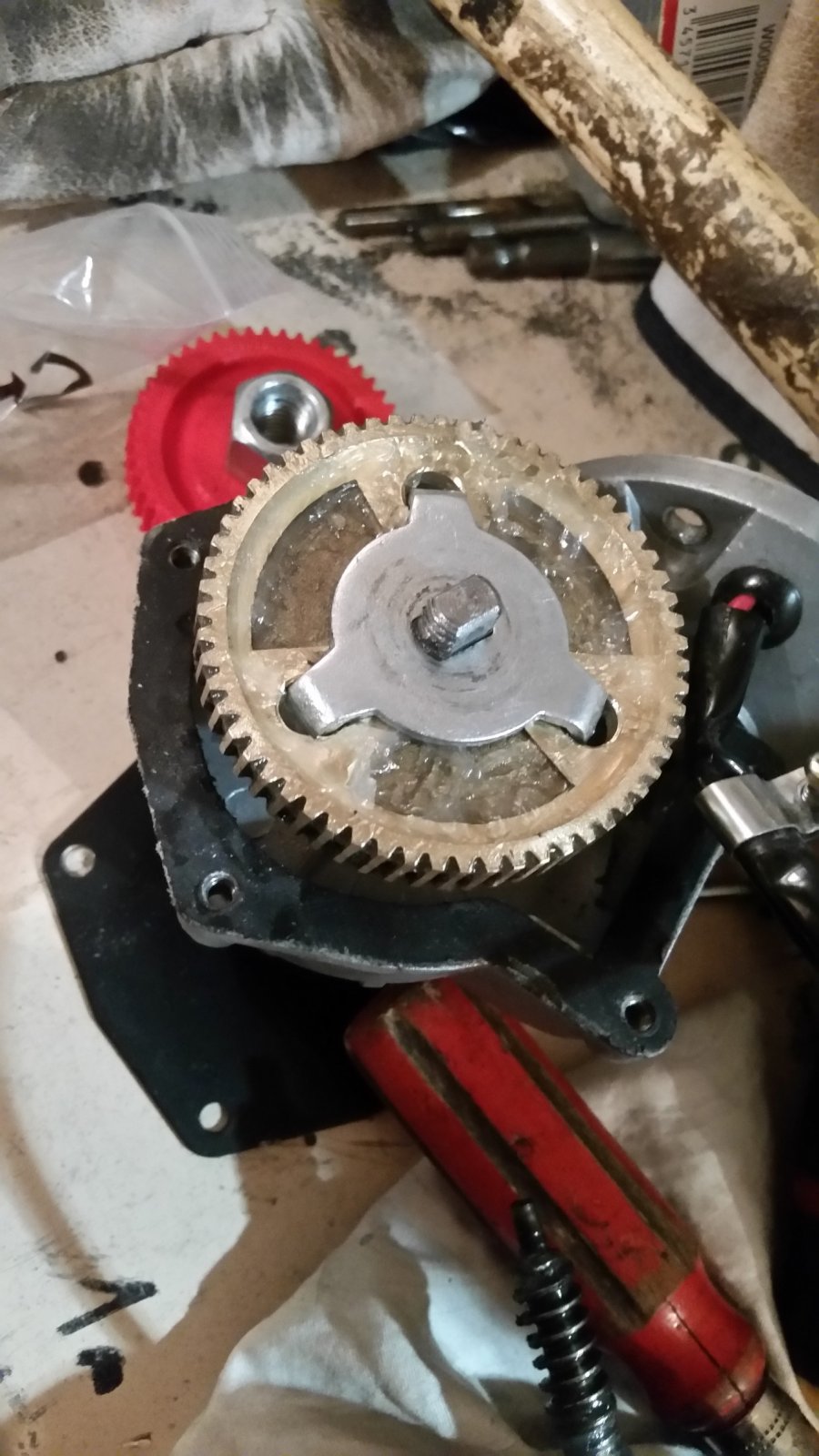

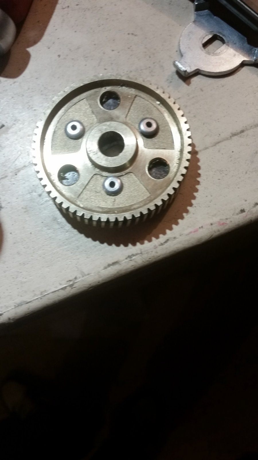

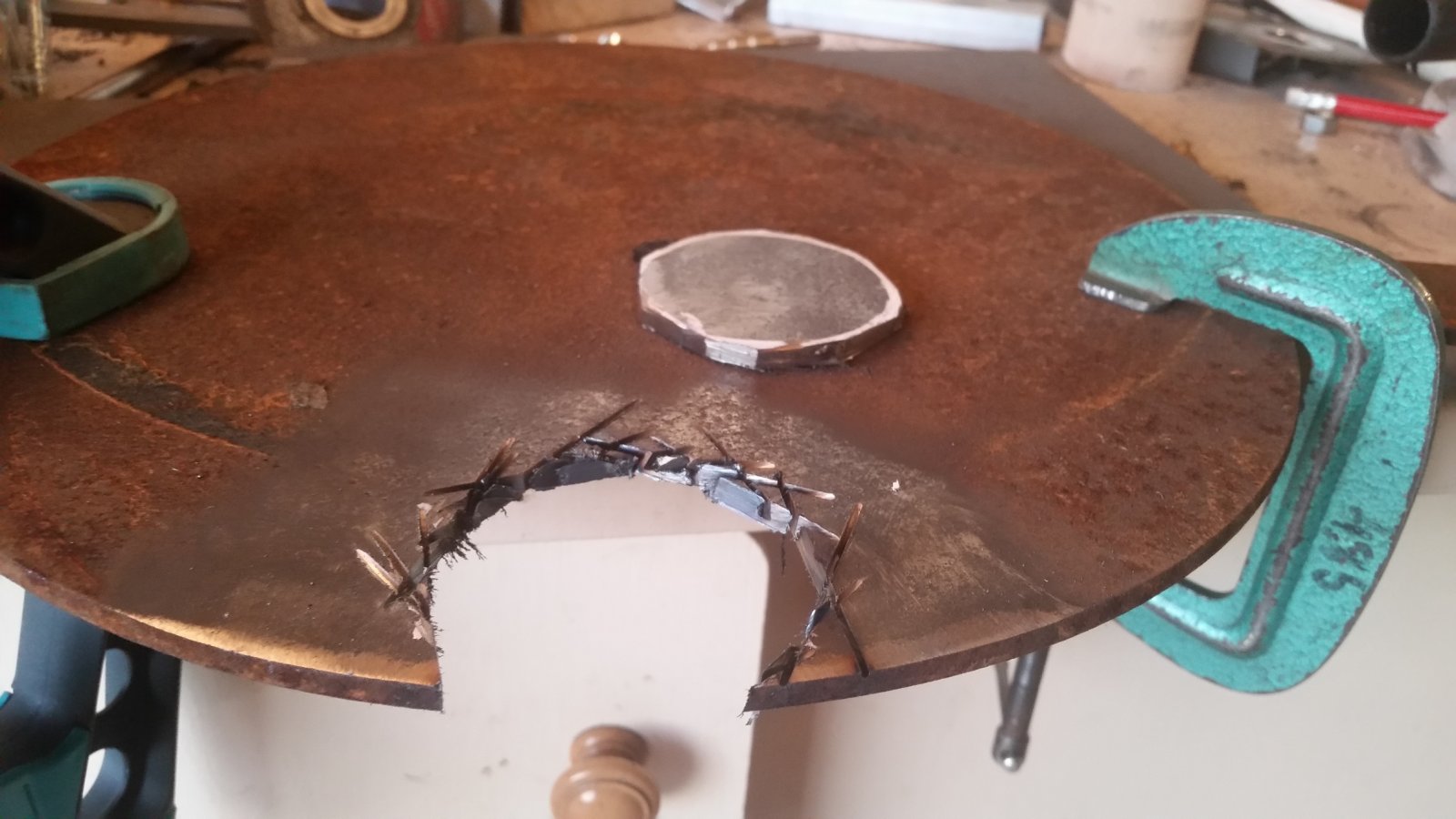

    I had a big problem with the 2 motors between the shaft and the gear of the reducer,
    the arm of the motor could move freely about 2 or 3 degrees, the result was that the regulation couldn't work fine and I had some bounds with the movements of the simu
    This is the existing part
  11. creazyrider
    creazyrider Active Member
    Sep 12, 2017
    197
    france
    850Coins
    +56 / 1 / -0

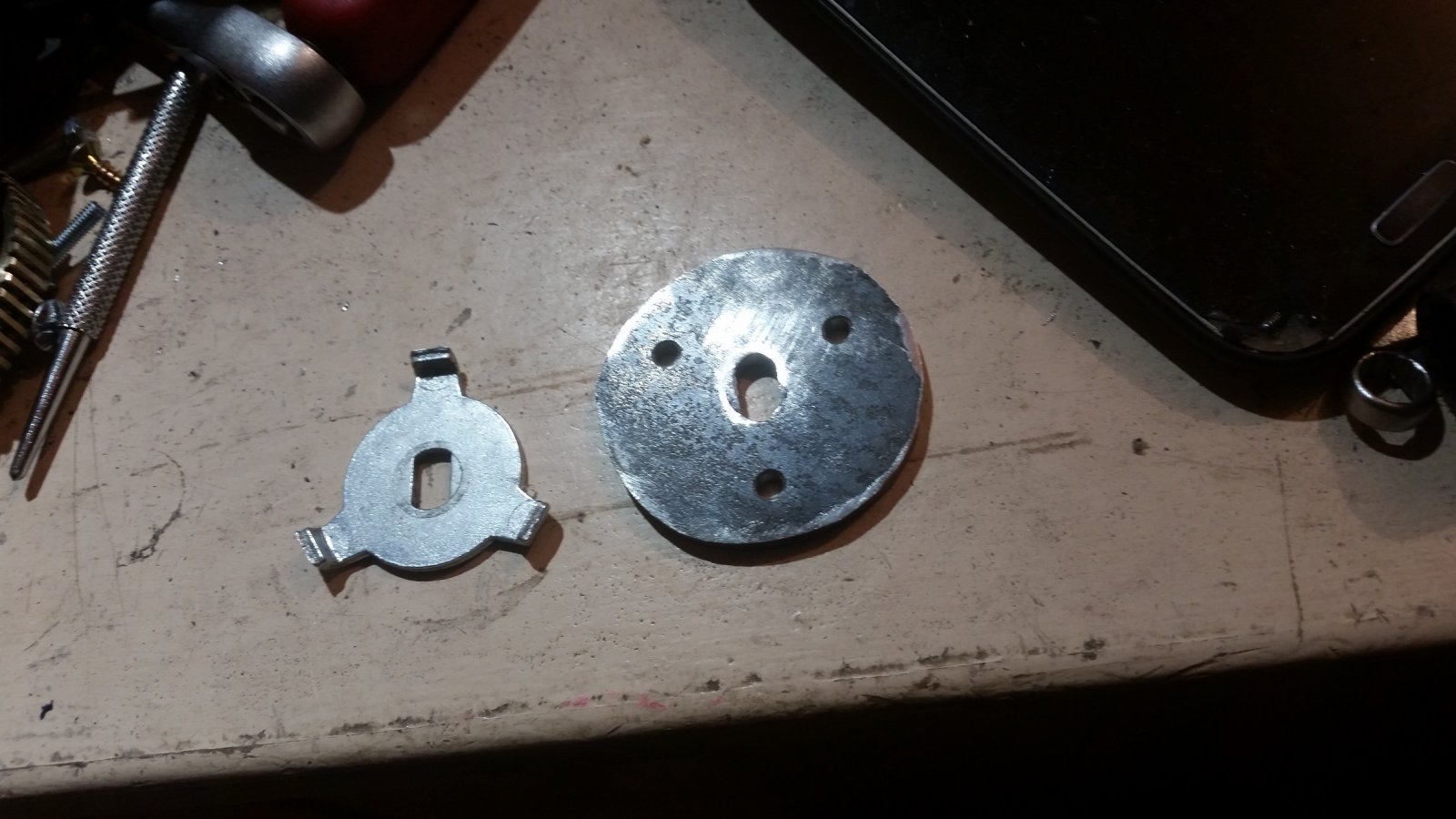

    Building the new part
  12. creazyrider
    Sep 12, 2017
    197
    france
    850Coins
    +56 / 1 / -0
    comparison of the old one (left) 2.5mm thick and the new one 4mm thick
  13. creazyrider
    Sep 12, 2017
    197
    france
    850Coins
    +56 / 1 / -0

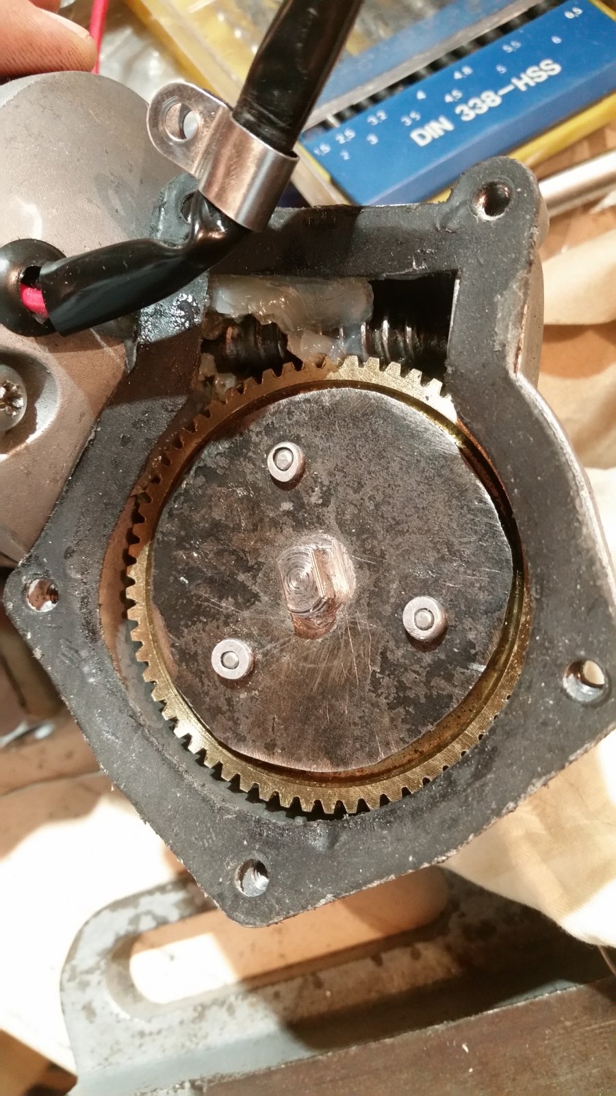

    From the other side of the gear, the new part fastened
  14. creazyrider
    Sep 12, 2017
    197
    france
    850Coins
    +56 / 1 / -0
    The new part ready to use, I added some tin to fill in the space between the shaft and the new part

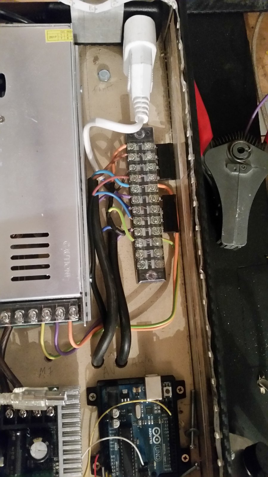

    I bought a terminal to wire properly all the 230V

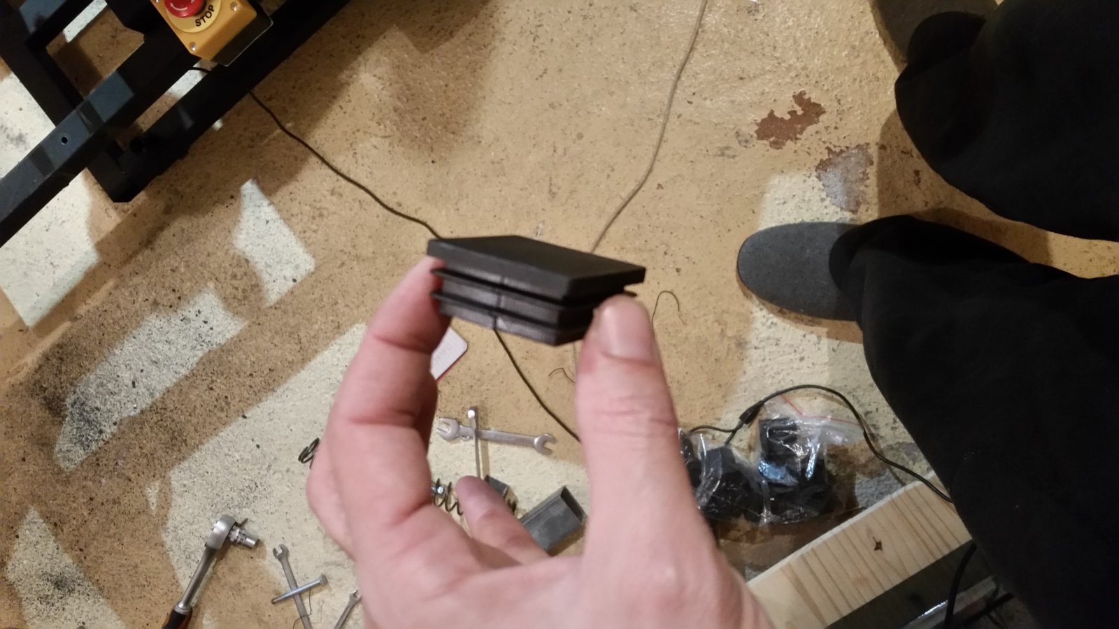

    Today I received the end caps
